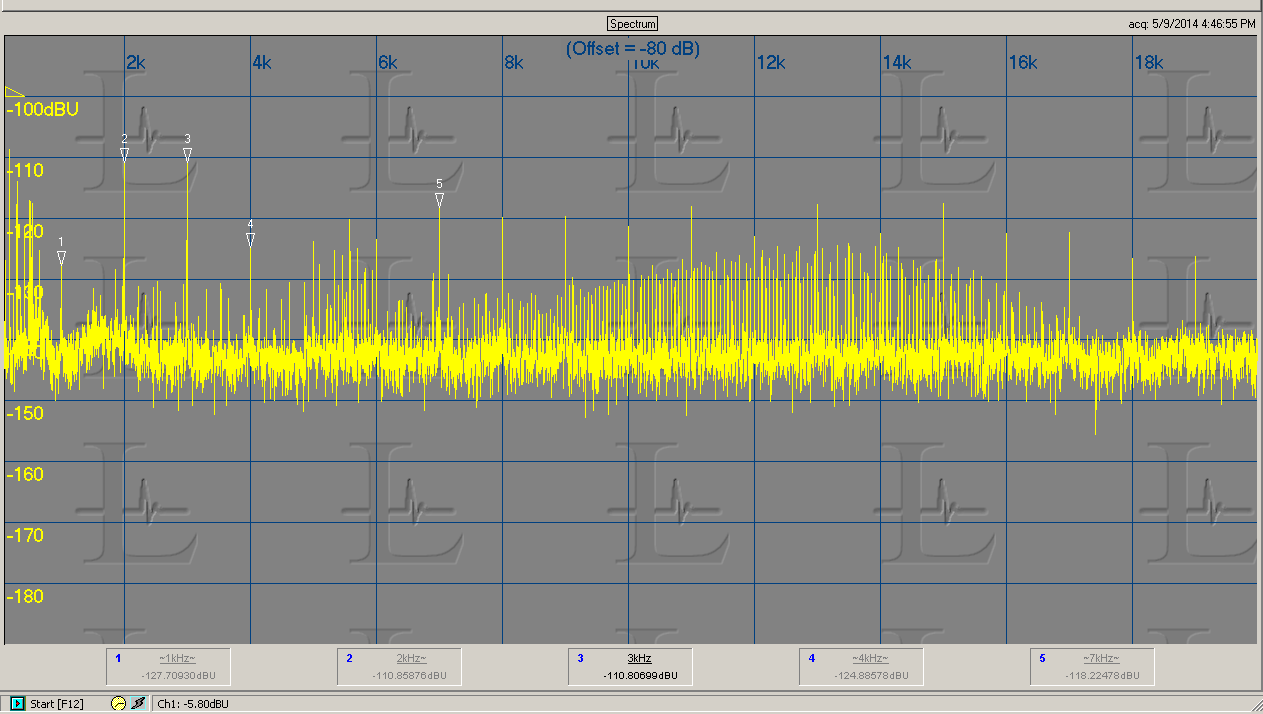

I don't have a real spectrum analyzer, so I have tried to measure the noise spectrum with my oscilloscope. See the attached document.
At least with this method I don't see the same level of noise as you have measured on the AK4399.

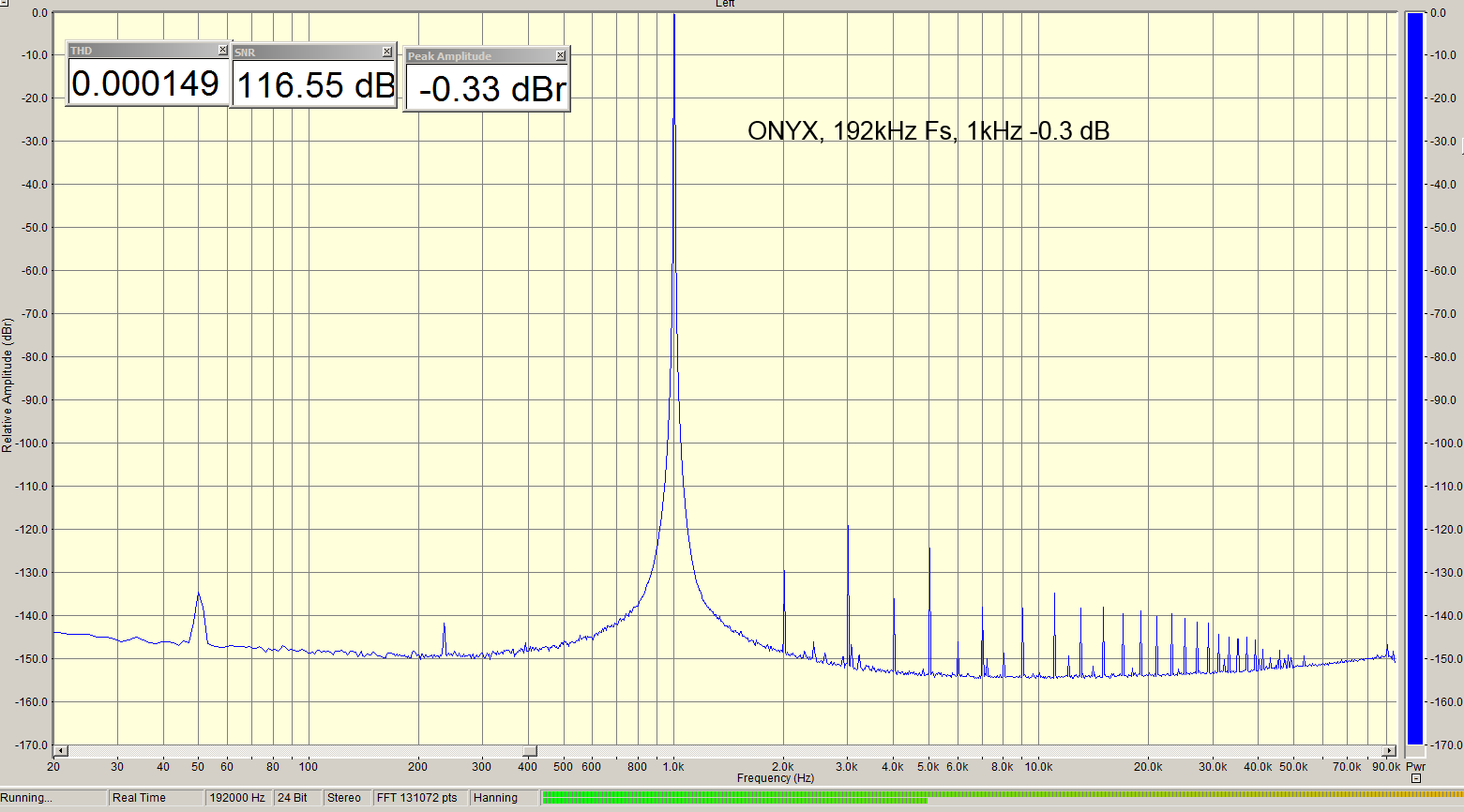

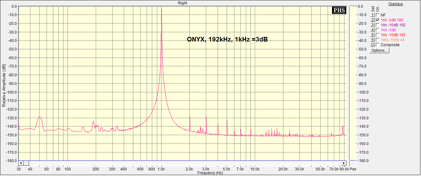

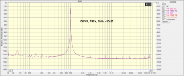

Thank you, JensH, I have comparable results, this is 1kHz from "Victor's generator":
