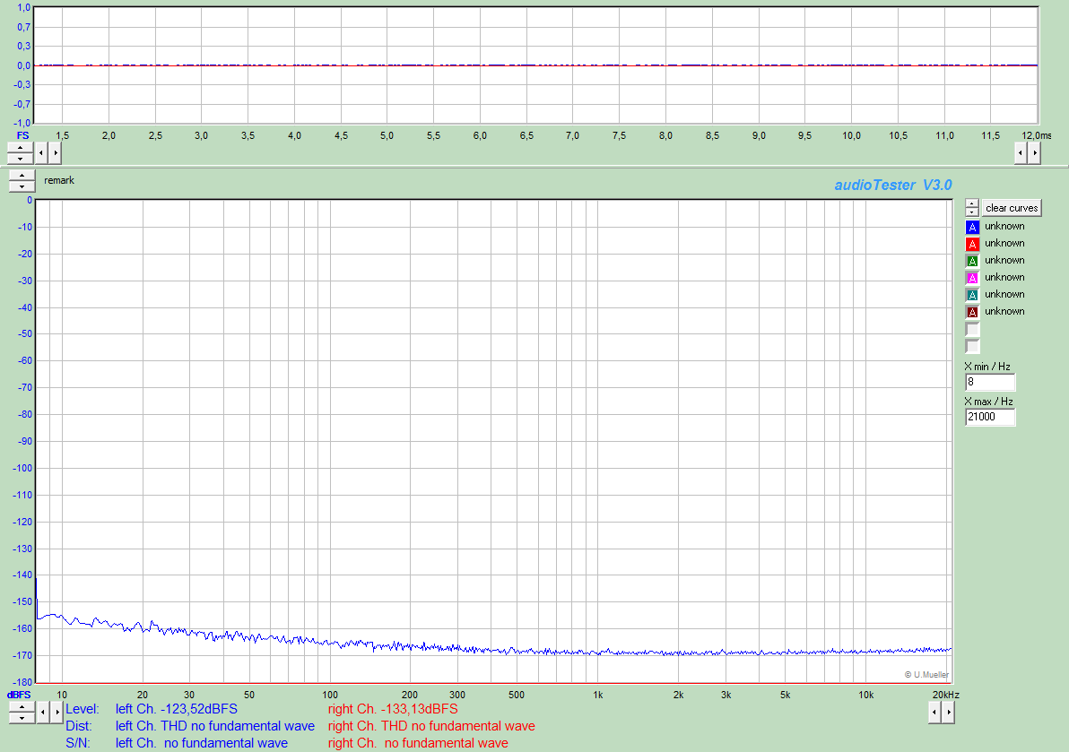

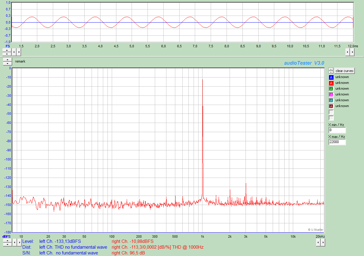

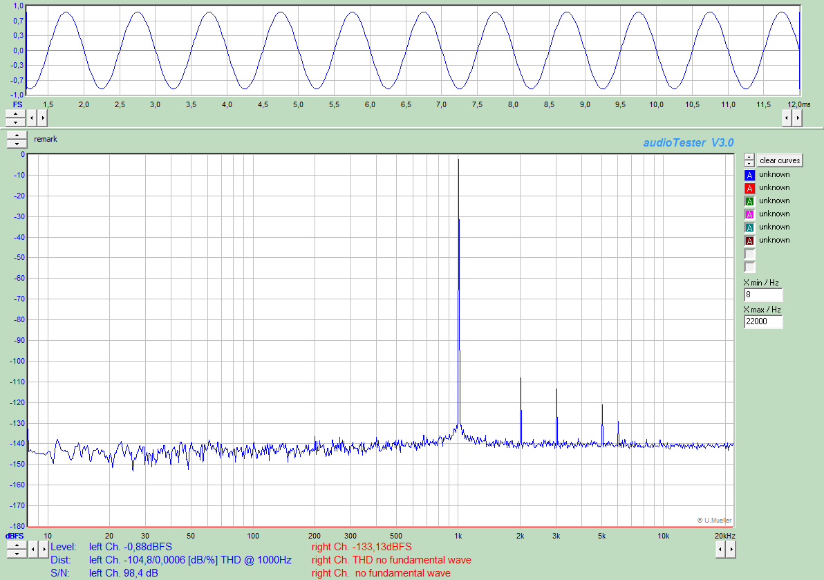

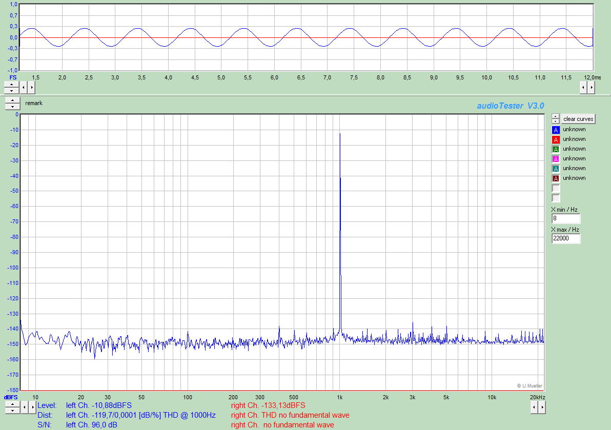

I found the problem with the noisy channel. It has been fixed now and the picture below shows a loopback from generator output to the left input.
The generator output level was -9dBFS and -19dBFS. Input set to no gain/attenuation.
The right channel still doesn't work correctly.

OK, got the right channel working also. I had deliberately left out the capacitors on the ADC right channel input to make it easier to experiment with different values if needed. I had forgotten all about until a moment ago 😱
Now they are in place and the results are similar to the results for the left channel, see below.
So the basic functionality now seems to be OK. I still need to adjust it and check the performance further.

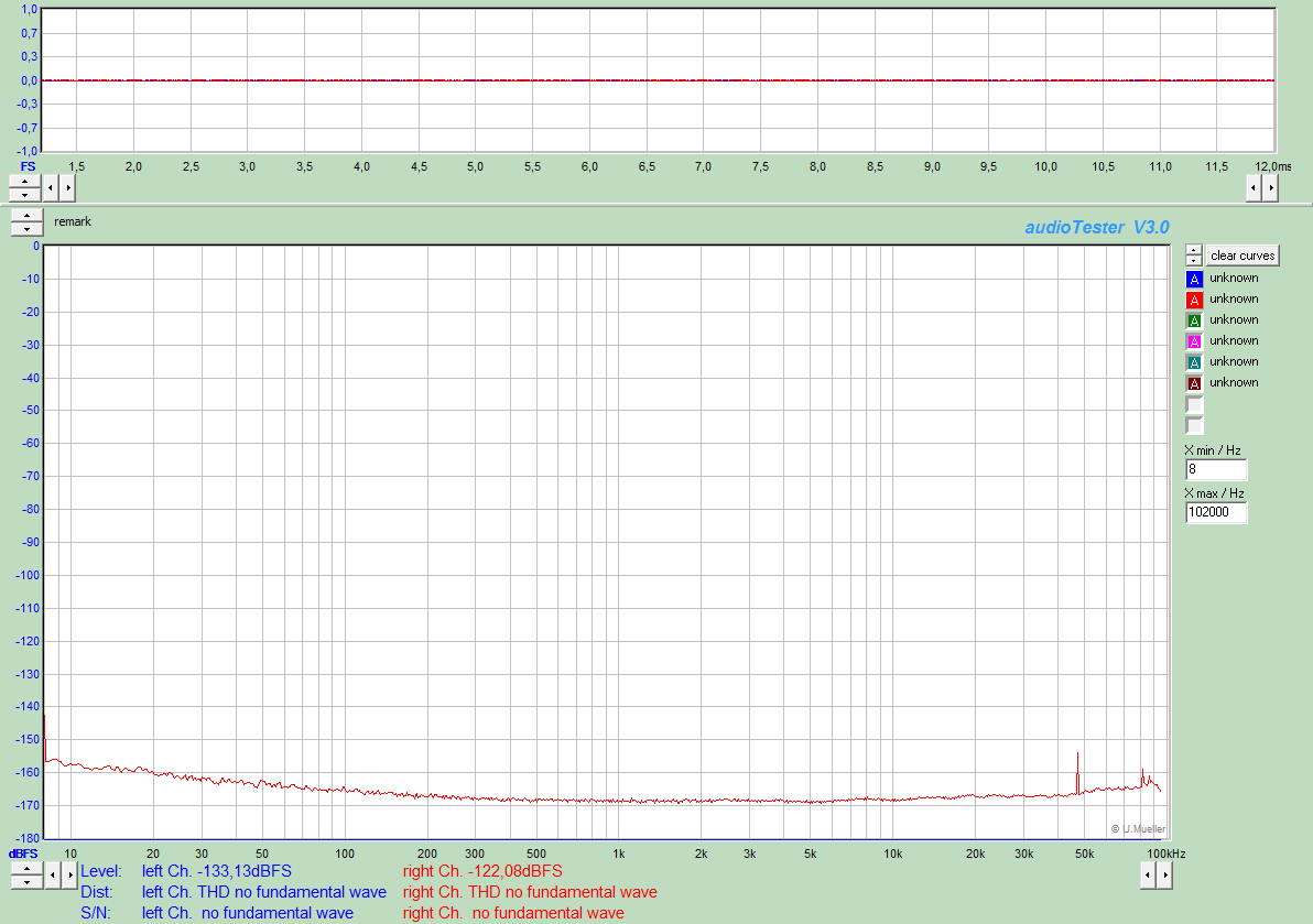

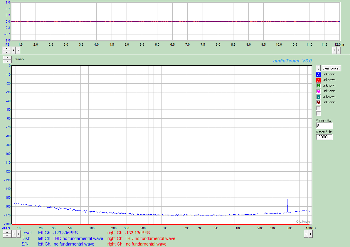

Two of the attached screen dumps show the noise floor at 192 kHz sampling.
The measurements were done at the 0dB input setting. This means a direct input, no attenuation and no additional gain, max input around 3Vrms.
There is a small noise peak at probably 48kHz on both channels. The right channel is slightly noisier than the left channel. There are also a couple of noise peaks between 80 and 90 kHz on the right channel.
But there doesn't seem to be any discrete noise frequencies apart from these. And there is still no shield/box around the PCB.

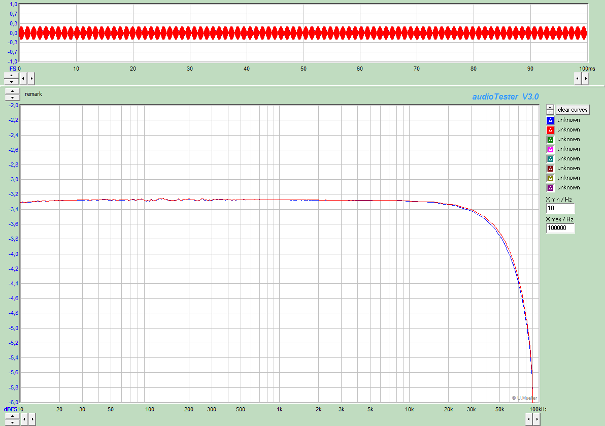

I have also measured the frequency response at 192 kHz sampling.
The attached figure shows the loop back response. It does drop a bit at high frequencies. This is primarily due to the generator. So I need to fine tune the filters on the outputs.
Measured separately the input side drops by 0.1 dB at 80 kHz and 0.3 dB at 90 kHz.
Hi Jens,
This looks very good. It's very impressive that this is just a bare PCB on the table and it is so clean.

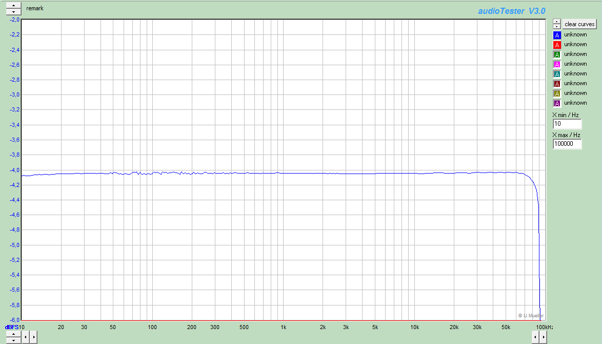

I have modified the post-DAC filter to improve the frequency response at the top. I also changed the gain a little, so that I now have a maximum level of 20Vrms balanced and 10Vrms single ended.
The attachment below shows the loop-back frequency response of the modified channel.
