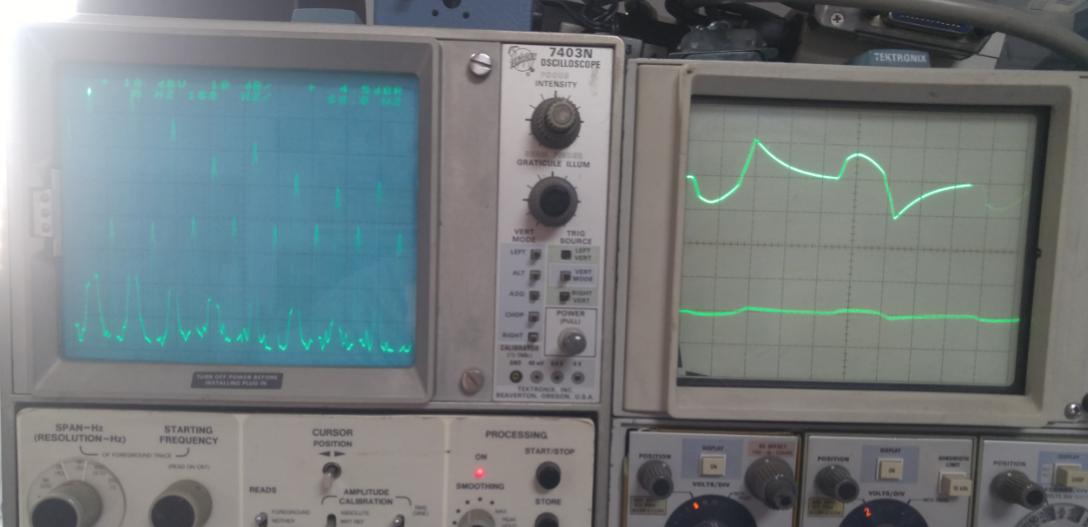

I wonder if the software scope function have capability to adjust sync timing adjustment like on the analog scope. Any scaling to lower level is great. I would assume we want to have scope functions that not only include the benefits of analog scopes, but also add the benefits of digital processing as well.
Sent from my iPhone using Tapatalk

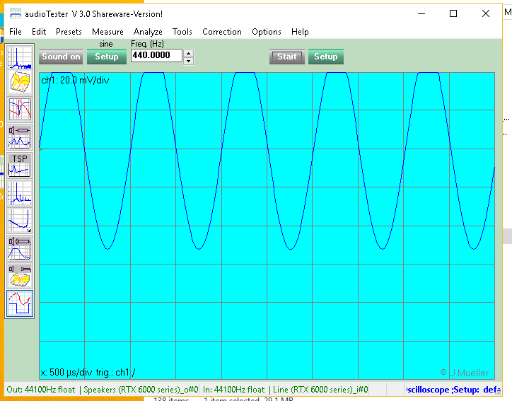

I think all my scopes are real old analog. I assume that CRT based scopes are analog. I don't use software scope often, only sometimes on SoundEasy. What I would like to find out is how digital scopes will sync with the input, especially when looking at low level signals. On the analog scope, you have to manually adjust the sync to get the signal to stand still, this is kind of tricky when you have a mixture of signals.
A 24 bit scope is meaningless for waveforms. your display has maybe 12 bits of vertical resolution if its a 4K X 2K display. There really is nothing to see in the time domain. However in the frequency domain there is lots to see if the vertical is log (dB).

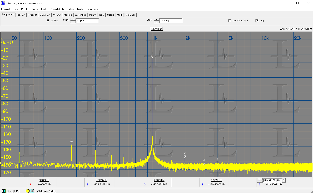

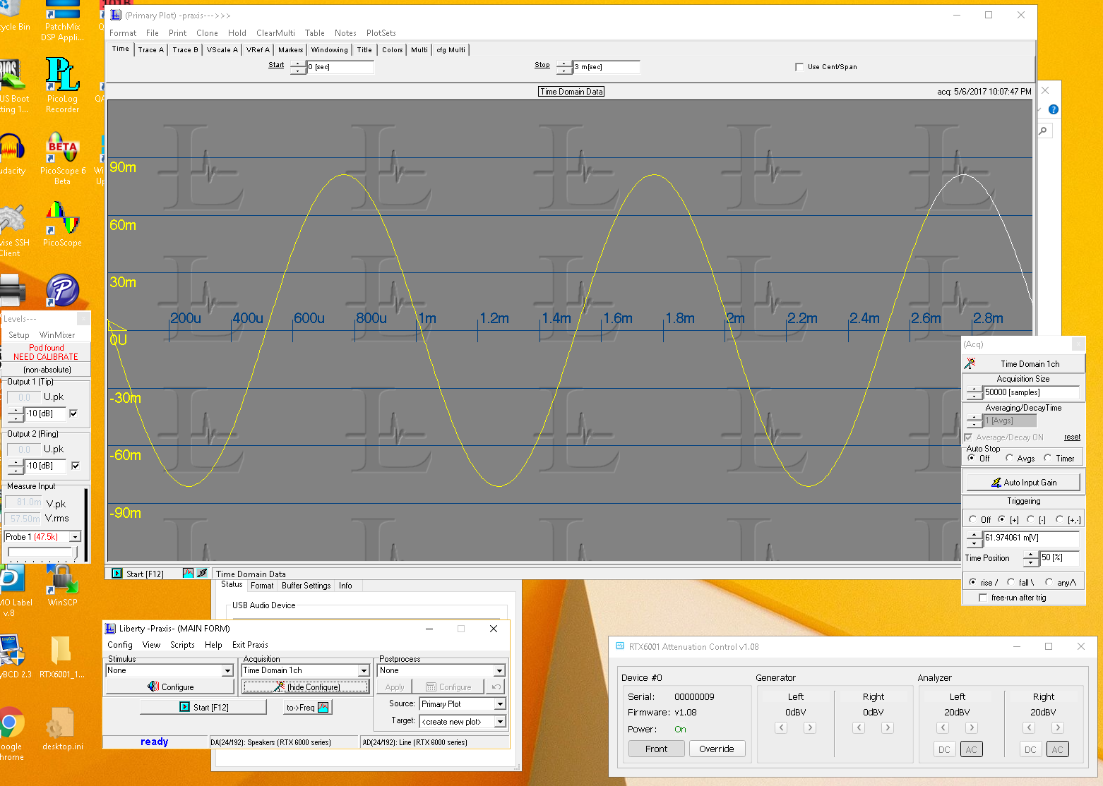

Three pictures below. First Audiotester scope. I still have a lot to learn to get around Audiotester's controls so I switched to Praxis scope. You can see the trigger options. Not as sophisticated as a real scope today but good enough. The waveform is flawless and you can't see evidence of the hum in the image. Third image is the spectrum of the same source (Victor oscillator on batteries directly to the differential input with a separate ground connection to the chassis). Here you can see the hum and the hint of harmonic at HD2 (-131 dB) and the hum at -113 dB. The hum is probably the unshielded cable between the oscillator and the XLR input combined with the 600 Ohm source impedance of the Victor. Its too late tonight to work up a better interface scheme. in the past i have put the whole oscillator package (in a cast aluminum box) inside a second isolated metal box acting as a shield. Its really clumsy and I need to find a better box than an old Zero suitcase.

Well, it wouldn't of course. I was just speculating that certain sources of internal crosstalk may couple in a way that would be suppressed, and other sources may not be.
Anyway, there is perhaps a more straight forward explanation.
It could be that the hum seen at the odd harmonics are a result of nonlinear functions, e.g. the characteristics of the rectifier diodes in the power supply. This will lead to pulse currents during the charging of the large capacitors of the power supply.

I just made a spectrum of a 50 Hz triangle signal. Not quite the same signal as the charge pulse currents, but it was easy to generate with audioTester. This also shows a lot of odd harmonics content and no even harmonics.
The exact source(s) and coupling mechanism(s) are still not investigated, but I think that the levels are low enough for all practical purposes.
Jens, a symmetrical wave like a triangle can be expected to show odd harmonics only. A good approximation of the waveform at the output of a rectifier is a sawtooth shape with the falling part about 80% of the total. If you look at such a wave you do see a mix of odds and evens. The proportion depends among other things of the 'rounding' of the sawtooth 'teeth' which again depends on the rectifier-reservoir caps values and current drawn.

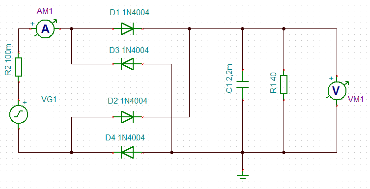

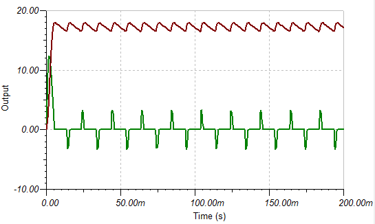

If you look at the current in the transformer, it looks pretty much like the figure 6 that i referred to in the previous post.
I just made a simulation of a rectifier circuit as shown attached. The brown curve is the output voltage, the green curve in the current in the generator (transformer).
The peak voltage of the sine generator is 20V in the simulation.

I agree that the scope function can be used for trouble shooting. If no oscilloscope is available, it can be used to show e.g. clipping or nonlinearity, which could be caused by e.g. a low supply voltage or incorrect DC bias voltages.
I haven't really used the scope function in audioTester, only briefly checked it, since I have an oscilloscope and prefer to use that. It is of course much better for showing instability at high frequencies (MHz), which the Audio Analyzer would not be able to measure.

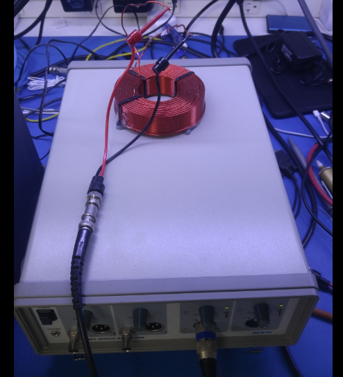

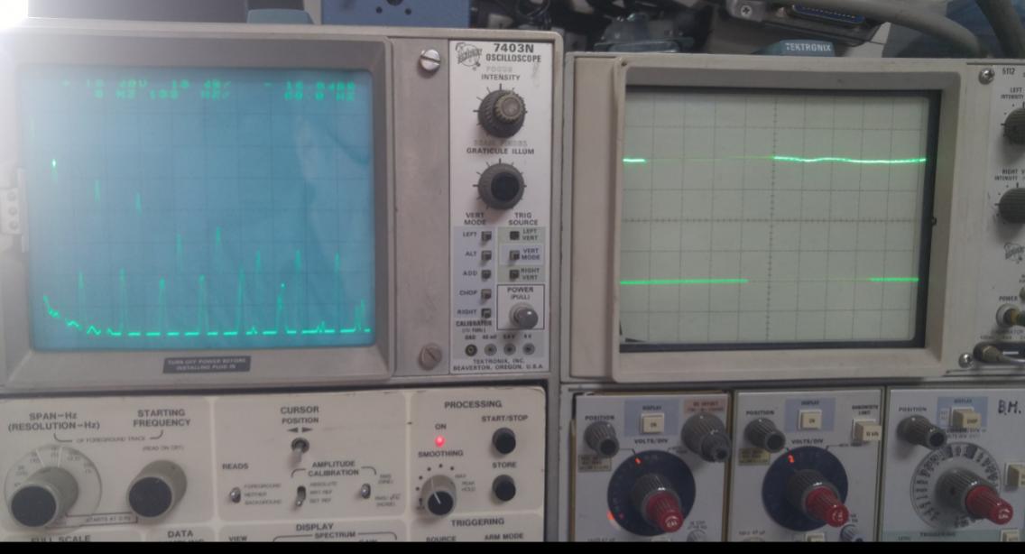

FWIW here is the filed from the supply in the RTX. First is an improvised pickup (old air core crossover part) second is the field with the coil located as in the picture and third is with it a good distance away. Sorry about the glare from the window but you can still see the spectrum of the supply with its odd harmonic mix.
I have no idea of the strength of the field. I can't find any of my calibrated probes.

I'm hard pressed to come up with a mechanism where even order harmonics are suppressed independent of frequency.
