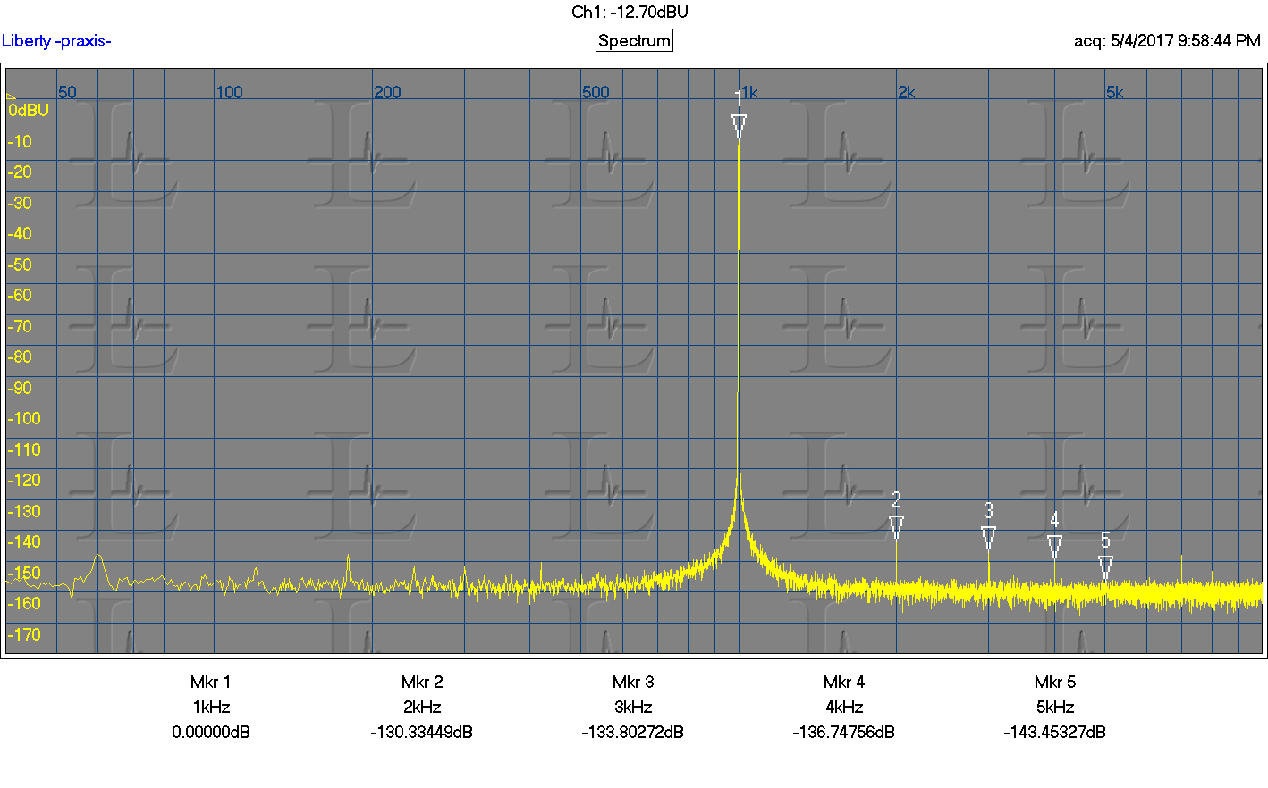

Here are two plots from the RTX using my KH4400a as a source. It has pretty uniform harmonics as you can see. As the harmonics of the source get close to the internal harmonics of the analyzer you do get additions and cancellations. My guess is that below around -125 dB you should be less confident of the absolute level of the harmonics.

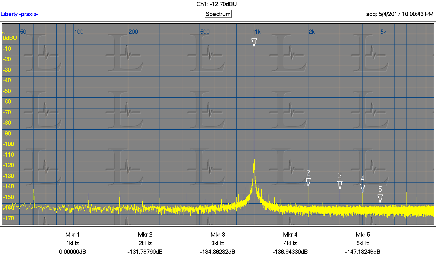

The second plot was a much higher (4X) resolution than the first plot so you can see deeper into the noise and more of the power line harmonics are visible.

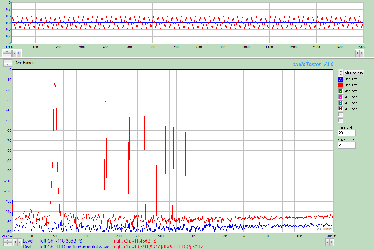

Anyway, there is perhaps a more straight forward explanation.
It could be that the hum seen at the odd harmonics are a result of nonlinear functions, e.g. the characteristics of the rectifier diodes in the power supply. This will lead to pulse currents during the charging of the large capacitors of the power supply.
In principle similar to figure 6 here:
http://www.edn.com/Home/PrintView?contentItemId=4422710
I just made a spectrum of a 50 Hz triangle signal. Not quite the same signal as the charge pulse currents, but it was easy to generate with audioTester. This also shows a lot of odd harmonics content and no even harmonics.
The exact source(s) and coupling mechanism(s) are still not investigated, but I think that the levels are low enough for all practical purposes.
