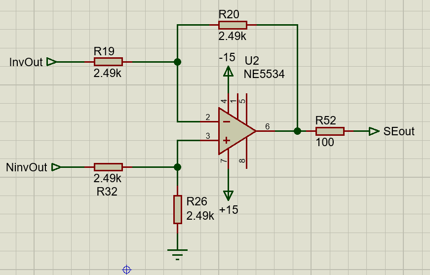

I remember, but can't find it back, a post by JensH where he stated that the SE output is formed from one of the balanced output phases and Gnd, and that therefor the SE output was half of the BAL output.
It triggered me at the time but then I forgot about it until something triggerred me again.
My point is that this method degrades the SE output S/N ratio. A better way is to form the SE output from taking the difference between the two BAL output phases as the SE output, and not the difference between only one phase and Gnd. This also has the advantage that the BAL and SE outputs are equal. See attached for a possible way.
Of course, at the end he always need to get Gnd involved in a SE output but this is a bit cleaner; a fully diff amplifier would be ideal.
And the Gnd connection of the SE output connector should be directly connected to the Gnd of that input resistor (which in turn should be directly connected to whatever the signal Gnd is).

The circuit you have shown is very similar to the output that I use, except that I use an LME49990 with an LME49600 buffer instead of the NE5534. And the output resistor is 50 ohm in my case.
The balanced input to the circuit is taken from the balanced output of the post-DAC filter.
This is how the SE output is made.
And the balanced output is just two of these circuits with the inputs swapped on one of them, to get the opposite polarity.
In terms of S/N ratio I don't think that you loose anything. The noise is dominated by the DAC/post-DAC filter, not the output amplifier. On the balanced output you get twice the output signal, but also twice the noise.

OK, thanks for the clarification. From the remembered post I understood it differently but that may have been me.
