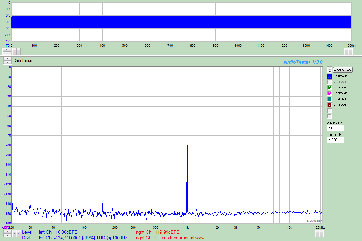

I am not quite sure what levels Demian used for the loopback measurement. It doesn't look like 1V to me. The level is measured at -2.1dBFS. If the level was 1V I would expect the measured level to be -10dBFS at the 10dBV input setting (or 0dBFS at the 0dBV setting).
I have attached a measurement, where I have an output of 1V (verified with my HP 34401A). The input is set to the 10dBV range, so the level measured is -10dBFS.
In this case I measure a loopback distortion of -124.7dB.
It is generally a good idea to use levels well below 0dBFS when measuring distortion (THD), because the distortion of the ADC (AK5394A) does increase when approaching full scale.
You refer to the Analyzer residual THD @1kHz, which would be "typical -130 dB, < -120 dB @ 0 dBV"
This is not the loopback figure, but the analyzer (input) only.

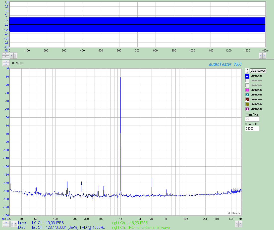

I have attached another measurement, where I used a low distortion oscillator with balanced output to drive the analyzer input. In this case I do see a distortion of around -130dB at a level of 1V.

  • 1kHz distortion_1V out_-19.72dBFS to AK4490_48ksps_input 3V range_512k FFT_average over 5_Right_.png
  • 1kHz distortion_Low Dist osc_input 10V range_1M FFT_average over 5_Left_Prototype no13_170424.png
Good point! It is easy (for me anyway) to forget that in loopback the total distortion is the distortion of the analyzer plus the distortion of the generator. Hence Victor oscillators. 🙂

It appears that the first plot in 1audio’s post #990 is much more telling. It better represents how this instrument will be applied. The only thing missing is the DUT placed between the function generator and the input.
We are not going to apply this instrument with its input only or with some high quality standalone oscillator. I am concerned about the presence of the 60hz power supply hum and resulting series of distortion frequencies in the loopback configuration. The 2Khz and 3Khz spikes are very much like those seen in the AP or Keysight U8903B analyzers.
JensH, please show us an audio Tester loopback with a -10dBV signal applied.
DT
Here is a loopback measurement with an output of -10dBV.
Output attenuator set to 0dBV range
Input attenuator set to 0dBV range
Output to DAC = -10dBFS
48 kHz sample rate
The settings in the loopback plot in post #1005 were:
Output attenuator set to 20dBV range
Input attenuator set to 10dBV range
Output to DAC = -20dBFS
192 kHz sample rate (does not make much difference)
Changing from -20dBFS in the previous plot to -10dBFS increases the distortion of the DAC.
The 50/60 Hz hum can be a challlenge, especially when using unbalanced connections. Using the balanced inputs and proper cables will normally keep the noise at an acceptable level.
I agree that using a very low distortion standalone oscillator should not be necessary in most cases. In this case it was used to separate the issues, so that only the distortion of the analyzer was measured. With a loopback connection, and no other reference, you don't know if the distortion you see is caused by the generator or the analyzer.
Using a 1kHz notch filter I recently measured the distortion of the "Low Distortion Oscillator" to be well below the limits of the analyzer input/ADC.
