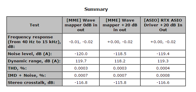

I did a set of RMAA loopback tests at 192-24. The levels are all very close to clipping so not the best possible performance. I generated an HTML report but don't know how to share it here.
The 60 Hz noise is lower in the +20 dB in/out. Its really low in any case.
Here is a summary at least:
