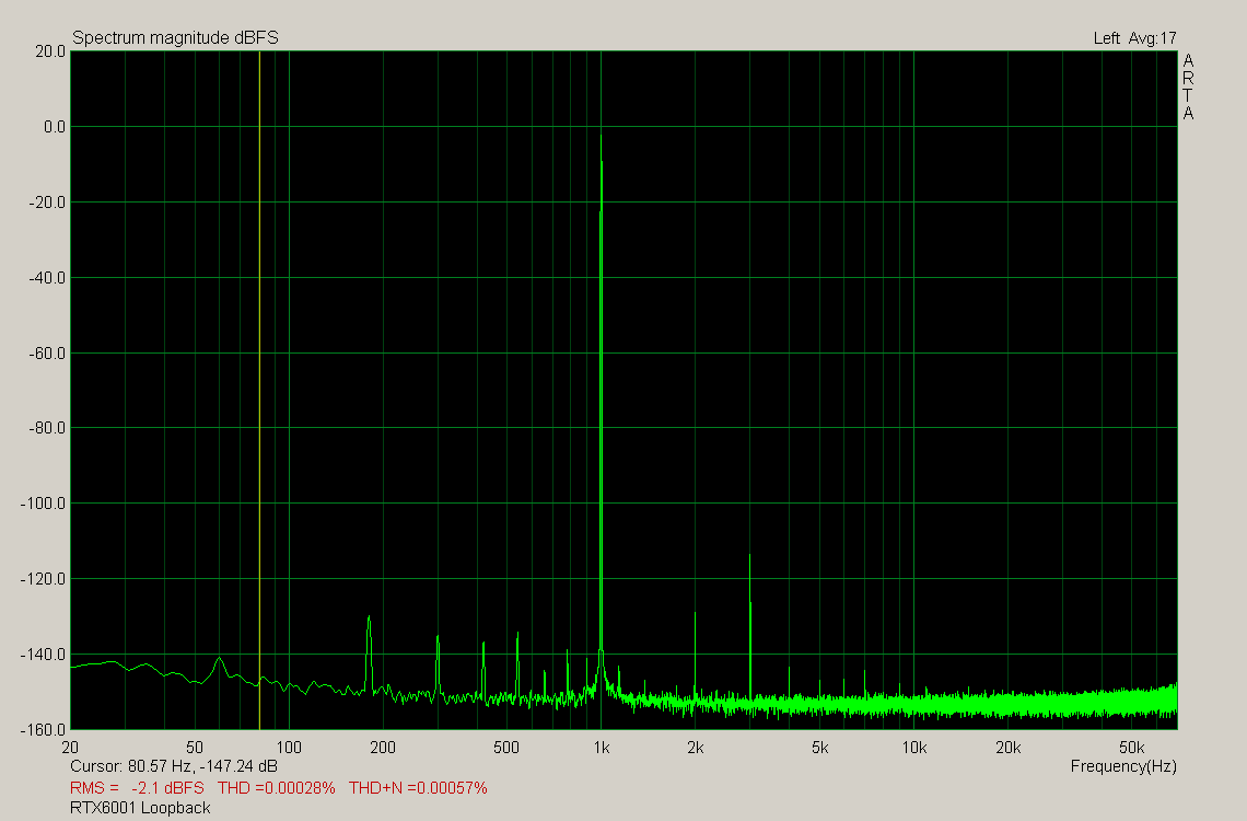

Here are a few measurements from the RTX6001:
First is loopback at 1V

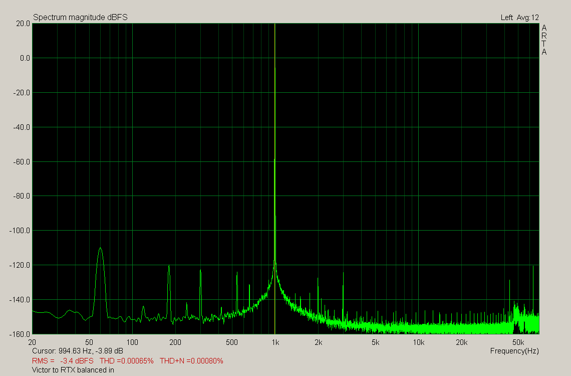

Second is Victors oscillator to RTX balanced with the oscillator floating (and some 60 Hz common mode)

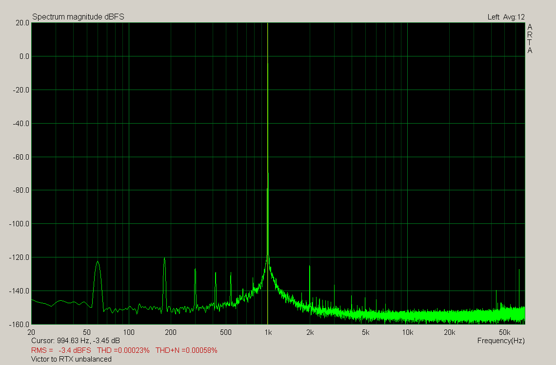

Third is Victor oscillator with the ground tied to the ground reference at the XLR connector

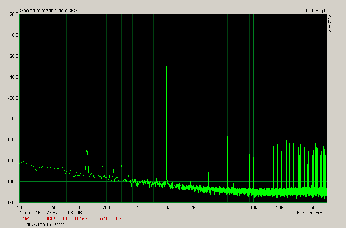

Forth is an HP 467 power amp driving about 10V into 16 Ohms. This amp was made in the mid 1960's and has a power bandwidth of 1 MHz. Its an example of what you might actually be measuring in terms of less than perfect.

Demian,
Thanks for doing the measurement with the Victor Generator.
The THD+N is about 102 dB typical with -3 dBFS input at 1 kHz?
Could you repeat the measurement with 0 dBFS and with higher frequencies (20 kHz) ?
