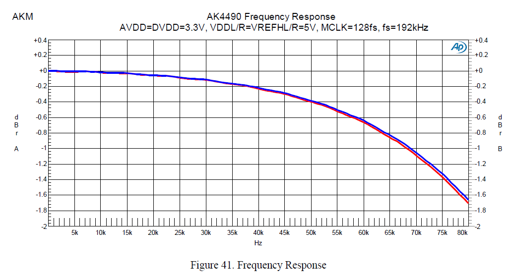

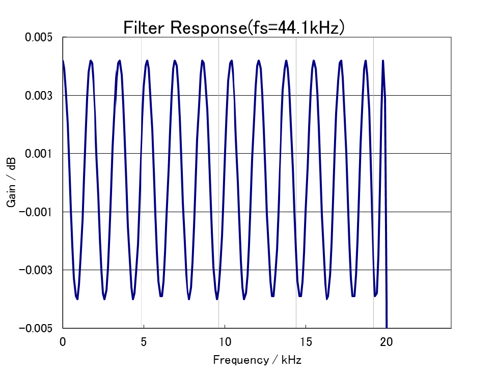

I studied the AK4490 evaluation board in greater detail in the meantime.
My understanding is, that there are two filters inside the chip:
1. the digital antialiasing filter with typical +-0.005 dB ripple in the passband
(first picture)
2. a switched capacitor analog filter to suppress the aliased frequencies.
This filter gives an error of typical 1.8 dB or 23% at 80kHz
(second picture).
I do not want to criticize Jens work.
I want to understand and discuss the limitations and maybe
find ways to improve it 🙂

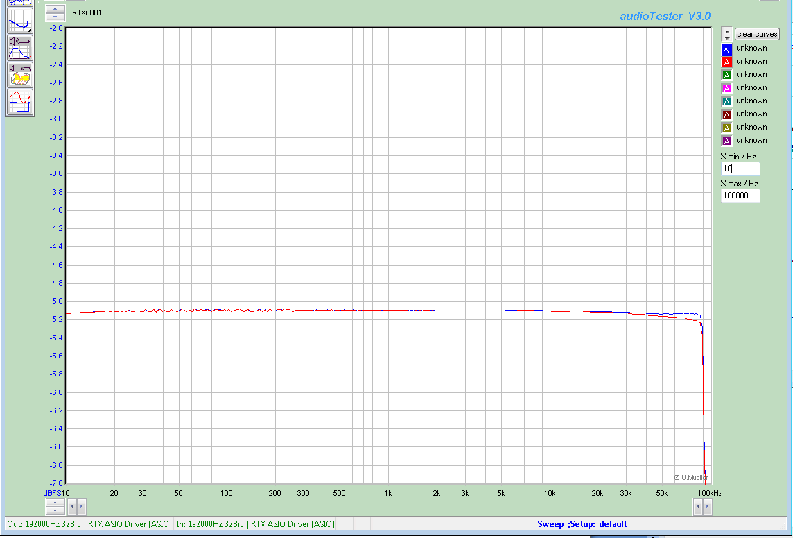

I do compensate, at least partially, the level drop at high frequencies. I just made a loop back measurement at 192 kHz sample rate on an arbitrary unit, see attached.
One channel is almost flat up to above 80 kHz, the other channel drops a bit.
(first picture)
(second picture).

The combination of filters is normal practice for delta Sigma DACs (and ADC's). The 80 KHz filter tracks the sample rate. If you look at the pre filter output its pretty clean up to the first image which is pretty high up. I use an LC filter on some of my implementations around the AK4490 which also works well.
In this application (which is measurement) flat response would be the important criterion. The AK4490 allows for the use of an external filter but its unlikely that an external filter would work any better. However the 44.1 KHz clocks may have lower distortion than 48 KHz clocks per AKM due to some optimized internal timing. There are several compromises involved to get this combination to give good results and usually response above 20 KHz is not at the top of the list. However an application with self calibration capabilities can correct for these errors in measurement. Praxis PRAXIS INFORMATION is a good example. I believe there are others.
I really do not understand what you are saying about measuring noise with an FFT? And I can assure you that your laptop does not have a distortion of -140 dB at 100 mV. Distortion products do not by definition go to zero as the level goes down. In DAC's and ADC's they go up as the available bits decrease and the accuracy of the bits becomes a bigger part of the total. Even completely linear devices like opamps can show higher distortion for whatever reason at lower levels.
This is extremely good! I know from experience that it is not easy to get better than 0.1dB flatness over a large band.
Jan

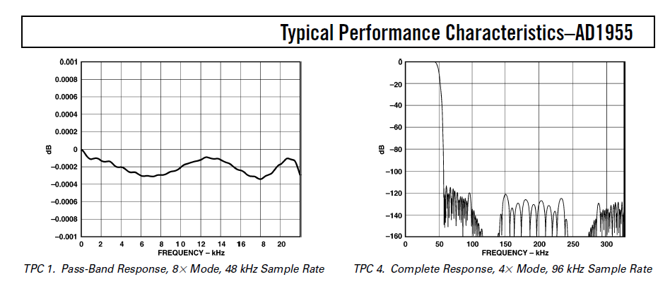

I aim for a sine generator with a precise absolute level
and flatness over the extended audio band up to 100kHz
(for non audio measurements).
My goal was to get more than 0.1% absolute precision.
To my suprise this it is very difficult as not to say impossible.
I was also surprised to see that the the State of the Art is
not going forward (see attached AD1955 ripple from 18 years ago).
Only marketing improves.
The new Cirrus Logic DAC too seems to target Smartphones
and has no more precision than the older designs too.
@Demian:
How is it possible to switch off the SC post-filter?
This could be a workaround for the 2 dB droop @80 kHz.

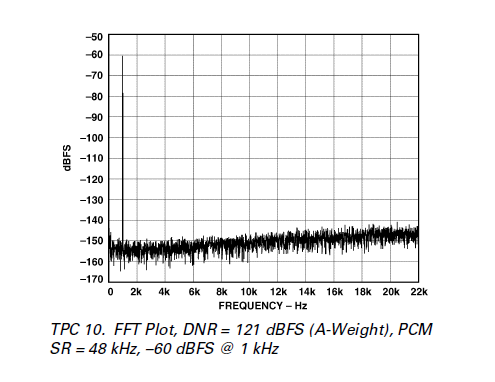

To prove my point:
Attached is a picture from the AD1955 data sheet,
where the harmonics are clearly below 150 dB, measured with
a very low input signal of -60dBFS.
Maybe this is getting somewhat offtopic 🙂
Best wishes,
Udo
Hello Udo,
Where you are wrong is that you refer the THD level to the full scale.
On the spectrum you show, the signal level is -60dBFS and the noise floor about -150dBFS.
SO, you can only say that the THD harmonic are only below -150-60 = -90 dBc !
It is not spectacular !
The dBc amplitude is here referred to the signal amplitude (-60dBFS) not the full scale.
You can also look at the THD math definition that is the ratio of harmonics power
vs input signal.
Hope that is more clear.
Regards.
Frex
