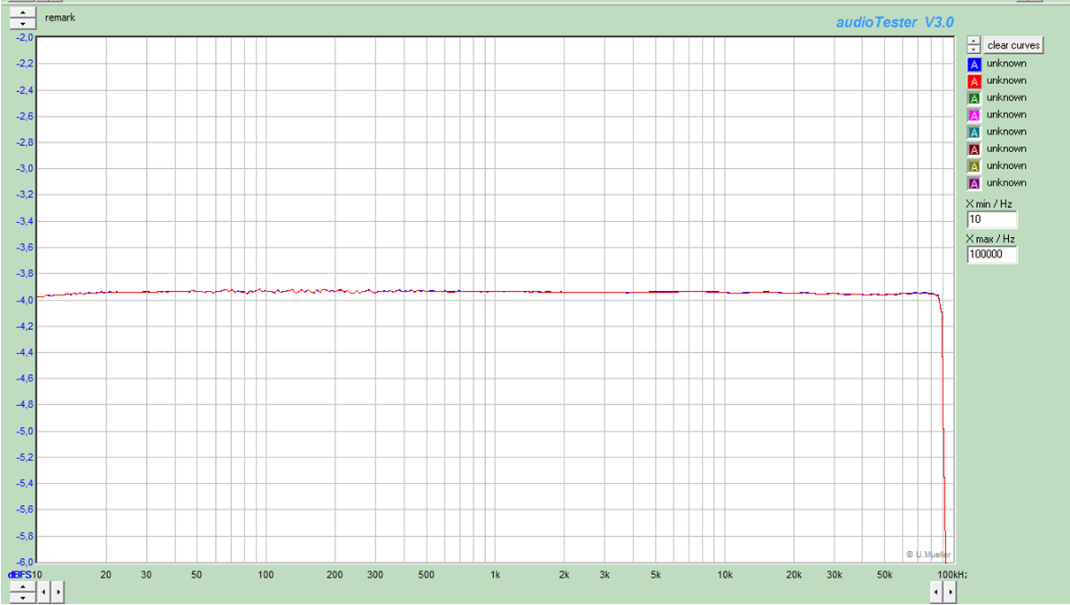

Here is a loop-back frequency response of the Audio Analyzer measured at 192 kHz. Some units have a slight deviation at the top, in the order of 0.1 dB, probably due to component tolerances in the filters.

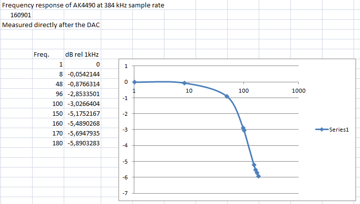

Today I got a new firmware for the XMOS USB Interface, which includes support for 384 kHz sample rate.
This gave me a possibility to measure the frequency response of the AK4490 DAC. I generated some files in Audacity with tones ranging from 1 kHz to 180 kHz. I also tried to enter 192 kHz, but the output contained all zeroes🙂
I measured the output directly from the DAC using an oscilloscope. The results are shown in the attached screen dump.
It doesn't drop quite as much as I expected, but it is far from being flat.
The ADC was removed from the unit during these measurements since the AK5394A does not support the 384 kHz sample rate.

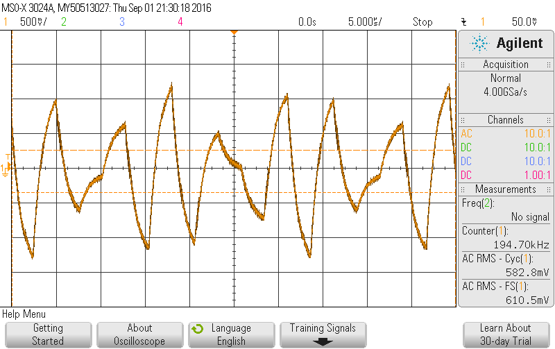

I have also included an oscilloscope screen dump of the output at 160 kHz. There is definitely some work to do for the reconstruction filter😱
