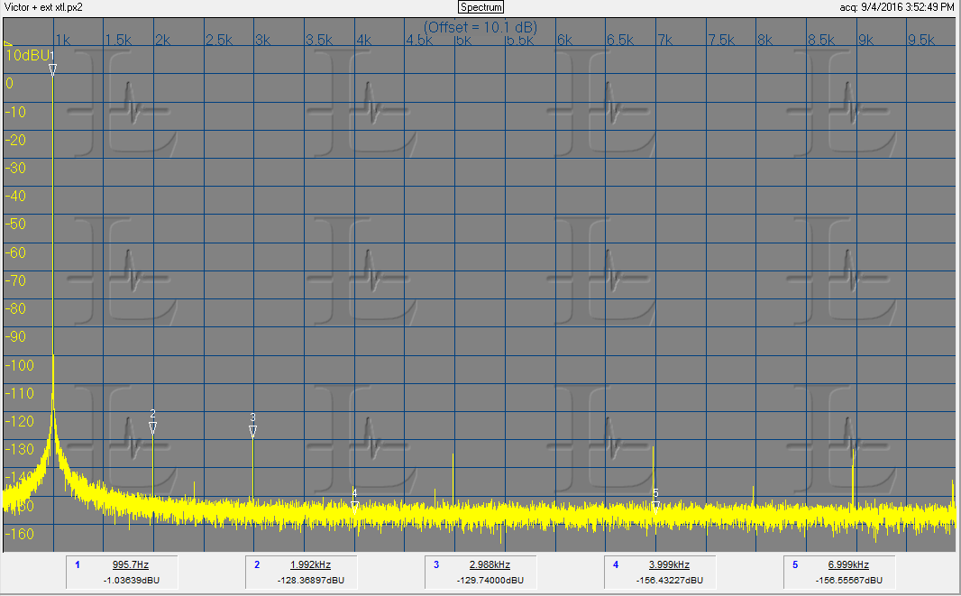

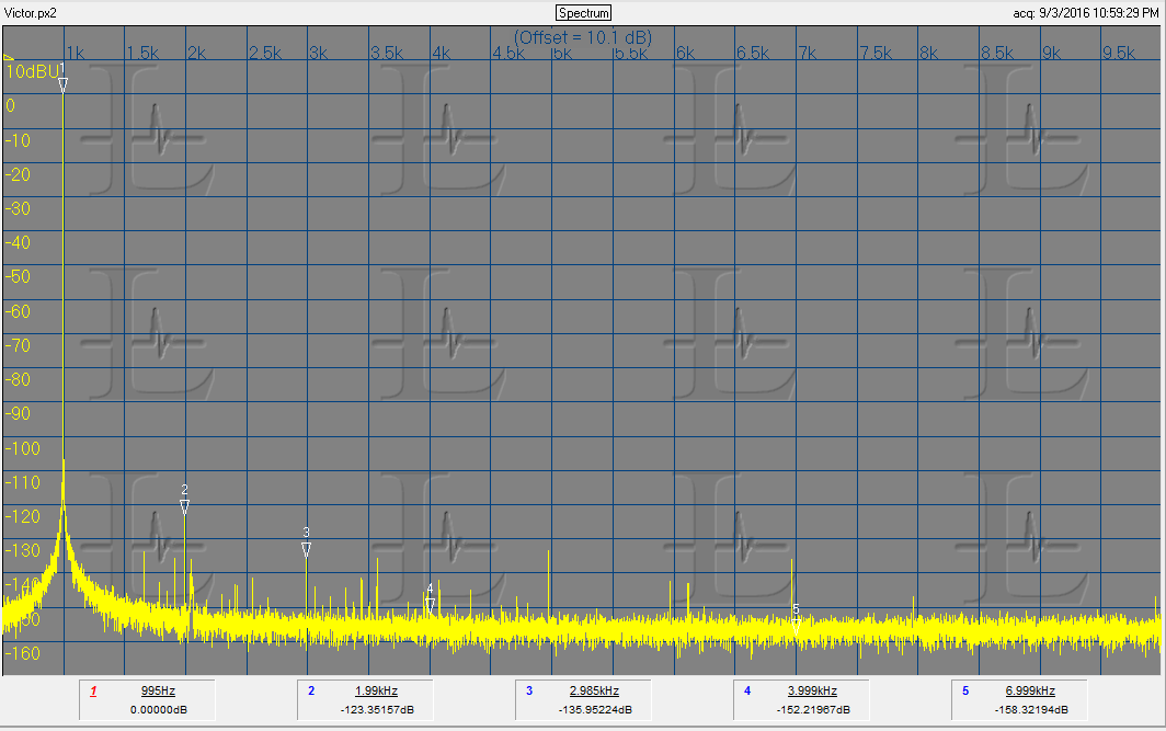

AK5394A performance potential
I was making some measurements with an EMU 1616M and noticed that I was getting the same distortion with different sources and then checked with my reference Victor oscillator and still ran into the -112 dB 2nd and 3rd harmonics.
This prompted me to pull out my highly tweaked demo board. The harmonics are much lower. It also gave a chance to show what grunge can come from a master clock with issues.
The difference between the two plots is adding back in an external crystal oscillator injection locking the gate oscillator on the PCB. The difference in the noise floor is dramatic. (At least if you are this deep into this stuff.)
With effort Jen's board should be pretty close and far more flexible.
