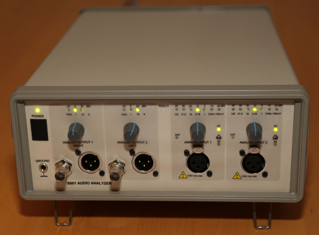

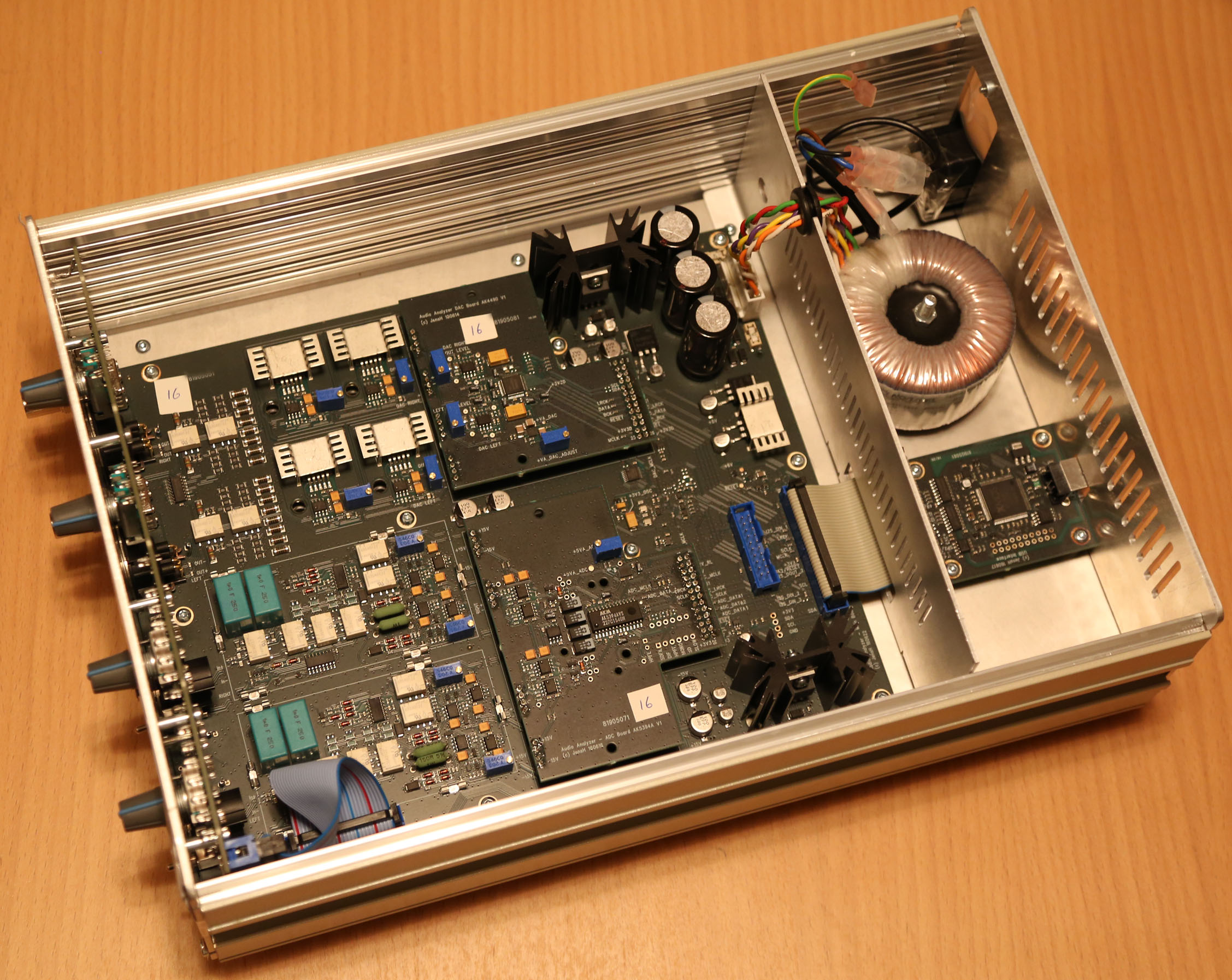

Here are a couple of pictures of the first prototype in an enclosure.
The front foil is still not in the right material. It was made to get an impression of what it would look like, to find out if anything needs to be changed. There will be some minor changes like font-size and a couple of other things.
The LED indicators will be improved to avoid light-bleed from one LED to the next one.
I still haven't got the right mains switch, so another one was used here until I get the proper one.
For my personal taste, the main switch could/should be at the back side to avoid power cable radiation into the box, while we deal here with uV or lower voltage. May also an additional main filter is a choice.
May also made clear enough for tube gear tester: The maximal allowed DC!
An other question: Where are the master crystal clocks located. In case some would like to have a better master clock with lower phase noise.
just my 2 cents
Hp
The mains switch IS at the back side. But the control is from the front. So no mains cables are going through the compartment with the generator and analyzer.
I would like to avoid using a mains filter, because typically they couple a lot of noise from the mains into the chassis and this can cause additional noise issues.
At the moment I use 250 V DC capacitors on the inputs (Polypropylene).
