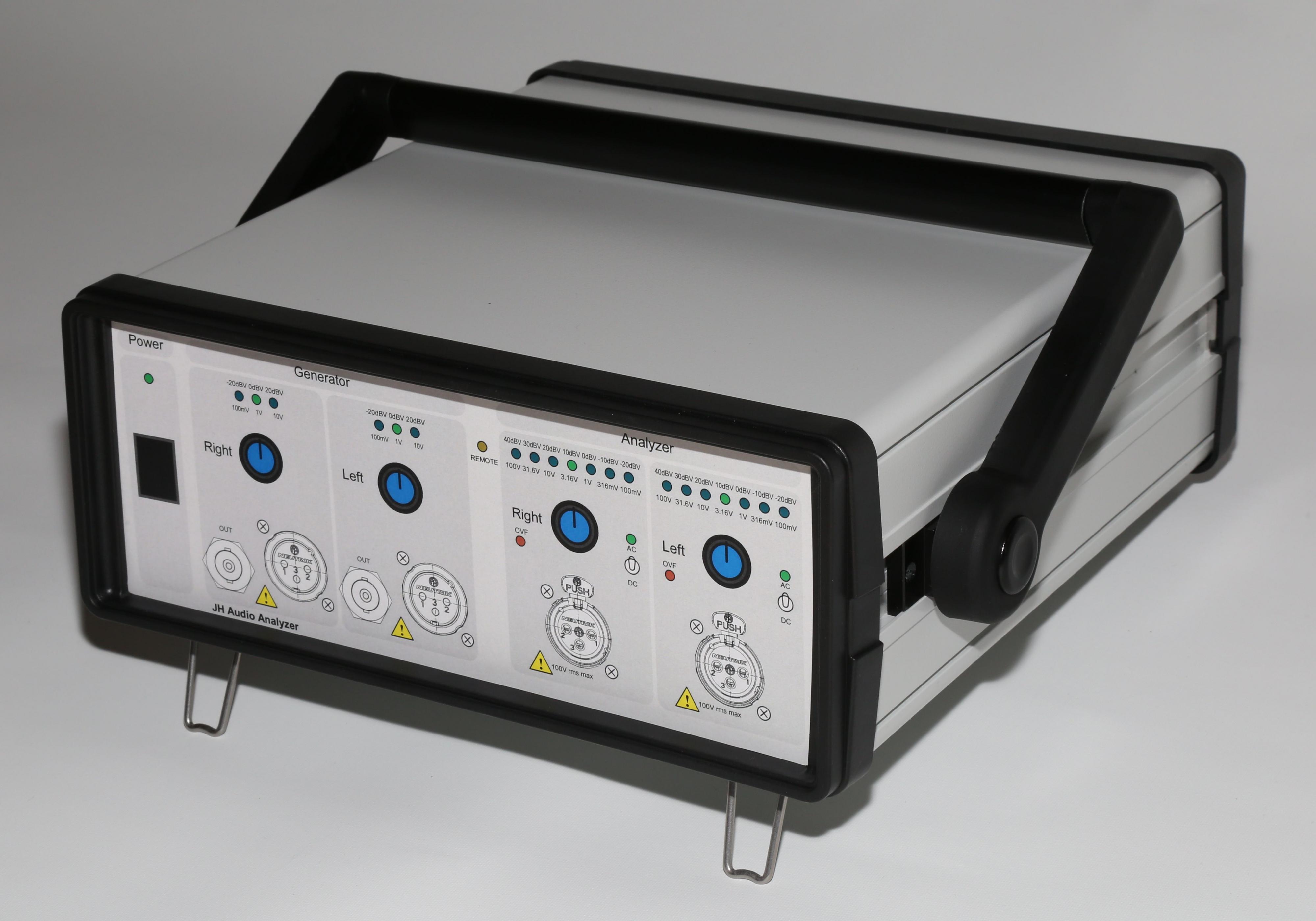

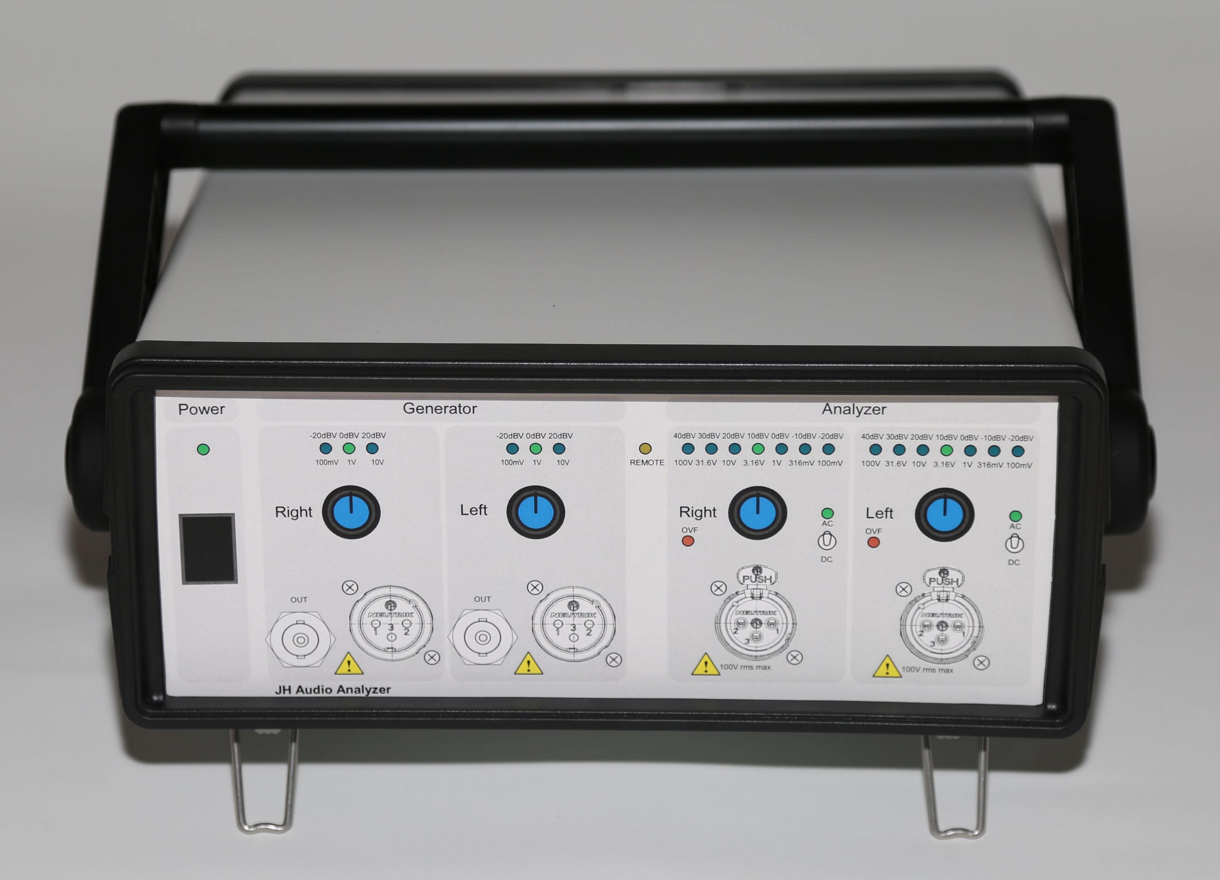

Just a quick status update.
The development of the electronics (5 boards) has been finalized. I just need to update a few components in the library. Next step is to hand it over to procurement and manufacturing to run a pilot series. Getting all the parts and setting up the assembly will take some weeks. The exact schedule is not known at the moment.
I have also worked on the mechanical design, selecting a suitable enclosure, making sure that the internal placement of boards, transformer, mains switch etc. is OK.
I have attached a couple of pictures showing approximately what it is expected to look like. The front panel is just a drawing at this point, but I hope it will give you an impression of what it will look like when finished.
The handle is optional.
The feet, including the two tilted ones, I expect to be standard.
The enclosure will be a bit deeper than the one shown in the pictures. It will be extended by 90mm compared to the one shown.
JensH

Hi Jens,
That's ok. Looking forward to see the result of the pilot series. So far it look very good.
Mogens

Jens, what is the meaning of the warning symbols on the outputs?
Gesendet von meinem D5803 mit Tapatalk
The warning symbols may not be needed in the final version. The intention is that you should not put a DC voltage on the output. This may destroy some of the resistors in the output stage, which is DC-coupled.

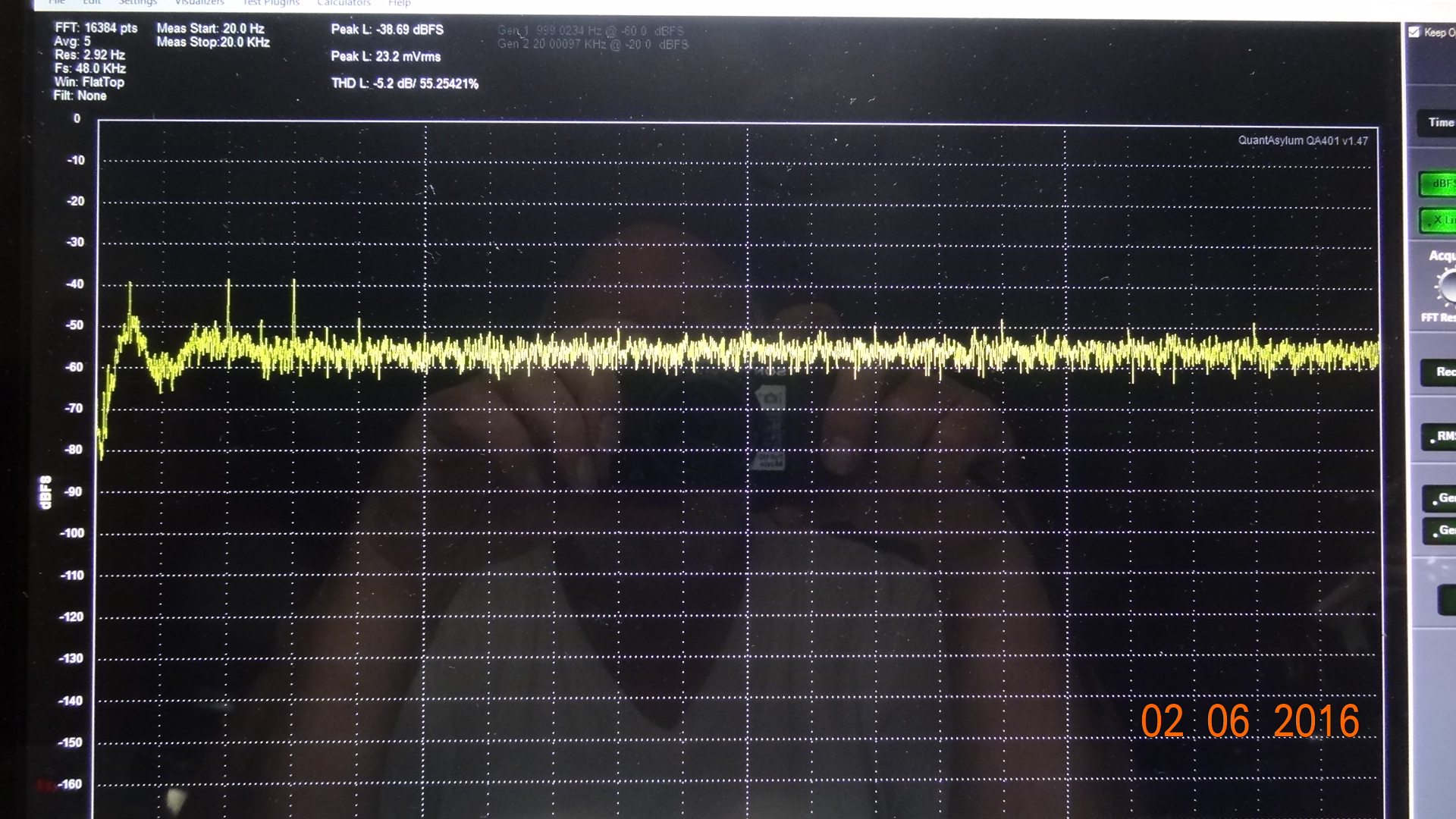

For a simple point of reference using industrial models; The ShibaSoku 725D's distortion residue monitor output into a QA401 (AG16B source being used) looks like this:
The 725D can directly measure harmonics to -130dB; The Panasonic VP2277A can directly measure to -140dBv. Then from thier monitor outputs into QA401/FFT can get to -150dB, with high accuracy (<1/2db).. The AP2722 indicates exactly the same measured values at these ultra-low levels.
THx-RNMarsh

I mean the amp output to xlr into analyzer as shown in the picture (assuming picture is accurate)
Hi 2 picoDumbs,
Same with the XLR connectors. You just have to be careful you don't exceed the maximum voltage in. You would normally be monitoring across some load resistors as well.
-Chris
-Chris
Hi 2 picoDumbs,
I don't expect test leads to be part of the delivery. There will be different needs depending on the test setup.
You can definitely cut a standard cable and mount e.g. banana/alligator clips if that is what you need.
If you have a single ended amp output you may still benefit from the differential input since it can eliminate the ground currents.
Take a look at this page for information about System Interconnects.
Sound System Interconnection
If you use something similar to fig. 13 you still need to make sure that you connect the ground of the analyzer to the ground of the amplifier. Otherwise the common mode signal (mains hum and DC offset) may get outside what the analyzer can handle.

Yes, a dedicated terminal can be useful in some situations. I will definitely consider adding that.
I'm assuming the xlr plug into the audio analyzer section is used for testing both balanced and single ended signals.
Does the instrument need to know what sort of signal is being tested from the output of the amp or does it automatically recognise what type of signal is being fed into the analyzer?
