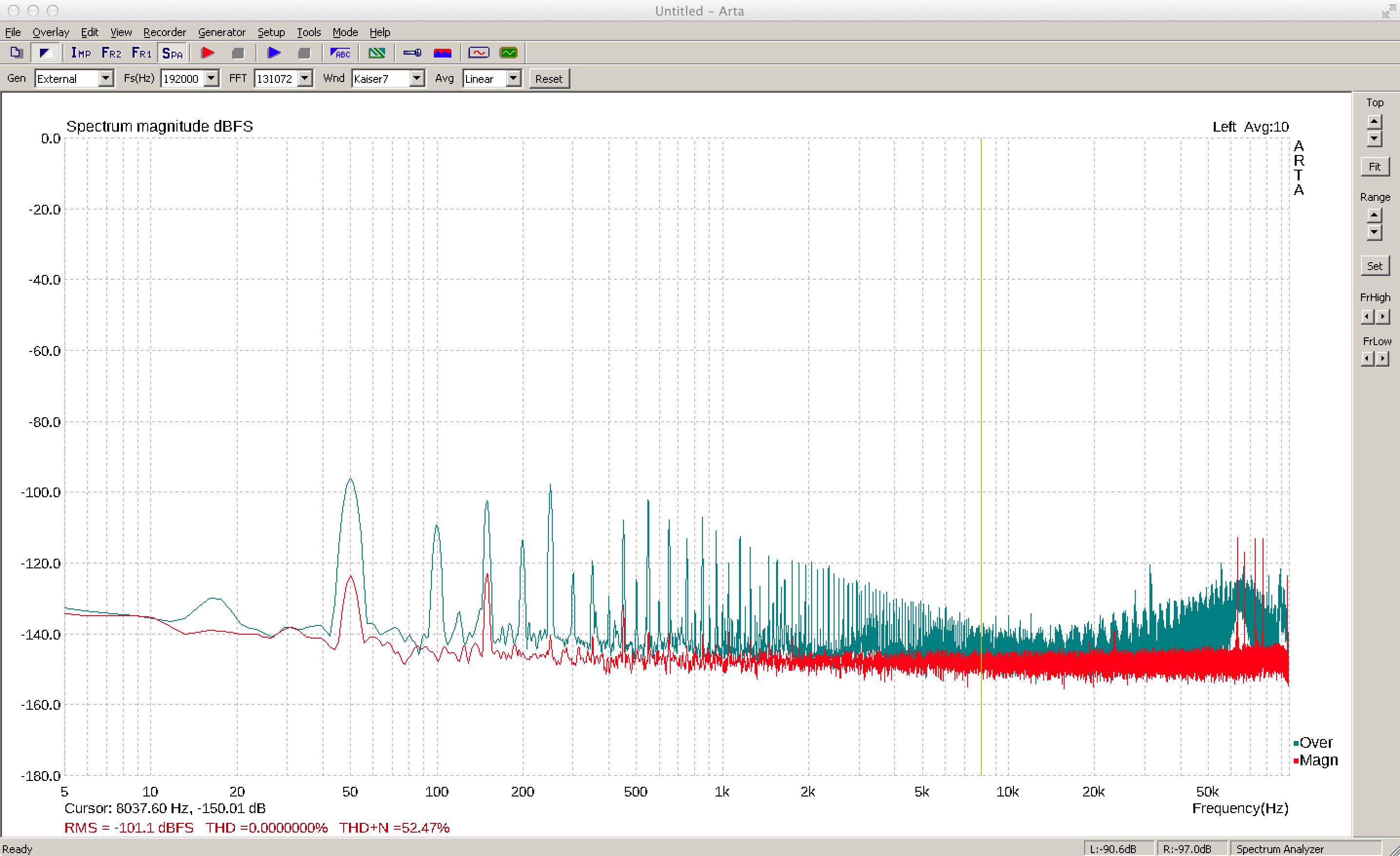

Again annoyed by the 50Hz power-line induced artefacts in unballanced measurements using a BNC-XLR adapter (or even, to a little extend, with the recommend "no.xx" cable layout) I decided to test what would happen when the RTX is supplied with power that has "no" 50Hz content.

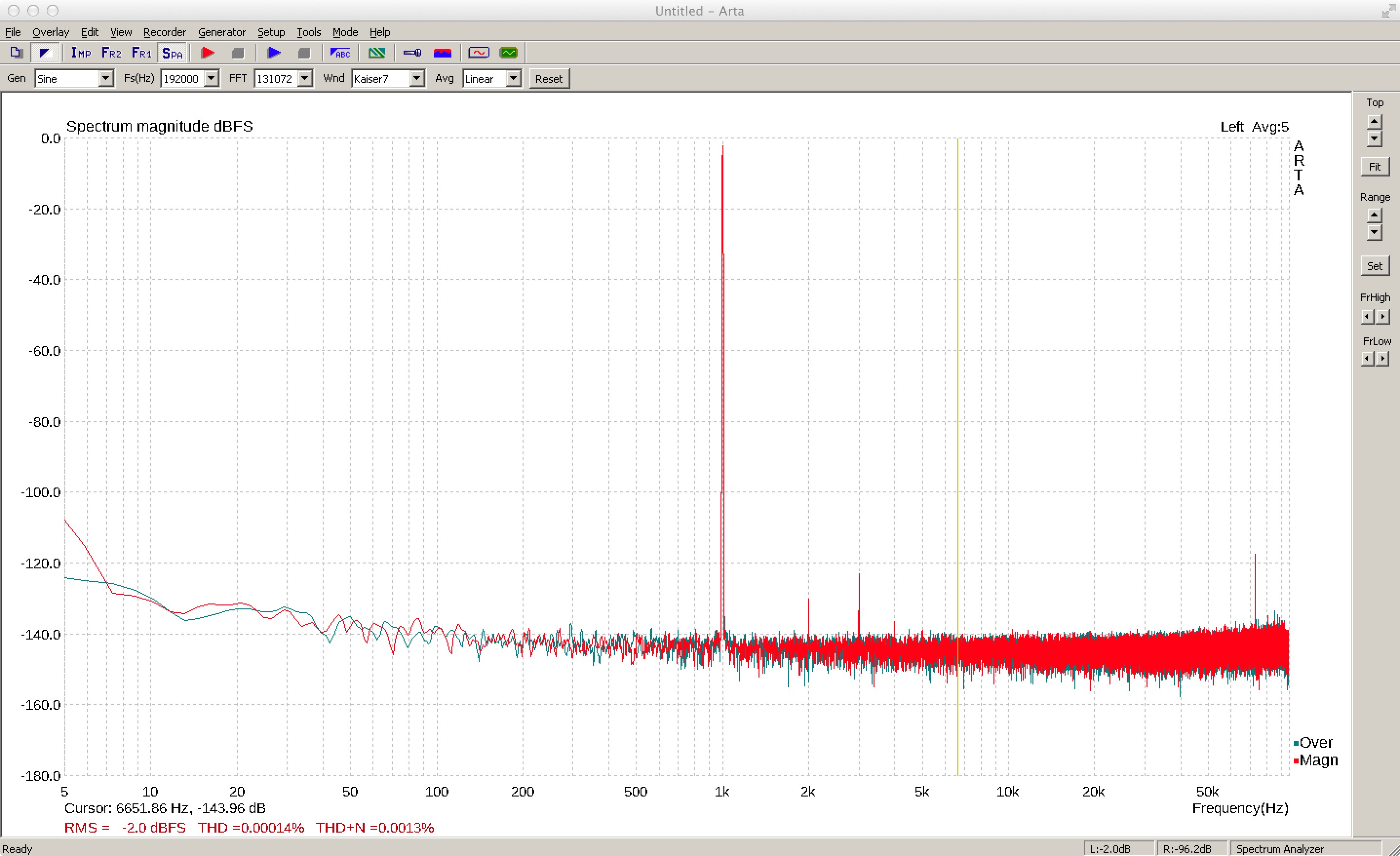

The following was just intended as a proof of concept with the material lying around, so far far from an optimal solution. I used 3 switched mode Laptop/Computer power supplies followed by a linear regulator to get the suitable voltage.
As the power supplies are not synced and different there is unnecessary HF noise.
The regulators were of LM317 type, thus not intended for switched mode supplies (no good HF rejection).
This causes a few spikes around 70kHz which show also up in the measurements and can be avoided with a descent supply-regulation approach.
First, as indication that there is no performance loss due to the SMPS, a balanced loopback measurement, a 1kHz test signal at -12dB (settings 0dBV out, -10dbV in). Green the original supply, red the SMPS:

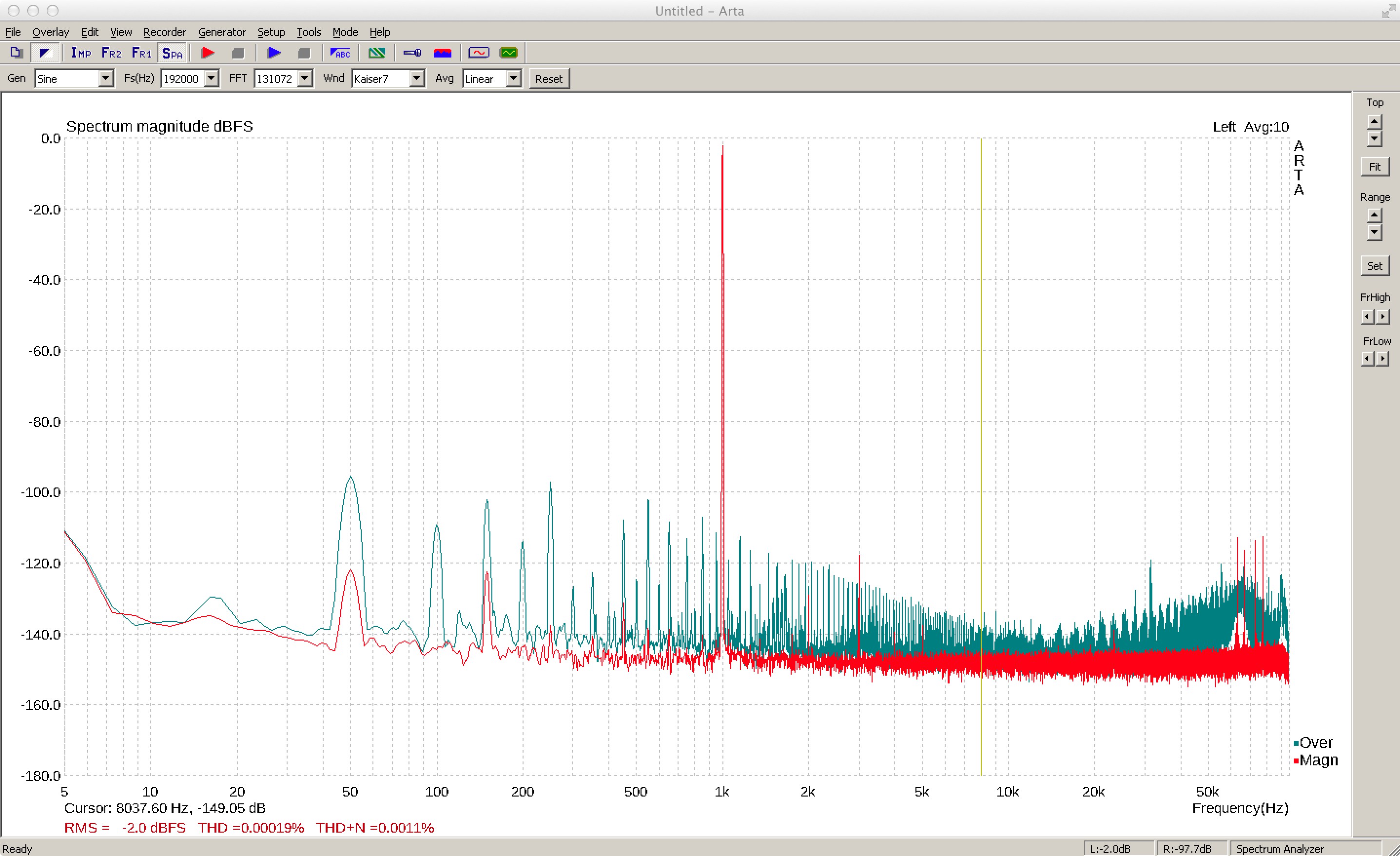

Then a unballanced loopback: BNC out to BNC cable to commercial BNC-XLR adapter. The BNC cable was not the best performing I had, but for a test this might be an advantage. First the noise floor, second a 1kHz test signal at -6dB (settings 0dBV out, -10dbV in). Green the original supply, red the SMPS:
Conclusion, I would say, there is room for improvement, at least for the measurement ease of the user, in for unballanced measurements.
P.S. I give intentionally not more details on the SMPS setup as you should not duplicate it unless you know very well what you do. You can easily damage your analyzer and, of cause, warranty is voided by the attempt.
View attachment 704728 View attachment 704729
