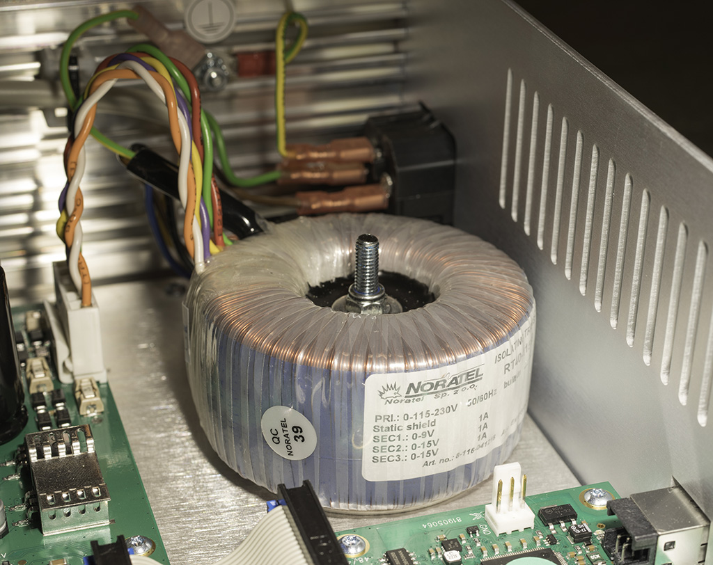

Here is a simple inexpensive fix: Trafo shielding sheet, 14,90 € that could actually work. Before I get one shipped all the way here maybe someone in the EU can try it? There are also cans like these on eBay that may work: Black Metal Shield Toroid Transformer Cover Chassis (multiple sizes available) | eBay
Switch mode supplies can be low noise or high efficiency or cost effective but not all three. If one of the steel cans or the magnetic tape solution works that's probably the best option.
If I were designing a transformer for this I would cut the flux by about 50% which will reduce the field by a whole lot. However not something you can get off the shelf.
Lots of switching noise are through the ground. Good luck. You could probably check whether the switching frequency is out of the measurement bandwidth or not though.

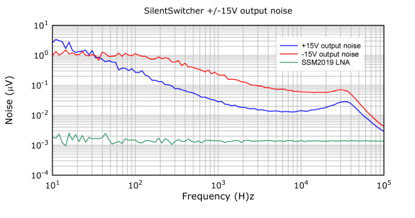

I think you may be referring to this figure

Your argument simply isn't true this day and age. All the top test equipment manufacturers are using switching power supplies today, and have for years. If nothing else, this is to keep the weight down. My old equipment weighs in at 60 to 80 pounds for the network and spectrum analysers. The current stuff is light as a feather, and that includes the oscilloscopes that cost over $250,000 US. These are making measurements way down in my noise floor with ease, and no switching artifacts. Their bandwidth greatly exceeds the switching frequencies used. Their low noise power supplies and SMUs are also using switching power supplies.
I am using switching supplies in some of my audio designs, and they are not the limiting factor in the design. The limiting factor would be me in this case. I still use linear regulators in high voltage applications.
