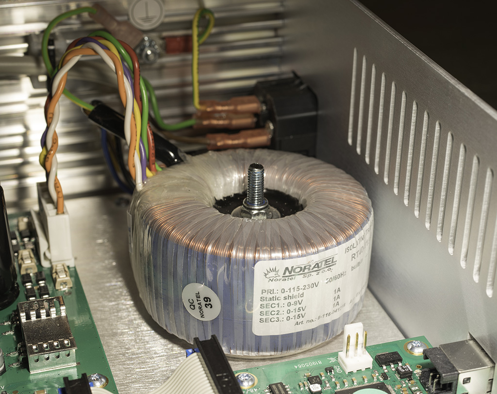

The RTX has its chassis connected to the power ground which could be the source of the noise. The transformer radiation is higher than I would have liked to see and that may be the biggest cause of the power line noise. I'm running 125V AC here on the 120V setting and the magnetic field is high but manageable. Its not from ripple on the supply. There may also be some capacitive leakage from the transformer to the chassis causing currents in unwanted places.

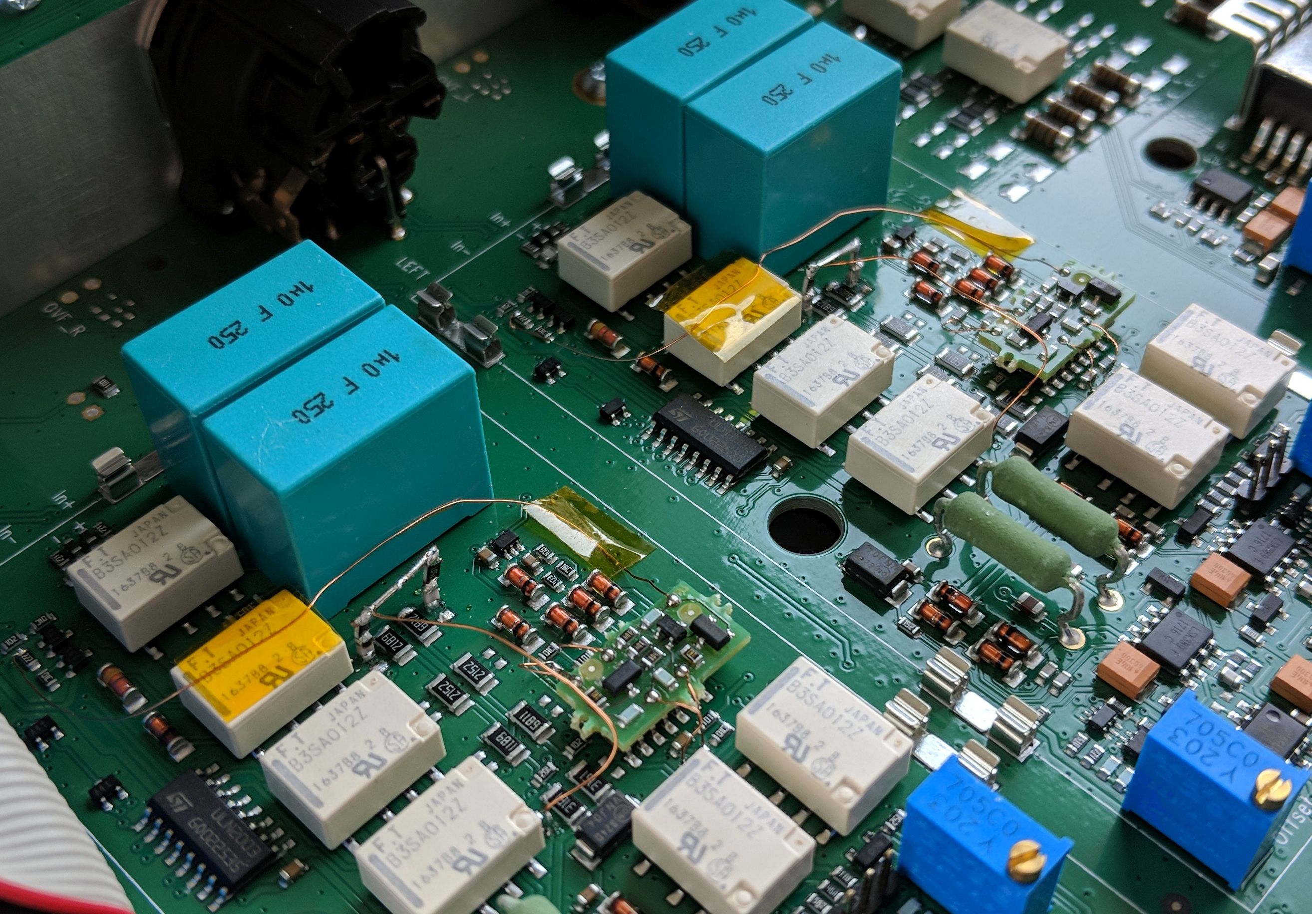

Hi all, I have at long last perfomed the oscillation mod on the right channel only, and have recorded some loopback results from the two channels to make sure all is in order before proceeding with the second channel. There is quite significant variation in the distribution of recorded distortion between the left and right input channels. These figures are just read off the audiotester v3.0 graph so will have maybe 1dB error in them of course. I have appended a small spreadsheet of the values.
I used 1V as FS, 1kHz tone at -1,-5, and -10dBFS looped back to the 1V inputs. I ran one channel at a time.
The question is: has anyone else seen this change in the distribution, and if not have I screwed up the soldering. It doesn't seem right yet it's not massively wrong. Help!
Jazid, did you do measurements prior to making the changes? Comparing the two channels can be misleading as they will never have identical performance. My recollection is that one of the channels input channels on mine is noticeably worse than the other, both however are still in the realm of excellent performance. There is no perfection in the real world - only good enough.

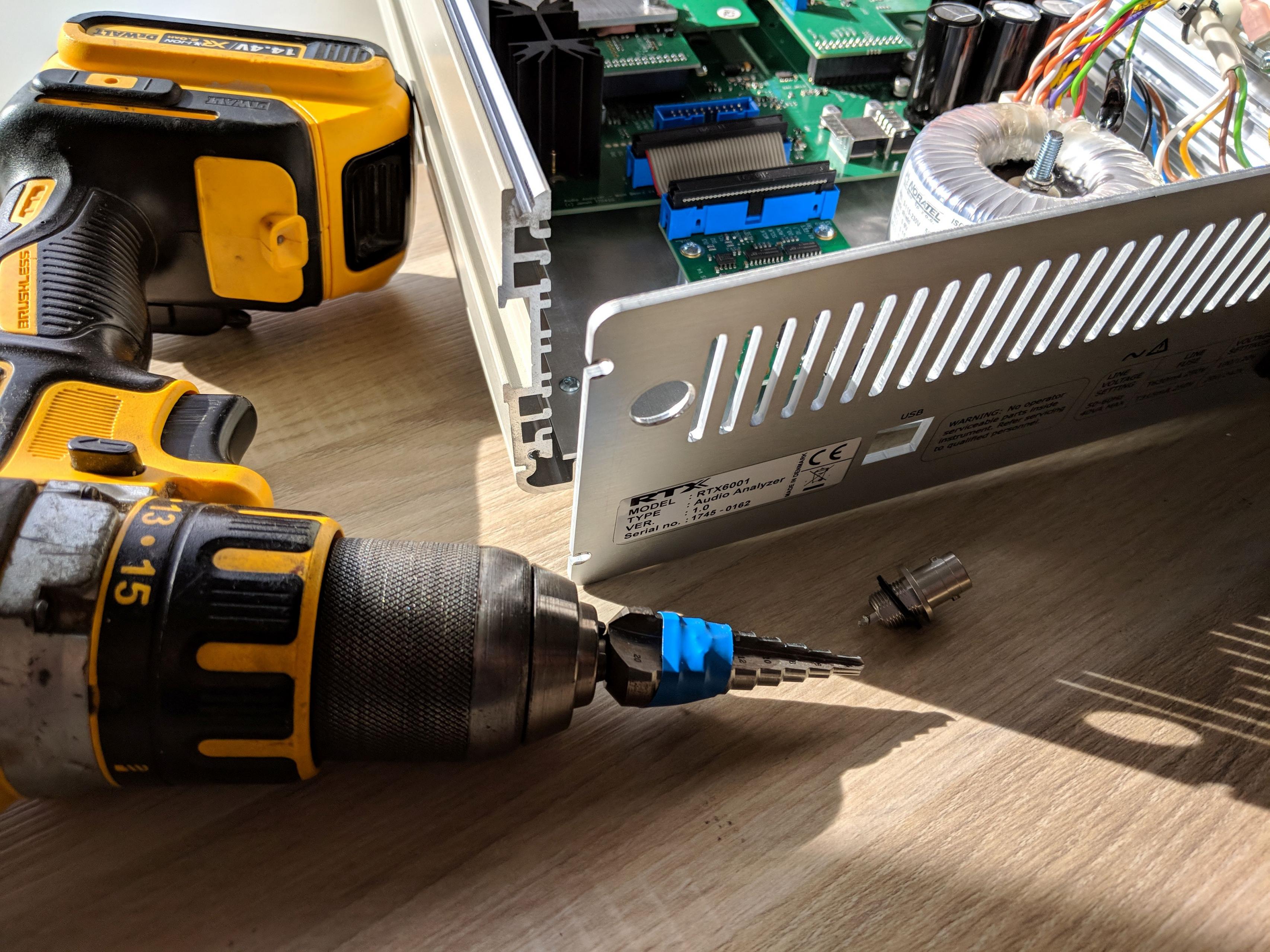

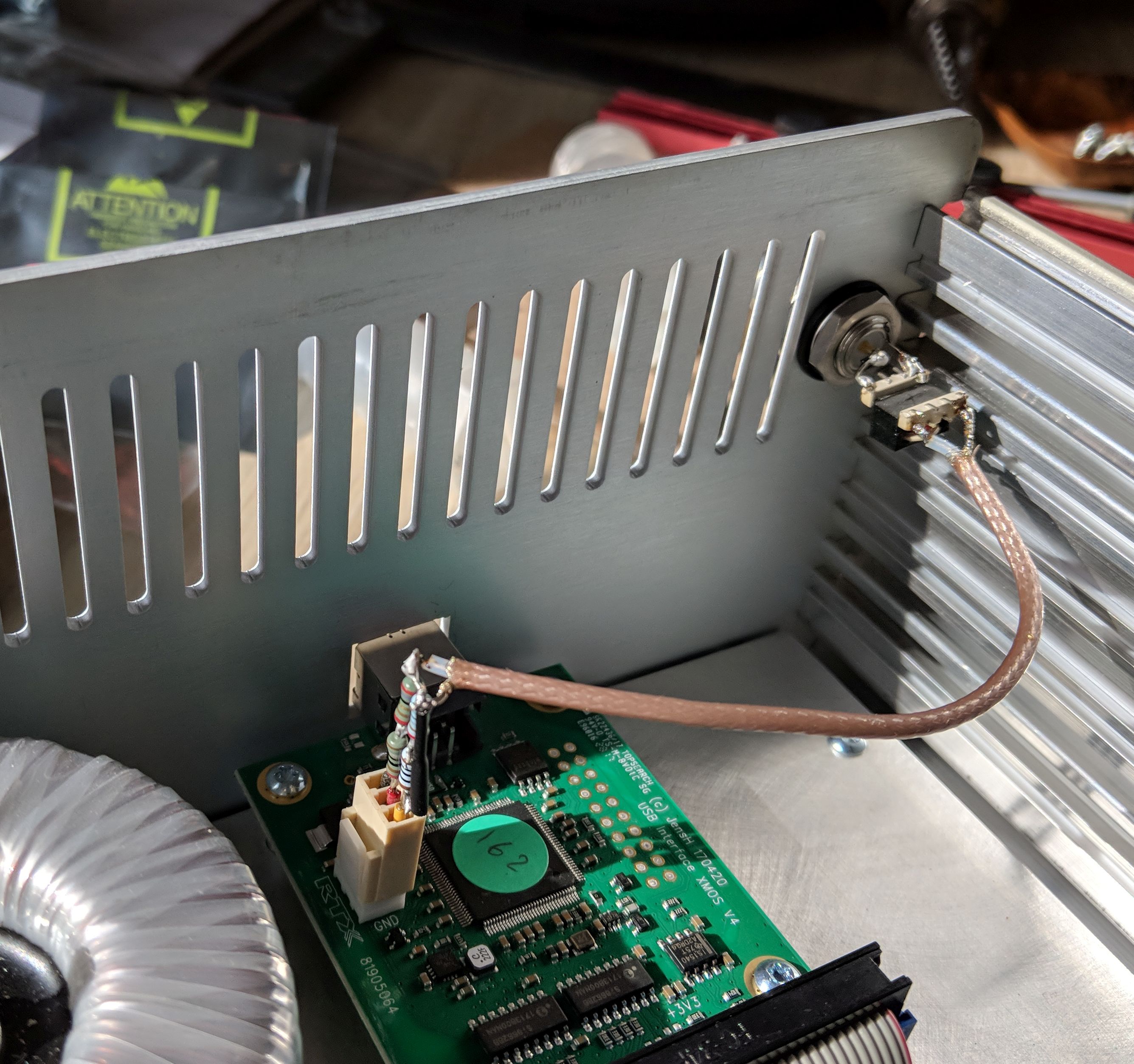

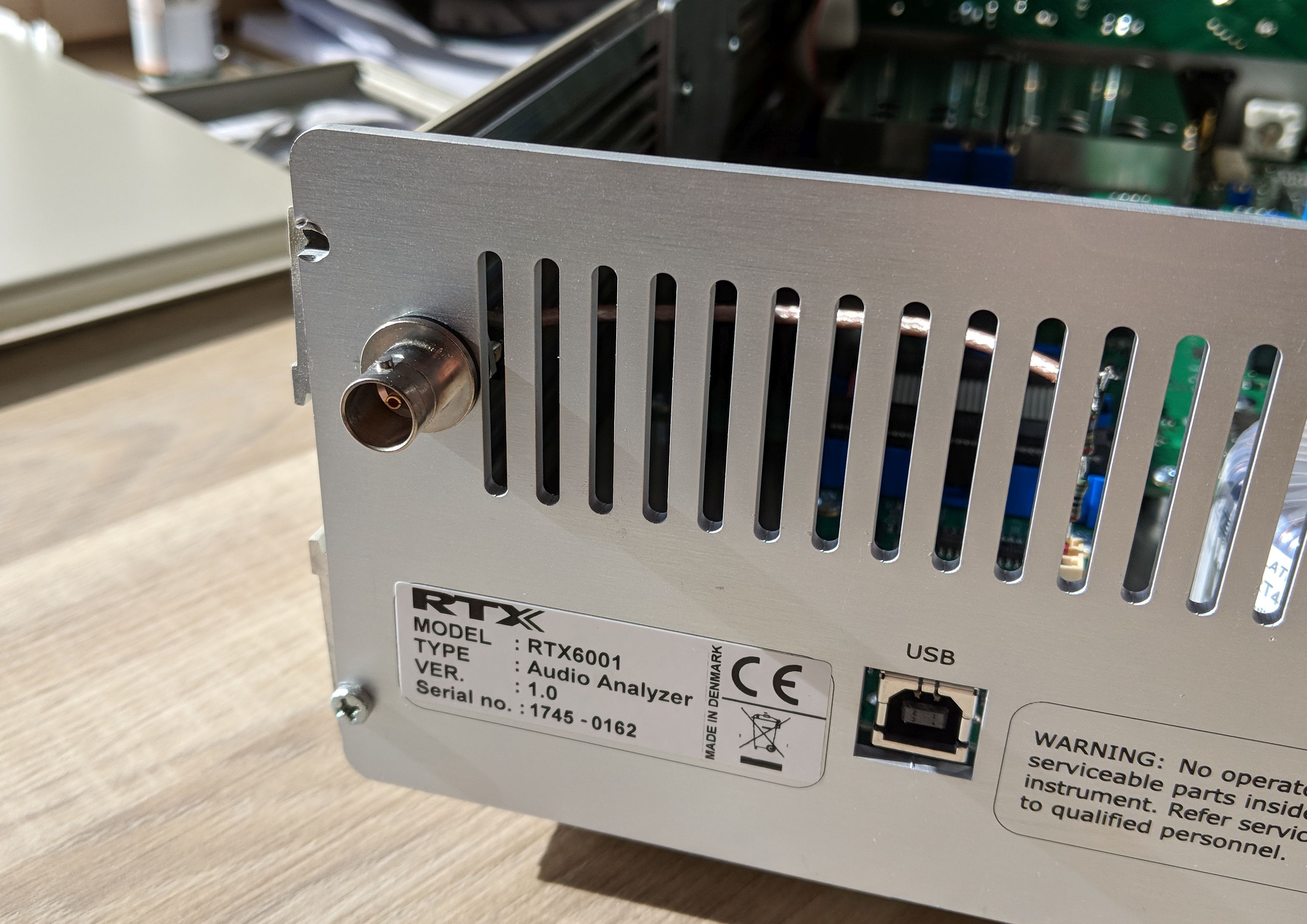

I finally found time to also apply the latest mod kit and put the shields over the inputs. Also added the SPDIF output with isolated BNC. Done carefully one can install it into the back panel pretty nice. SPDIF out works well into WaveIO kit as well as into APx instrument, so should mean it will work overall.
I'm more than happy with the device. I'll post some measurement on my unit after all mods applied also in next post... it's an impressive gear for sure. Big thanks to Jens again for device as well as good clear instructions for mods.

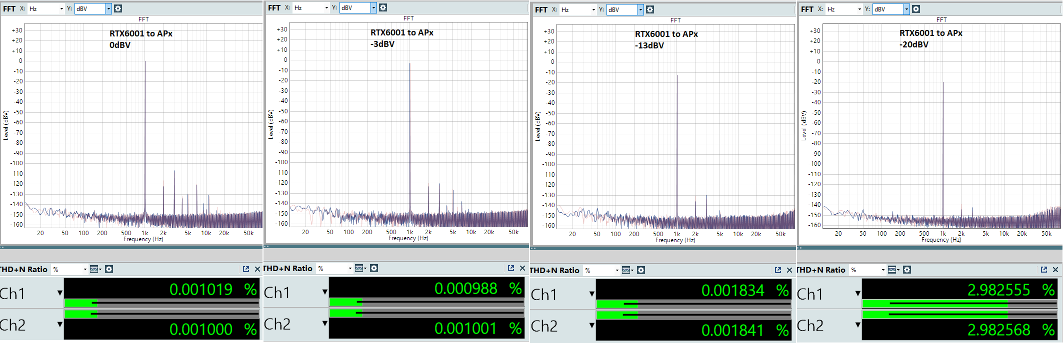

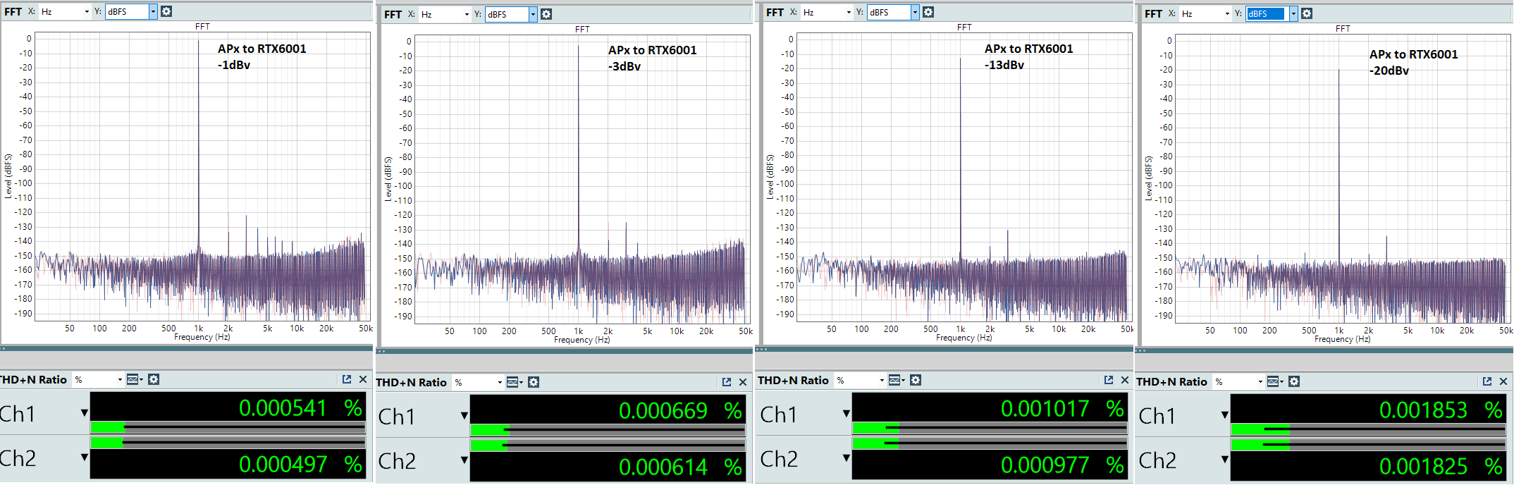

These pictures should speak for themselves... but anyhow few comments.
There is small difference between channels for harmonics, but only at 0 or -3dB levels. If one keeps the levels in -13 ... -20 range the differences between the channels are super small and the harmonics are so low that it would take really highest level of know how to design circuits where this gear would be the limiting factor when measuring it.

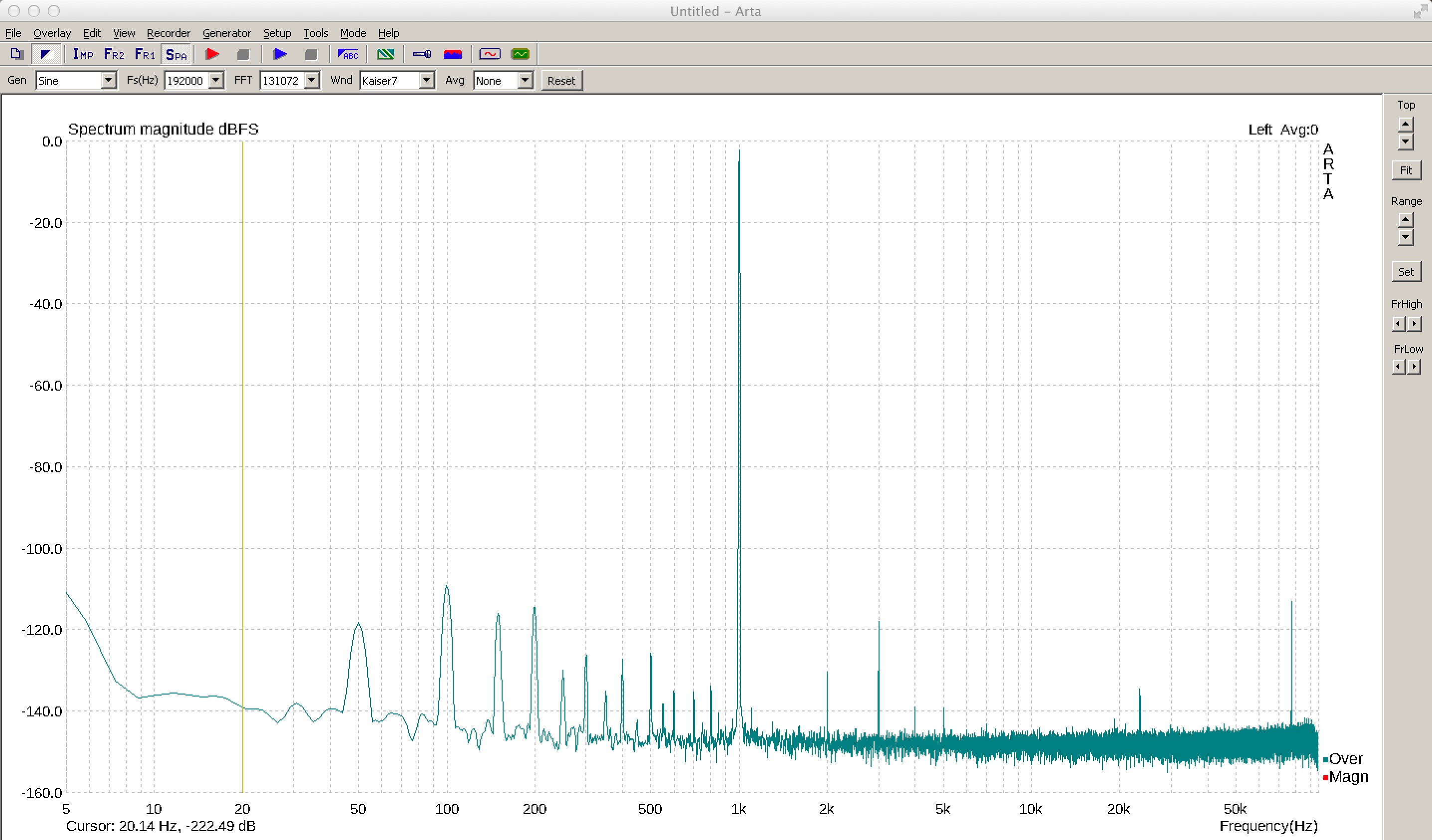

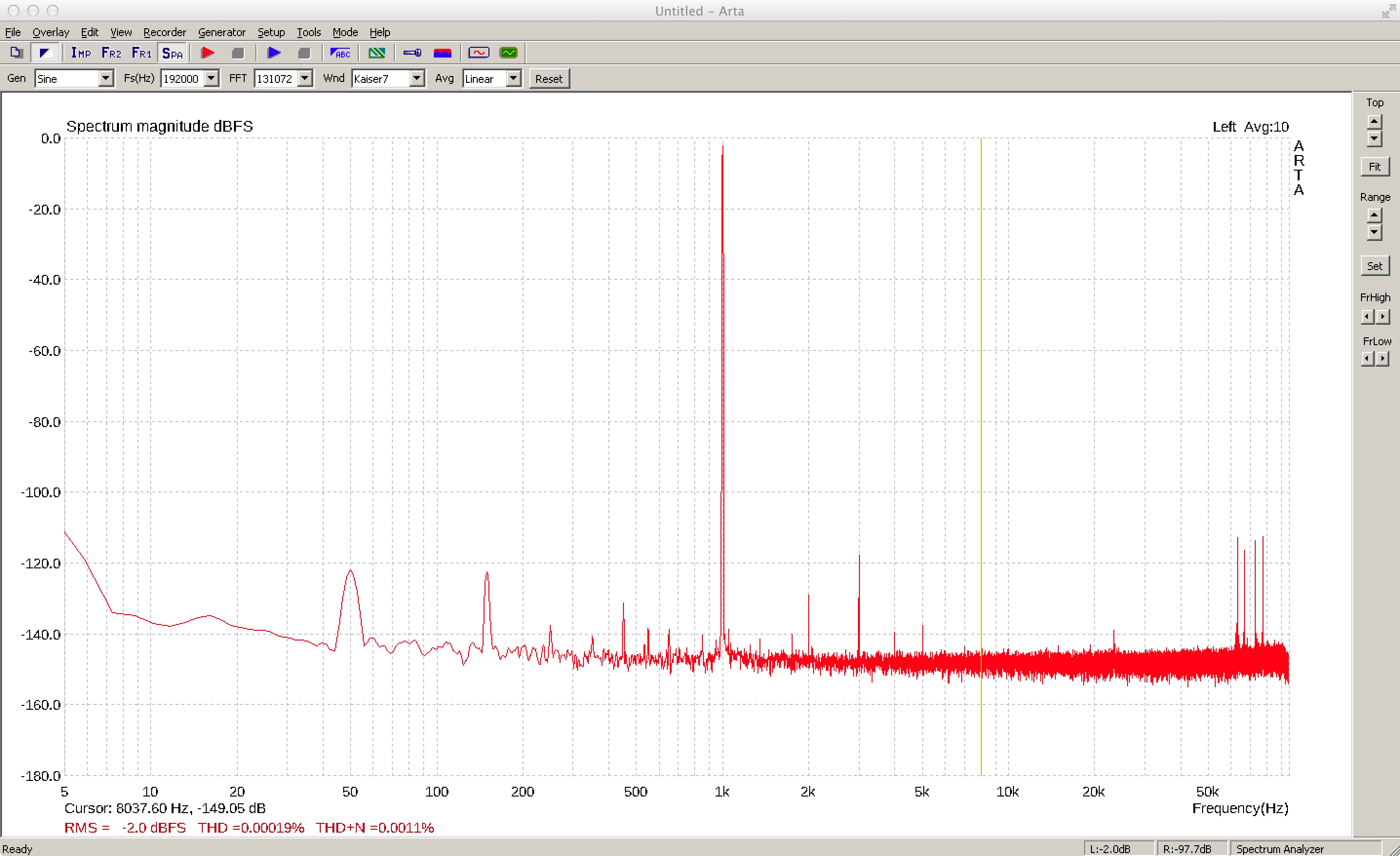

Thanks for the replies Kevin and ergo, yes indeed the measurements are still good but not equal. Attached are some screenshots run at -3 and -13dBFS relative to 1V, Hanning window, 262K, 5 samples to consider alongside ergo's screenshots.
Decent balanced interconnect from output to input FYI.
I notice that the measurements I previously posted were (inexplicably) taken with a Rife-Vincent 2 window...

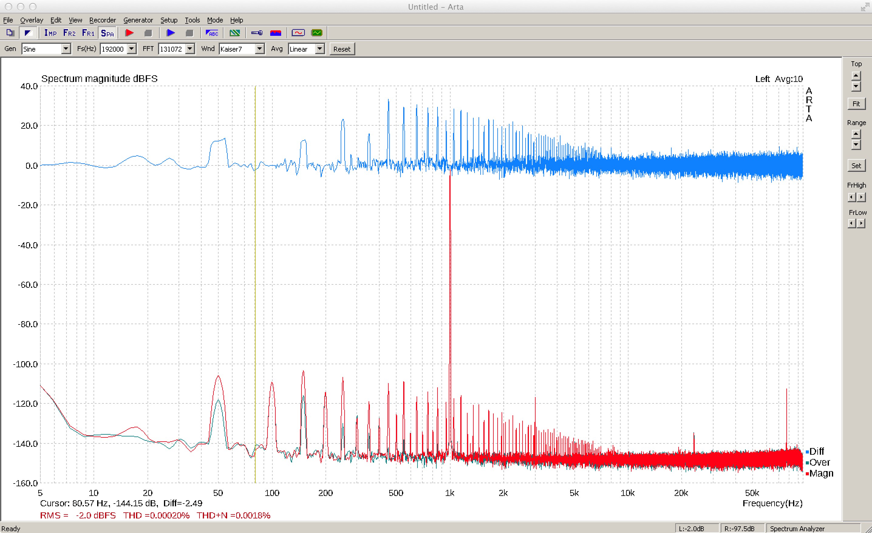

I made an extension cable and moved the transformer about 30cm away from the chassis.
The green graph is with the moved transformer, the red with the transformer mounted back on its place again (blue the difference).
Measurement 1k sine -6bB unbalanced (out 0dBV, in -10dBV)
With the transformer moved it looks clearly better. But the SMPS was even better than that:
P.S. note that the unbalanced measurement in the unmoded state, shown here, looks much better than in the unmoded example shown at the SMPS mod post. Probably a different cable.

Is the transformer shielded?
