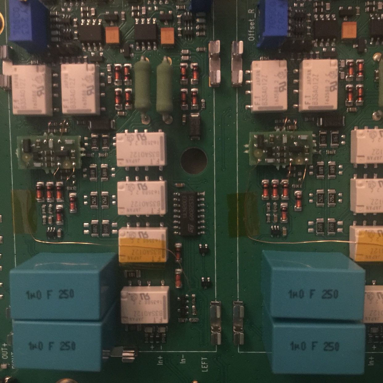

How many HW mods are there for the Jensalyser ???
I have the "over voltage control circuit" kit and the "shields, capacitors and resistor" kit.
I read about the SPDIF fix in this thread, but are there more I have missed ???
Life have kept me rather busy so I have not applied any of the kits yet.

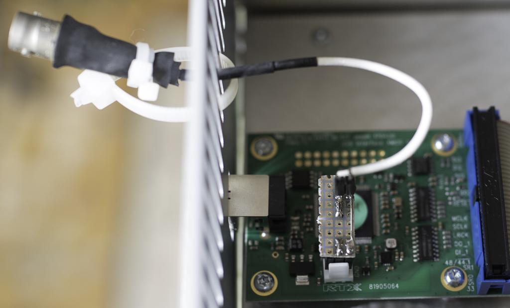

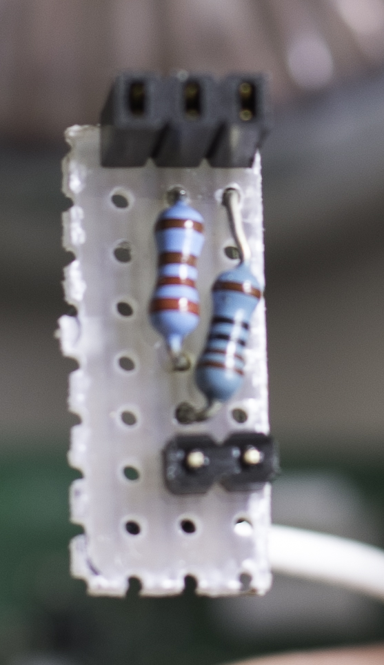

Did anyone manage to put together the SPDIF out. Would you be open to providing it as a small kit for other owners of the Analyzer?
thanks
Works fine.
Good to know but I rather drill a hole in the back and make the connector permanent.
Is the previously mentioned pulse transformer needed ???
In my case, I have already one on the receiving side, so I didn't bother.
As you need to unscrew the back plate (at least to a certain extend) to open the case, some flexibility, somewhere, is needed.
PS. I have put the capacitor from the schematics, it is a tiny SMD.
