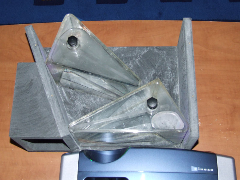

Materials -
Perspex, Lexan and evem Plexi-Glass are all types of Acylic. There is a fusing glue available that basically melts the pieces together and makes a water tight seal. Currently I am using 6mm Perspex but I am looking at Plexi-Glass as it is supposed to have the best transperency of the three. Even though the Perspex looks good, the plastics engineer that made both sets of prisms for me has stated that Plexi-Glass will give the best results, but it does cost more and I would have to purchase the entire 2400mm x 1200mm (8 x 4 foot) sheet.
Prism sizes -
The very best way to find the size you need is to conduct the paper test. Basically hold a piece of paper in the light path and draw the size of the rectange of projected light at (or as close to) the lens, and then some 4 inches away. Because I am using the SONY HS-3 (a very short throw 16:9), I had to build my prims large. My prisms are 220mm x 112mm. I built them rectangular, but most commercial lenses are square. Just make sure that the light path will not be clipped by either the prisms or the housing.
Each prism (in my 1st lens) are based on a right angle triangle of 30/60/90 degrees and have the hypotinuse facing the projector (prism 1) and facing the screen (prism 2).
My 4 prism lens is a little different in that each main prism has been split down the middle to create two chambers, so that there are now two 15 degree apexes inside the main 30 degree tip.
Yesterday, I drained them and took them back to the Plastics guy to have them glued to a mount plate. Only one is fixed directly to the plate (the plate is just a 10mm peice of Perspex that is 220mm x 250mm) and the second prism is joined to the first by an Acrylic hinge. This allows me to move the front prism (without accidentally moving the rear prism) to give me a pass through (no stretch) mode so that I can watch non anamorphic material without having to remove the lens.
I had been testing this with some double sided tape and some packing tape to form the hinge and it worked like a charm. I had a major re-alignment issue with the lens after the prisms were glued for some reason, but all is good now and the front prism can swing from an angle between the two prisms from 0 to 60 degrees, where about 40 degrees gives optimal stretch with no light reflections on screen...

Hi Michael,
I just spent about an hour trying to re-align the lens (again) and I have to re-do the mount. I have no pass through mode again (well the front prism swings back but hits the inside of the case) so watching 1.78 looks all wrong as there is some stretch being applied, not the true pass through mode I had.
I don't understand how the prism could be offsetting the light that much. My 1.78:1 looked more like a diamond than a rectangle...Wthout the lens, the projector was level, yet stretching a 4 x 3 into 16:9, the image was all out of whack vertically...
The 2.35:1 setting looks OK now so long as there is not straight vertical lines on the far left (they look bent from the pincushion) and I can not get enough latteral movement to compensate. It was much easier to align them when they were separte...
But removing the lens tonight was nice and easy as you just grab the plate and whole thing comes out as one peice...
As for those "glass prism" lenses that Mark G mentioned (and you've asked about), they may be 2x stretch rather than the 33% we need.
I am working on a new plan that will be easier to construct. I will post details as they develop...

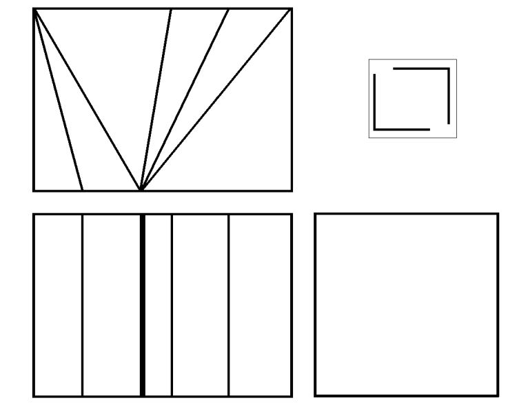

I'm not sure I understand your newest drawing, but if it represents 2 prisms composed of 2 elements each then I think you are on the right track. From my readings I take that each prism should be achromatic in itself. This result is obtained by composing it of two prisms with different materials with different refraction indices and using different apex angles for each. I have the formula for calculating the angles based on known refraction index and Abbe number so now I need to find these values for a variety of materials and do some number crunching. There are of course many other aspects that have to be considered. I am just trying to get a grasp on what those are.

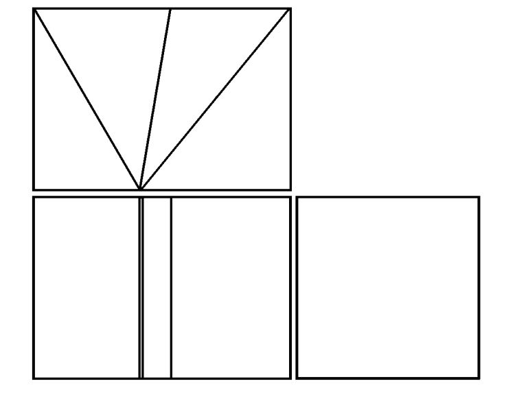

Basically put, the angles represent two prisms in a box. I've kept this design as a sinple 2 prism lens. Starting from the left is a 30 desgree prism, then an air gap then the second prism followd by the end on the lens. The angle are based on my current set up (that I know can work🙂) but rather than complex construction using the strip heater, I want to make a jig and glue everything in place. naturally there is some room for error and I will most likey have to give it a few goes as the angle between is what I fear the most - too much gives light reflections and not enough gives incorrect geometry. There should be a small (about 3 degrees) angle off the first prism, but I figure the whole assembly can be rotated here. The other idea is to create a lens that when used on way is a HE, or reveresed and turned 90 degrees can become a VC...
I'll be making a new for my exsisting lens before I go too far with this new project...l

That's not good news Michael...
I have revisted that design I posted earlier. Rather than bending, which is both time consuming (therefore expensive) and not always guaranteed to be perfectly vertical (I found this with my second set of prisms, probalby why I have found it so hard to align) due to the amount of sanding needed to smooth out the "bumps" that occur at the bend.
So I am thinking about an all glue project. I will go back to my MDF supplier and get him to cut me the wedges I need (his saw is very accurate) to set the angles. If I use 25mm MDF, the vertical sides will be higher (25mm) and therefore should be easier to clamp for glueing.
So basically I need different wedges at 15, 30, 40, 50 60 and maybe 80 degrees and intend to work the lens as two opposing L shapes (1 prism per L) and then join the two after.
I also wan't to make the HE lens so it can be reversed at turned 90 degrees to form a VC lens as well.
I have attached the revised diagram showing the 2 L plan (insert). I won't be able to do any work on this project until middle to late next week, but will try to get a quote for the materials on Monday...
Mark
Mark
