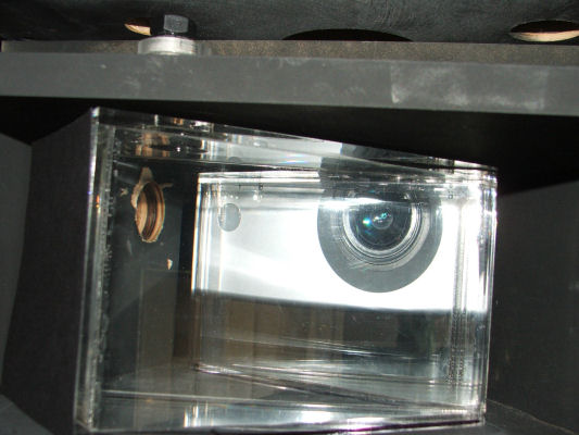

internal light issues
I've fitted some peices of black card agaist the small sides of each prism to stop light leakage.
The image should show the card. Best thing would be to remove the prisms, mask then up and paint small end of each.
I also get some light reflection behind on the back wall as well, but this is not too disctracting as it is never seen on screen...

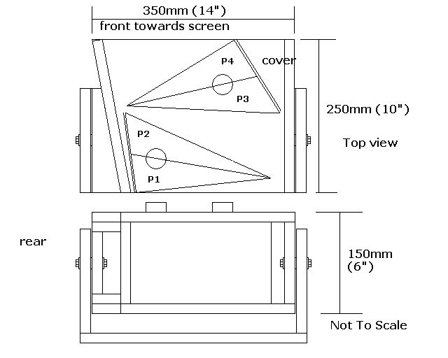

After using my dual prism anamorphic lens for many weeks, I have considered making a 4 prism version. Has any one tried this?
I am considering spliting each 30/60/90 into two - one at 15/75/90, the other at 15/60/105 by adding a divider to each. Both will be filled throught the same hole at the top in the expansion chamber.
The part that puzzles me is that each pair will face the same way. When I was designing the lens I have now, I learned that the prisms must oppose, or you get severe CA. Given that the second pair will still sit opposite in the case, I am hopping it may cancel out any problems.
Once again, I am getting the plastics engineer to make these new prisms for me, and naturally I will keep you all updated🙂
I have attached an image of what I am thinking of doing...
Any feedback will be welcomed...

Your new project with 4 prisms sounds interesting.is there any other advantage than less chromatic abberation?
If it is only the chromatic abberation I would maybe try first filling your existing prisms with two differend kind of liquids.Like some are using water and terbentine.Or maybe both of them with glyserine.

The next step is big gamble as I am effectively halving the angles and then adding two together to form a new dual prism. When I move my prisms in or out, the edges do change from quite straight to the bad bow I have on the left. My theory on this is due to the amount of displacement of the two prisms, where there is significant air gap between the surfaces. Hopefully the additional two prisms will help reduce the negative effects by progressively stretching the light in smaller steps as the prisms most likely will not need to be displaced as much...

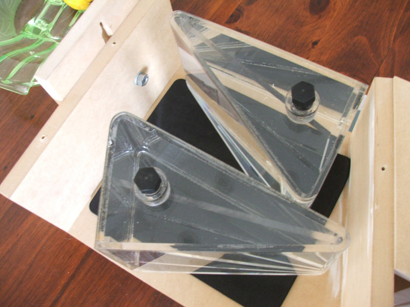

Yes, I picked up the new prisms today. He charged me the same price as the last set even though there was a bit more work to these new 2 chamber prisms.
I also started on the new case given that I am reasonably happy with the size and shape. I am making this one in the hope that I can obtain a pass through mode as well as stretch mode. The current one has an alignment issue if you try to make to pass through. Only half the image is on screen. The other half is distorted by the end if the second prism.
So the split prisms work. This worried me a bit given all the previous chat about the angle having to be specific, or it won't work. It does work with the simple tests so far prove that there is enough angle to stretch the image 33%. I have not yet had the chance to run the projector through these prisms, though it would not be that big a deal to change them over from the current single chamber prisms in use right now.
Yes, CA is even finer. I tested this by looking through just 1 prism that I had only filled one side of first and then there was a large decrease in CA when I filled the other side. Even with just one half filled (15 degrees) it stretched beautifully. Then I filled the second prism and placed it in front and there was no CA at all. Even with my two single prism lens, there is some CA if you look at the edges. It appears that a 4 prisms lens fixes that...
I am still looking at different liquids to fill the prisms with. The biggest problem is finding a clear liquid that won't go off (has a long shelf life), is not flammable, and won’t (worse still) ruin the prisms themselves...
So for right now its back to water, but I am going to run some tests in the coming days with some scrap to see what re-acts and what does not. Hopefully by then, I should have the new case all finished as well 🙂

Tonight I got my older front projector out of its box to conduct some light path tests. There is definitely less CA and the addition of two extra prisms appears to have helped fix that annoying bent left hand side, though that is projector/lens placement dependant...
The placement angles for each dual prisms seem to be the same for the four prisms lens as the conventional 2 prism lens.

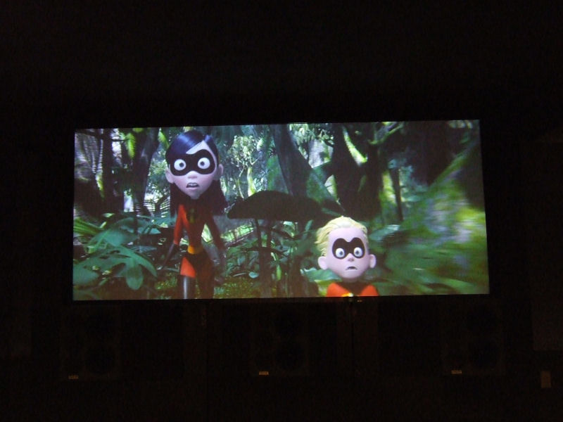

Ok I had some time spare today to play around with that lens again. Up and till now I have been using the older 2 prism lens as I had some "teething" issues with the 4 prism lens and my short throw projector.
I have basically reversed the prisms where the 90 degree angles face in, not out as they did before. By running the back prism flat across the opening, I have been able to get a true 1.33:1 (I wasn't getting that before with our light reflection problems) and there is no reflection issues. The front prism sticks out a bit, but this set up has also allowed me to get a pass through mode as well as a stretch mode, so I can now re-visit all of my LDs 🙂 some have DTS soundtracks...
I have attached an image from "The Incredibles" that shows the ful screen and you can just make out the speakers...There is a slight wash out in the image, but it is the camera I used tonight...
