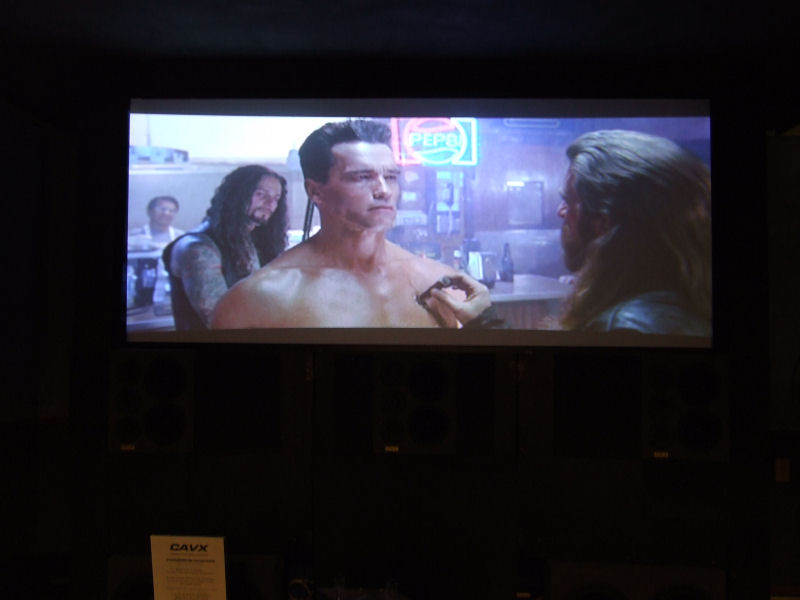

Projector Set Up 1
As I can only attach one image at a time, I will have to make several posts. The purpose of these shots is simply to show the set up, not image quality...
I have used the same still from "Terminator 2 Judgement Day" for all of the images. The geometry and size will vary from photo to photo to demonstrate the set up proceedure when using a 16:9 projector and an anamorphic lens.
The first image from "T2" and is the full 2.35:1 image. This image is made possible by setting the DVD player to 16:9 (wide mode) and the projector is set to "zoom" where by it fills the entire panel with image. Because the source is anamorphically enhanced, the black bars that are normally seen at the top and the bottom are missing, allowing the projector to reproduce the image using every pixel on the panel. The image's geometry is optically corrected by the anamorphic lens...
Mark

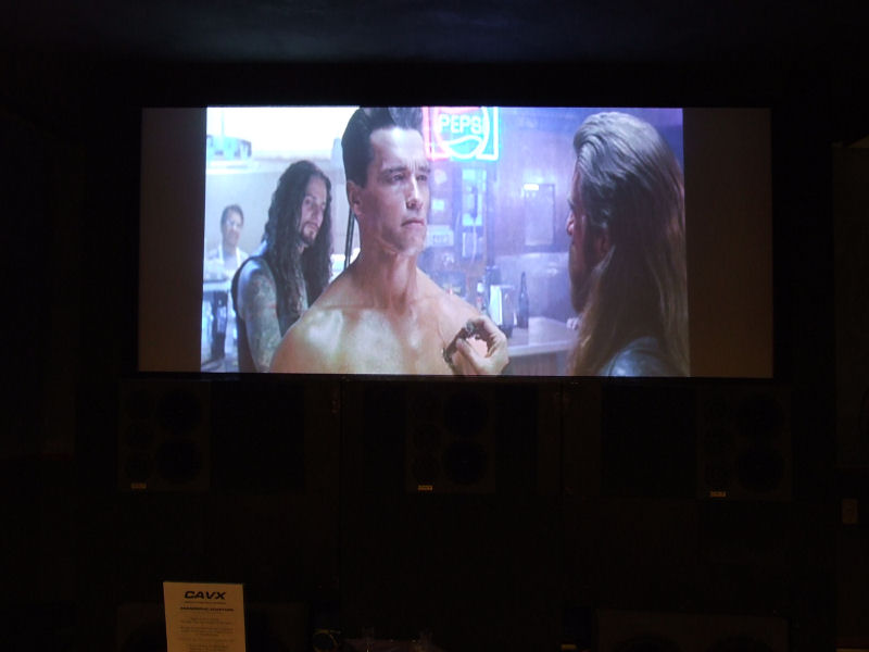

Projector Set Up 2
This next shot (same frame) is what the image looks like without the anamorphic lens optically stretching the image (this is my lens in pass-through mode). The image is horizontally squeezed. This is because the player is running in 16:9 mode, the disc is 16:9 enhanced, and the display is running a 4 x 3 mode.
Notice that the image still runs from the top of the screen to the bottom with no black bars (they have been removed by the projector) running in "zoom". The shape of the image now is actually 16:9 and the projector is able to use every panel for maximum image brightness...

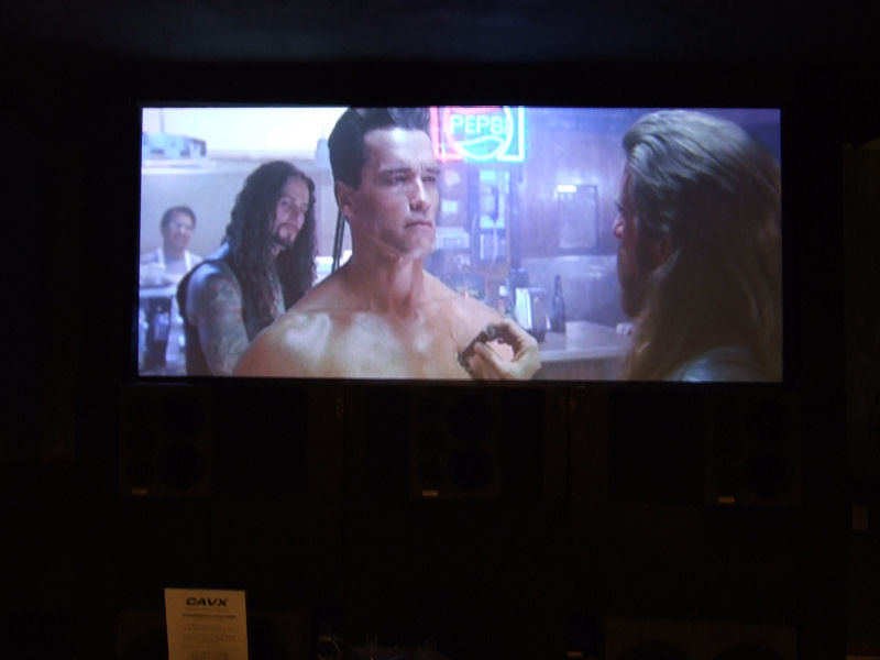

Projector Set Up 3
Normally we use a 16:9 projector (16:9 mode) to electrically stretch the horizontally squeezed image to restore the geometry. When using an anamorphic lens, this is the last thing we want to do, as the projector will electrically stretch the image and so will the lens. The result is a short fat image much the same as when 4 x 3 material is played in this mode. It is incorrect and the image shows why...
Notice that the black bars are back too - NOT GOOD...
Mark

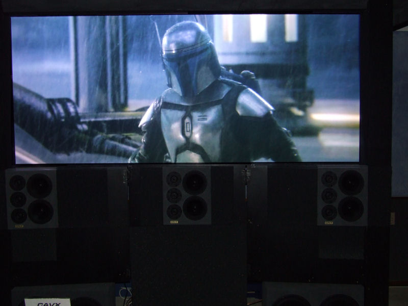

Only if the stretch exceeds the desired 33%. All of the screen shots I have posted are real including the Jango Fett image which is comprised of 2 digital photo layered to allow you to see both the screen and the speakers. If my lens produced light reflections, they too would be seen in the digital screen image captures.
My lens has a pass through mode, and when restretching the image, I simply work off the light on the screen for the width. If you move the prisms too far, you will see the light reflections form in the centre of the image.
I used to have a lot past 25% stretch, then through experintation, I learned that the best results came from reversing the prisms so that their 90degree angle now faced in. From reading the results of a few others that got light reflections, I would say they too have set their prisms as I initially had them. Reversing doesn't seem like such a big deal, but it works way better. Some down tilt (projector is ceilling mounted) seems to be required as well...
