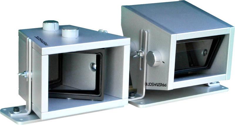

Guys,
Is this company called Prismasonic new as I haven't seen thier adjustable anamorphic lenses before. They make a vertical squeeze model and a horizontal stretch model. Lenses are either singlet glass or achromatic (doublet) glass prisms for higher imaging quality.
Knobs turn to get exact adjustment.
Hezz
