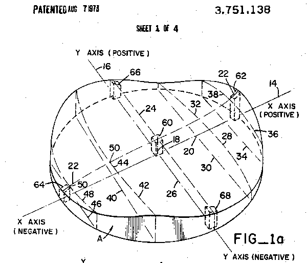

Guys,
After some study of the patents and of Torne's lenses I have come to the conclusion the the prismatic types of variable anamorphic lens are impratical for large aperture lenses. The prisms are way too large and heavy to work with the DIY triplet that I want to build. It has a final lens of nearly 6 inches in diameter.
So I have come up with another design based on U.S. patent number 3,751,138. It uses a lens system that will be necessary to build with a CNC machine that can grind the lens as it uses a very special surface correction. I will post a picture of the lens and then give the mathmatical formula that describes the surface according to the author.
This lens though harder to build has some advantages to the prisms. First the same configuration can be used to both expand the image horizontally and compress it vertically. The mount will be easier to build.
It will be made as a triplet trio for more chromatic abberation correction.
Here is a gif image of what the lens surface looks like. Two of these lenses are needed at minimum and one is the exact opposite of the other one so that they fit together to make one virtual flat of glass. Each piece can be of a different type of glass.
The three peice method allows for some more abberation correction for wider angle lenses. Instead of two there are three pieces. The middle one has the surface on both sides of opposite polarity. And then the outside lenses are fitted with the same surface so that all of the lenses fit together to make one virtual flat. When the middle lens is moved up or down perpendicular to the lens imaging axis the image is either compressed or expenaded depending on which direction you move the lens.
Hezz

While the lenses must be made so that all of the opposing surfaces are mirror opposites of each other so that the lenses could actually be placed next to each other to form one flat plate the lenses are actually seperated enough so that one of the lenses can be moved without hitting the other ones.
With the three lens system the middle one would be best to make movable I think.
When the lenses are aligned the net magnification is zero except for the refraction of the glass itself.
Now I feel that a negative spherical radius could be made in the first lens and a positive sherical radius on the last lens of exactly equal radius. This should improve the lens performance but still maintain the net overall magnification of zero. Or nearly zero. The negative curve on the first surface will cause less light loss because most of the light rays are exiting the objective lens at an angle will strike the negative surface at a more normal angle than if the surface was flat.
The idea is that this lens system is placed after the normal objective lens system.
I will post a picture of a rough 3D model that is not perfect as far as the correction surface is concerned but to give an idea of what I mean.
The way to get the surface is to have a software application that can derive a high resolution surface from the equation plot the surface. Then the surface information needs to be saved in a high resolution IGES format and imported into a CAM software package.
I know the Mathematica can export a DXF of a formula derived surface but DXF wouldn't have enough resolution for the CAM software. Does anyone know if newer versions of MathCAD, Maple or Mathematica can expert a formula derived surface in IGES or other high resolution format. Or is ther any other software that can do it.
Hezz

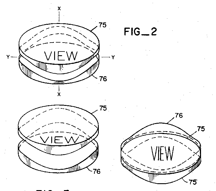

Here are some more images. The lenses are actually moved sideways in relation to each other rather than turned or moved apart. Also ideally the surface correction would be small compared to the picture so that fewer distortions are created. The pictures are exaggerated to show the surfaces.
Hezz

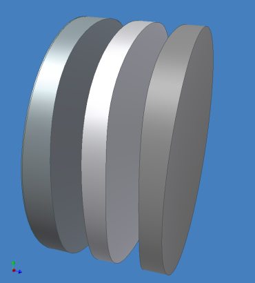

OK,
Here is a quick model of my idea. The three lenses don't have exactly the right surface but close enough to show the idea. The first lens has a negative spherical surface and then the anamorphic surface. The negative surface is hard to make out.
Hezz

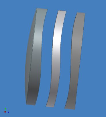

Now from the side to give an idea of the combination. The middle lens is moved up and down to compress or expand the image. When all three lenses are aligned the net magnification is zero.
The lenses will actually be placed closer together to minimize distortions.
Hezz
It is important that the first negative surface and the last positive surface have the same radius. Then the three lenses can be made of differing glasses or materials to correct for the color abberations just like in the cooke triplet.
The radius of the neg and pos surfaces can be chosen to minimize angular distortions from the emerging light rays from the objective.
I may have to think on this some more but it is possible that the middle lens surfaces may need to be reversed in order to work properly. What matters is that the sum total of magnification through the system is zero.
Hezz
