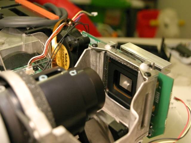

Finally I got time to disassemble my HT1000 and I notice something worth trying for another DIY anamorphic lens project.
DLP projector utilize different light engine and I can add a rear attachment to the lens.
Yes! that is exactly what I want to do. I want to make a anamorphic lens and put it at the rear end of the projector lens.
The lens will be about 1" in length and width, so it is fairly inexpensive to use solid optical grade prism for this anamorphic lens.
as the attached photo, I opened up my HT1000 and do some observation.
any one knows any place I can get good glass prism about 1" in height?

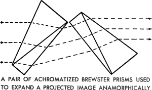

Have any of you guys out there thought of trying to recreate on a lightweight scale a variable anamorphic lens system like the old superscopes or panatar. I think something like this implimented in lighter weight plastic would be the perfect projector solution.
It seems to me that all they do is tilt the prisms both at the same time on a central axis to vary the compression.
I think the hardest part would be to get the prisms of the right material to cancel out abberations. As this picture shows the prisms seem to be of a doublet type of configuration. With differing index of refraction.
