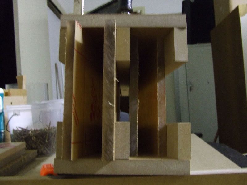

I have also built a new test jig with small wedges cut using my miter saw (power drop saw) to keep the face material (I’ll start with 6mm Perspex again) at the right and constant angles…

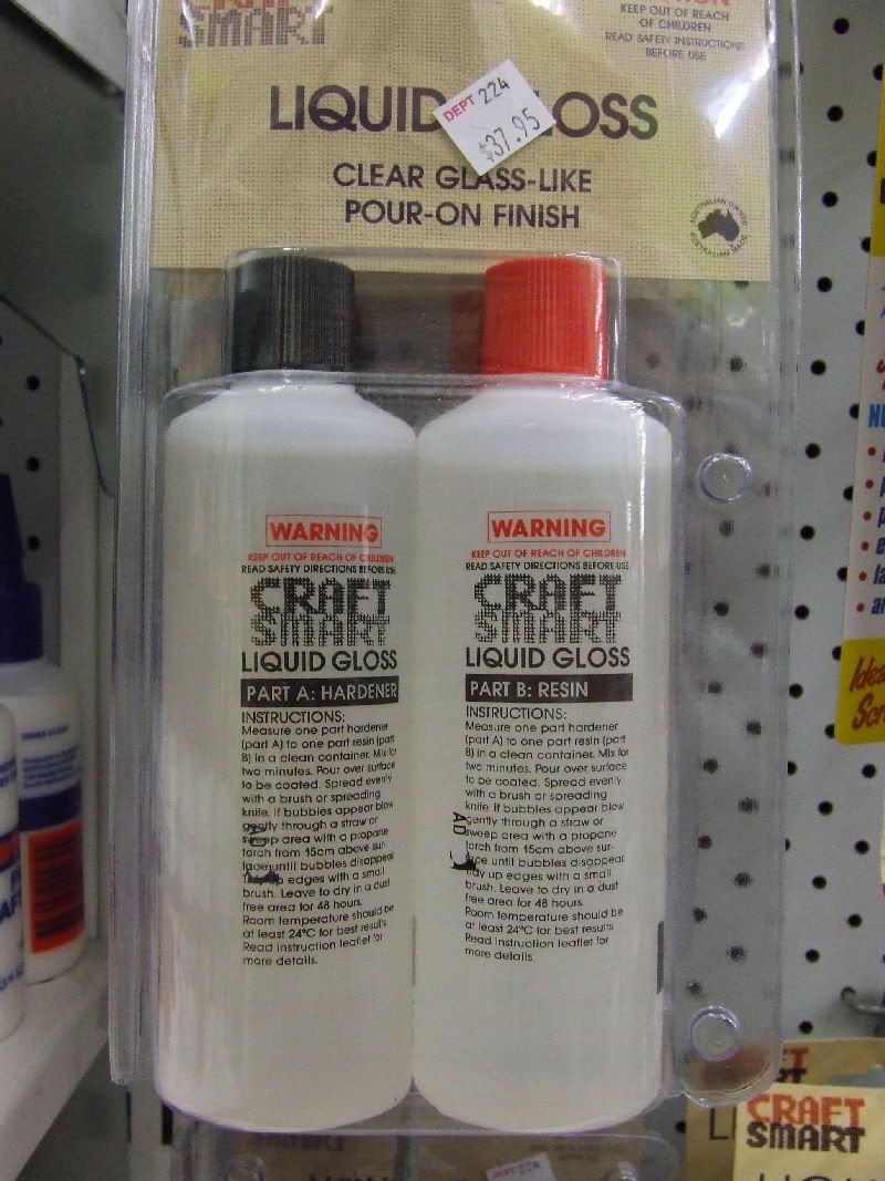

Looking into solid prisms
I went shopping and found two different products (at two very different prices) that might do the job.
The first of these is an equal mix parts of resin and hardner and looks clear. The packaging claims "a glass like finish".
The second product is also a resin, but the harder is mixed in smaller amounts (somewhere in the order of just 3mm hardner to 100mm resin), however the hardner (not pictured) is amber, not clear. I wonder if such a small amount of amber is even going make a visible difference?
Both products are exothermic and care should be taken with mould.
My thoughts are around using 6mm (or maybe 10mm?) as both the mold front backs, but so that the persex becomes the clean smooth face of the prisms when the Resin has set. It won't be removed, so as long as there are no major bubbles, should produce a clean solid prism with a very clean, smooth faces...

Awesome! Thanks Skhattane (Sam) 🙂
I'm not sure about the Refractive Index of this resin, but its got to be worth at least a prototype...The CA should be cancelled out by the second prism...
I noticed that you got 20 degrees to work and I am thinking of bonding two 10 degrees prisms (to make the 4 prism lens)...
The main reason for making thinner prisms is the resin is exothermic as set reacts, and too thick produces allot of heat. Also I am concerned with bubbles not escaping if the resin is too thick...
Hopefully I will get some positive results soon...

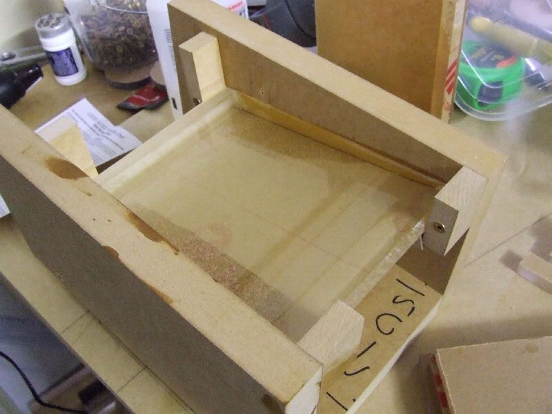

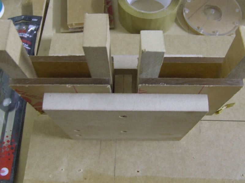

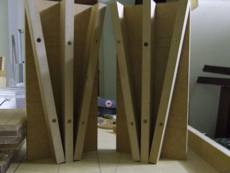

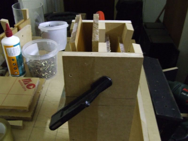

UPDATE:
The new full sized jig. The new jig is large enough to hold both the 6" x 6" and 6" x 8" Perspex plates. It is clamped together and can be used with ever wider pieces...
The only part that concerns me is the resin sticking to the jig, but I'm thinking lining the ends with baking paper should prevent that.
Stay tuned next week for the first pour...

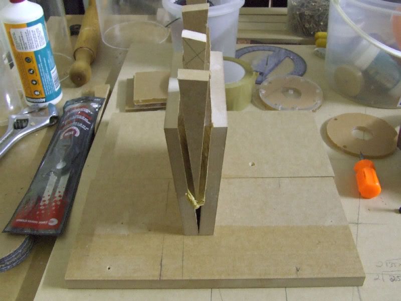

Solid Prism Update
Hopefully I will still get the first pour done this week. However speaking with several people about pouring resin, and I am led to believe that the jig I made and pictured above may not work.
The resin is a 2 part product that must be mixed correctly. To get the mix right requires a lot of stirring, and as one does so, one mixes air into the product. The air forms bubbles and they may or may not rise to the surface. Given that the jig makes a 6" x 8" prism, the chances of the bubbles rising that distance is pretty remote.
So I have made another "flat" jig to pour the resin into and then add the top layer of Perspex to.
To ensure the bubbles disappear, I have to run a butane torch over the resin. The heat from the torch causes the bubbles to rise and expand and hopefully they will all be removed before I lay the top piece of Perspex on to complete the prism. I am hoping that by slightly over filling the mold, that I won't trap more air under the top layer. I have also though about laying the top piece of Perspex from one end first, so that it pushes out the excess resin and hopefully the air as well...

Having build a few different jigs, I decided to try the 2 part resin that I posted earlier, just using the "flame" method and to see how this resin actually performs.
I set the jig and mixed equal parts A and B together. The stuff goes almost white with bubbles. By pouring down one edge rather than pooling in the middle makes some of the larger bubbles burst almost straight away. This mix is crystal clear
I used my girlfriend's heat gun to remove the rest which poped easier than I expected giving a glass like smoot finish.
And here is a picture of the first pour...
Mark
Mark
