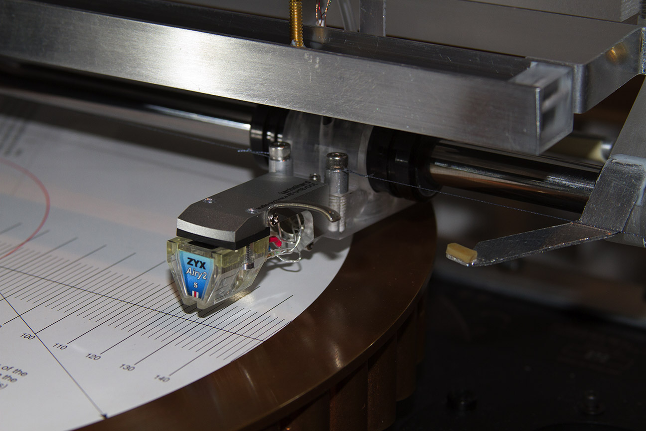

I have done some updates on my air bearing arm.

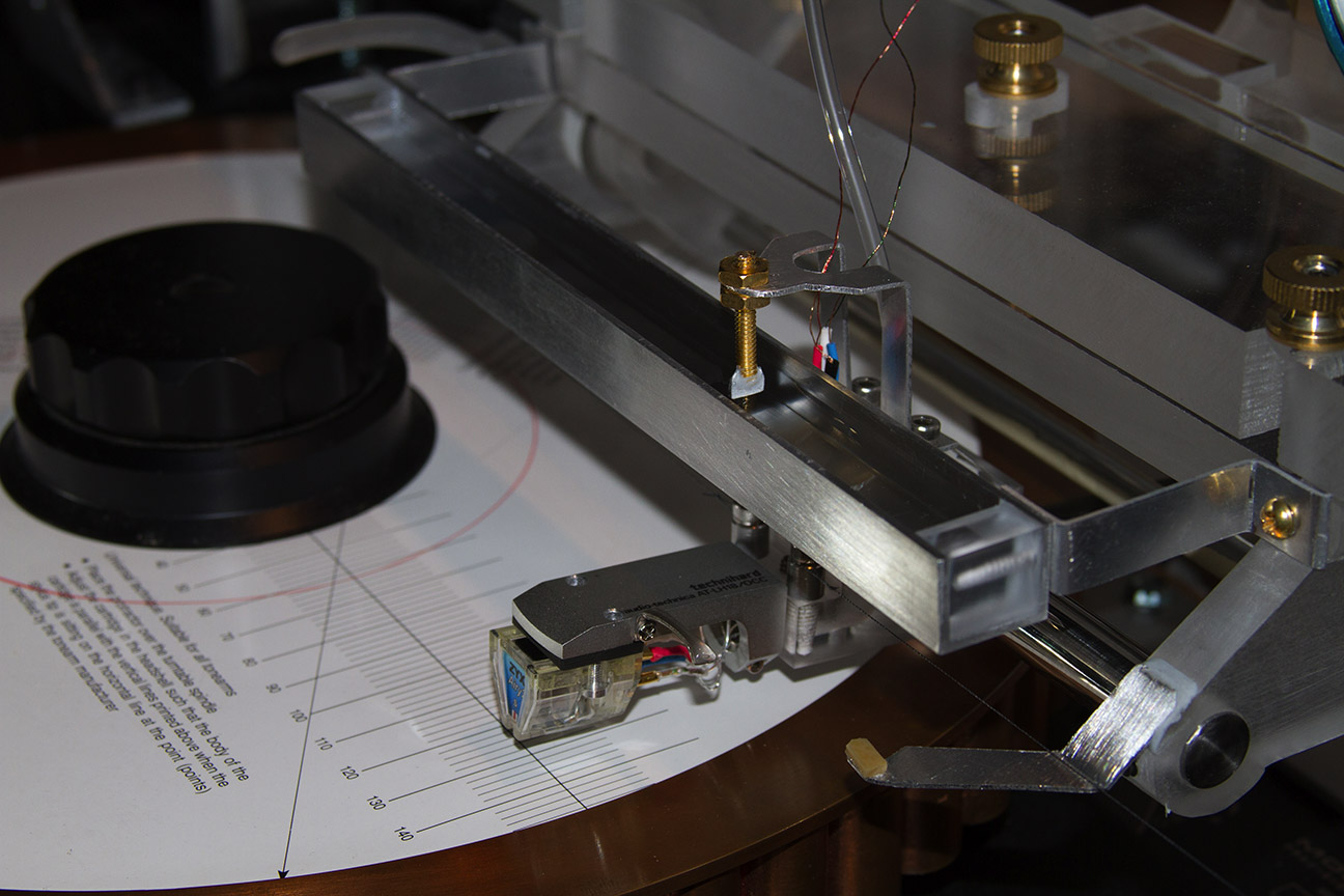

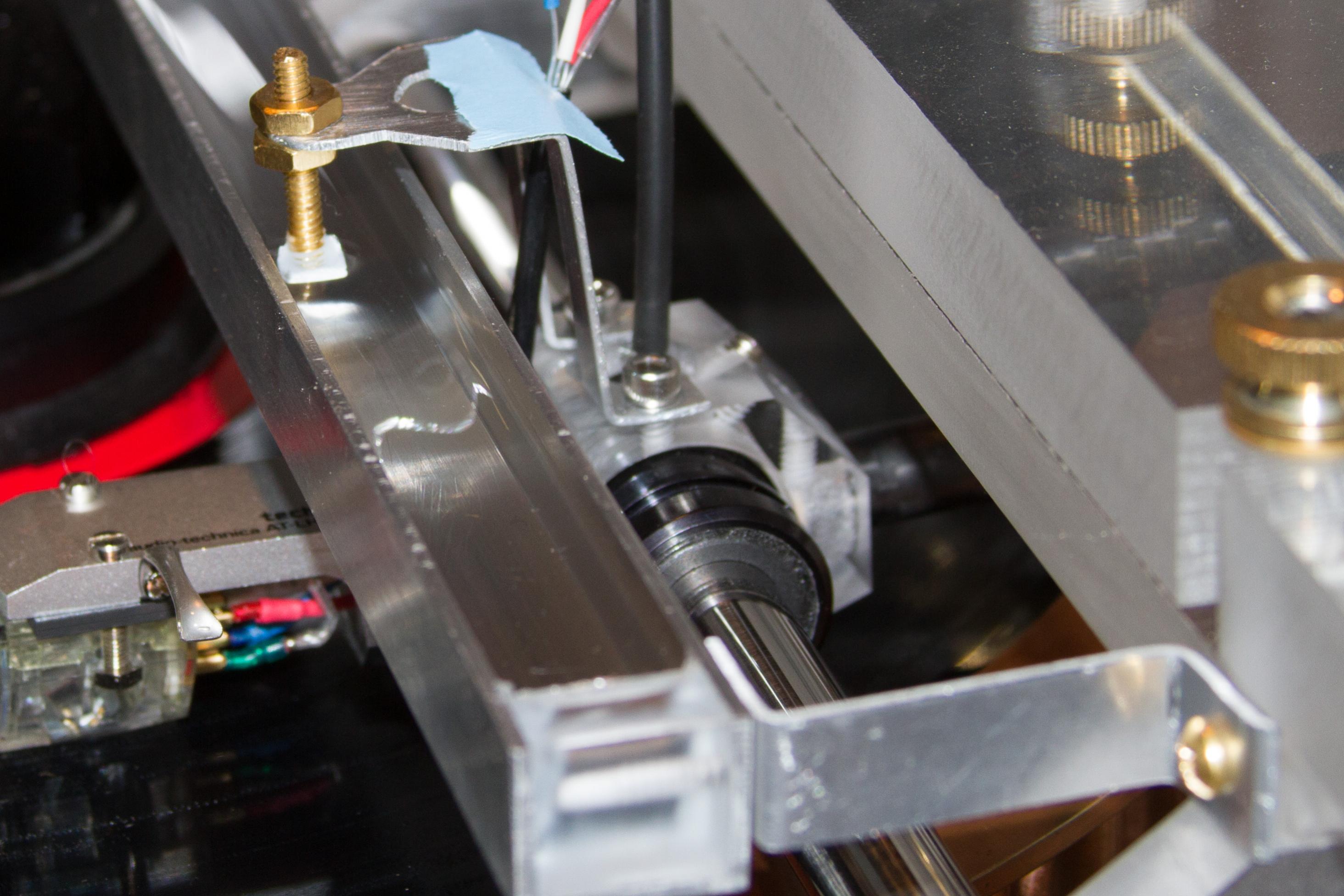

First, I added a silicone oil damping device. Please see the photo. I have tried 30 wt and 40 wt silicone oils. I prefer 40 wt. In the meantime, I reduced the weight of my own damping device, 1.2 g on right side and 1.4 g on left side. The silicone oil damping provides base while mine to compensate the difference of biasing.
I also did three different versions of carriages. From these carriages, I have learnt a simple but not so obviously fact. The tip of needle should be on same level as the center of air bearing or at least, to close to it as much as possible in order to improve the tracking ability. The carriage can be further improved by using aluminum. However, I don’t have tools to do it. If anyone has the access to a machine shop, please let me know.
Air tubing should be as flexible as possible. I tried three different kinds of air tubings. Air tubing has certain degree of damping function, but it is not good damping device because its resistance is not consistent while the cartridge is moving. It may introduce distortions, artifacts and peaks under certain conditions. Using air tubing as damping device is never a good option.
Pictured air tubing and carriage are not the latest ones.
My arm is very quiet now. Its sound is exceptional.

Hi Super.
Good to see that you're still busy. The aluminium headshell in the photos looks very tidy. How does the current one differ and is it sonically superior? Did you consider a Townsend style trough where the trough sits in front of the cartridge and an outrigger extends the headshell. The Townsend trough was designed to damping arm resonance rather cantilever resonance but with your arm it might do both. (not that you're going to have much arm resonance with such a short arm so just a thought) The Townsend design used 10,000cts silicone fluid which is rather high on the viscosity scale.
Keep up the good work and keep us posted.

Hi Niffy,
I can’t tell for sure how much the head shell improve the sound since I have been changing the arm frequently, but it adds convenience to change cartridge and to adjust azimuth. Here is a photo to show you the construction of damping device and how it attaches to the bearing. I ordered 60 wt(800 cst) silicone oil and am going to try it out. But I feel 40 wt should be fine.

What's the size and shape of the paddle in the silicone trough?
Yes. I have spent a lot of time to build the arms and put a lot of thoughts into the designs. It has been a process of fun and learning. There are many small updates I have tried which I never mentioned here. If anyone interested, please feel free to ask.
The paddle I use now is 5 mm x 6 mm rectangle. I am thinking of using different kind such as a 6 mm long and 7 mm diameter round rod. Doing this way will add damping vertically as well as horizontally. But for now, I don’t feel it will make big audible difference. However, this may be my next update.
For the damping silicone fluid, I tried 30 cst to 800 cst. I ended with a mixture of 30 cst and 3000 cst. I guess it is about 2000 cst.

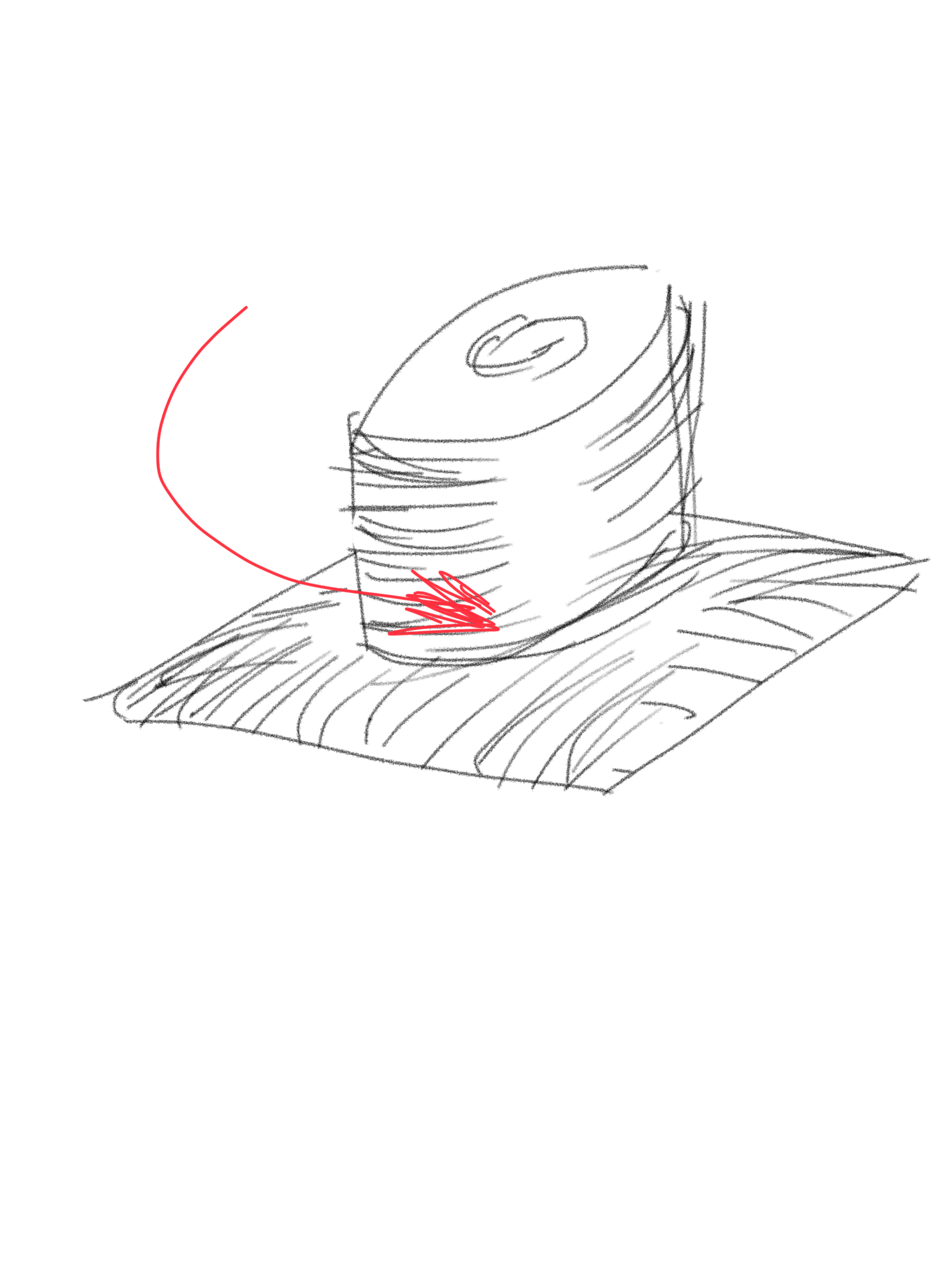

You got me thinking again. ;-) I am going to make a paddle as the drawing. This paddle can always have vertical damping. If I don't need horizontal damping, I can just turn the paddle 90 degrees as the red arrow indicates.
