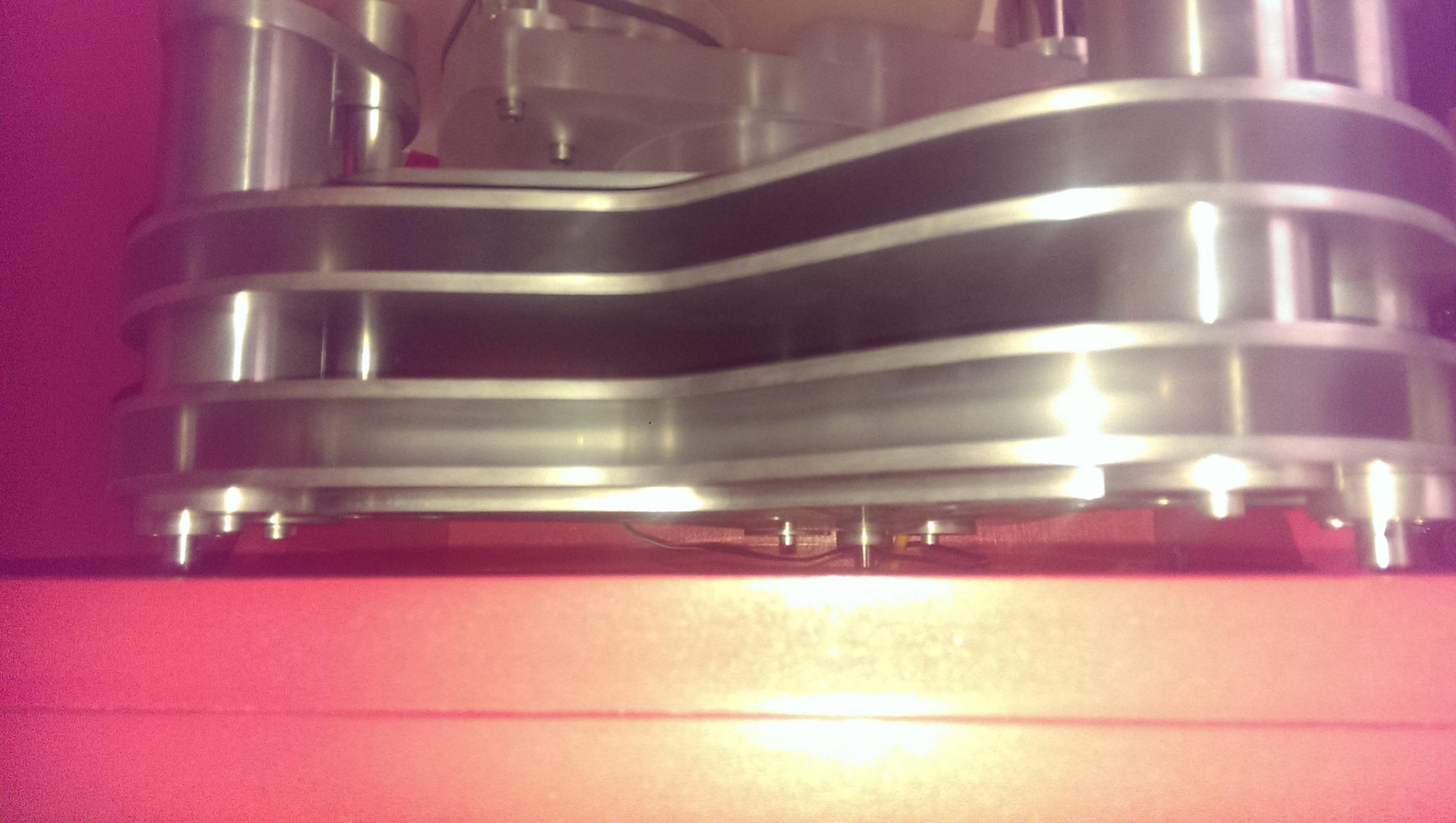

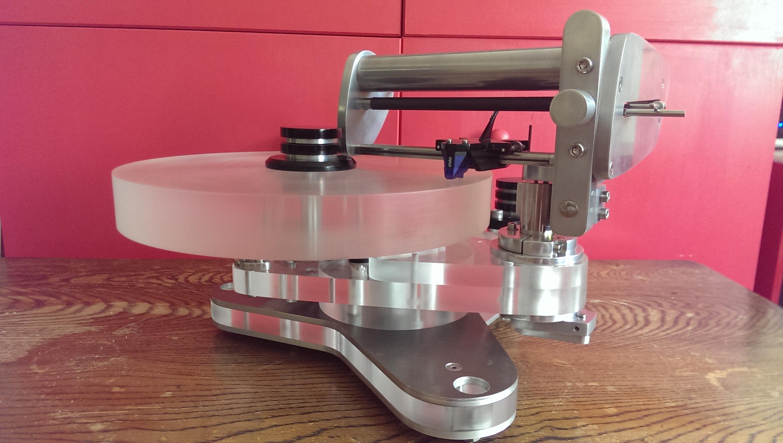

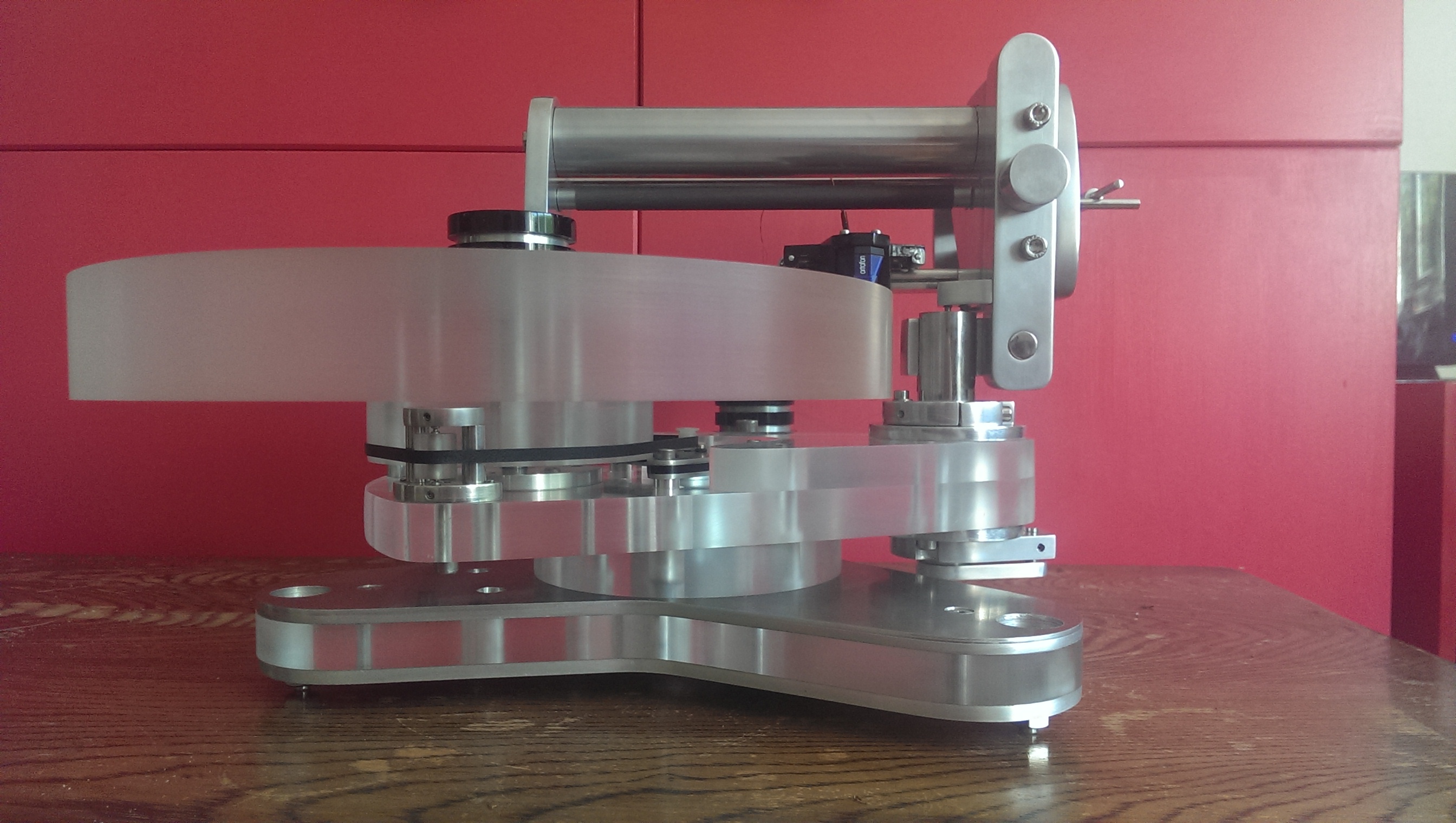

Suspension description
Hi Jim.
The purpose of a suspension system on a record player is to isolate it from external sources of vibration. These can be from many sources, vehicles passing outside, people walking, water in pipes but mainly from the speakers.
With a conventional suspension deck the arm and platter are mounted on a subchassis that stands on or is hung from some form of springs. The motor is either directly mounted to the decks plinth or is a completely separate from the deck in a motor pod. This style of deck has become less popular of late with the solid plinth style of deck becoming more popular. This is mainly due to a major problem with suspended decks that solid models don't suffer. The friction in the main bearing, stylus drag and belt hysteresis all create the torque that the motor has to drive. This torque twists the subchassis on its suspension and sets up an oscillation. The subchassis has a constant shimmy which can often create a problem as great as the one the suspension is aimed to cure. The normal way of combating this shimmy is by damping the suspension.
Damping the suspension seems like a good idea as if you bounce the suspension you want the deck to come to rest quickly. This view of how the suspension works has a fundamental flaw. It uses the plinth/ground as the reference point to which the subchassis is bought to rest. It is the vibrating ground that you are trying to isolate the subchassis from. The whole point of the suspension system is that the subchassis is kept stationary whilst the plinth/ground bounces and vibrates. The stationary subchassis should be the reference point. This is an easy mistake to make. Probably the best after market isolation platform is the minus K. Their website shows an animation of how their system works. Even in this the platform is moving whilst the base is stationary. Completely the opposite of what you want.
By damping the suspension what you are actually trying to do is bring the entire world to rest relative to the stationary subchassis and that just isn't going to happen. The suspension should be COMPLETELY UNDAMPED. A critically damped systems level of isolation is proportional to the driving frequency. With an undamped system the isolation is proportional to the SQUARE of this frequency.
When using the ground as a reference you isolate the subchassis from the ground, you attach the motor to the ground and then attach the motor to the subchassis with the belt. This is as open system.
By using the subchassis as the reference you isolate the ground from the subchassis and you isolate the motor from the subchassis. In other words you mount the motor on the subchassis. This creates a closed system, there is no interaction between the suspended deck and the outside world. There will still be a torque reaction between the motor and platter but this cannot effect the main suspension. This torque reaction is controlled by damping the suspension that separates the subchassis from motor. Also reducing the level of bearing friction reduces the torque and reduces this torque reaction.
"what about motor vibration" I hear you scream.
First imagine that you have a very noisy motor. In this case you would want to get the motor as far away from the deck as possible and use a long stretchy belt. Now imagine that you have an absolutely silent motor. Now you can attach the motor directly to the subchassis with out any fear and use a short belt. If the motor has a little bit of vibration a little bit of isolation would be needed. Above some level of motor noise it is better to have a separate motor mounting, below that level it is better to mount the motor, via an isolation, on the subchassis. Modern quite running dc motors and power supplies are below the threshold where moving the motor to the subchassis is desirable. On my deck using a mechanics stethoscope and listening for motor noise I cannot detect any at all anywhere other than directly on the motor itself.
Many idler drive decks and all direct drive decks have the motors directly attached to the platter usually without adverse noise. All solid plinth decks have the motor directly attached to the plinth/chassis even if it is only by the shelf the deck is stood on. If you stand a solid plinth deck on an isolation platform the plinth becomes the subchassis with the motor mounted on it. Mounting the motor on the subchassis is a lot more common than at first it seems but most manufacturers don't see it that way. The notable exception is funk/pink triangle.

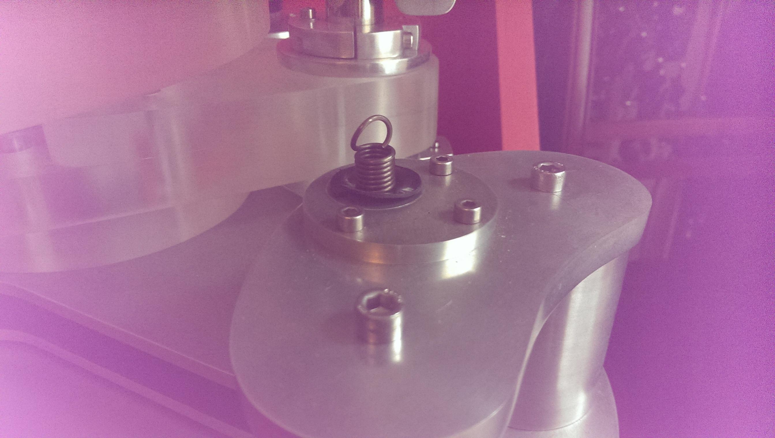

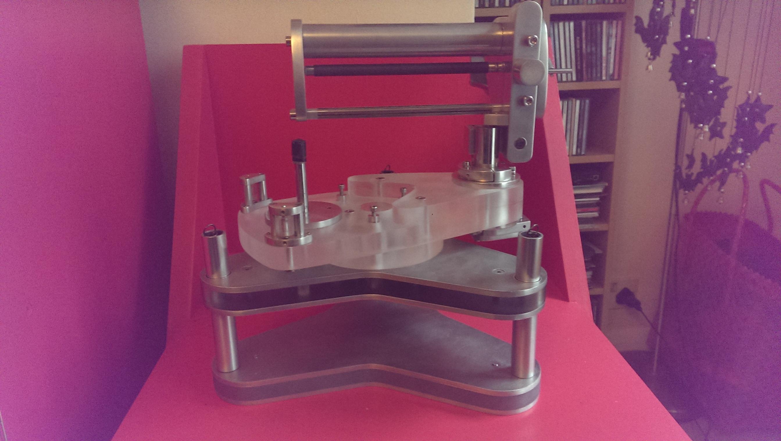

My deck can be seen as a suspended subchassis design or a solid plinth design with dedicated isolation platform. The plinth and isolation platform being fine tuned to each other. My aim is to get the best of both worlds.
My subchassis hangs from 3 steel coil springs and is completely undamped. Hanging from springs is dynamically more stable than standing on springs and the springs used can be much thinner which reduces energy transfer by sound waves traveling along the wire of the spring. The springs are set equidistant apart on the apexs of an equilateral triangle.
In most decks which hang from springs the springs are not equidistant. The subchassis is levelled by raising and lowering the point at which the spring is attached to the plinth. The load on each of the springs will be different. Changing the tonearm for a different one will change the load distribution. As each spring is supporting a different mass they will all have a different fundamental frequency and their level of isolation will be different. This will cause the subchassis to jiggle at many different frequencies all at once.
The total mass of the platter, arm, motor and subchassis (the entire suspended mass) of my deck has its centre of mass aligned with the centre of the suspension system. The weight is distributed evenly between the 3 springs meaning that the fundamental frequency of each spring is the same and all 3 act as a single unit rather than 3 disparate systems. Additionally my deck levels the subchassis by changing the length of the springs rather than moving them. If the centre of mass isn't exactly aligned with the centre of suspention and the springs are set to the same length the subchassis will slope towards the centre of mass and the fundamental frequencies will be slightly different. Changing the lengths of the springs until the subchassis is level will move the centre of suspension to align with the centre of mass and the fundamental frequencies of the 3 springs will then be the same. This allows for very easy suspension fine tuning. Here's a photo of the very simple spring length adjuster. The suspension is tuned to have a vertical fundamental frequency of 3hz. By the nature of how a mass suspended on a spring moves the lateral fundamental frequency is half this at 1.5hz.

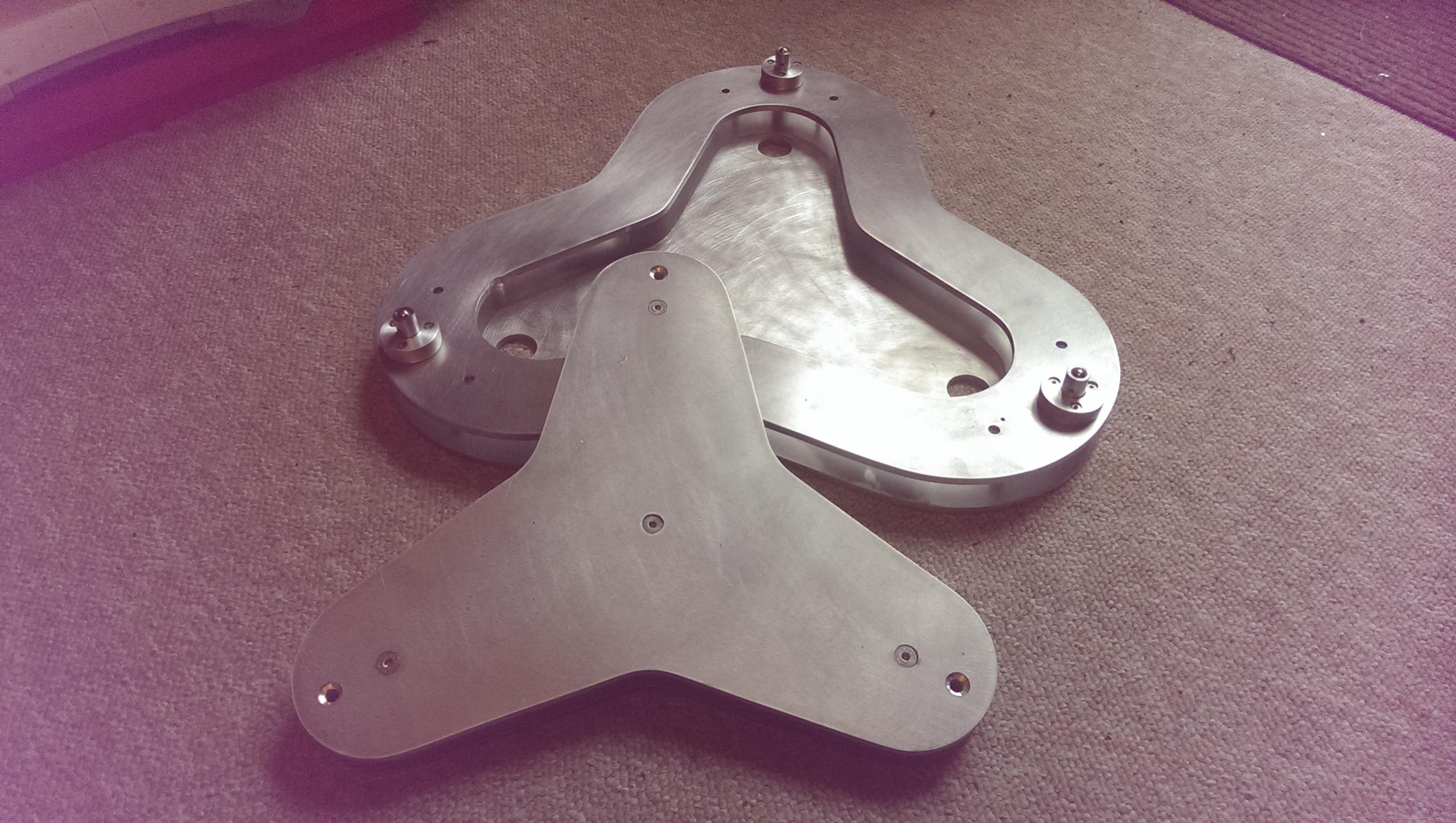

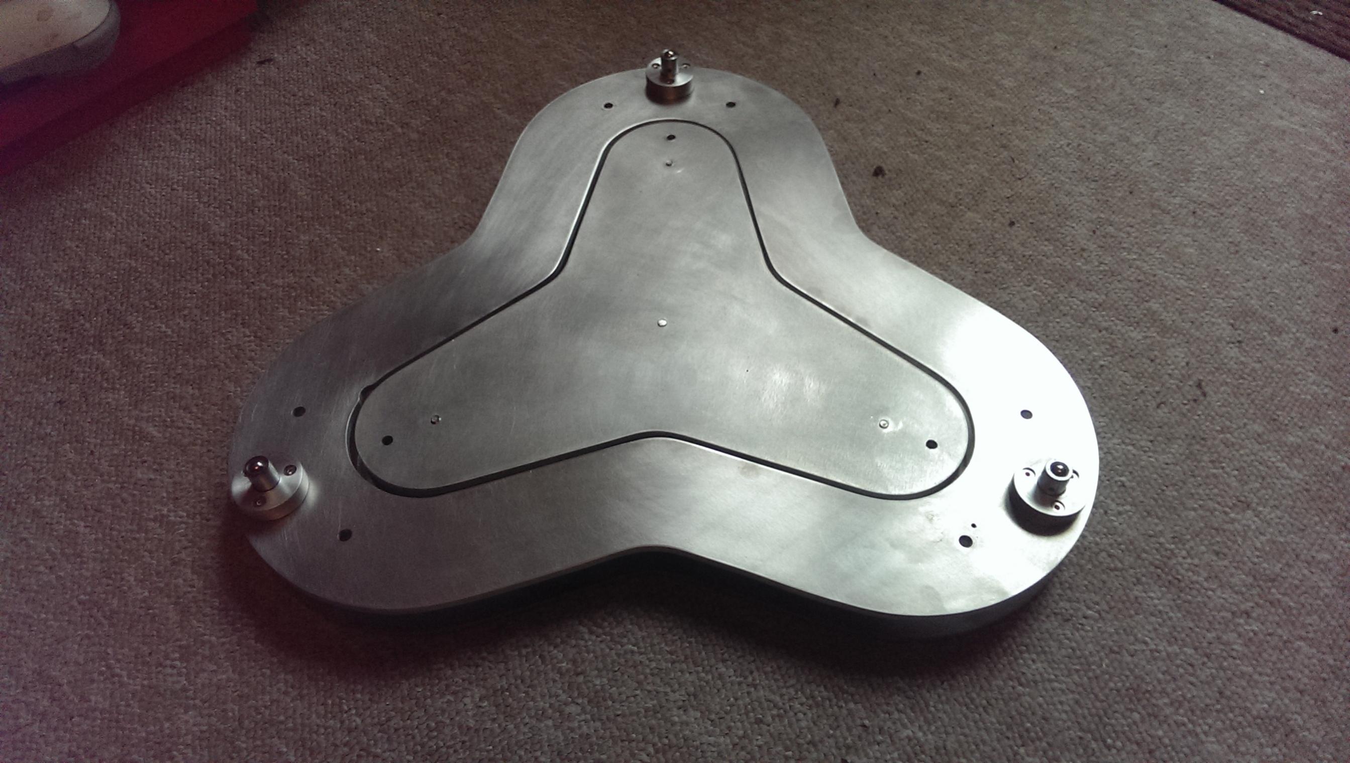

As I was building the deck I started on the arm then the platter, bearing and drive system. Having built these I mounted them on a temporary plinth. Then I tinkered and tweaked until I had the best sounding design. I then weighed them and measured where their individual centres of mass were. Using this information I then tweaked the subchassis design until the centre of mass aligned with the centre of the suspension system. I also, at this point, made sure that the motor sat at the centre of the decks suspension. This ment that the centre of suspension of the motors suspension system is perfectly aligned with the centre of the decks suspension. This helps to further reduce any negative interactions between the two.

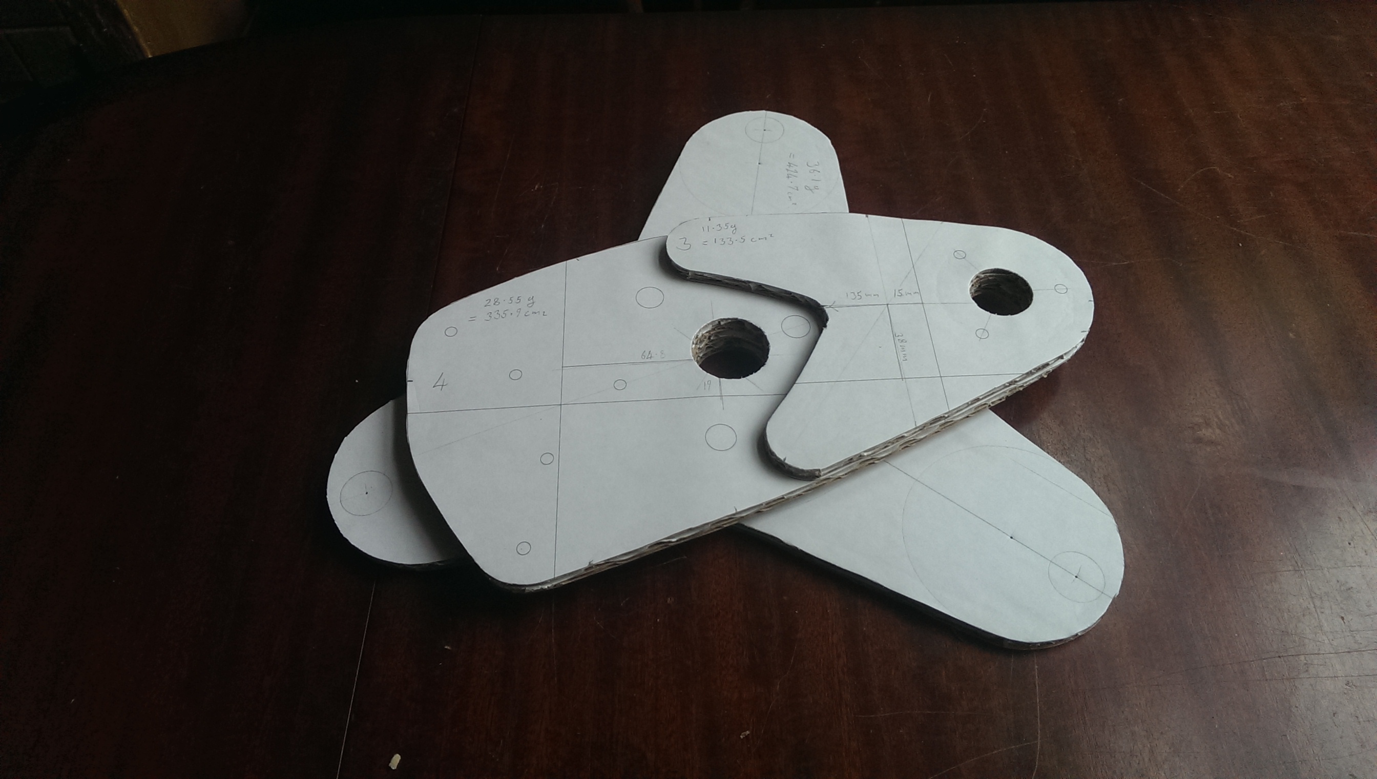

I then built the subchassis, the design of this is a subject for another time. The subchassis with platter, arm and motor fitted was at this point a solid plinth deck and was used as a solid plinth deck for about a year. Here are some photos of the deck at that time. I bolted spiked feet into what were to become the suspension attachment points. I've also included a photo of the cardboard template that I used whilst determining the subchassis's centre of mass.
If I were to just hang the deck as it was then from springs the centre of mass would have been way above the points where the springs attached. Any lateral movement would cause the subchassis to rock back and forth. The solution to this also has another big role to play that I will describe afterwards. A heavy counterweight is hung under the subchassis. This drops the centre of mass of the entire suspended mass to be level with the points where the springs attach to the subchassis. Having the centre of mass perfectly aligned with the centre of suspension make it very stable and maximizes its isolation performance. The counterweight sit in a recess within the lower plinth section and is not normally visible. Here are some photos. The first is of the subchassis/counterweight assembly removed from the deck. The next few shows the counterweight and its recess.

Continued
The other roll of the counterweight. A solid plinth deck grounds vibration produced within the deck into its own mass and that of the ground. Unfortunately that ground is a source of vibration, the very source that a suspension system is used to isolate.
The counterweight is a heavy lamination of aluminium and lead which gives it excellent damping characteristics. The counterweight weighs nearly 10kg, almost half the total suspended mass. It is attached to the subchassis by solid aluminium legs giving an easy path for any vibrations. The counterweight in this role acts as a floating ground that unlike the actual ground is not a source of vibration.
The entire suspension system is very stable and effective. The deck is now almost immune to the support it stands on. It sounds the same on a flimsy coffee table as on a solid stand.

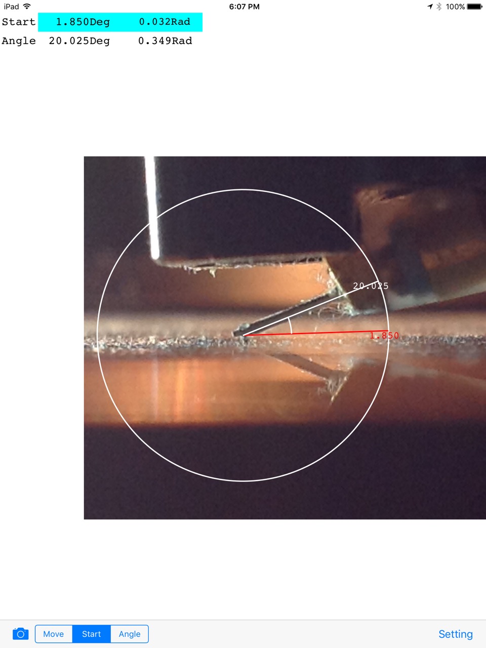

My journey to create the best sounding tone arm continues.
I have been trying different structures and materials for the head shell.
For the structure, I did three versions of head shells.
This is first version. I drilled holes from different sides. Then, I filled these holes with foam glue. But after listening, I realized it was a bit too much of damping although the head shell was very quiet. The sound was very natural with slight compressed sound stage. So, I took foam glue out of the head shell. It was an improvement with sound stage. But I was still not satisfied.
This is current version of the head shell. It is even 5 mm shorter than previous one. I did it from a solid block of 2024 aluminum. Its bass is further enhanced. Sound stage is excellent. However, background is not as dark as previous head shell. I am very happy with it. This is the version I will keep.
When I designed the head shell, I optimized it with the following measures.
1, I added two slots on the sides of the head shell. These two slots enable me to adjust azimuth and rough VTA. The reason I need to adjust VTA on head shell is I can let the bearing closes to surface of record as close as I can. Please see the photo.
The gap between the bottom of air bearing and record surface is about 3 mm.
2, I made A distance as short as possible. As I said before, the new head shell is 5 mm shorter than previous one.
3, I made the distance C as short as possible. It is now about 3 mm.
4, I made the distance B as high as possible. The head shell attaches about top 1/3 area of air bearing.
For material, I have been using 2024 aerospace aluminum for head shell and magnesium for the part which attaches the head shell and air bearing. I think it is a good combination with right amount of damping. I tried brass. It is another good material to use for head shell. But brass is heavy.

Love the look of your new carriage. I'll comment further in a separate post when I get a minute.
Niffy
Niffy
