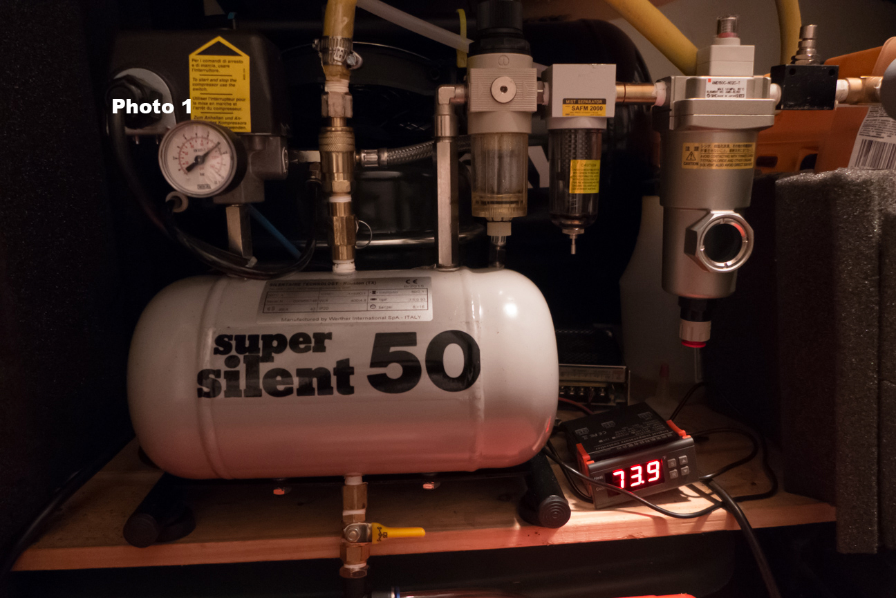

Photo 1. This is Silentaire TC-50 compressor. I modified the compressor by adding a 10 gallon tank. Big tank increases stopping time. I also added a flow control valve to minimum the air flow. For air bearing arm, it only needs high pressure but low flow. To keep clean air, I added .3 micron and a .01 micron filters to form a air filter stage. I also installed two PC case fans to cool down the compressor with a thermal switch. The fans will be turned on at 90 F.

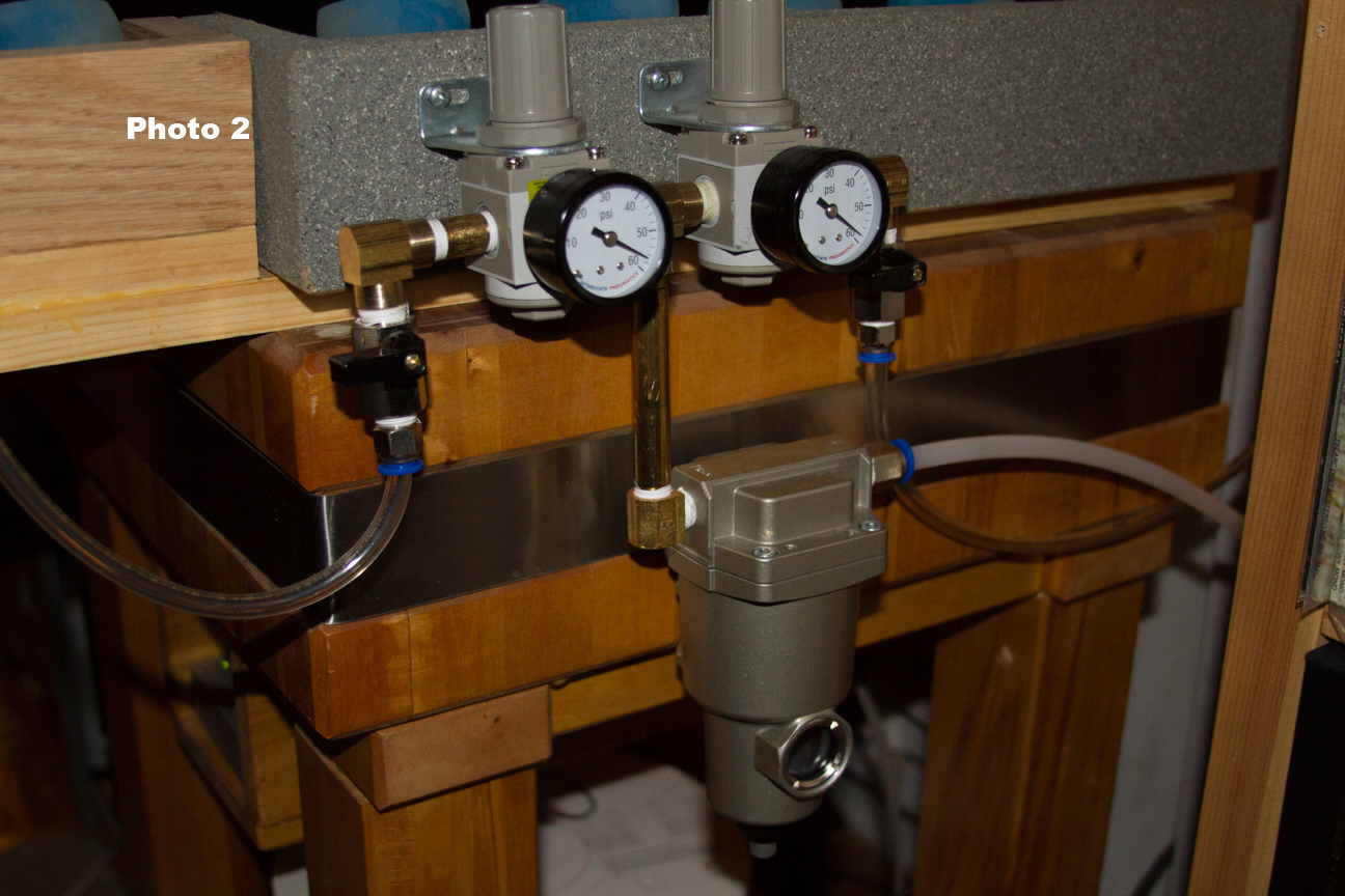

Photo 2. I use different air pressure for different arm. The moving bearing arm uses 52 psi and the moving shaft arm uses 56 psi. I also installed another .01 micron filter just before the air goes into the bearings to filter out the moisture.

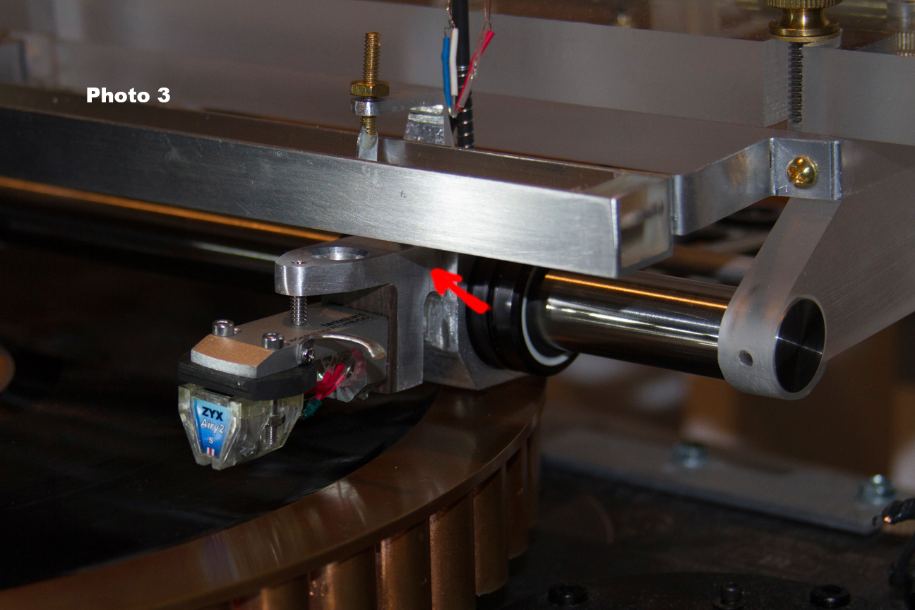

Photo 3. This is the arm which I call it as moving bearing arm because its bearing moves. The carriage is made from a block of aluminum. Someone in UK was very kind and made it for me with his CNC machine. The carriage is designed by me under the inspiration of other fine air bearing tonearms. The critical part for this carriage is its head shell in relationship with the bearing. I marked it with red arrow in the photo. This connection point should be as high as possible.
I made a piece of shim to put between cartridge and head shell. The shim is made of two pieces of 3 mm carbon fibers glued together. The propose of the shim is to eliminate unwanted resonance.

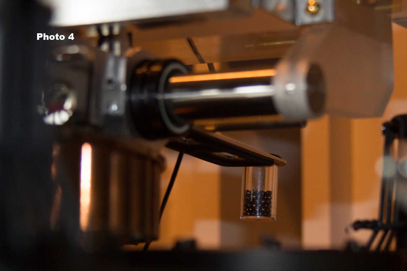

Photo 4. This photo shows the construction of counter weight. The tail which holds the counter weight is covered with double side form tape to prevent ringing, therefore, to reduce the noise.

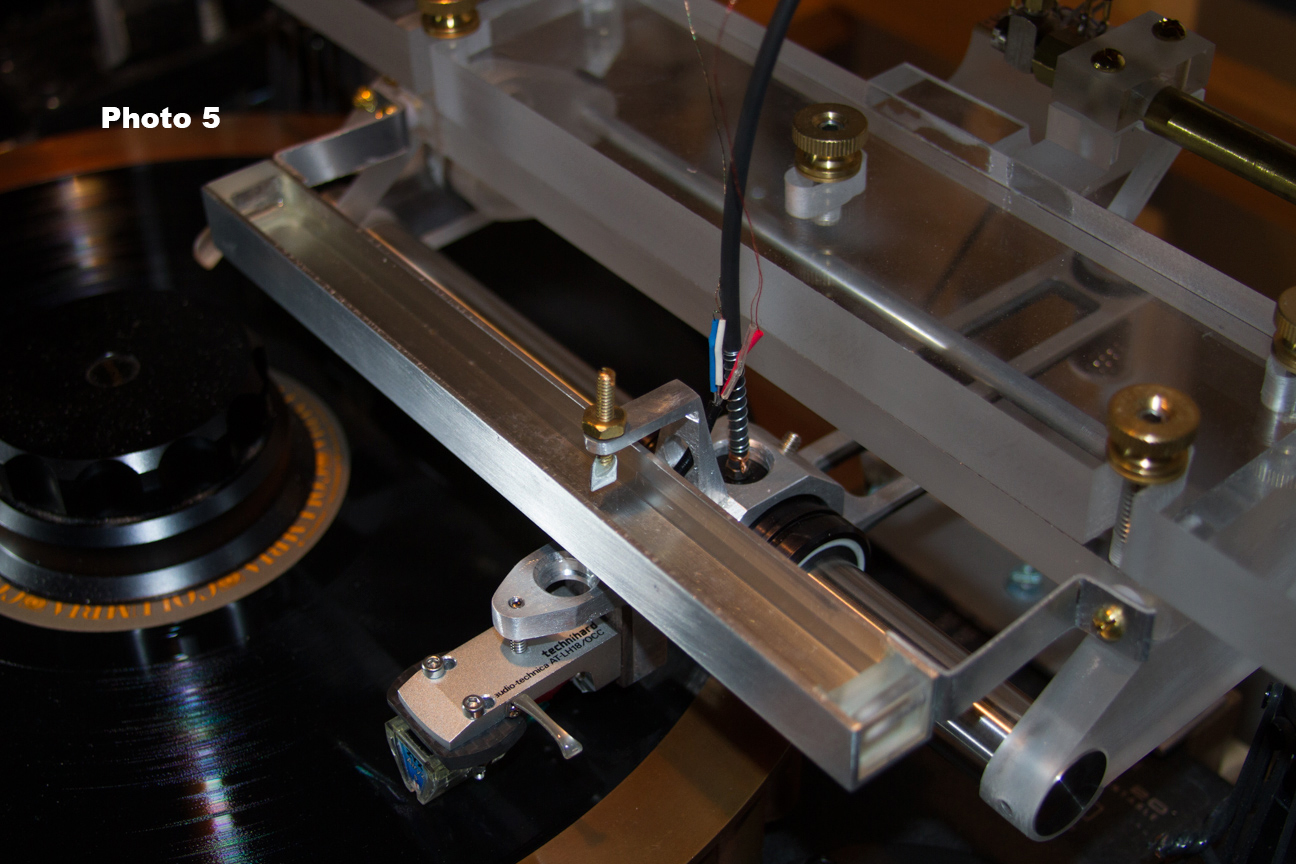

Photo 5. You can see the construction of bearing carriage from this photo. I use 1/16 ID latex tubing. Latex tubing is the softest tubing. But it can hold high pressure. The maximum pressure I can use is 52 psi.

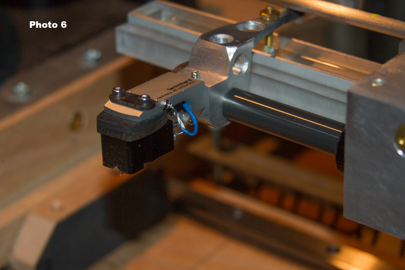

Photo 6. This is the head shell of moving shaft( because its bearing is fixed and shaft moves) arm. The shim is made of one 3 mm piece of African black wood and one 3 mm carbon fiber. I also tried to connect the aluminum body of cartridge to ground, but I can’t tell if it makes any audible difference.

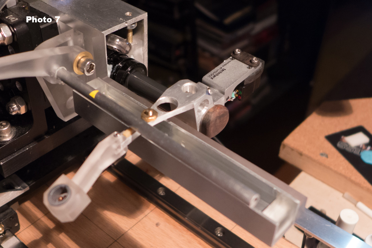

Photo 7. On the side of head shell, I glued a piece snake wood to reduce possible ringing.

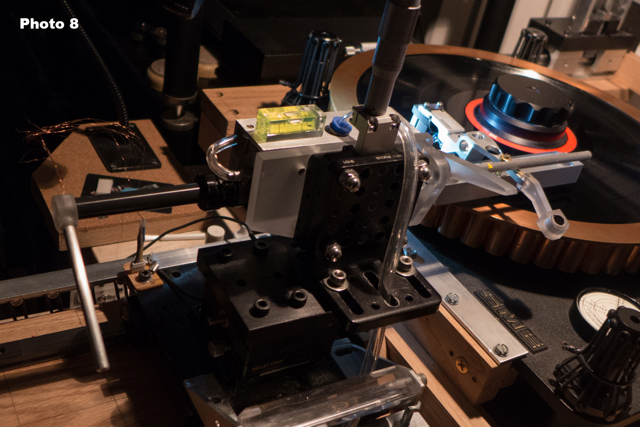

Photo 8. I changed the weight distribution of counter weight after I shot the video. Most of the weight is now on head shell area. I did this because I found that I could hear some distortion on the most inner grooves of some records.

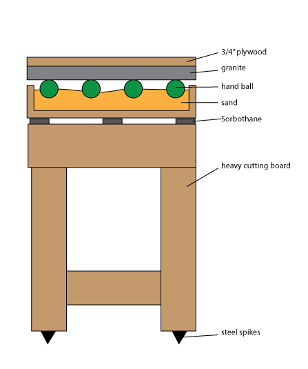

Actually, my table is sitting on a very heavy diy stand. I think the total weight is over 200 lbs. Please see the drawing for the stand. The hand balls are actually sitting in the sand. I used bicycle tire before. The problem is bicycle tire could not keep the air pressure for long time. I had to pump the tire from time to time. The stand makes huge difference for table like VPI, which has no suspension system. It makes difference for SME, too, but it is not as huge as for others because SME has nice suspension system.
So, back to the SME table, if there is varbration, it comes from mostly the motor which sits on the bottom plinth of SME table.

That's a good solid table design. The open sand tray is a great idea. I used to use motorcycle inner-tubes sandwiched between two paving slabs for my equipment supports. I never had issues with the tubes going down though I did find levelling them could be a bit tricky. I would still be using them now if it wasn't for WAF.
