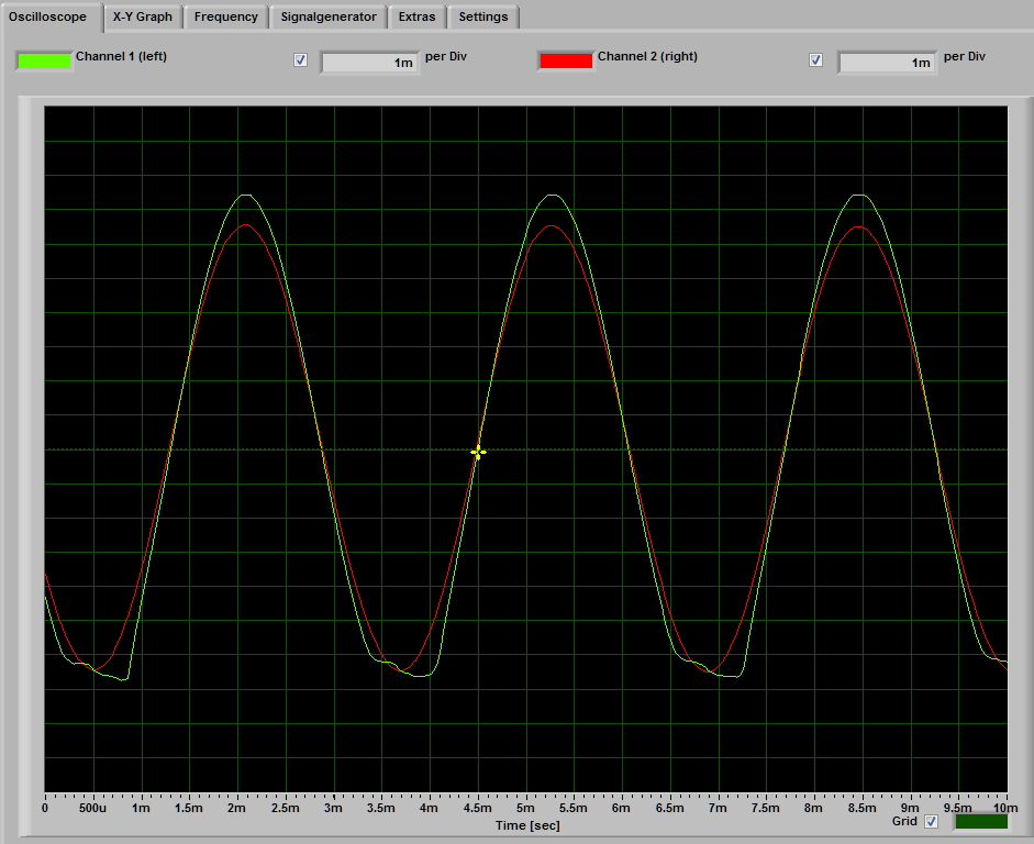

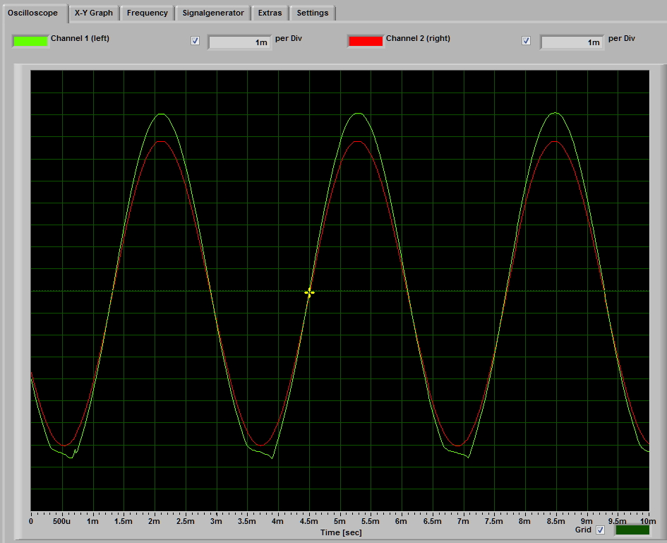

My tests show there is a fundamental misunderstanding about groove and stylus interaction for a linear tracking arm. This is important.
I did another test last night. Everything else was same as my 1st test except I use my diy ball bearing arm. The cartridge was Denon DL-103R, a low compliance cartridge. There was no damping device. Here is the results. Please see attached images. The distortions do exist in left channel only. It means that the needle was slammed onto right side of groove wall and lost contact with left side of groove wall.
The result is same as what I did on the air bearing arm. I believe that my tests are highly repeatable. Therefore, they are not tonearm specific. These tests raise questions which challenge fundamental thinking laying under linear tracking arm design.
The consensus for linear arm damping( or biasing) is that the stylus will be slammed either on left side or on right side. Therefore, damping should be applied on both sides with equal force. I thought the same until I did the tests.
However, my tests show otherwise. A stylus of linear arm will be slammed on right side of groove wall only. So, if the damping applies equal force on both sides, it won’t correct the problem. The stylus isn’t still centered in groove. This is why I said all the damping devices for linear arms on the market are not correctly implemented.
I would like to see someone else do the same test.

Your tests look more like lack of tracking weight, or dynamic mispositioning of sled is causing over deviation of cantilever positioning which is causing dynamic mistracking.
It seems that passive linear tracking is flawed due to too high sled/arm/cartridge masses, especially for eccentric discs.
Lowering moving masses will serve to raise system resonance frequencies up into audio band.
Sled damping needs to be velocity dependent, and not frictional.

I would disagree with this statement. I calculated the cantilever displacement purely due to carriage mass eg bearing friction, arm wires resistance etc not included. I based the calculation on my arm and cartridge with a record with a 0.5mm eccentricity which will cause the stylus to dance back and forth by 1mm, quite a severe case.
Carriage mass. 50g
compliance. 20um/mN
cantilever length 5mm
speed. 33.3rpm
This case would result in the cantilever being displaced by only 0.02 degrees. Well within the zone where the cartridge is still linear, in fact a lot less than the deflection observed due to groove modulation. With this arm /cartridge combination the cantilever resonance is just under 5hz safely above the 0.55hz driving force caused by disc eccentricity.
Passive linear tracking is not flawed and any short comings it may have are massively outweighed by the advantage of being able to utilize very short armtubes.

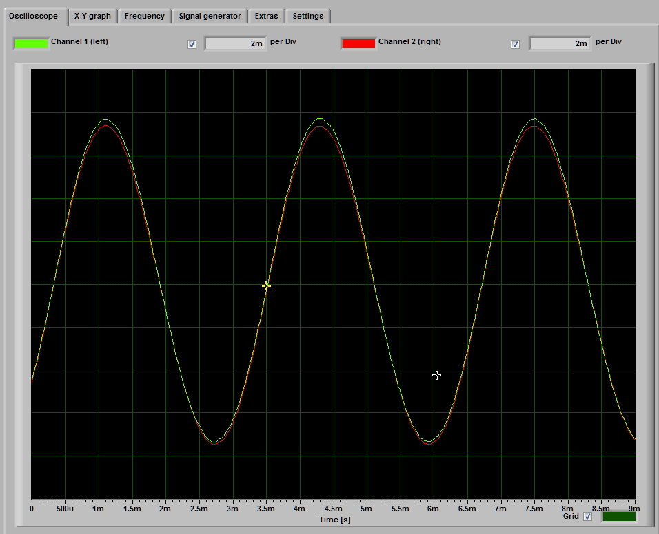

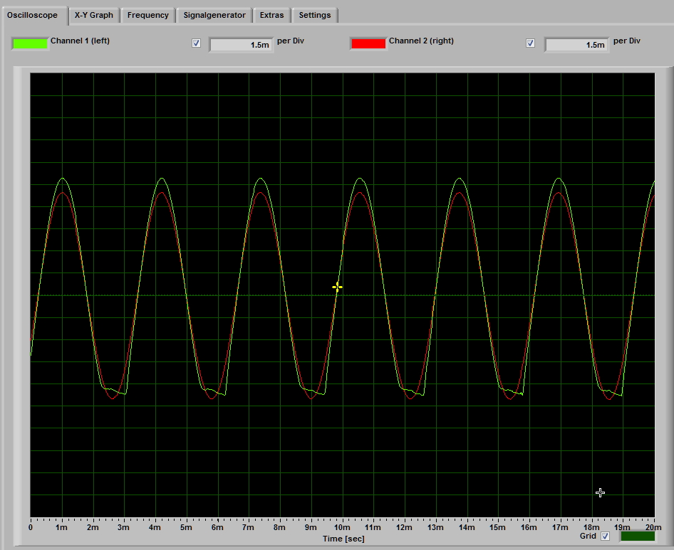

I did the test as you requested last night. I tilted the ball bearing arm less than 1 degree and adjusted azimuth to make sure the stylus is perpendicular to the record. Here is the result. Please see the image.
For air bearing arm, the distortion from left channel starts at about 7 db signal because frictionless bearing. Air bearing doesn’t have any damping. But for ball bearing arm, the bearing and glass rail are not frictionless. The distortion starts at 10 db. This friction acts as damping for the arm. If I tilt the arm more, the distortion will switch to right channel. It means overdamping(or basing). The stylus hits the left side of groove wall.
So, for an air bearing arm, damping is a must, but for ball bearing arm, you may get away without damping. However, you must realize that the ball bearing may have high friction since damping is not necessary.

Thanks for the test. The sub1 degree tilt has certainly improved the plots.
The result would suggest that the force required to track from outer to inner groove is significant even with a virtually frictionless bearing. This seems a bit counterintuitive especially as the distortion always appears in the left channel suggesting that this force is more significant than that due to eccentricity.
I Have the begining of a theory as to why this may be but will have to think on it a bit more before committing it to paper.

I don’t think the stylus lacks tracking weight because the right channel is almost perfectly tracked. VTF was correct. It isn’t caused by moving mass either. The cause is the interaction between groove wall and stylus. I can do another test to approve my point. But I need to change the cartridge to a cheap one. I will run the cartridge on a grooveless disk. I expect that the cartridge will be stationary and will not move sideways.
A cheap ink jet printer can do 600 dpi or 1200 dpi. The resolution is well enough for tracking records, but the tracking system may be very difficult to implement for diyers. I am sure active tracking arm will have some kind of problems too.
I don’t think the linear tracking arm’s mechanism is flawed, but little complicated.

Tilting the arm means adding damping force(biasing) on left side of groove wall. Therefore, the distortion on left channel is gone. For right channel, the stylus is being slammed on the right side of groove wall. Extra damping is not necessary.
I think the bias applied buy the tilt is more significant than any additional damping effect.

I don’t think so. On a ball bearing arm, you may tilt the arm because the distortion starts at about 10 db. It means ball bearing arm is ok without additional damping for wide range of dynamics. But the degree of tilting is limited. And, you may tilt the arm only if the friction exists. For air bearing, it is frictionless. Its distortion starts at about 6 db. It means that it has narrow coverage of dynamic range without additional damping. And, the distortion is much more serious than ball bearing arm without additional damping. However, it doesn’t mean ball bearing is superior over air bearing. Air bearing is the best mechanism for linear tracking arm for many reasons( we are not talking about active tracking here).
