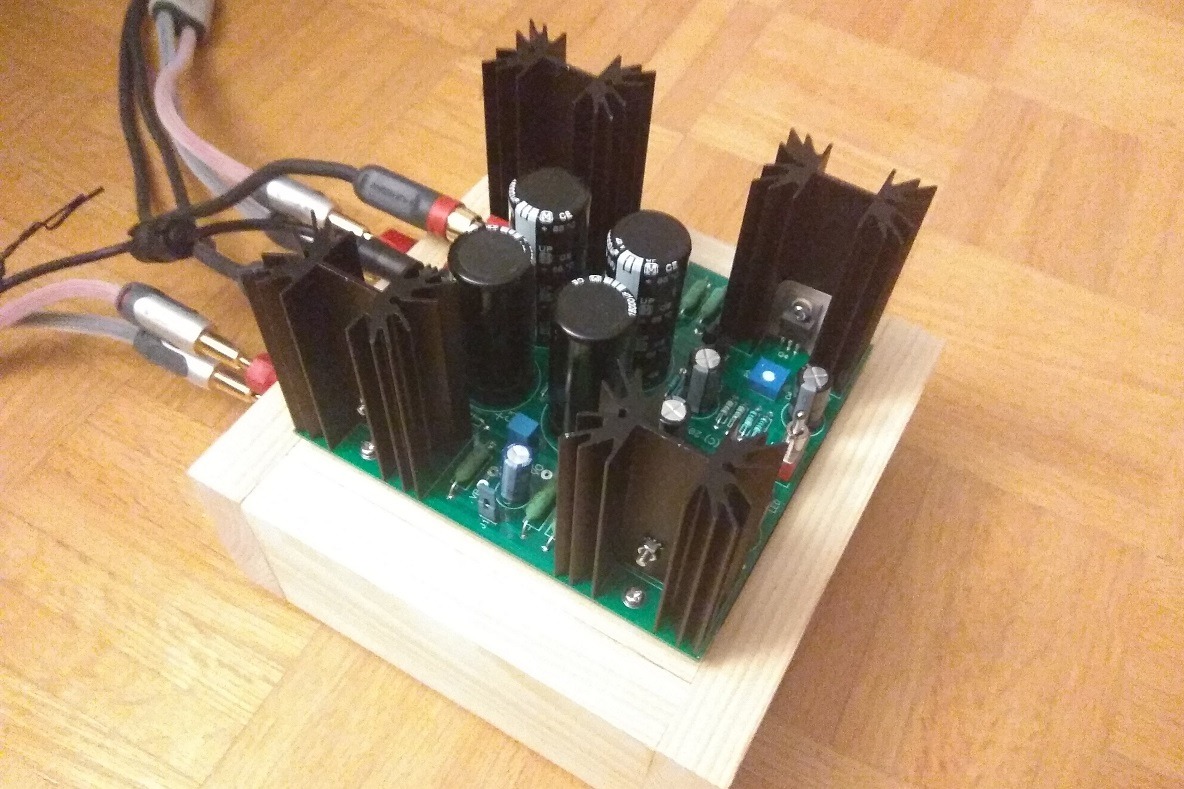

Being a headphone guy, I couldn't resist listening to the ACA Mini through headphones. I made a XLR 4-pin connection with open wires on the other end (since most of headphone cables are balanced), and hooked them into the speaker out of the AC Mini. My first impressions are "nice". Well rounded, full sound. I might even like it more than the WAMMY! Not as good as the Mainline 😉
There does seem to be some noise when RCA cables are plugged in, but silent with nothing plugged in. I have to explore. Maybe it's a grounding issue.
If I get my act together, I think I will build a little wood case with both speaker posts and a 1/4" switched jack.

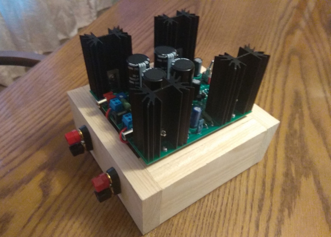

Thanks for Papa's generosity, I was able to build one yesterday.
I also made a small wood base and added some binding posts.
I look forward to playing around with the jumpers over the holidays.
This is going to be fun.

Nice! I like the binding posts you chose. Sleek and clean.
