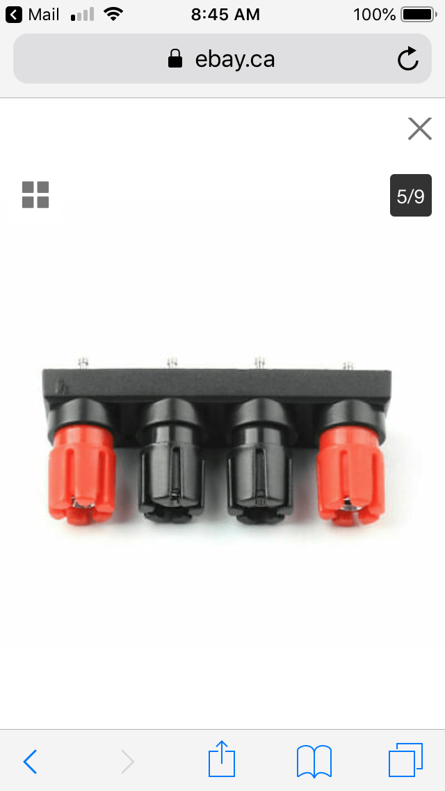

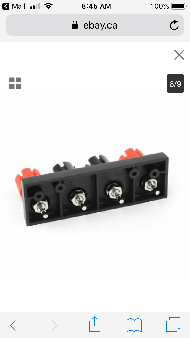

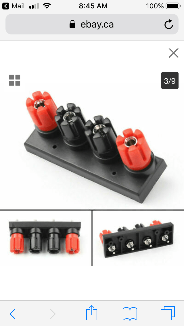

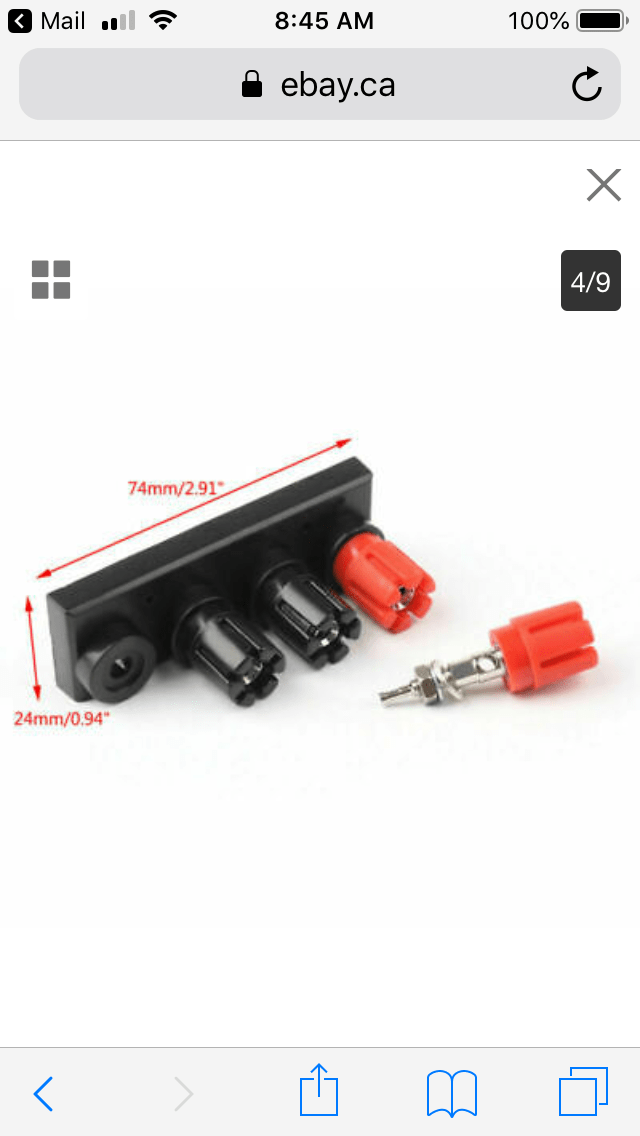

For those of you like me who prefer not to have flying leads binding posts for the output I just found this easy to use terminals. It will be a great solution for folks who have just like me, thick wood plinth as enclosure. You drill 4 holes for your wires and 2 more to hold the terminals in place and you’re done.
https://www.ebay.ca/itm/403297690462
I’m not associated with this seller, first time I buy from them.
BR
Eric
