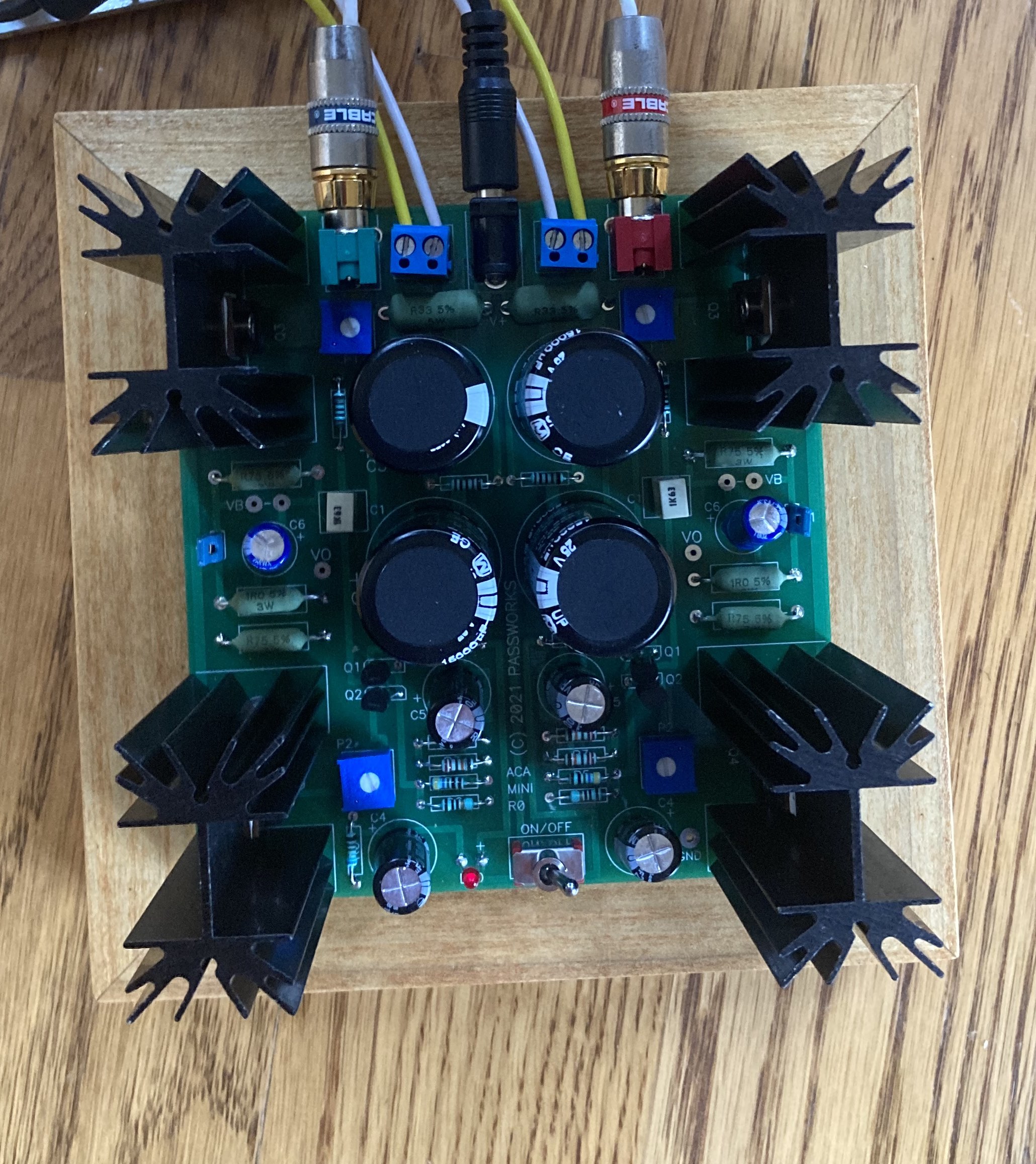

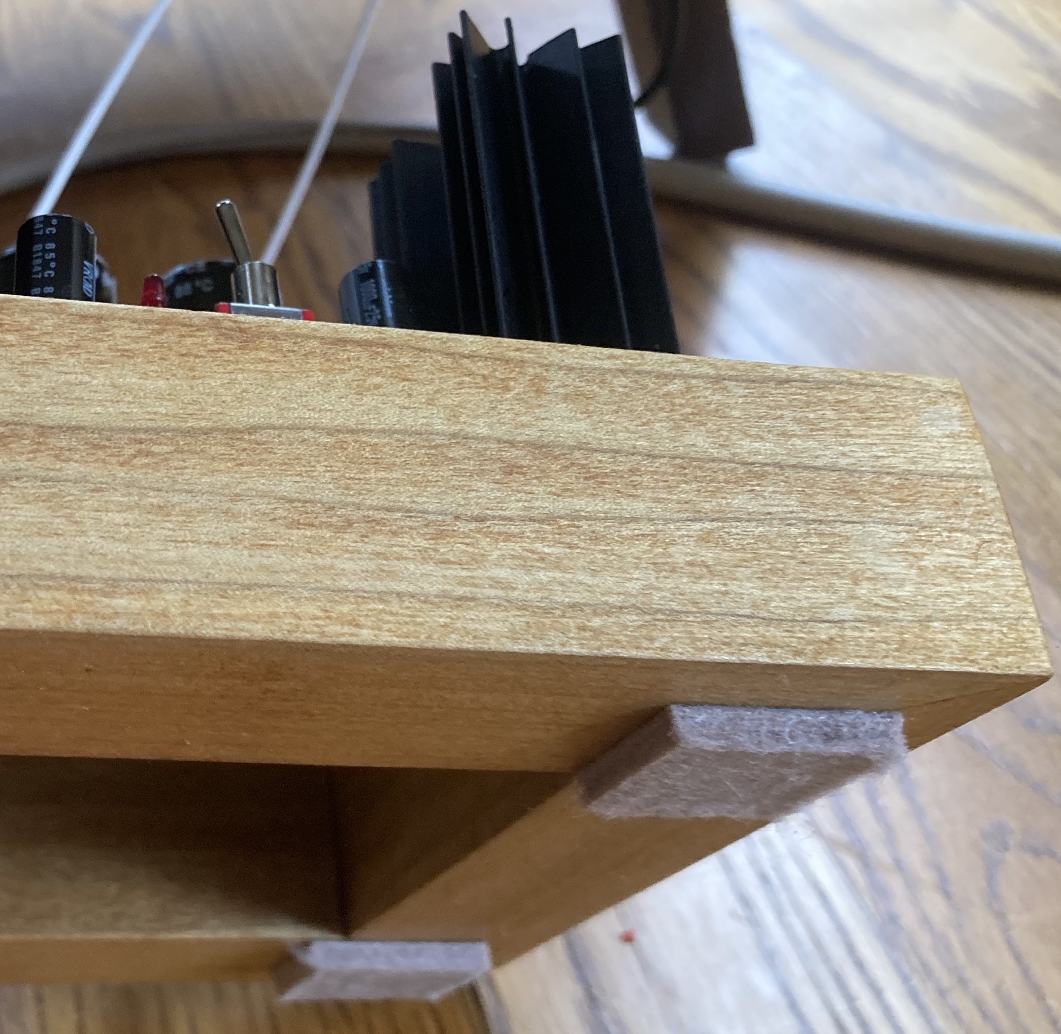

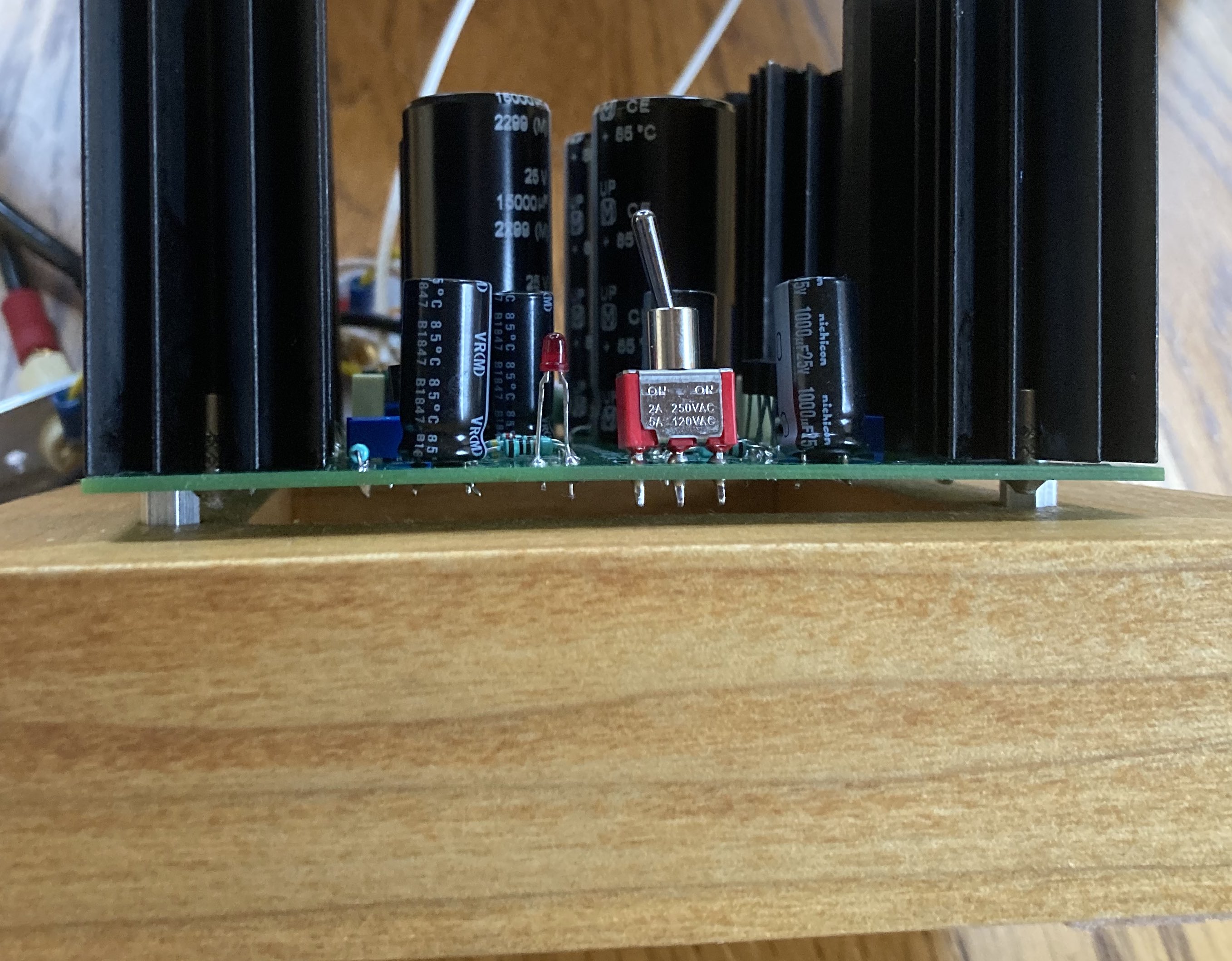

Here is my base with wood finish drying. 2x2 poplar from HD 8$. Four holes 0.3 inch deep, the Al standoffs have slight interference on the side so they can hold the pcb w/o glue. It is deep enough so the PCB is couple of mm off the base I will eventually pay tribute to ZM and secure the standoffs in the base with JBweld. 😀
Self sticking felts would be installed at the bottom.
I lacking the proper 90 deg clamping tools so one of the miters moved slightly during glue up but whatever, once the pcb is mounted no one can't tell.😉

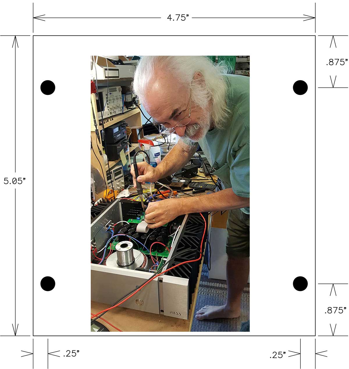

So members can get on with making a spiffy wooden base (or some other exotic material) while we wait for kits/boards in the store, can someone who has the kit already share the exact size of the pcb, thanks - inches and mm would be great to suit all members.
