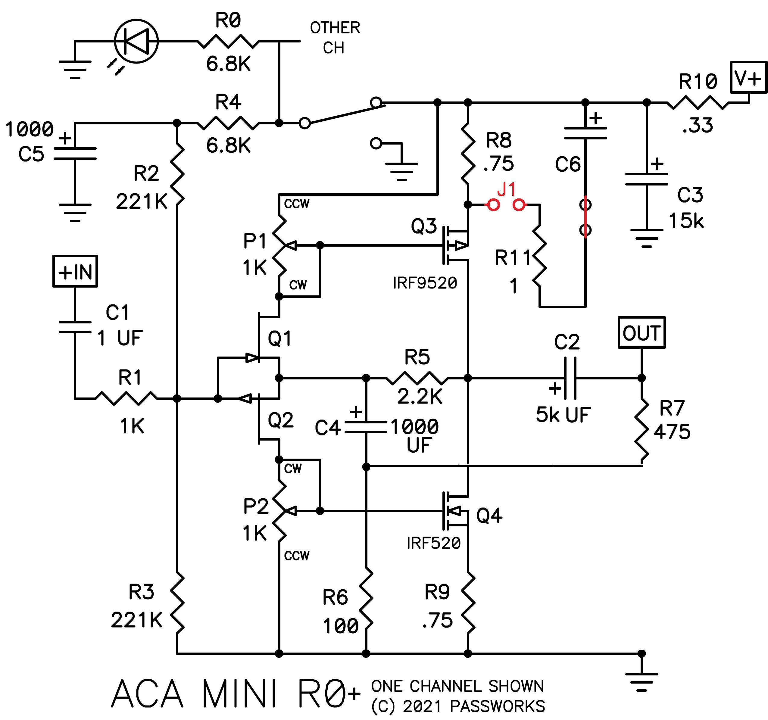

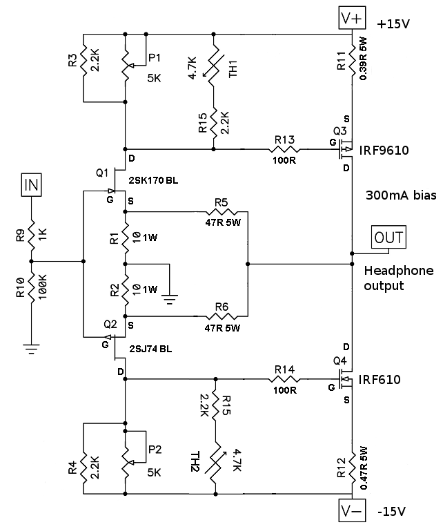

I was wanting for this questionI know it would complcate the design and raise costs but... could the single ended supply be changed to a bipolar supply? And in so doing connect C4 to ground and omit C2? Would that work?
It seems that it should. Does anyone more knowledgabla than me have any thoughts on this?

Can the IRF9520, IRF520 MOSFETs, from Vishay or Infineon, be used for this amp? or do we only need the MOSFETs from Harris corp only?
I am sure you can use IRF9520, IRF520 from Vishay or Infineon!

Franz is correct. The specific manufacturer is not critical it all.
but matching is? in terms of having fun with the "distortion jumpers", it surely will sound good either way : )

Matching Shouldn't matter. You adjust the bias of each MOSFET to the suggested bias in the writeup. Getting a couple of each MOSFET from the same.source like mouser etc most likely means you'll get them from the same batch anyways.
Traditionally the Harris are the premium part, especially for the lack of the "P channel distortion" of the IR parts, as documented in my old article on testing mosfets, posted at FIRST WATT.
More recently I have seen some samples of IR (Vishay) P channel parts without it, but it is random and not clear what difference in sourcing accounts for it, in spite of request for such information.
So if you are in a position to test parts before buying or if you apply plenty of feedback or don't care then you can go ahead. I find it simply easier to buy the nos Harris parts much of the time, particularly for Common Source operation with low feedback.

Hi Sir, thanks for the detailed info.
Also could you please tell, whether we can use the JFETS 2SJ103-GR & 2SK246-Y , for Q1 and Q2, in mini ACA. If yes, will it have lesser gain/output power ?
And does these two JFETs and output MOSFETs needs to be matched.
With slight rearrangement of parts we can mitigate some of the notorious audiophile fears that arise in this lovely circuit - trading places of C4/R6 enables us to introduce second feedback loop (R7/R6) which encompasses both feedback cap C4 and output coupling cap C2 (which now can be of smaller value, say 4,700uF) so that cap's influence on the amp's sound will be constrained. Also, R5 changes value to 2k2 and R7 to 470 (475) Ohms.
Easy trick to try...
