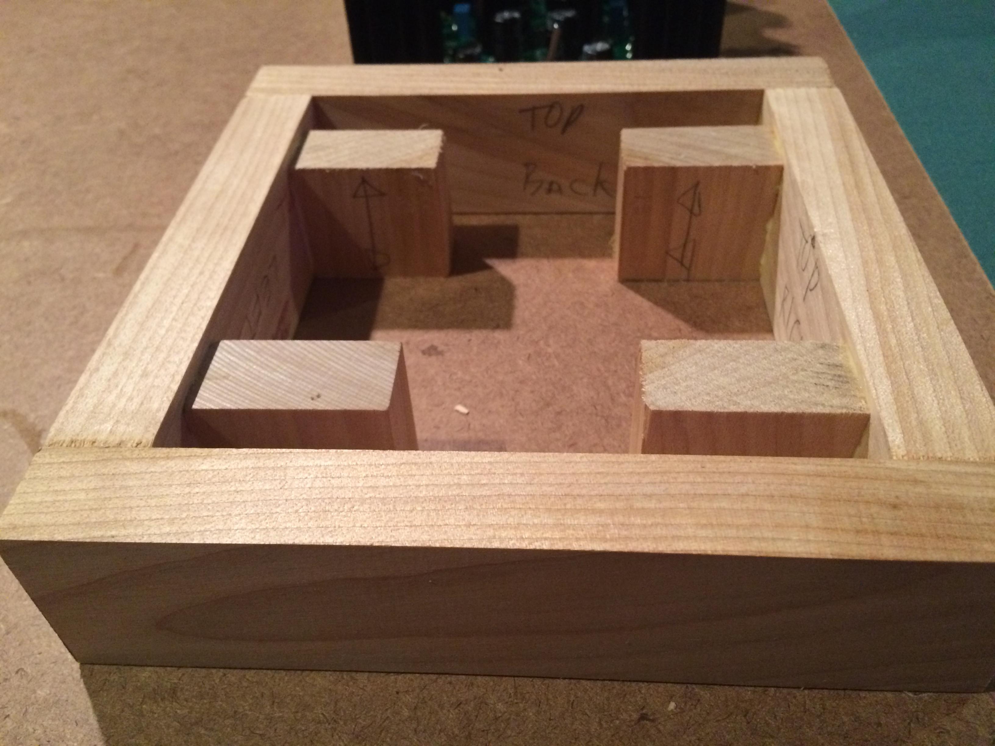

how is the pcb attached?
I have added 4 wooden support that are the height of the sides minus 1/8” (3mm).
They are located under each heatsink, I’ll just use some wood screws to hold the
P.s. I have of course removed the 4 stand-off that came with the kit.
Eric

I was thinking to do something like that but to drill holes where the standoffs would go into. Holes would be deep enough so that pcb is flush to the frame height. That way the pcb can be removed at any time.
...or do none of that and use JB weld 😉 😀
The whole wood base thing is in keeping with the low cost ethic, and fits the “tube amp look”
And more practically, enclosing the heatsinks in any way will raise their temps a LOT.
The need to be free! Or if enclosed maybe a fan?

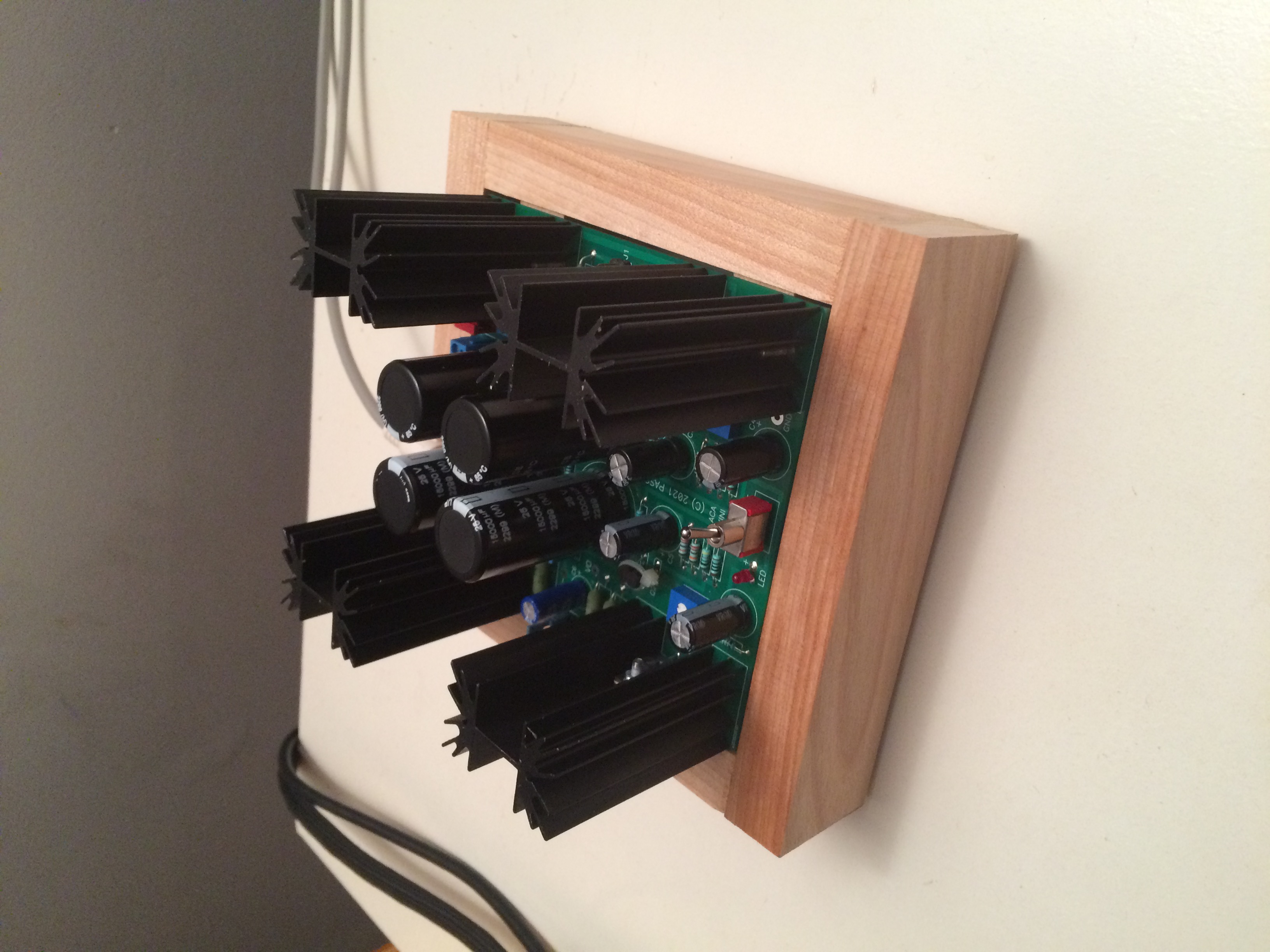

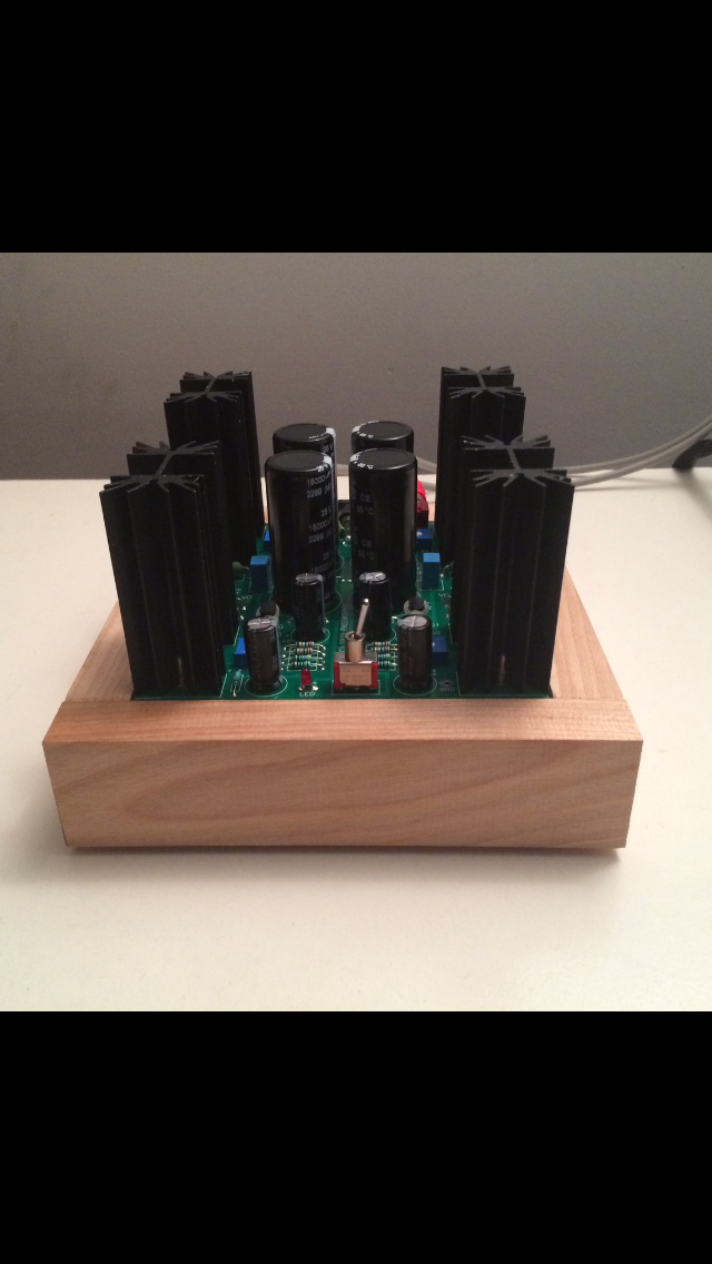

Keep some distance from the heatsink to the wood plinth, see pic below of final assembly, I have a 1/16” (1.5mm) all around the PCB. The heatsink doesn’t touch the wood so it’s all good. My bias is set to 0.45A with each heatsink between 53-55C in a 22C ambient.
What an awesome little kit.
Eric
