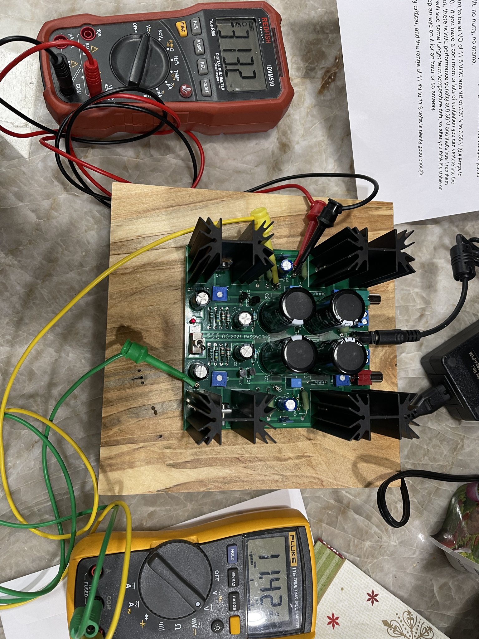

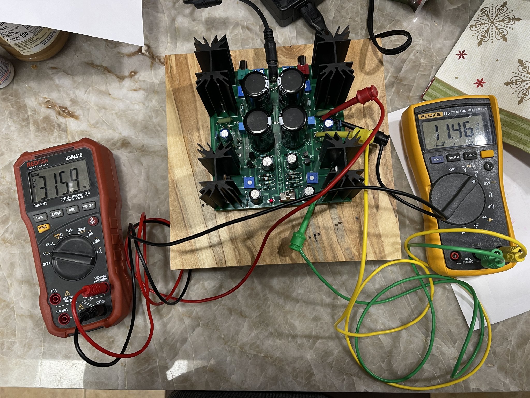

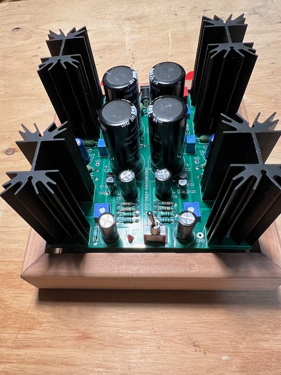

Thanks for Papa's generosity, I was able to build one yesterday.

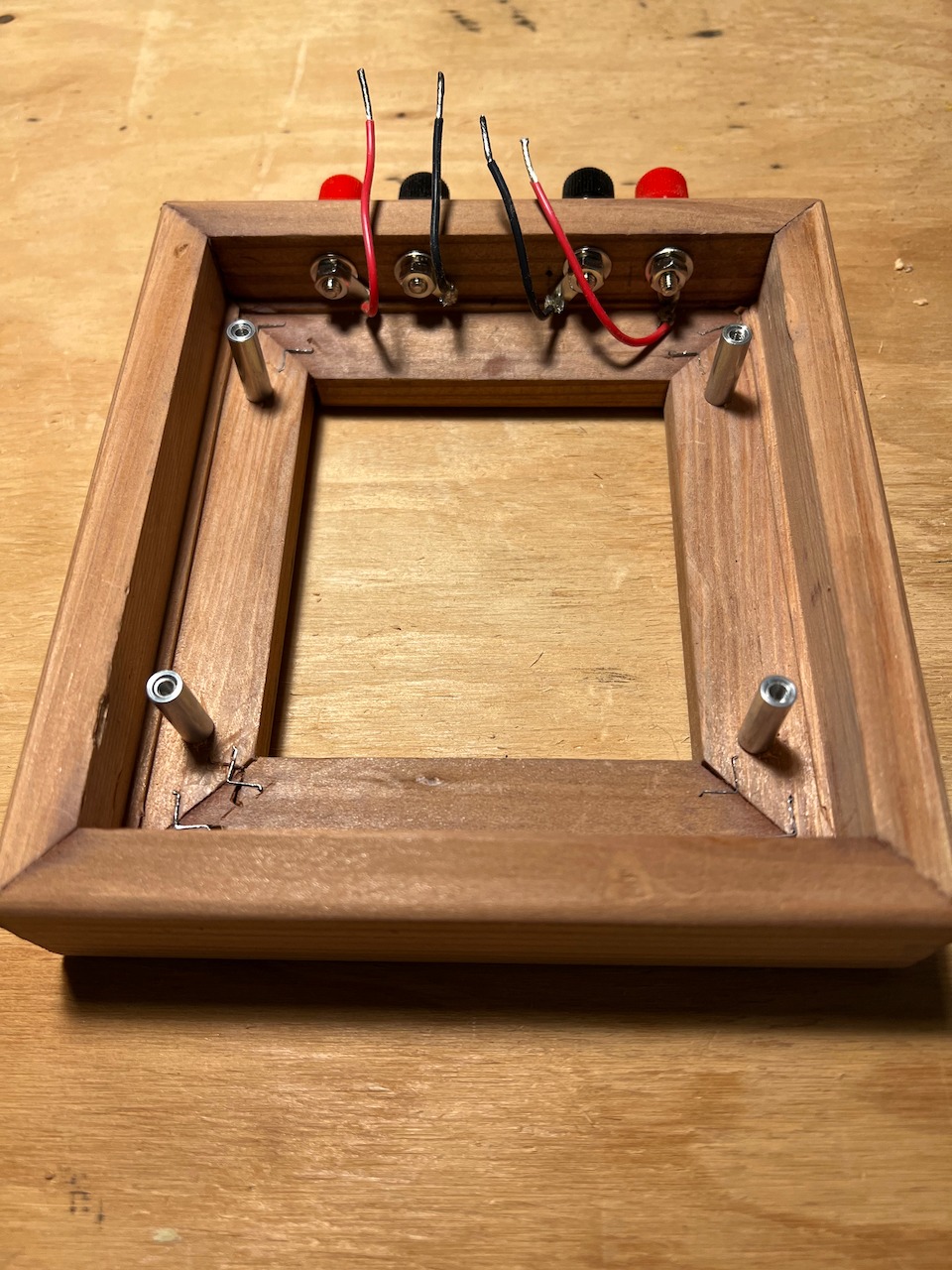

I also made a small wood base and added some binding posts.
I look forward to playing around with the jumpers over the holidays.
This is going to be fun.
Looks great! Any listening impressions? Jumpers in or out? I see you used insulators on you output mosfets. I m using a smidge of thermal grease to ease the heat transfer. The heatsinks seems to be hot plugged by soldering the studs anyways.

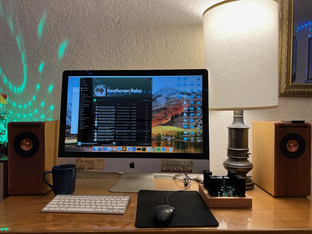

It's done and playing music! This is the third idea for a base. First was an aluminum box and then Nelson made the PCB bigger. Second was a cigar box, but the sliding instead of hinging top presented difficulties. Third time the charm. Inspired by Dennis Hui's base I found some ends from redwood 2x2's left over from a fence project to make the base.
Jumpers in or out? Since I lost the jumpers, it's jumpers out!
Thanks Nelson. Pennie says "It sounds like you just bought $10,000 speakers!"
