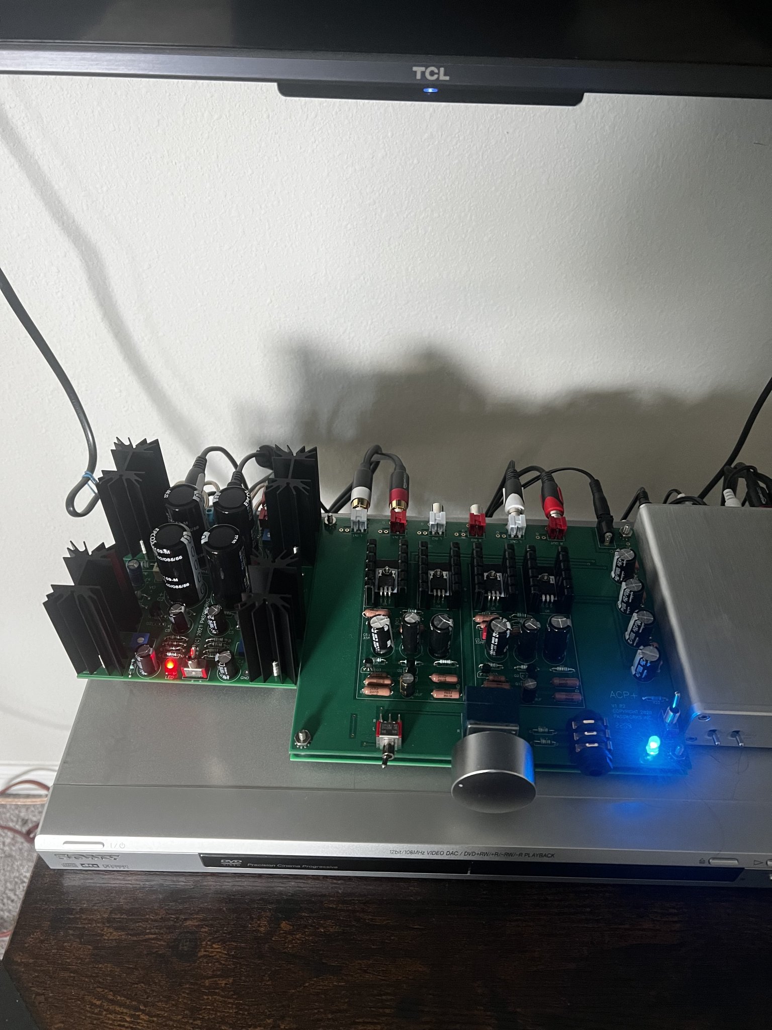

Mini Skyscraper!
Stacked heat sinks work very well! Has anyone else tried this?

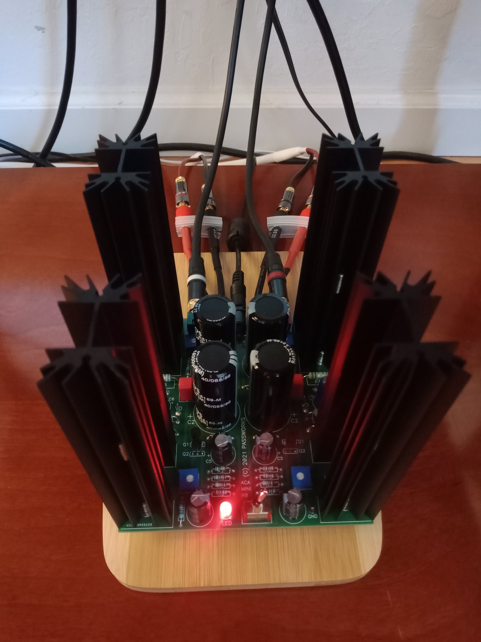

Now for the long story...
I have had my DIY ACA Mini biased at 370 mV since last December, four months. @Nelson Pass told me that the Mini likes to be biased between 350 and 390 mV, and that it's OK if the heat sinks get very hot, as long as you can put your finger on them for a couple of seconds or more.
I set the bias when the ambient room temperature was around 69 degrees Fahrenheit. In my house, the temperature seldom goes above 72 degrees. The amp has worked perfectly, and it hasn't failed the finger test.
A little over a week ago, we had some pretty high temperatures. The living room got up to 75 degrees. I ran the amp, and all was well, but I thought to myself that I ought to have turned on the little fan I bought to cool the amp when the indoor temperature is high.
The next day, I used the fan, and it really cooled the heat sinks a lot. But unfortunately I could hear the fan a little bit when no music was playing.
That got me thinking...
What if I bought a second set of heat sinks and stacked them on top of the first set? I knew the pins would hold them directly above the first set, but would they make enough contact to draw off a significant amount of heat from the first set? I decided to try, so I bought a second set from Digikey. They arrived yesterday.
I put the second set of heat sinks on top of the first set, turned on the amp, and let it warm up for two hours. The house was 72 degrees. It's the same right now.
Good news! Both yesterday and today the top level heat sinks get warm and, best of all, the bottom level heat sinks are cool enough for me to put my fingers on them and hold them there as long as I want. In other words, the bottom heat sinks are a lot cooler.
I still have the fan, and maybe I'll have to use it if the house gets up to 80 degrees, as it did for a few days last summer. But I am happy to have found a cheap and easy solution to the heat dissipation problem.
I will repeat what I've already said: The DIY ACA Mini amplifier is by far the best sounding amplifier I have ever owned. The clarity is astonishing. My hat is off to @Nelson Pass for designing such a great little kit that someone like me can build and enjoy.
