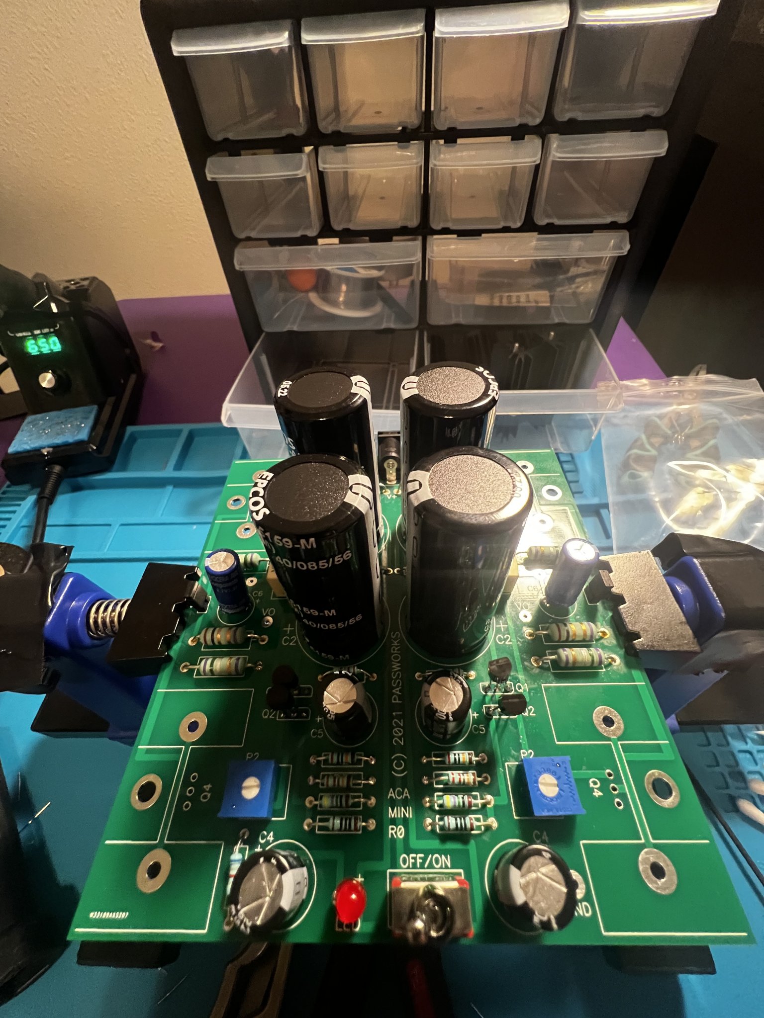

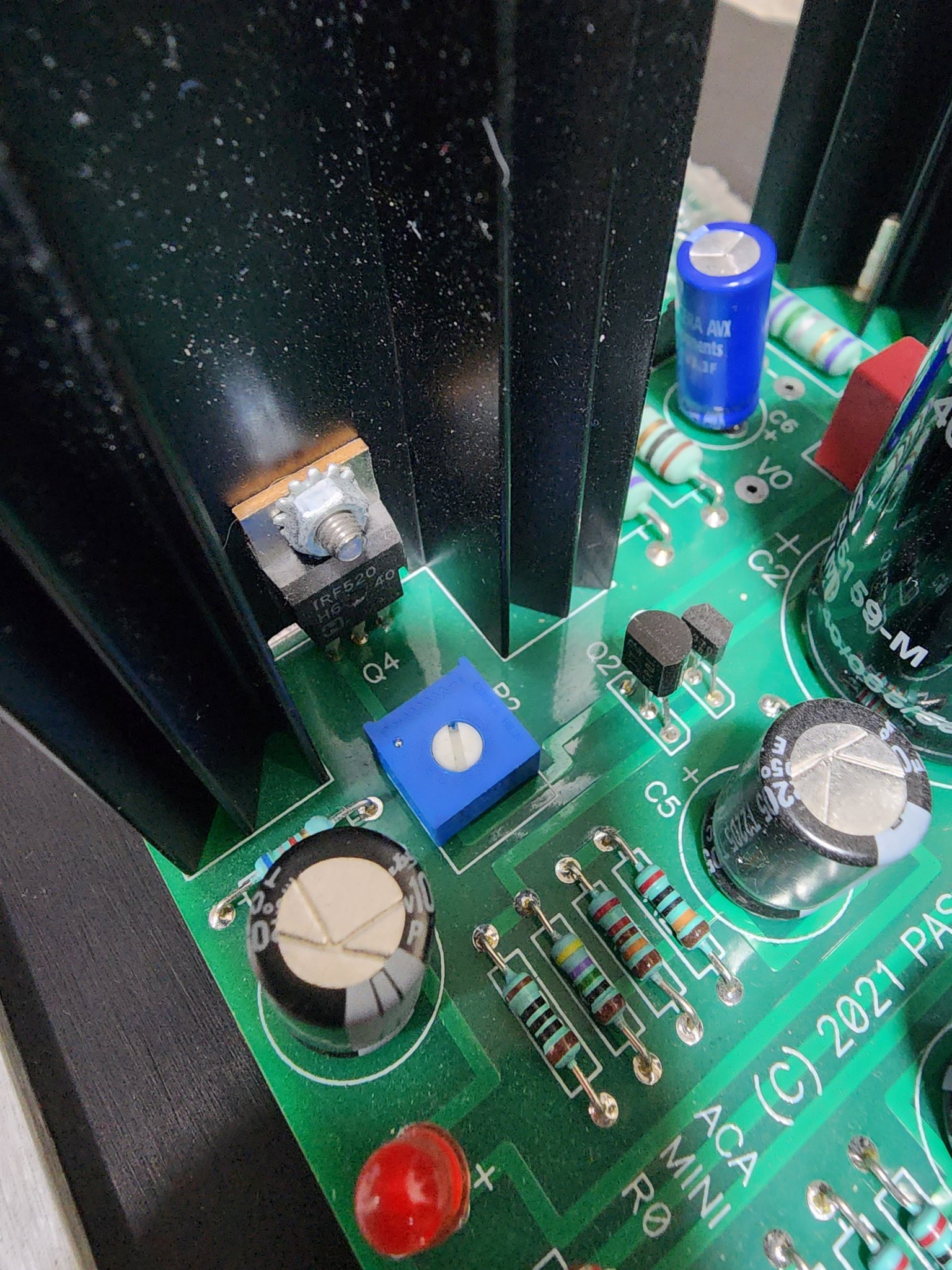

Hi builders,
My completions kit came with 6.8K resistors for R4. I have some 22K 1/4W resistors in my inventory. Is 1/4W rating OK for R4.
Also, my kit has the 1K trimpots. Should I try to set the bias using them, or just order some 2K pots. I do not like to de-solder components if I don't have to. Thanks for the help.
MM

check the updated BOM! https://www.diyaudio.com/community/threads/diy-aca-mini.379037/post-7373835
the BOM says that its 1k pots and the 6.4k resistor is only for R0.
Hopefully, that helps you avoid my earlier mistake!
Happy Building!
Jose
@Jacruzer787
Thanks, I am aware of that BOM. I have used one of the 6.8K resistors I received for R0.
Could someone let me know if 1/4 W rated resistor's be used at R4 ?.
Some builders have experienced trouble when trying to set the bias with 1K trim pots. I prefer not de-soldering components, hence I am asking if one should just purchase some 2K trim pots and be done with it ?.
Thanks again for the help.
MM
I think I may have answered my own question about the 1K vs 2K trim pots. Only need to verify if 1/4W resistor okay for R4 ?.

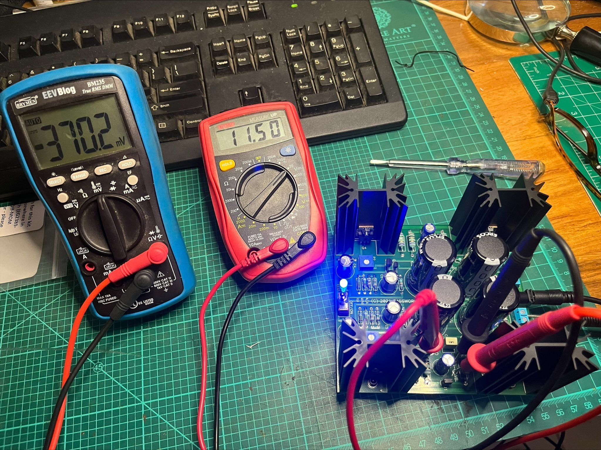

Hi Everyone, Santa is packing up lots of ACAmini Essentials (pcb + fets) for the Store, and
I want to inform customers that the Bill of Materials has been altered, changing the value of
the bias trim pots to 2 Kohm, up from 1 Kohm to accommodate the ranges we are getting
from the Mosfet/Jfet pairs. Previously we could work with up to 1K, but now the upper limit
is a little higher, and 2K is the next value pot on the scale of availability..
There is no performance hit. Completion kits from the store will reflect this change, and will
work fine with boards purchased previously.
:santa2:
Nelson,
Should I replace the 1K pots with the 2K? I just finished assembling the old kit
IRFP devices? Before doing that just see if you can achieve proper bias,
No need to worry. If the amp biases up then you're fine. On the next batch the margin between the Idss of the Jfets and Vgs of the Mosfets is thinner, although most of them will work with the original 1k pots.
Sorry about the confusion, should have searched farther.
MM

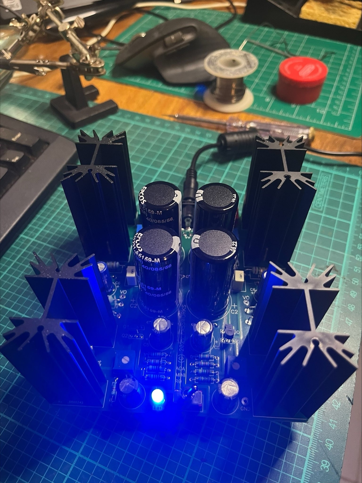

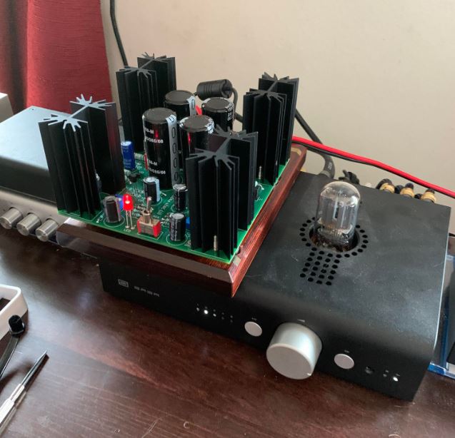

Just finished building a ACA-Mini the other night and I have to say I'm pretty impressed. Except for being a little confused by not looking at the updated BOM it went together fairly easy. Biasing was fairly straight forward. After it warmed up for an hour I finally connected it to some older Sony 89db sensitivity speakers and sound came out but it wasn't that good. I was satisfied the amp was working properly and connected to some Heresy IV. Wow. I was blown away by the difference in the soundstage between this amp and my Kenwood Class G 220w amp. At most listening volumes this little amp is more than adequate and sounds so refined. I had some old customer service plaques from Cisco Systems and they were the perfect size so I mounted it on one of them. Not sure of what type of wood but they are fairly heavy.

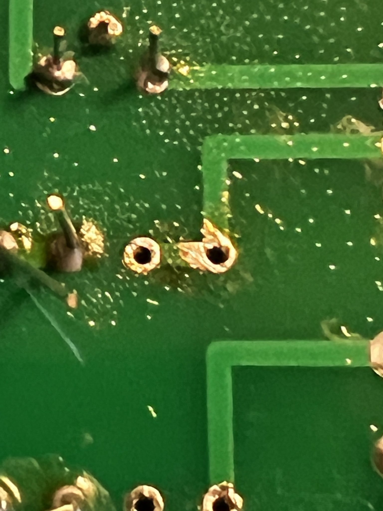

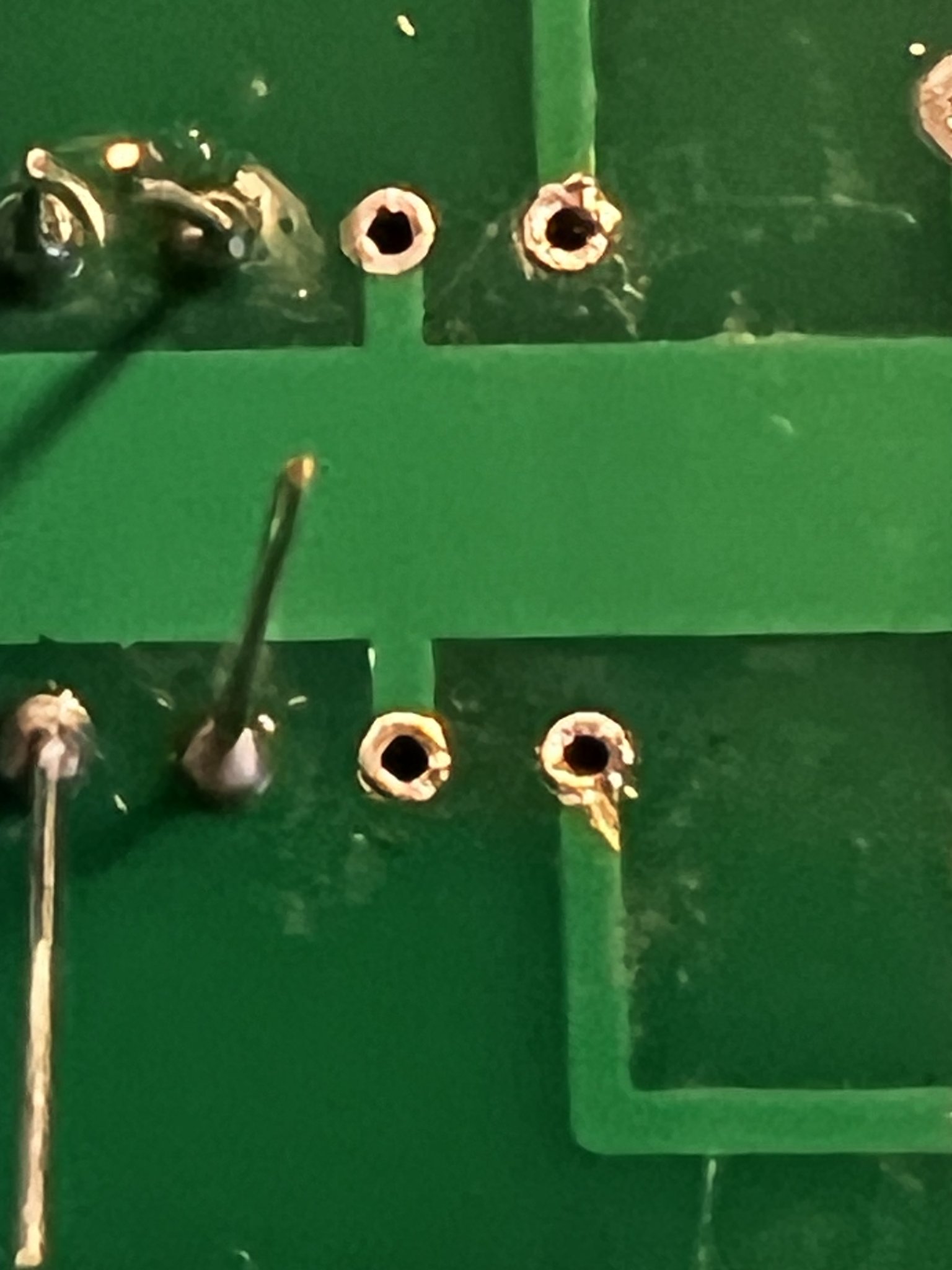

This is too late but it may help you the next time you need to remove a part. It would have been much easier if you had cut the leads shorter. If you had intended to reuse the resistor, leave a few millimeters of the lead above the board. Then heat one lead until the solder melts and pull the resistor from the other side to pull the lead out of the hole. Do the same to the other lead. To clear the hole of solder, heat the solder in one of the holes and once the solder is molten, quickly tap the board sharply on a table. Repeat if necessary, then clear the other hole of solder. Done.
Looking at your solder joints, it looks like you are not applying enough heat.
