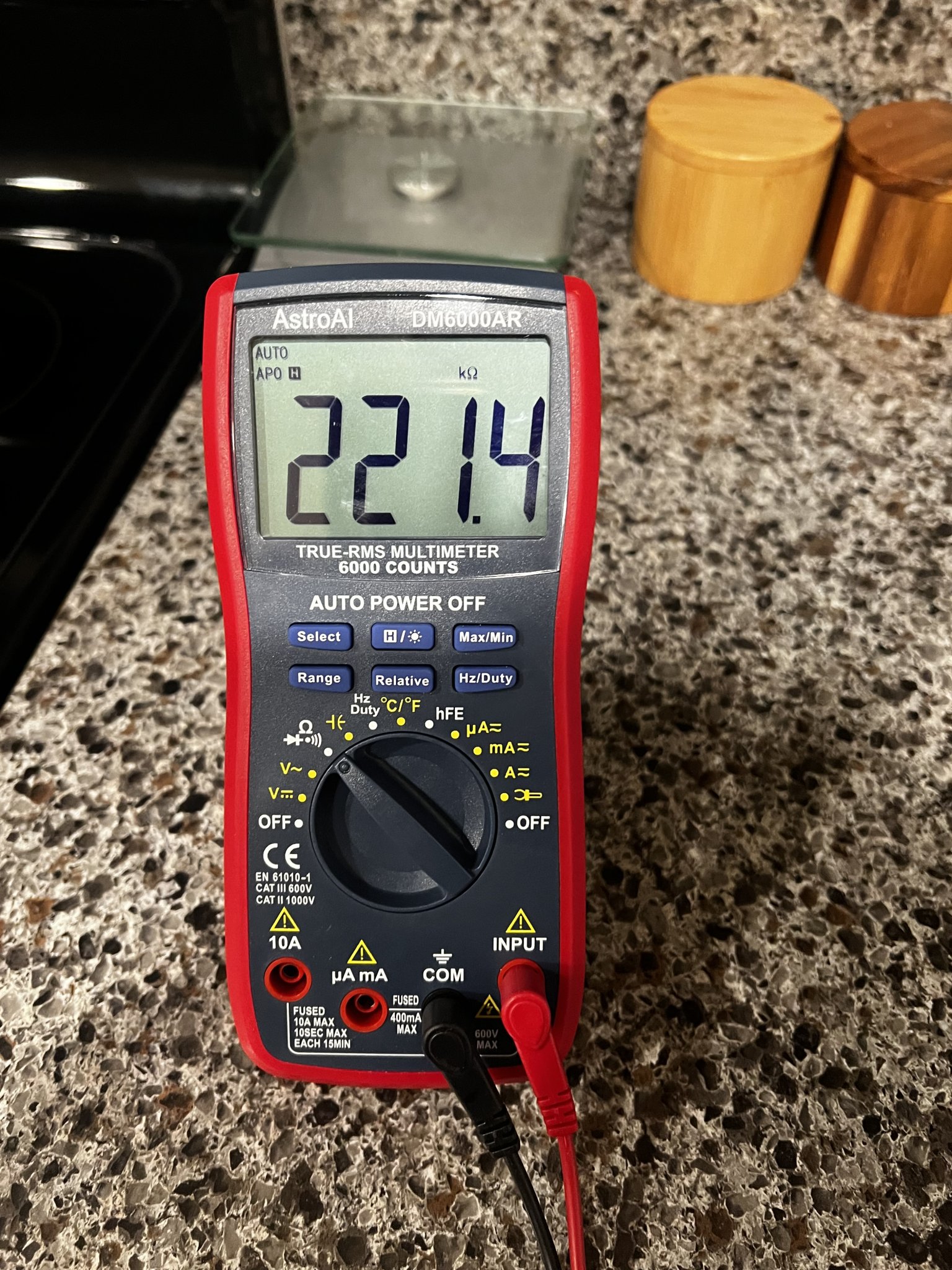

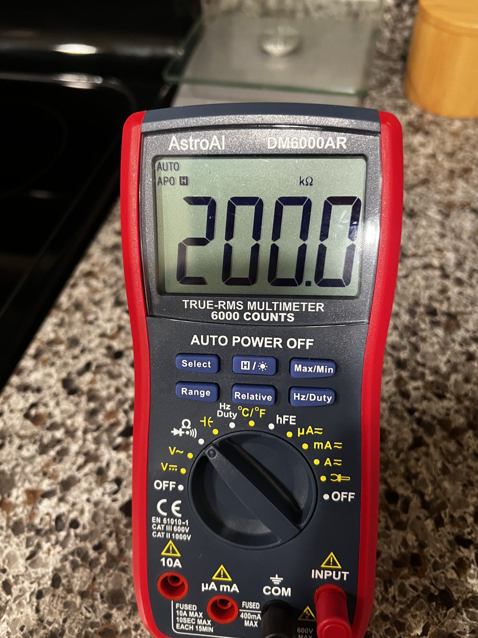

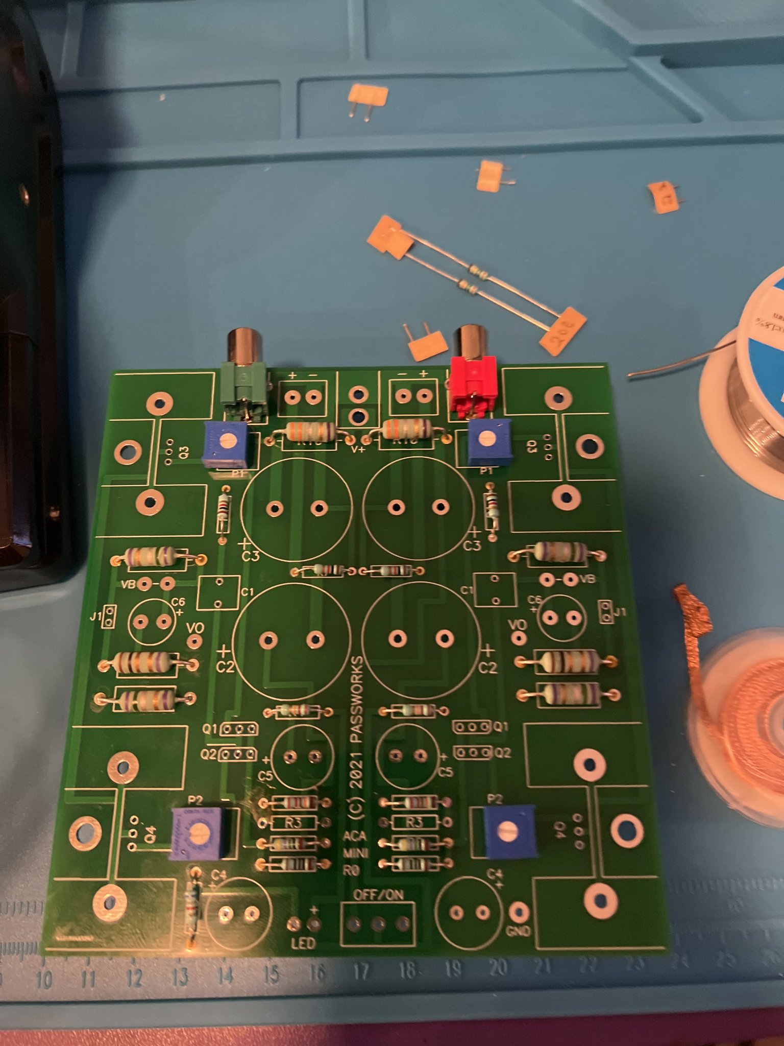

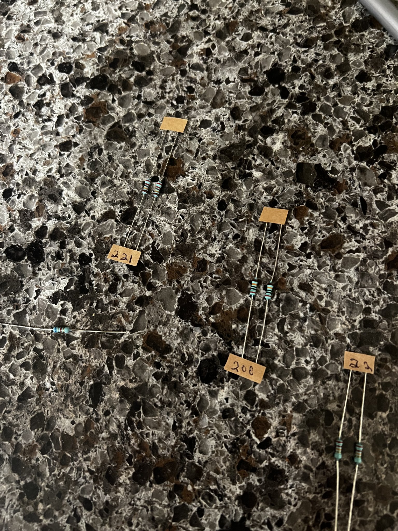

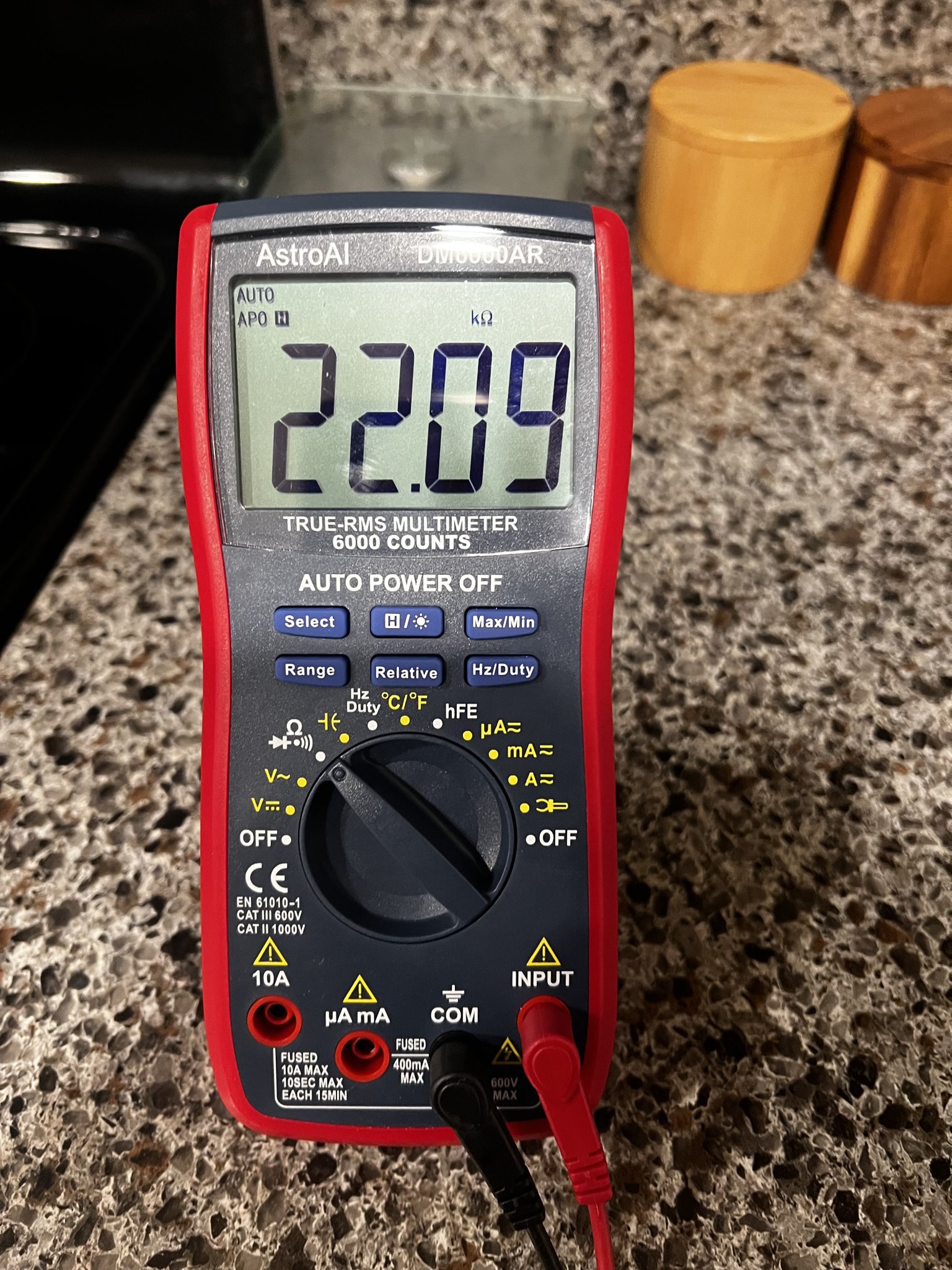

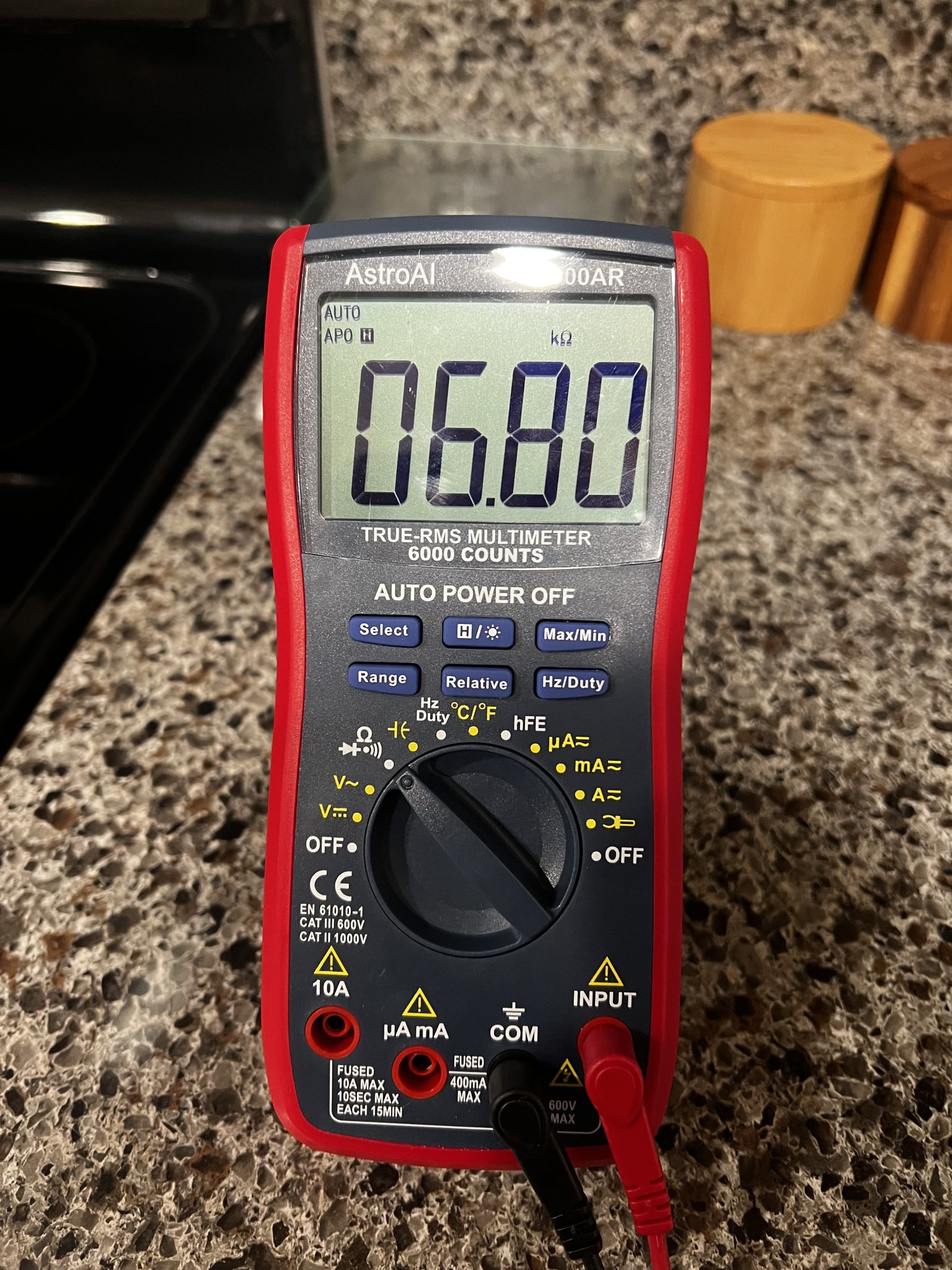

I need some assistance with R2 and R3. I have a pair that read 221k, just the same way that is listed on the bom. however, the BOM specifies 4 resistors two for R2 and two for R3. No matter how much I try, I cant get close to the 221k ohms. I have a pair that reads 200k, and one that is 22, but I dont know which one is correct. I also seem to be missing 2 6.8k ohms, I one have one and I assume that it is for R0. Please let me know. Thanks!
- Jose

Solder wick is a waste of time and dangerous when working with small components.
Buy a solder sucker with a Teflon tip, they are not expensive and will serve you for years.
Apply fresh solder to the solder pad and at the same time engage the sucker.
With 0.25 to 0.5w resistors being cheap the easiest way is to sacrifice them. Cut their legs near the pad then turn the PCB over and apply the technique that I mentioned above.

Will do! Here is tonights progress!!!

Solder wick works best if flux is applied to the wick, wet the solder iron tip with solder, then place the wick on the solder joint, and place the wetted solder iron tip on the solder wick. Press down and when the heat reaches the solder joint, the flux on the wick should draw the solder from the joint. The solder should then be visible on the wick. It works for me. :)

Did you leave enough of the lead on the resistors you desoldered to solder the old one back on, or too short now? Just make sure the power rating is adequate for the circuit. Your kit there appears to have 1/4W resistors. I'll let someone with more experience chime in on what that value is for R3 and R2.

I have one of those! I used it several time, and the wick with no success. I didn't cut the leads. No matter how much I tried, i could not remove the solder to pull them out. I might give it another go soon.
For the solder sucker pump to work best, make sure to add a normal amount of fresh solder where you want to remove the solder from..it may seem counter productive but trying to suck a tiny bit of solder is much harder than a normal quantity. Once you get the hang of it you will love that tool.

I use flux on wick for small solder joints and it works great, and use a big blue sucker for large joints. What I do is wet the soldering iron tip with solder, hold the soldering iron in one hand and put it against the joint. At the same time hold the sucker in the other hand with a finger on the trigger, and put the sucker tip over the soldering iron tip and solder joint. Make sure that the sucker tip is over the solder joint. When the solder in the joint is molten, quickly remove the iron, press the sucker tip down against the PCB and trigger the sucker.
Yeah, there's a lot of ways that work to desolder, so it's great we are all sharing what works for each of us. I wish videos were a little easier to upload. Trying to share tricks and techniques via text description is tough for folks who have little experience with the various options. Everything said so far makes sense to me, although I've never had issues with the big solder sucker, but I dont typically add solder, so only need two hands. Tremendous improvement in "suck" over the small volume one I have.
