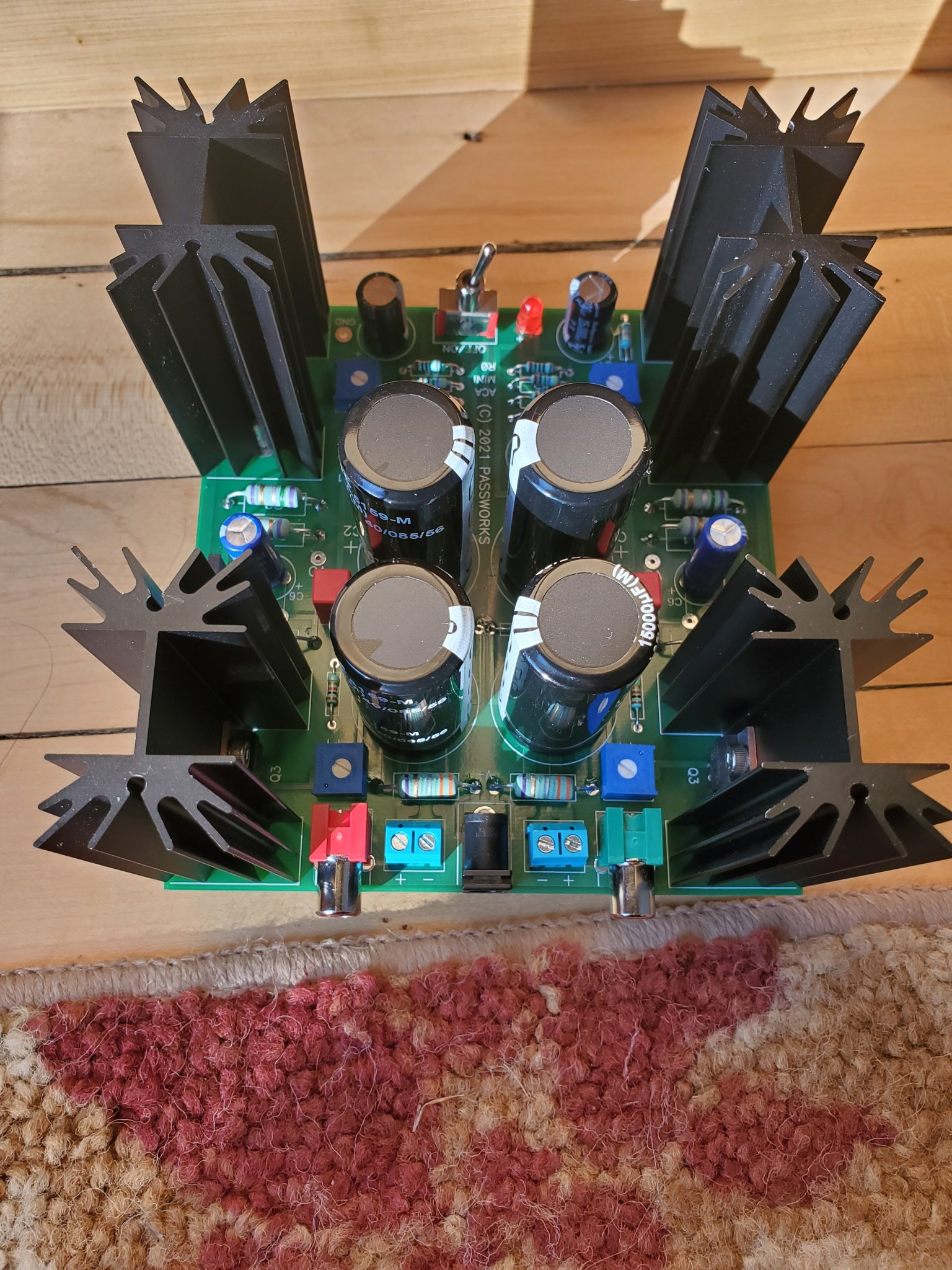

I set Vb on both channels to 0.3V and V0 to 11.5 V
On the left channel (green) heat sinks get hot.
On the right channel (red) heat sinks stay cold.
Heat sinks are connected with screw an a bit of heat paste.
Power indicator led does not pulse (at least I can’t recognise it, but there is no load connected)
This is important.
If Vb is 0.3 volts on both channels and the value of R8 is correct at 0.75 ohm then the correct current must be flowing. That is just ohms law and its an absolute. 0.3 volts across 0.75 ohm is 0.4 amp and 0.4 amp and 24 volt rails is 9.6 watts and that is shared equally between the two FET's.
That means that the heat dissipated should be the same on both channels. Vout set at 11.5 volts means the two FET's in that channel are equally sharing the power dissipation and should be equally hot.
So if one side really is not get hot then something fundamental is wrong. In that case measure R8 and make sure it is 0.75 ohm and not something like a 7.5 ohm.
I will check all voltages a values tomorrow.
I ordered some special hook clamps today. So I can measure Vb and V0 at the same time while tuning.
Gentlemen,
Thank you for your efforts. It seems that only P1 and P2 were not set correctly. Since, at least to the best of my recollection, I played around with the settings for a really long time when I was finishing the amp, I assumed that the settings should be correct.
I have checked all the voltages. checked the resistor values of R8 and everything is correct. I have already tested the amp today. both channels are playing nicely and getting warm (maybe not equaly but significantly warm).
all good. thank you very much and i apologise for any inconvenience. i really do like this community. the level of help one gets here is outstanding.
Cheers
Flo
Cheers
Flo

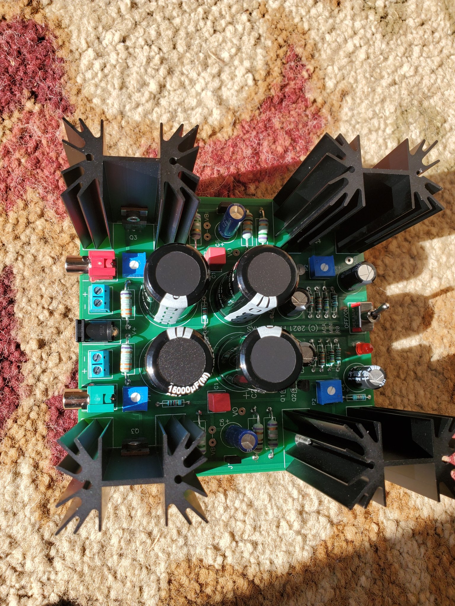

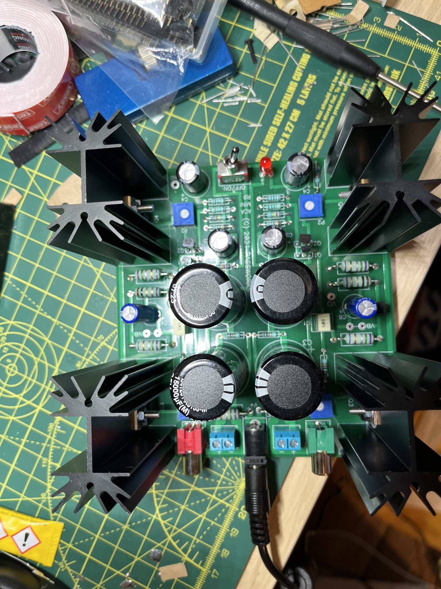

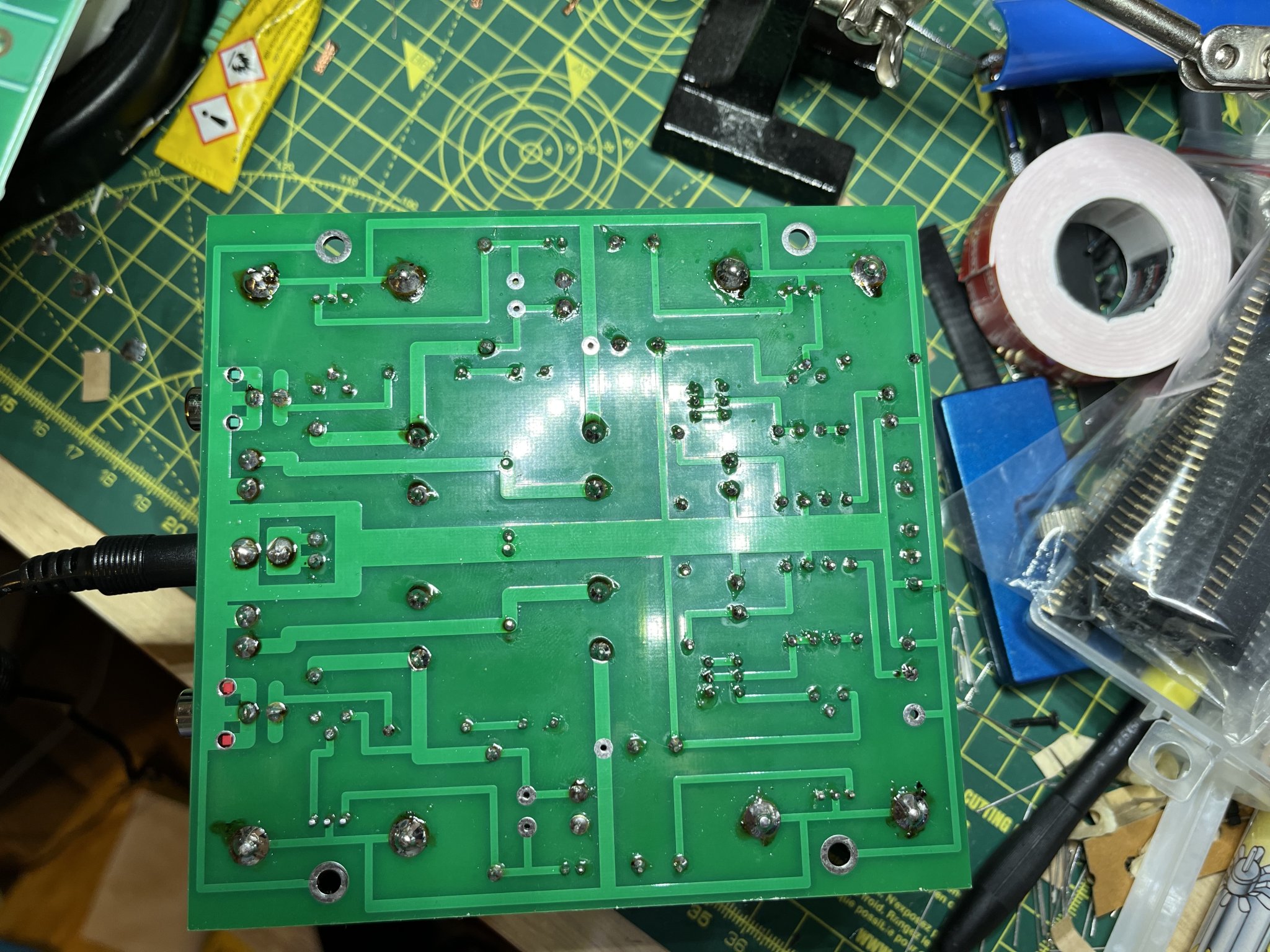

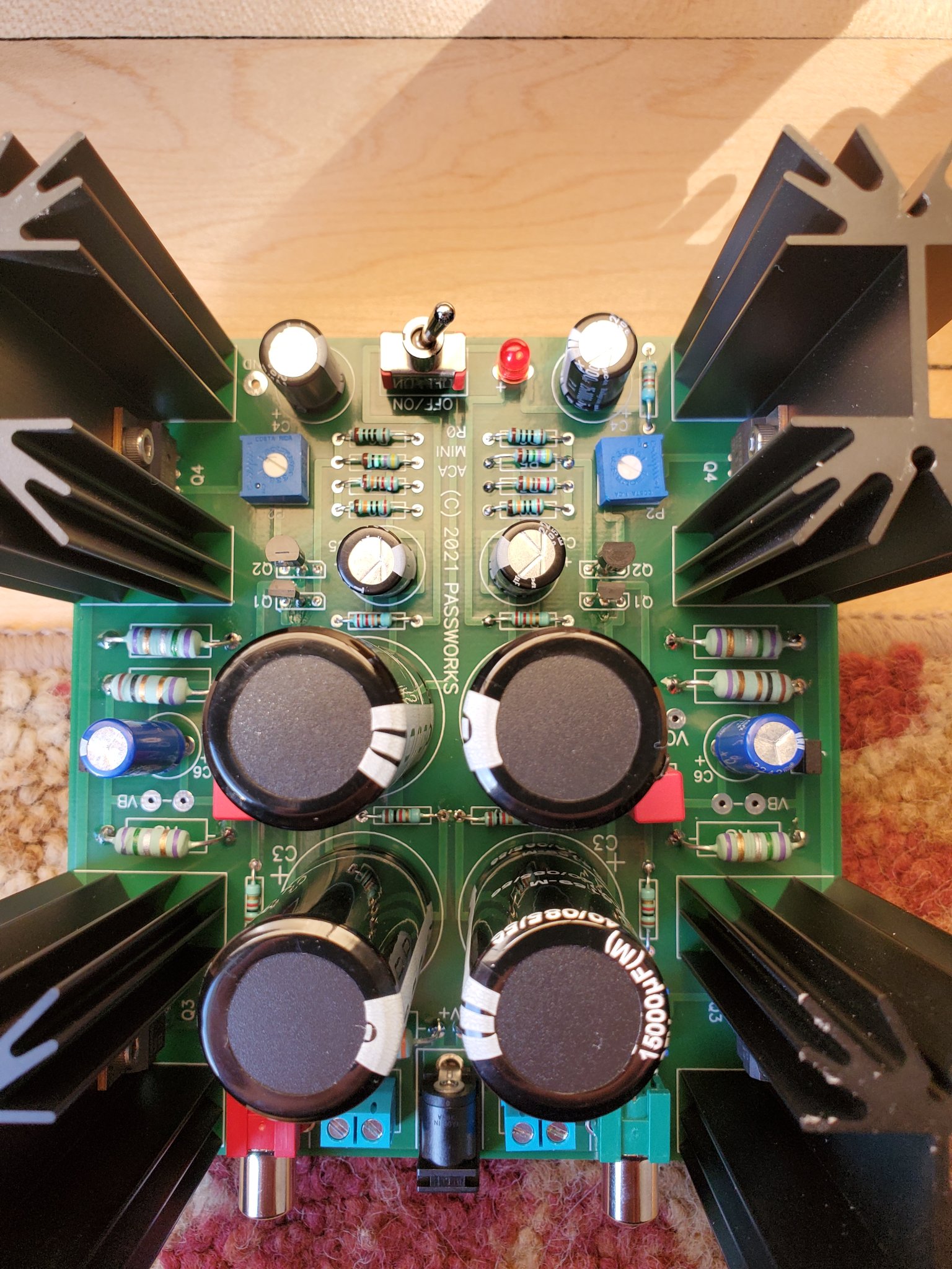

I went to do the VB and VO adjustments having zeroed ( counter clockwise ) all four trim pots first and i am getting 12 V on both channels VO. Left the mini on for a while and none of the heating sinks were getting warm. Something must be seriously amiss. guess I will have to post some pics....
I'll say on my first build I got two of the MOSFETs swapped. Easy to cross check that. It was no fun desoldering those to fix my issue (brings back desoldering PTSD memories), but the dang thing sounds so amazing it was worth the pain.
Thanks fellas, I'm taking a break and will get back to it in a couple hours. Iirc Ben, the VB was zero. I did go back over the soldering.
