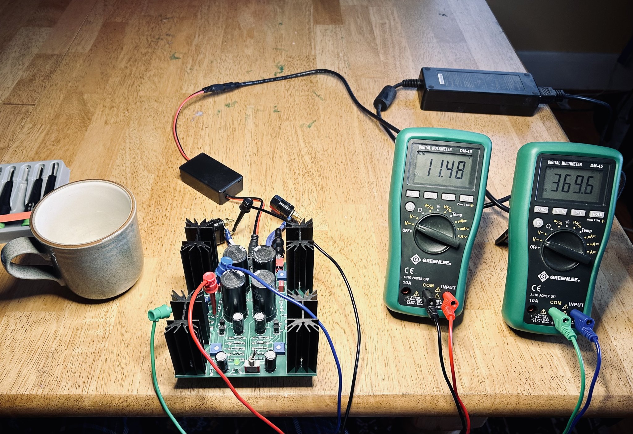

I had a magic moment where I was spot on for both of them (2 meters): 300mv/11.5v. I took a picture for posterity.How does your VO look? It's nice to have two DVMs to watch both VB and VO at the same time. It's also nice to have a test point to connect the test leads while making adjustments.

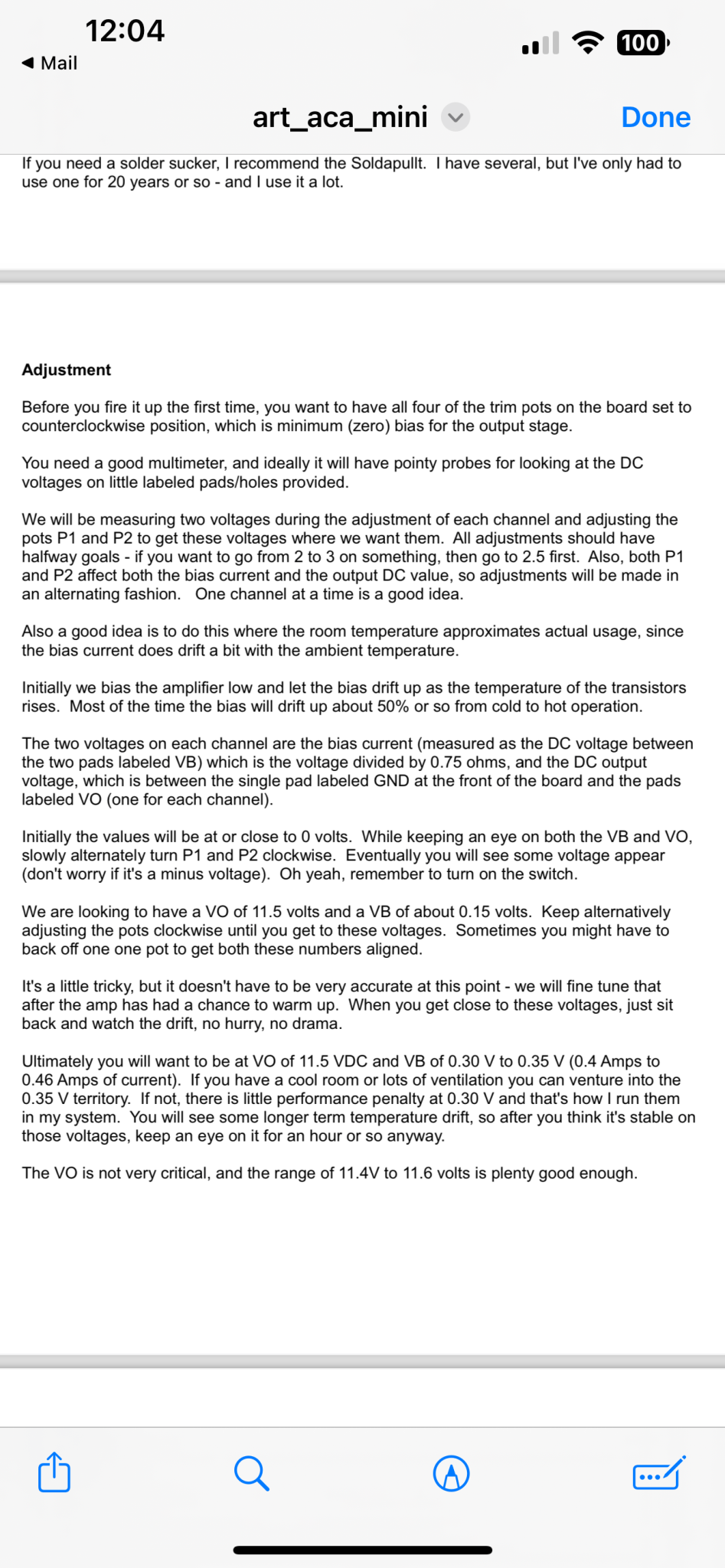

@e_fortier I will look for the videos -- I watched one very helpful video on the basics of how to use the 2 pots to set the bias. It's the "@Nelson Pass told me that the bias (VB) should be between 350 and 390 mV" line I quoted above that caught me by surprise.

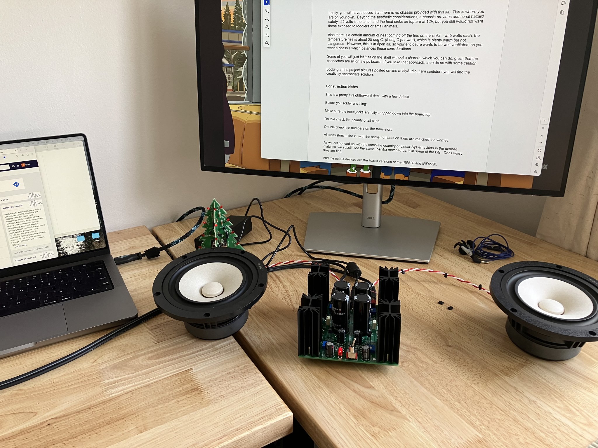

Another completed ACA Mini in the world tonight. I'm running it out of the headphone output of my CD player, since that has a volume knob on it. It's got enough ommph that if I gave it the direct output, I would suffer hearing loss.
First sounds to come through it:
1. Bach/Glen Gould "The Art of the Fugue"
2. Mary Lou Lord "Martian Saints"
3. Sarah Vaughn
4. Clash "From Here to Eternity"
@6L6's build guide was very useful to me. If the login on the "completed" button was the same as here, I would click that, but it appears to be different.

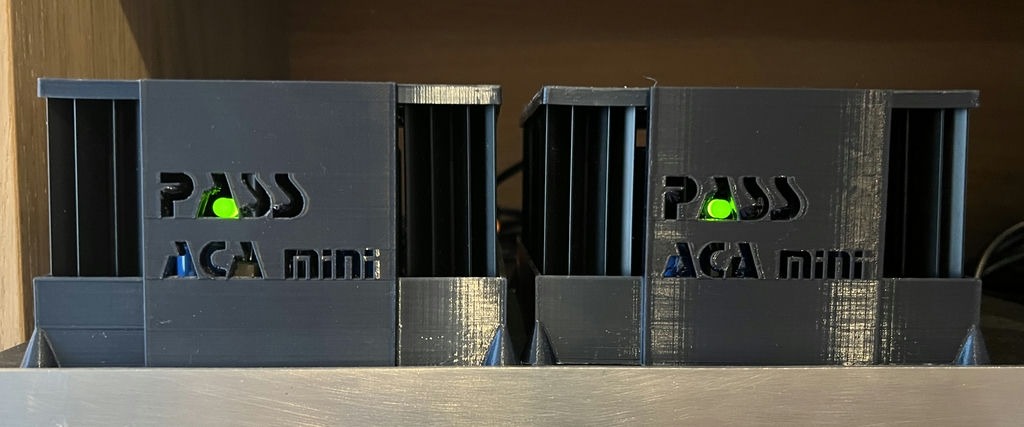

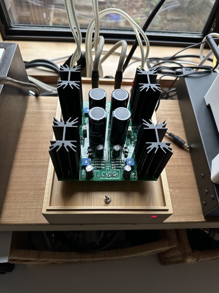

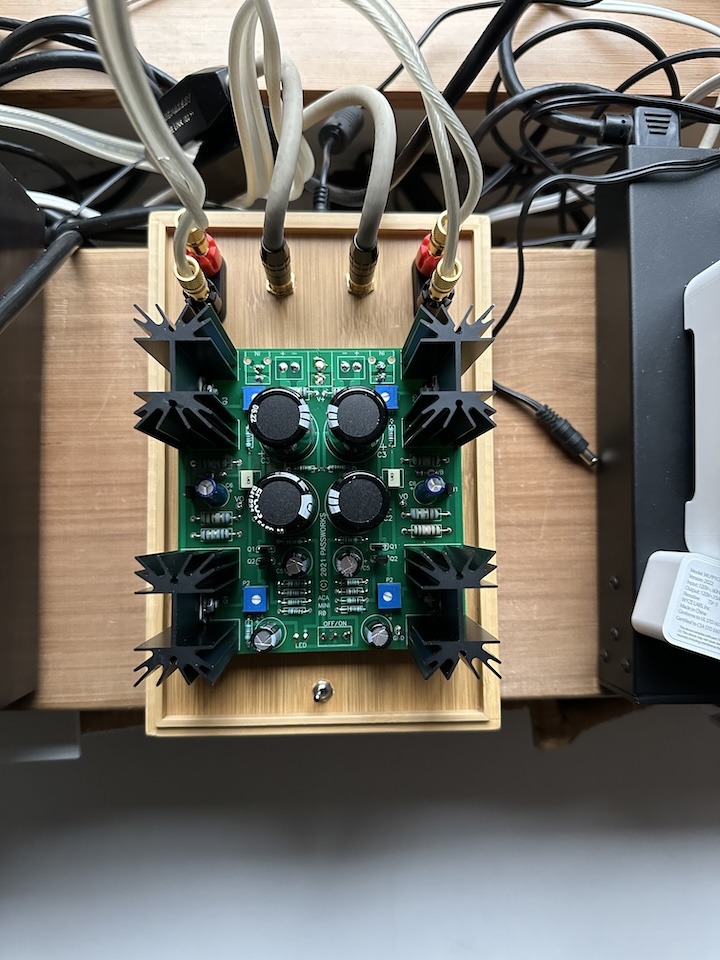

I built an enclosure for the mini folks here coached me through, so I thought you might like to see it. Took a while to redo the wiring under the board, &c. &c. As when I first completed it, no joy: no LED, no nothing. Eventually I remembered that setting the bias might help. Hooray, it's alive and wonderful again. Thanks again for the help with this project: such a delightful sound and truly fun to build -- even when I was tearing out my last hair.
