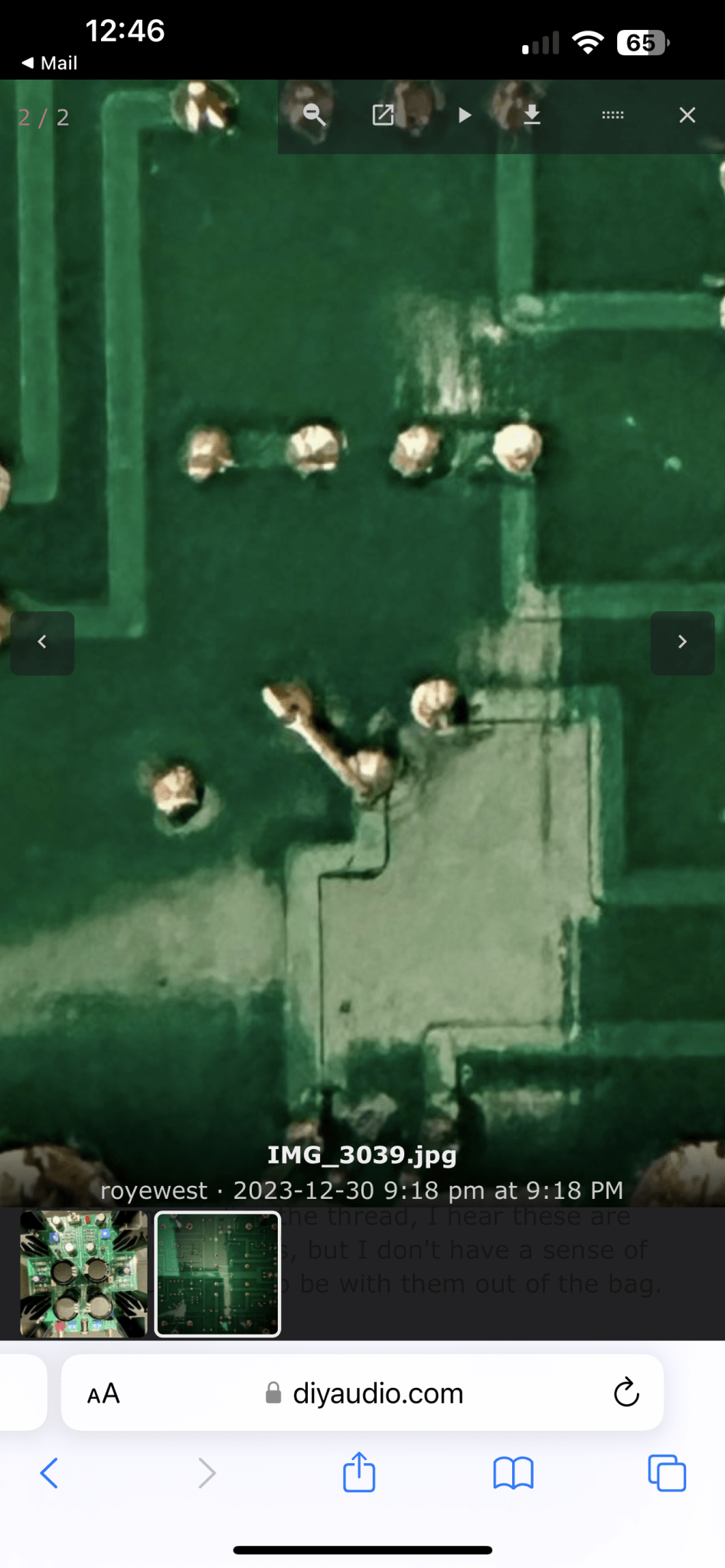

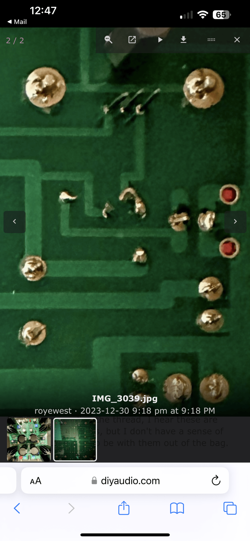

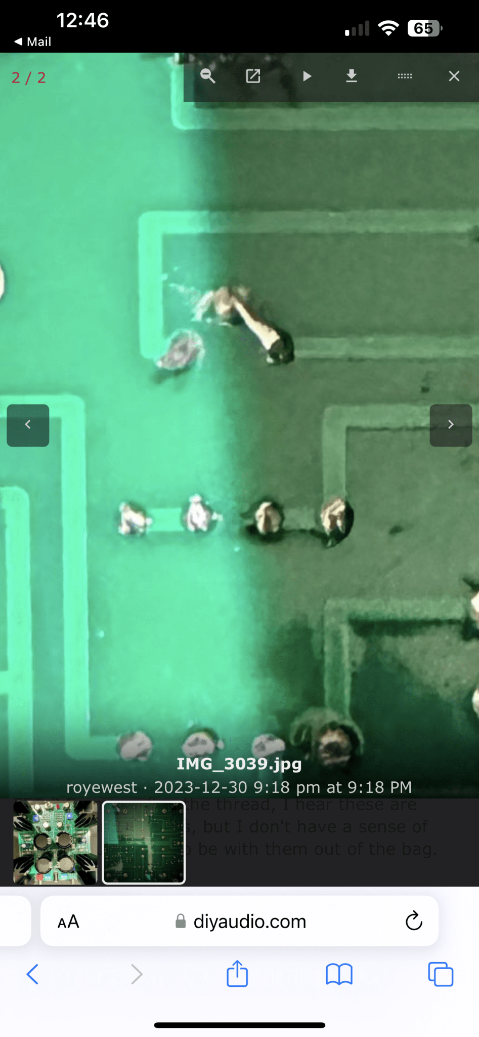

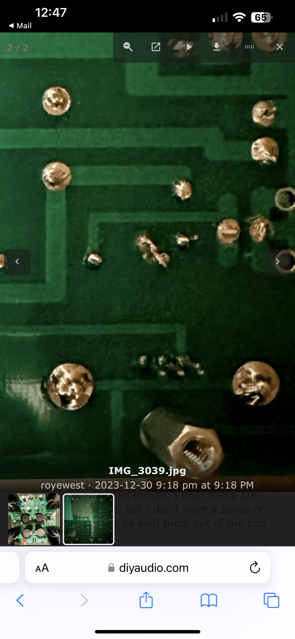

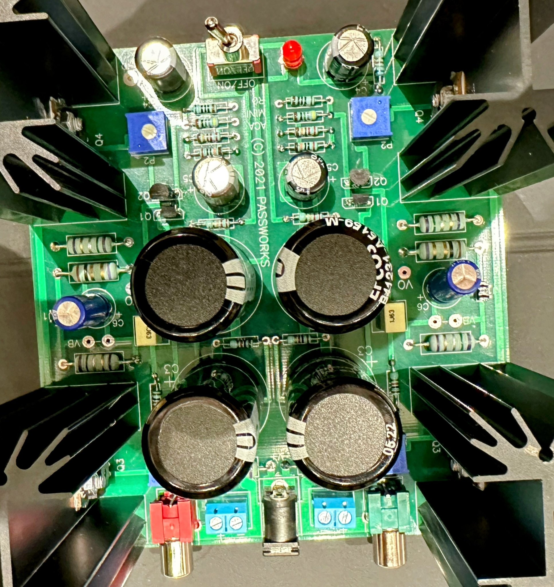

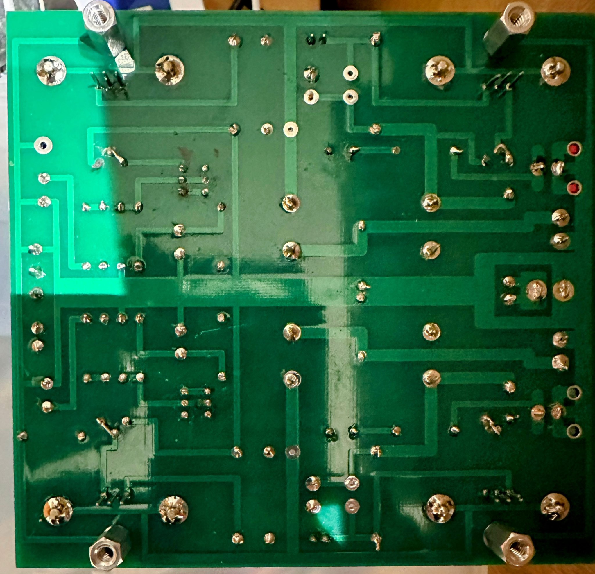

OK, I followed the instructions in the original Pass article and the build guide and no joy. I think it's a power issue. I get continuity across the + and - tabs of the power input jack -- plus a little puff of smoke -- oops. When it was plugged in, the diode faded in and out a bit. Perhaps it is the jack itself. In any event, is there a basic troubleshooting thread in this forum, so I can try to go through things in an orderly way? I've done some searching and don't see that here. Thanks and happy new year!

On the bottom of the board it looks like you've shorted pins 2 and 3 on the Bourns 3386P P1 & P2.OK, I followed the instructions in the original Pass article and the build guide and no joy. I think it's a power issue. I get continuity across the + and - tabs of the power input jack -- plus a little puff of smoke -- oops. When it was plugged in, the diode faded in and out a bit. Perhaps it is the jack itself. In any event, is there a basic troubleshooting thread in this forum, so I can try to go through things in an orderly way? I've done some searching and don't see that here. Thanks and happy new year!

Thank you for looking. Isn't this the correct mod for boards from the last month or two?On the bottom of the board it looks like you've shorted pins 2 and 3 on the Bourns 3386P P1 & P2.
HiOK, I followed the instructions in the original Pass article and the build guide and no joy. I think it's a power issue. I get continuity across the + and - tabs of the power input jack -- plus a little puff of smoke -- oops. When it was plugged in, the diode faded in and out a bit. Perhaps it is the jack itself. In any event, is there a basic troubleshooting thread in this forum, so I can try to go through things in an orderly way? I've done some searching and don't see that here. Thanks and happy new year!
You seem to have a few short circuits with some of your solders. I took a few pics where I’m wondering what’s the extra solder for ? Please check these out.
@e_fortier I read much earlier in this thread and my friend who built one of these previously said that pot pins 2 and 3 needed to be shorted because of a missing trace on the boards from the last couple of months. So I soldered them together (with wire). If this is simply wrong info, I'd be grateful to learn that.

@royewest see https://www.diyaudio.com/community/threads/diy-aca-mini.379037/post-7362227. Those pins are connected by a top trace (red in the original documentation).
No.Thank you for looking. Isn't this the correct mod for boards from the last month or two?
Thank you again for your patience. I will remove the wires. I'm trying to understand if this will make an electrical difference.
I'd also be grateful if someone could tell me what to expect across the + and - tabs on the power socket when it's not plugged in. I get continuity.
