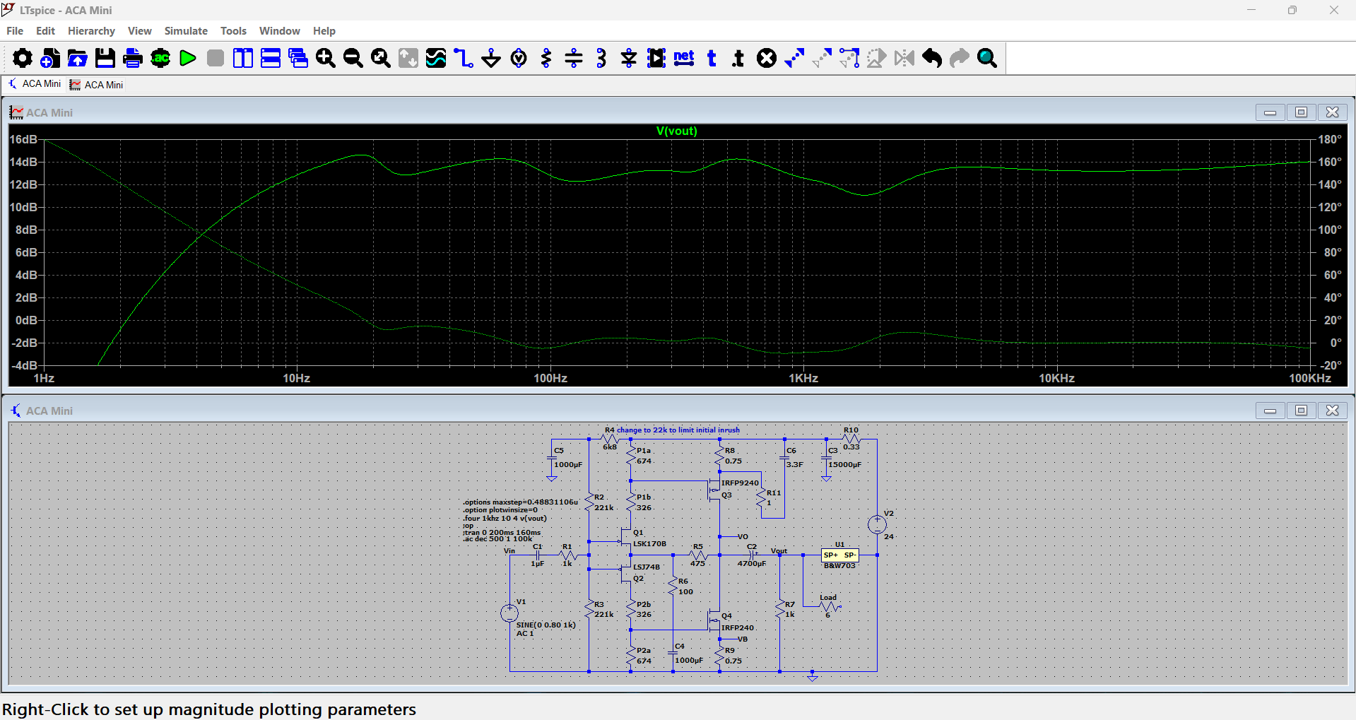

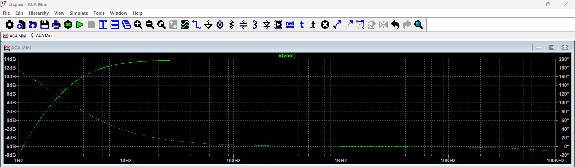

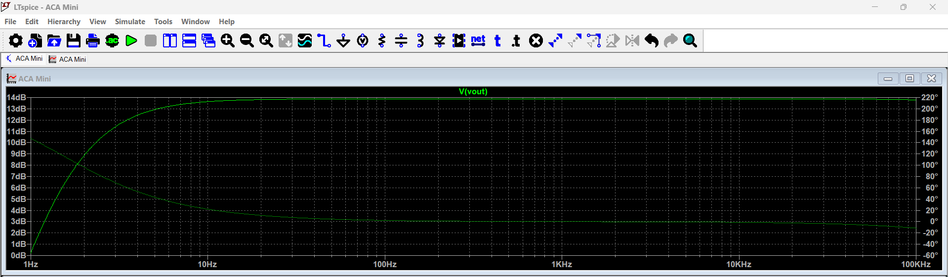

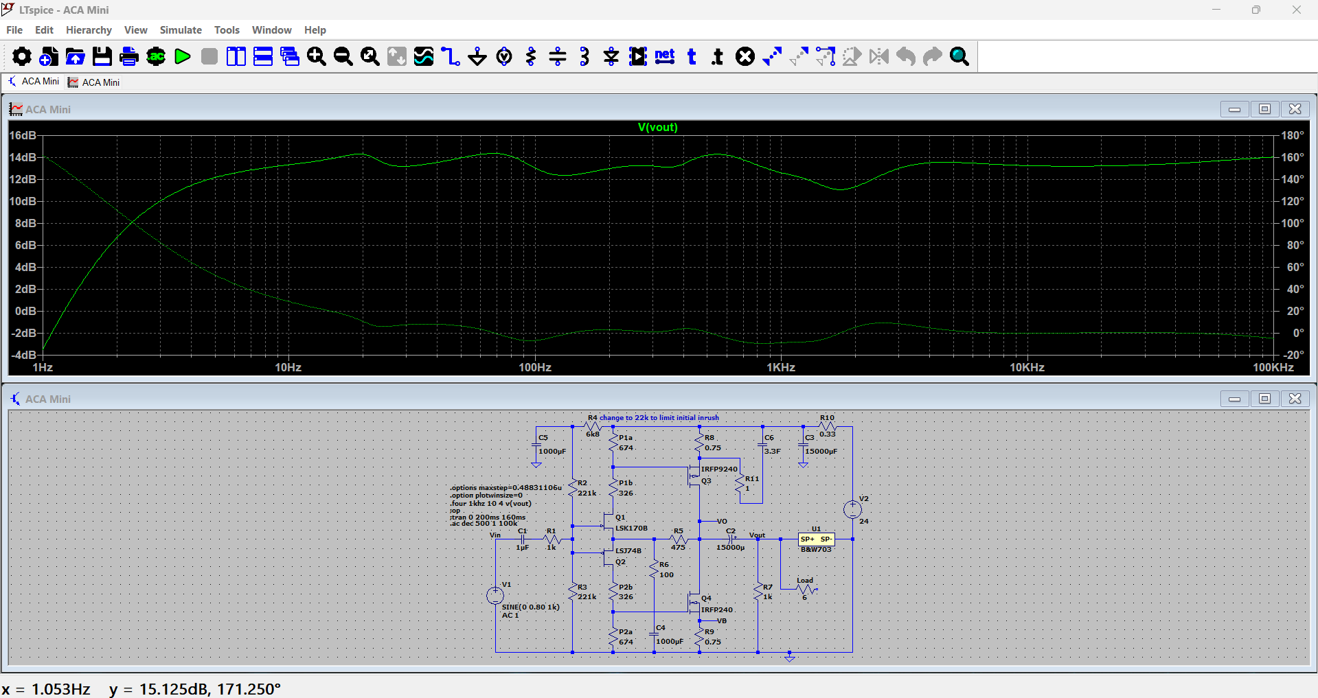

4700uF is still pretty large in the scheme of things but technically you reduce the low frequency response of the amp. By how much depends on your speaker impedance. Would notice the difference? I suspect not in the majority of cases.
This is with a 'tough' speaker load, first 15000uF and then 4700uF. Look at the response below around 30Hz.
And into a resistive 8 ohm load with 15000uF and then 4700uF:
Reactions: 69857
Thank you very much! This is what is was hoping for.
Klipsch Heresy don't say much under 50 Hz. I can live with cut-off around 30Hz with C2 = 4700 uF.
It's easier to get high quality electrolytic capacitors with lesser capacitance. Just trying to optimize my modest set-up. And will try a combination of Nichicon and Audio Note Kaisei as C2.

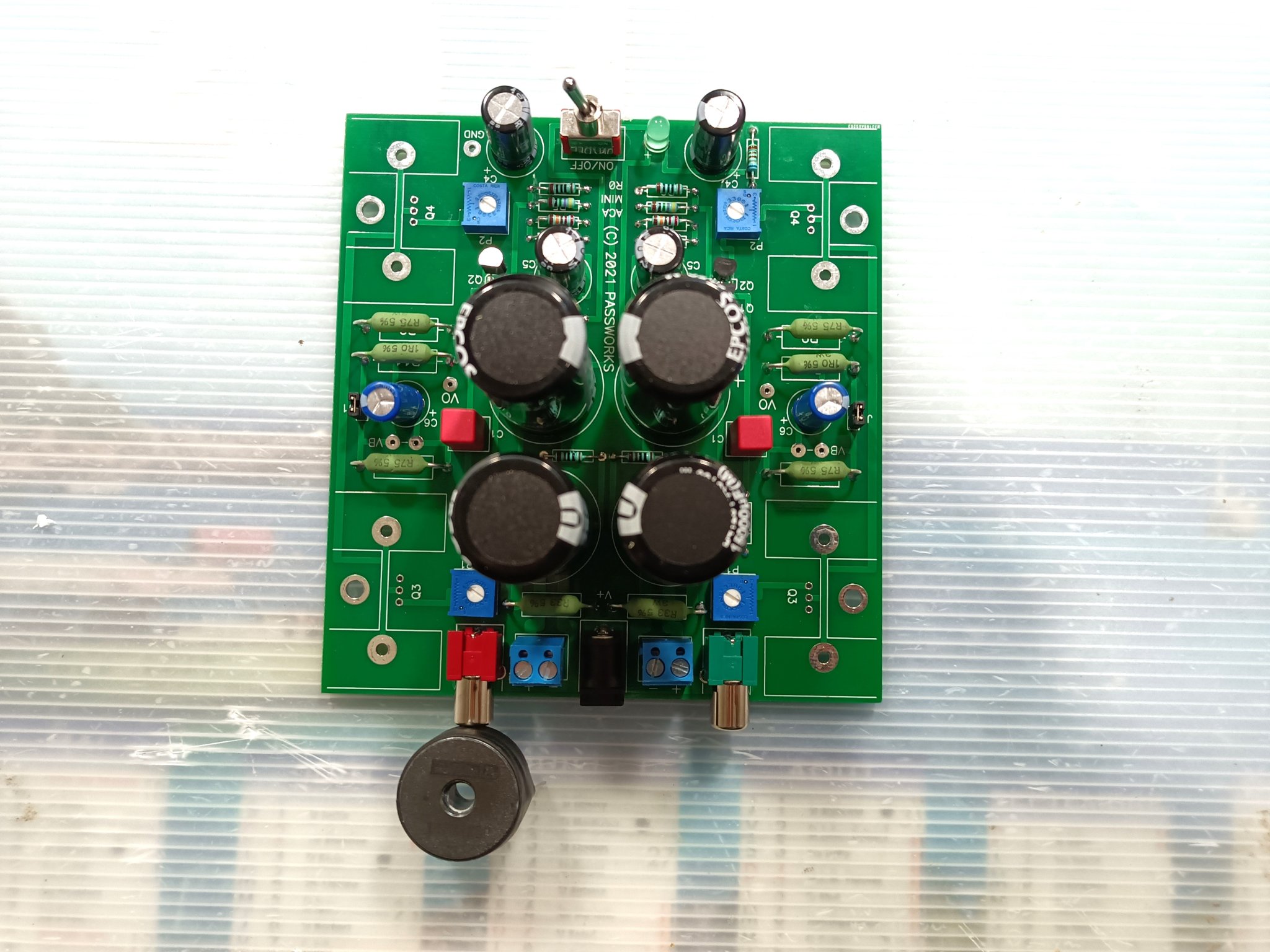

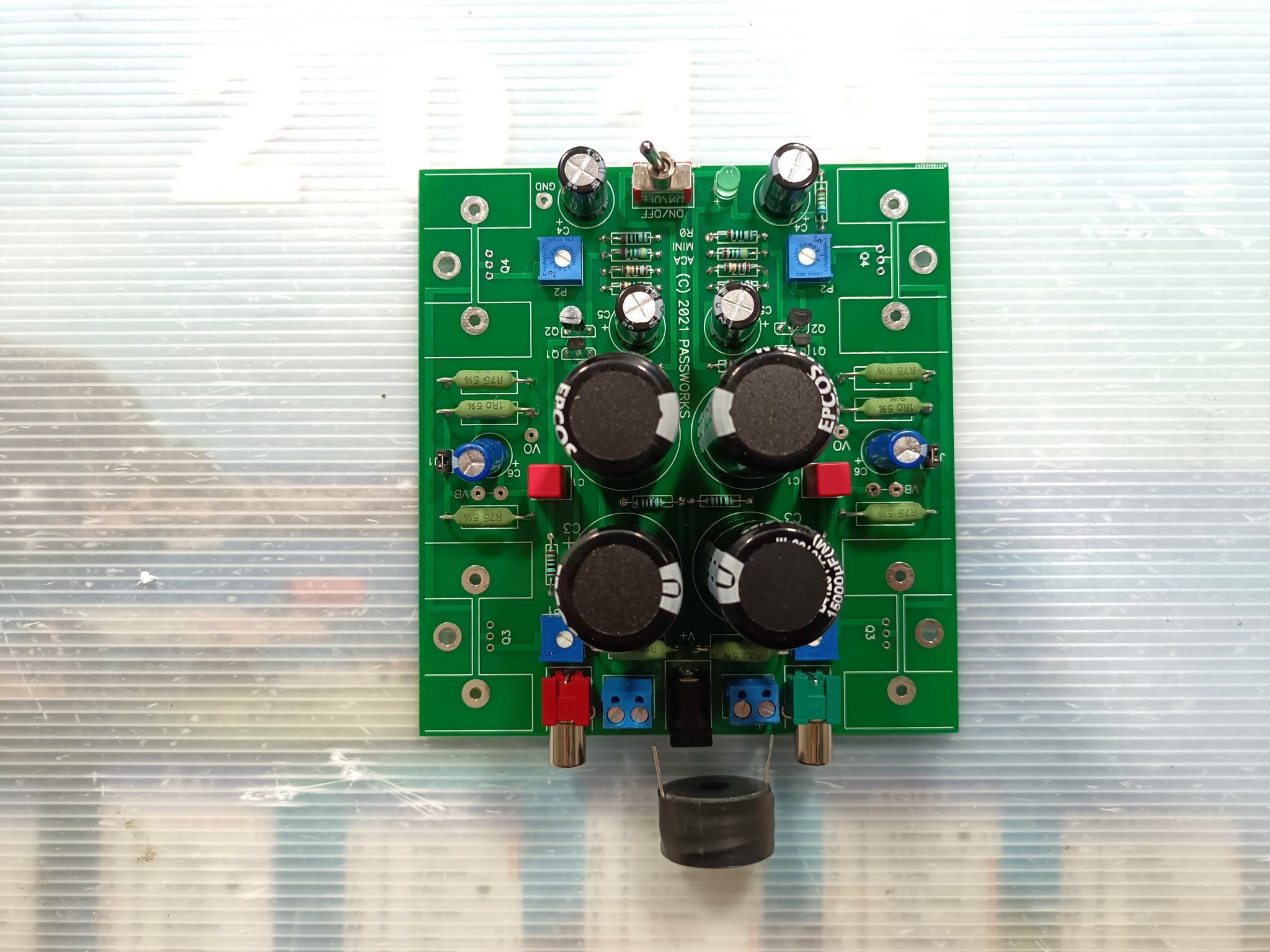

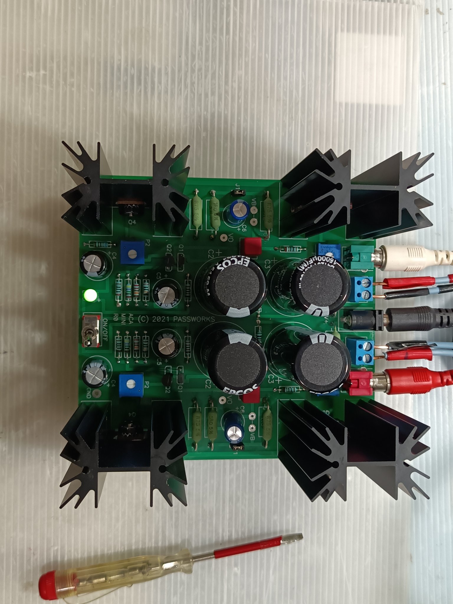

Always late to join the party, but here comes my ACA Mini build.
Everything has already been said, but hopefully I can encourage new builders to build this tiny… but truly great amp.
I went for the essential kit. For various reasons (thinking bi-amp experimentation for the sake of fun with 1 or 2 SMPS) I went for a big 5A low ripple Meanwell PS (GST120A24). I used the big caps as initially intended and the latest resistor tweak. Finally, I wanted to experiment something regarding SMPS filtering, with 3 filters. More to follow.
The soldering on the board is really very easy for everyone. The kits provided here are so great and easy going, thanks papa and DIYA!
Well, it is perhaps too easy for old guys like me as I decided to have it done quickly in one eve while everyone was sleeping here. That meant somehow soldering the 4 small transistors after midnight and while everything looked symmetrical… I noticed at 1 am it wasn’t. 2 of these tiny parts face in one direction, 2 obviously in the other –I noticed it while soldering the 4th one, so lucky me only one to resolder and no drama, but future builders keep it in mind… it is sooo quick to assemble one may skip that.
As Jim / 6L6 said in his excellent build guide, heatsinks are just that… be armed with patience and a lot of time. I cranked my soldering iron to 410°C while it had the largest tip on it. It works after a while, I found that removing the soldering iron here and there, soldering by bits, helped.
All has been said regarding adjustments. I did it relaxed, during 2 days, enabling it to settle. I went for 344mV & 11,53V on one channel and 345mV & 11,49v on the other. I wanted the bias to be very close and not to exceed 50°C at 23°C room temp.
I didn’t yet have the time to assess its sonic quality, nor to compare it to my VFET. My next step is anyway to have it on top form, trying the various PS filters I have. But other than that there is nothing to tweak / add: there is enough to play with bias and jumpers.
Short spoiler though to encourage people to build it: it is really nice and tiny, so easy to build… and for sure very very musical and special. Can’t say if it is very euphonic at this stage, but on my dummy LS the sound is usually quite… awfull. I fixed a nice little amp last week, one I know by heart -my mother’s midly tweaked HK620 - , and it confirmed it again LOL. Well, with the ACA Mini warmed up the sound was amazingly on the border of engaging while also loud enough! Something is defo going on…
More to follow re listening impressions and SMPS filtering
Claude

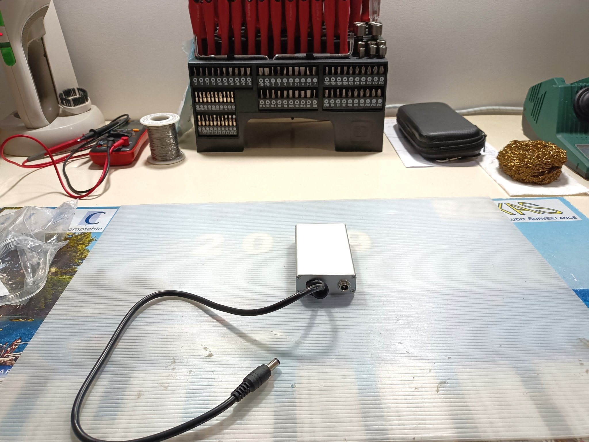

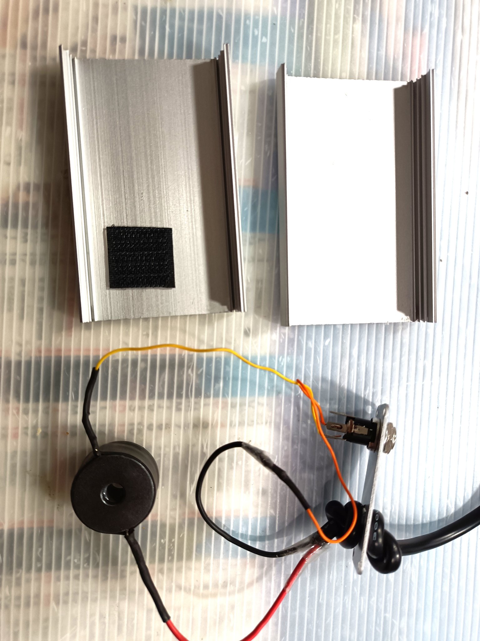

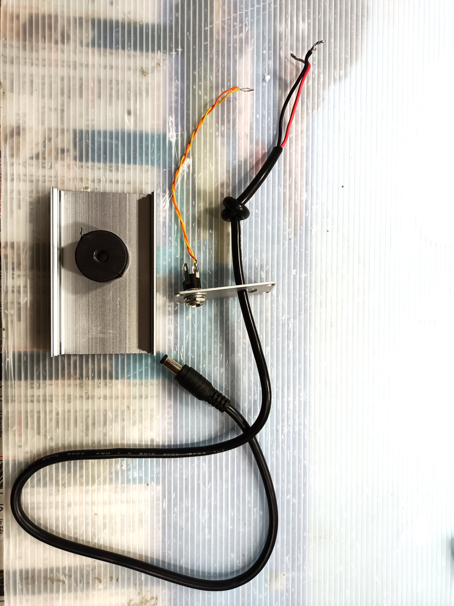

Now to the PS filtering options. To start with, I will have 2 (identical) of Mark’s excellent SMPS filters on hand (see thread... and shop here). I build over a dozen of them and they never failed to deliver. 2 enable daisy chaining, fun to try.
As one can see in my previous post, I have positioned a relatively big coil in front of the ACA Mini - just to give a sense of its size. This is Murata 1433428C, a part I found quite suited for a test around this build. I wanted initially to modify slightly the ACA Mini board to have 2 of these fitted (one per channel) and also easily removable to enable quick listening comparisons.
While doing this, I came across a post from Mark J (again our filtering genius), who mentioned this part… and its use to filter an amp! I sadly didn’t copy it, nor do I remember if it was a comment for the ACA Mini or for an other ACA amp derivative. BUT the point is his post defo gave me the idea to change my plans and to use only one coil upstream of the amp… in my case offboard, in front of the ACA Mini in a small and easily removable casing similar to the ones I use for the usual SMPS filters. Let’s put it this way: should that coil filtering work / bring some sonic benefits, then full credits should go again to Mark J – and if it doesn’t, then it was just another wrong idea of mine LOL
Anyway, on top of the jumpers (I suspect preferences here could be LS related, big LS jumpers in, small fun LS jumpers out?), we will have with friends a total of 3 PS filters to try (one being different and having a knot), each easily and quickly removable (plug in / plug out) and all of these can be combined in whatever order we want between the SMPS and the ACA Mini.
Sounds like a fun workshop in the coming weeks…
Claude
