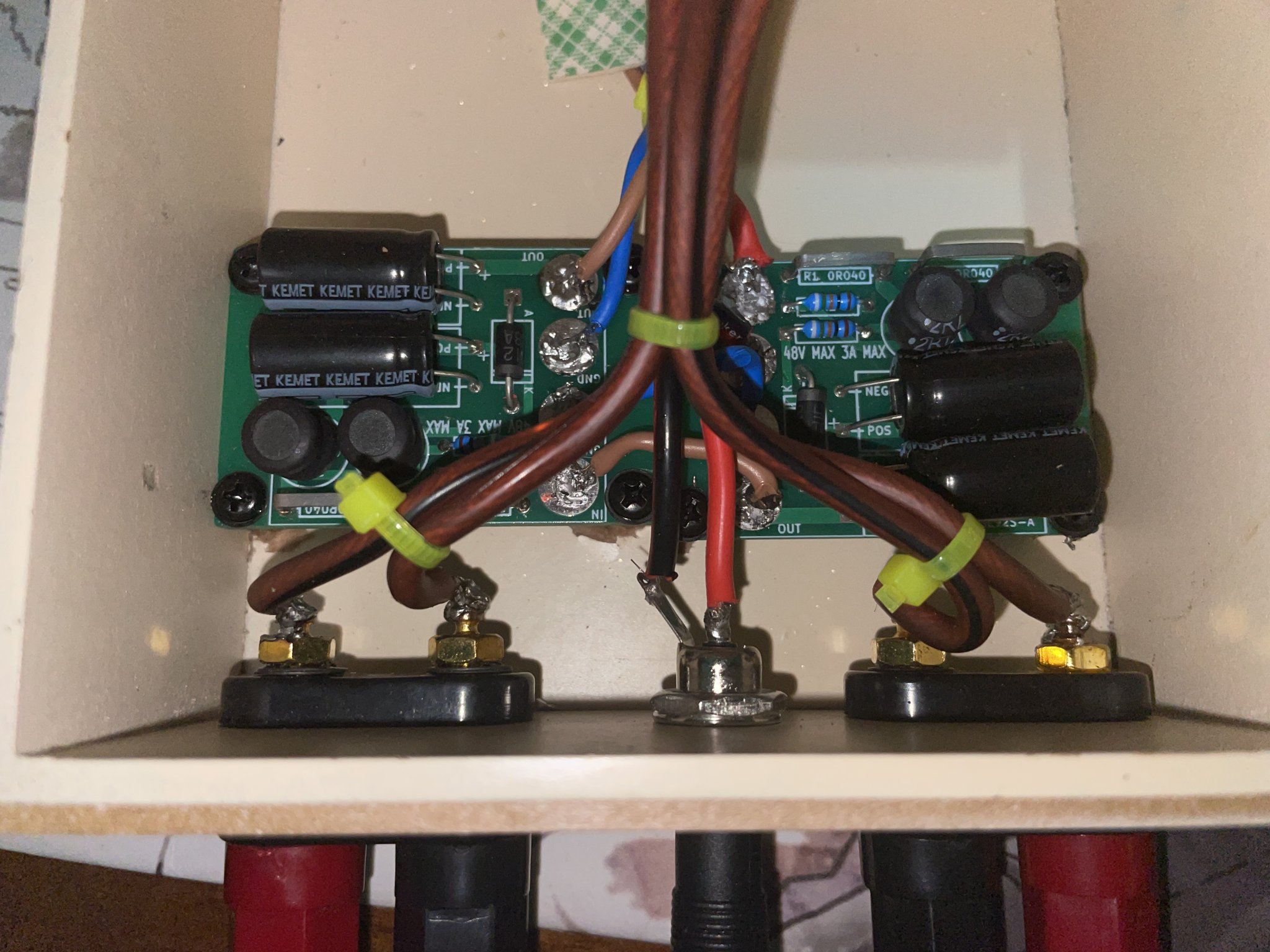

With a little time and adjustment I’ve gotten both channels stable, this is my first build! I super stoked to listen to it.
Really love the look of the exposed board. I’ll probably mount it on a wooden case with speaker connections, like some other build I’ve seen.

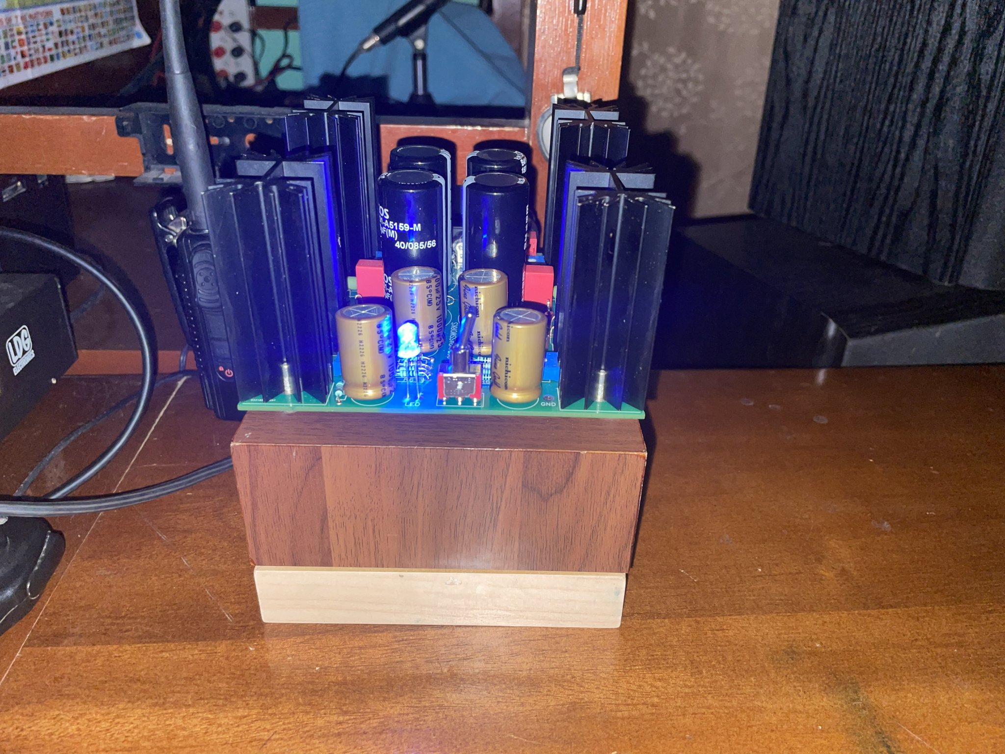

Sharing my Aca mini build. Musical amp and works 24/7 with less power. Thanks papa Nelson. The Preamp ACP+ is ongoing build cheers

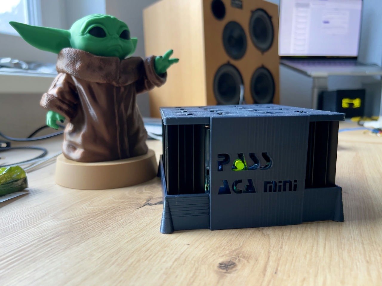

Hi all,
a second ACA mini kid in the house and a new design for the housing .. now we can try both in the "parallel mode". 🙂
Ok, the LED still needs to be aligned and set a little darker.

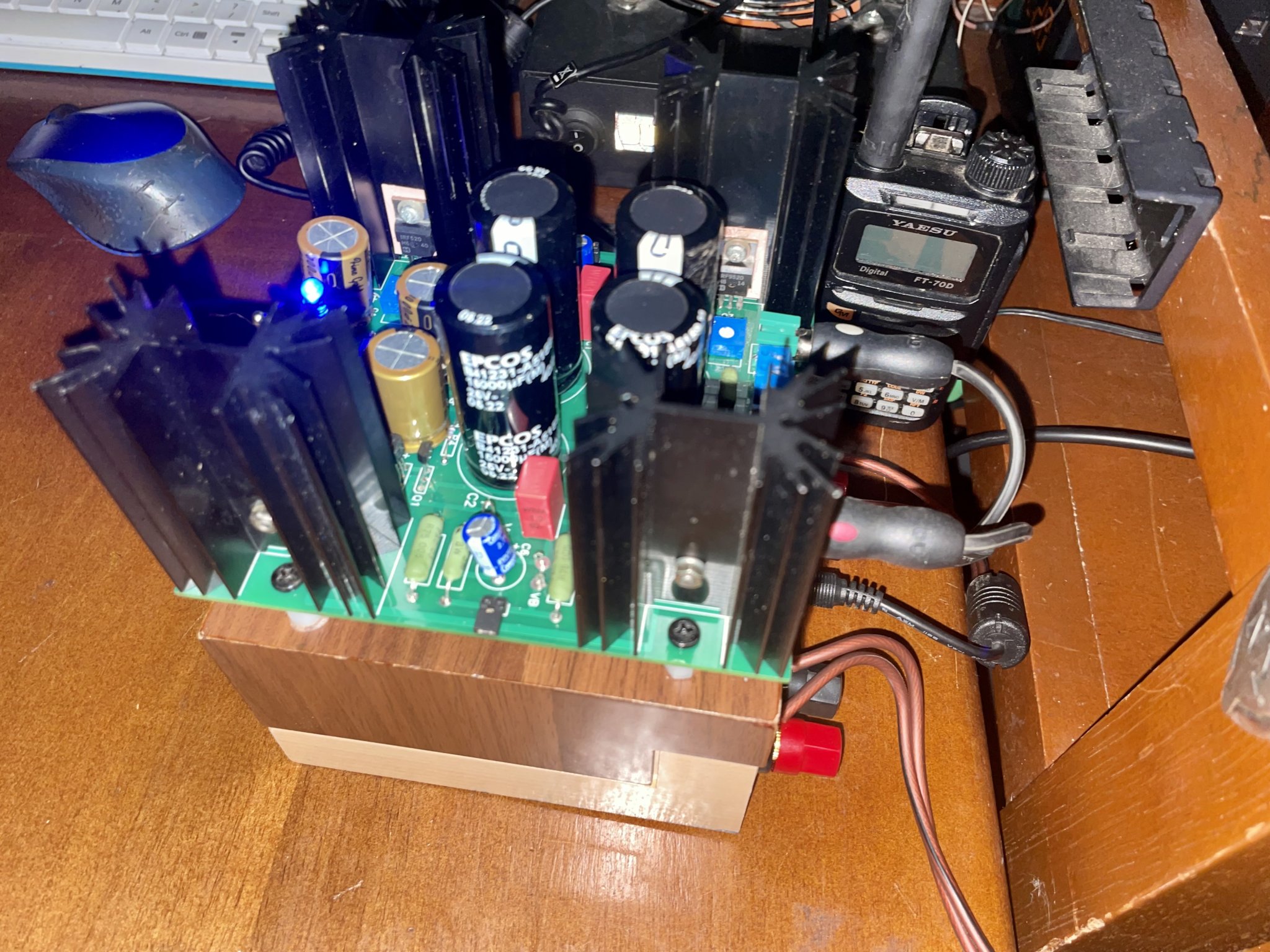

Took awhile to bias the amp, probably because I was too ham-fisted with the adjustments. Just put it in the rack, replacing an Icepower 50ASX2SE class D amp, which I would call a 20watt/channel into 8 ohms amp based upon the published graphs. The ACA is connected to Fostex 166EN full range drivers crossed over at 1200 hz to 12 inch woofers. The woofers are powered by an LM4780 chip amp with a regulated power supply. Still have to fiddle with the balance between low and high. Got a question for people who have some experience with the ACA. Do you leave yours on all the time? If you don't, does it maintain the correct bias when you turn it back on? How long does it take to get back to stable operating temperature?
I power mine up about 15 minutes prior to use. I've been powering some older ADS L620 speakers with plenty of "umpf" for my taste. I will say that local temps and forced convective cooling from local drafts will affect the bias if you're actively measuring it, however, I don't think I can perceive the differences in sound, so I don't bother changing anything bias wise since my first attempt. It sounds really great for what it is and I couldn't be happier with the compact and affordable design. Thanks so much Mr. Pass and all those who helped for another great DIY amp project!

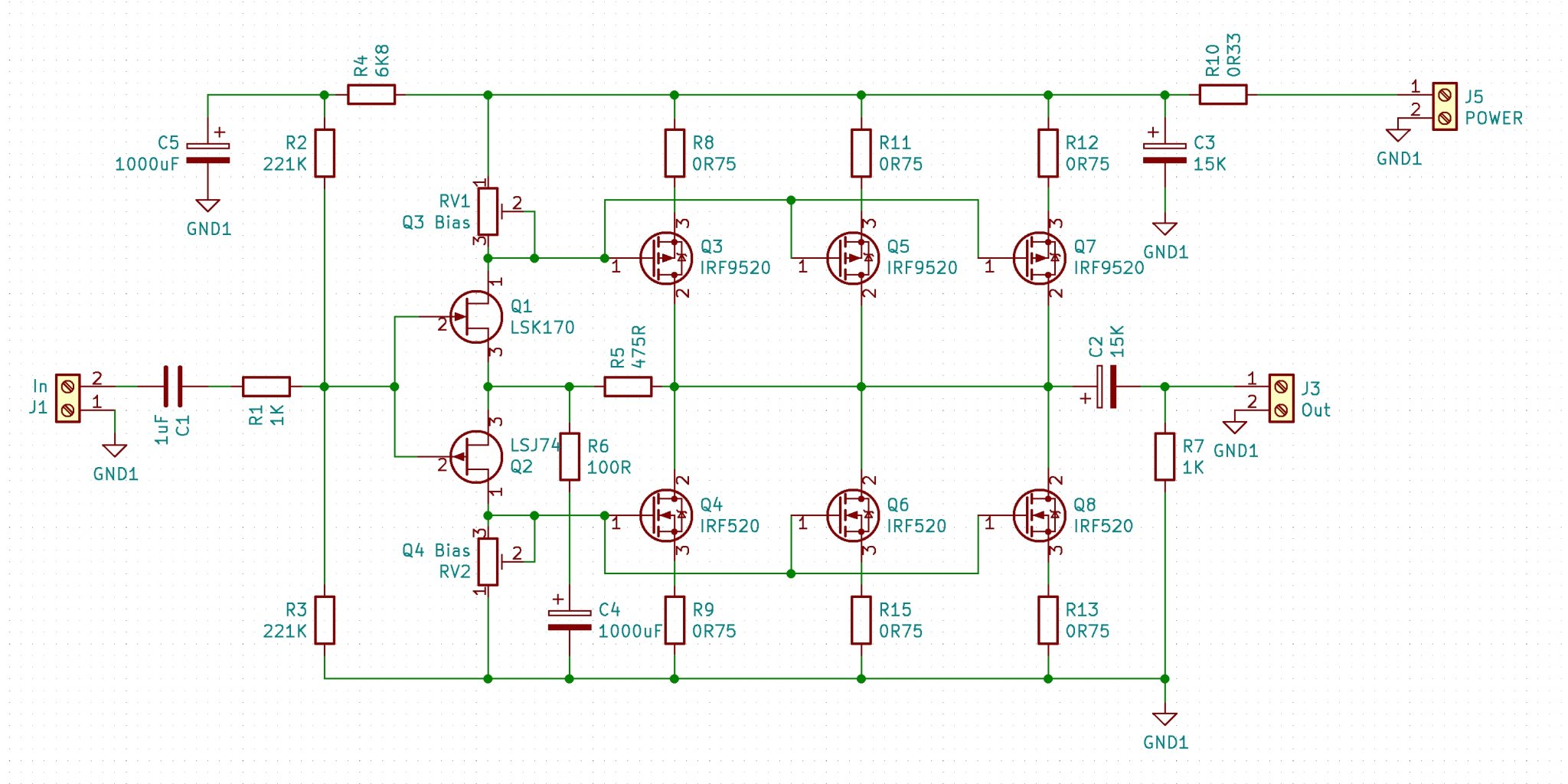

Now... this might be nuts, but I am, so let's skip that part.
I am also a huge fan of this little monster. It plays beatifully, it's loud enough, and it's good for my electricity-bill.
I know I can't make this baby perform like an F4, but I would like to try nudging it a bit, to see if I could add just the tiniest bit of xtra 'grip'.
So... would this work, or would I need to add some gate-resistors when parallelling outputs?
Thank you!
Thank you!
having gate resistors is safety measure
except in cases when you exactly know what you're doing and why going without them
note - sum Iq for circuit above is measure of your intentions
