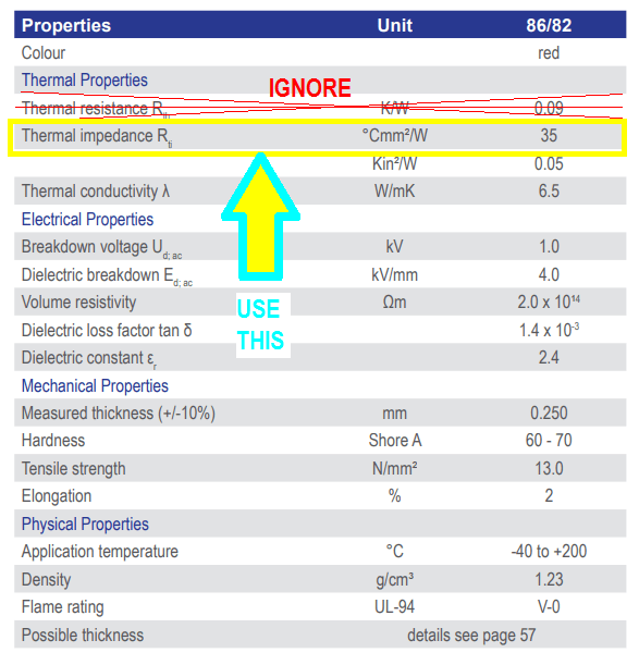

Oops, I fear you have used the wrong line item from Kerafol/Keratherm's datasheet and so you got an incorrect numerical value of "Rcs".
You want the thermal impedance of a piece of Keratherm 86/82, squeezed in between a TO-220 (IRF520) metal mounting tab, and a semi infinite slab of solid aluminum. Take out your calipers and double check me; I claim the TO-220 mounting tab is 12mm X 9mm, so its area is 108 mm^2. Plugging that into Keratherm's equation
(degrees C) / (Watts) = 35 / (Area in mm^2) = 35 / 108 = 0.32 degreesC per watt
The nice thing is, the bigger the package, the greater its metal mounting tab area, so the heat flows through a greater area of Keratherm pad, and its thermal impedance falls. Therefore the big bohunker TO-264 transfers heat through Keratherm a lot better than TO-220. Which agrees with our intuition.

- (deltaT in degreesC) * (Area in mm^2) / (Power dissipated in watts) = 35

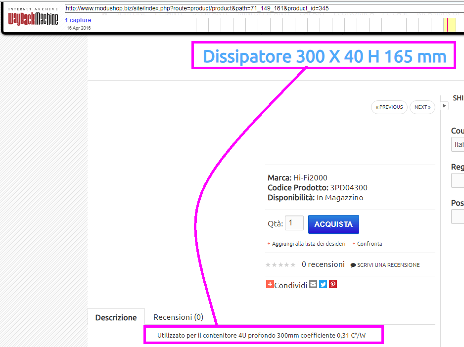

Modushop's website has a couple broken links, and their employees are on August holiday, so I used the internet wayback machine to discover what the links showed, a few months ago (when the links still worked). There's a screen capture below. If it's helpful, great. If not all that helpful, at least it demonstrates that you can sometimes use the wayback machine to discover what ought to be at the far end of a currently-dead link.

MJ,
Thanks for checking my oversight. So with a TO-220 device, the Rcs is about 0.32 deg C/watt after calculating the thermal impedance of sandwiched Keratherm sized for a TO-220 area (it is nice to know that devices with larger surface areas calculate to smaller Rcs values!).
This changes numbers slightly but accuracy is still important. Still Tj will be comfortably under max of 125 deg C.
And Rsa for the 4U/300 heatsink appears to be anywhere from 0.31- to 0.36 degC/watt compared to Aavid’s 2.6 degC/watt.
All in all, we have room to play with regards to the dissipation of this TO-220 transistor. And at the end of the day, the elephants in the room are the thermal resistance of the heatsink to ambient, the amount of power dissipated by said device and additionally the local ambient temperature immediately surrounding the device itself.

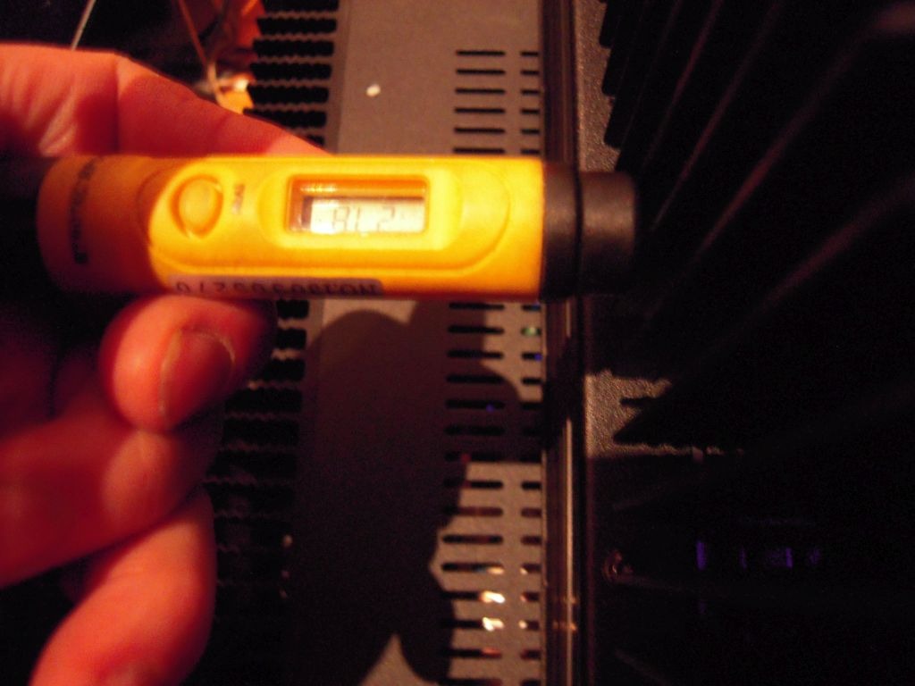

Hello Anand,
hello Mark Johnson,
I have measured the temperature of the Mosfet from outside the heatsink (inbetween the fins, where the Mosfet is mounted inside).
I did this after one hour of listening. Temperature was 27° - 28° Celsius.
Roomtemperature during measurement: 20.4° C
Case is a Modushop Mini Dissipante 2U 250mm with 10mm front. Heatsink temperature coefficient 0.47° C / W.
https://modushop.biz/site/index.php?route=product/product&path=284&product_id=733
Bias resistors R8/R9 slightly lower than original: 0.68 Ohm / 5 W
VB still at 0.200 V.
Perhaps it helps?
Cheers
Dirk 😉

@cubicincher
So you have the bias at (0.2/0.68) or 0.3A. You can turn the pot a little more if you like. 0.25V will get you to 0.36A. But I’m sure you are happy with the sound where it is! Enjoy!

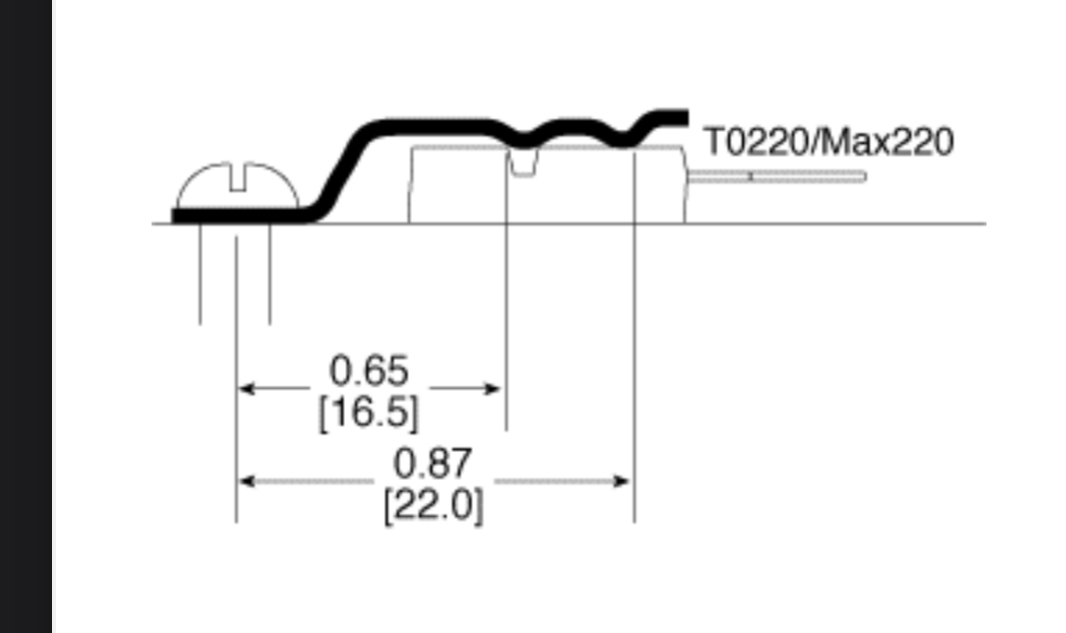

MJ,
I am considering using one of those Aavid mounting clips.
Best,
Anand.

Or get a piece of aluminum, drill two holes in it and drill and tap two holes in the heatsink.
I was just thing if you had a small piece of aluminum or even steel lying around, it would be quick and easy.
Great idea! I will upgrade to those spring steel mounting clips in my ACA mini amps.
I always worry slightly, slightly that the high heat cyklings of the class A amps will loosen the screws and/or the pressure on the active devices.
