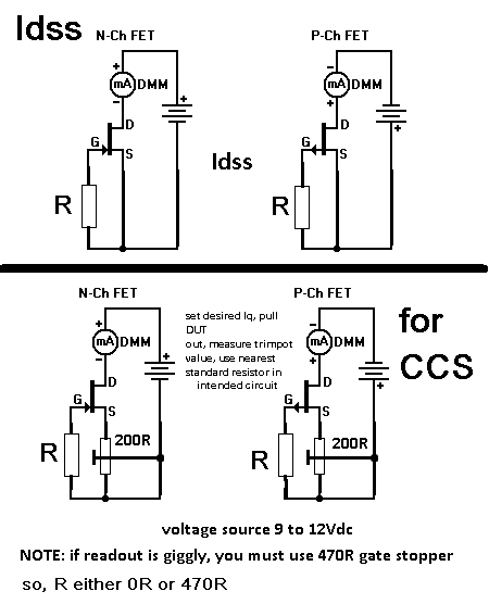

The Jfets in the kit were all tested and matched with Idss greater than 5 ma, which mates with Mosfets in the low 4 volt range. I haven't encountered any that didn’t bias up, although they all have pots operating mostly clockwise - deliberately.

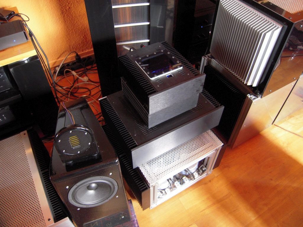

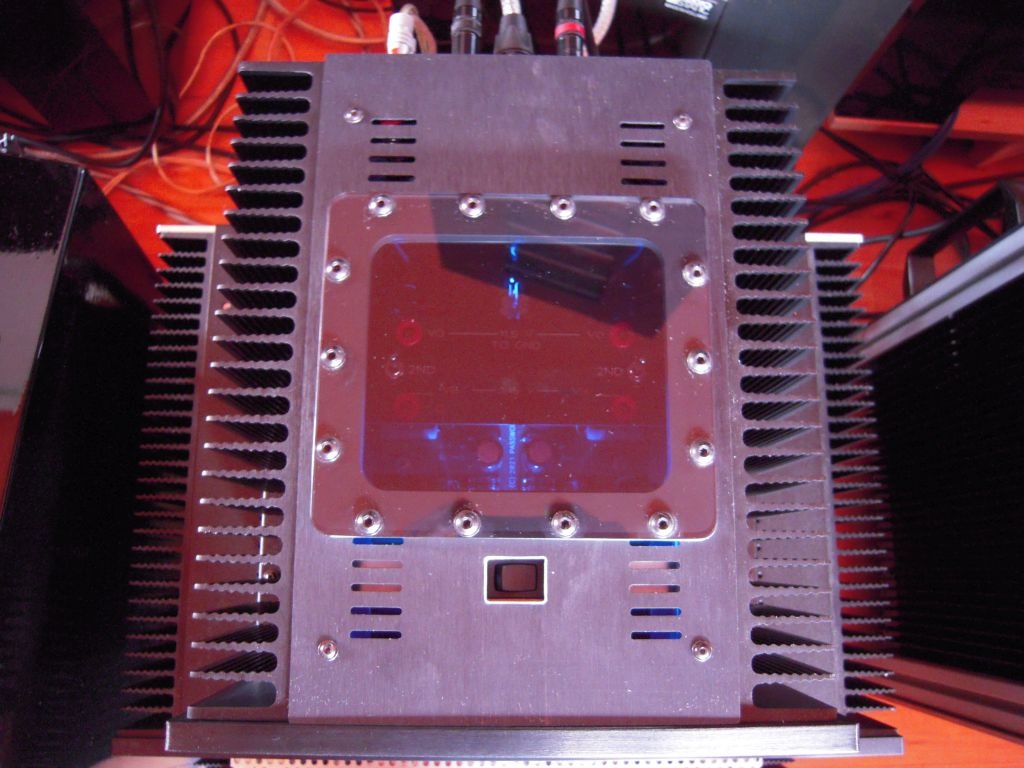

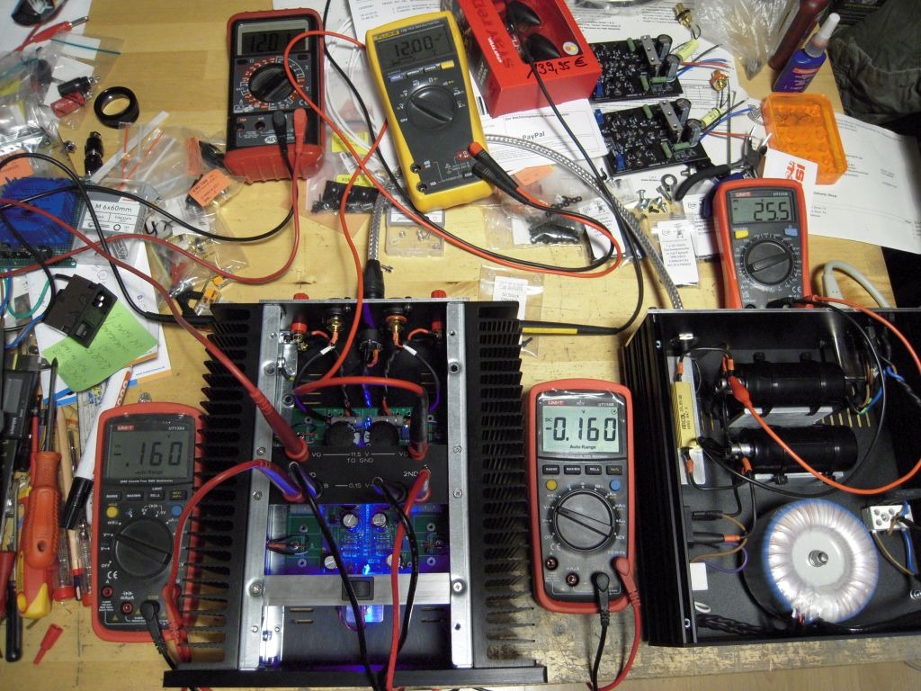

last night I finished my build of the ACA_mini. I was listening to it and was very impressed. Nice little amp.
It is running in my active-setup driving Air -Motion - Transformers.
Frontend 2022-preamp / 6-24-AXO /ACA_mini for AMT / BA-3 driving bass/mid.

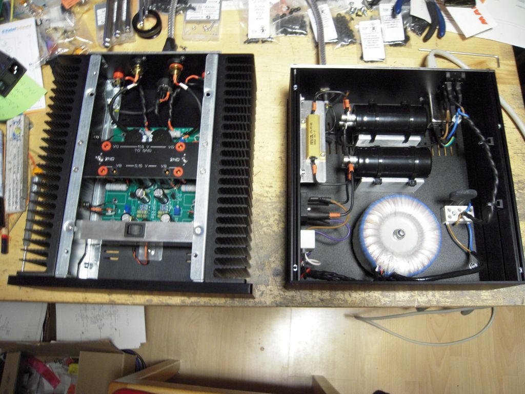

PSU is build with toroid (2 x 9V AC sec. / 100 W typical DIY-overkill), CRC-filter,...

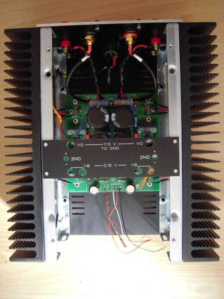

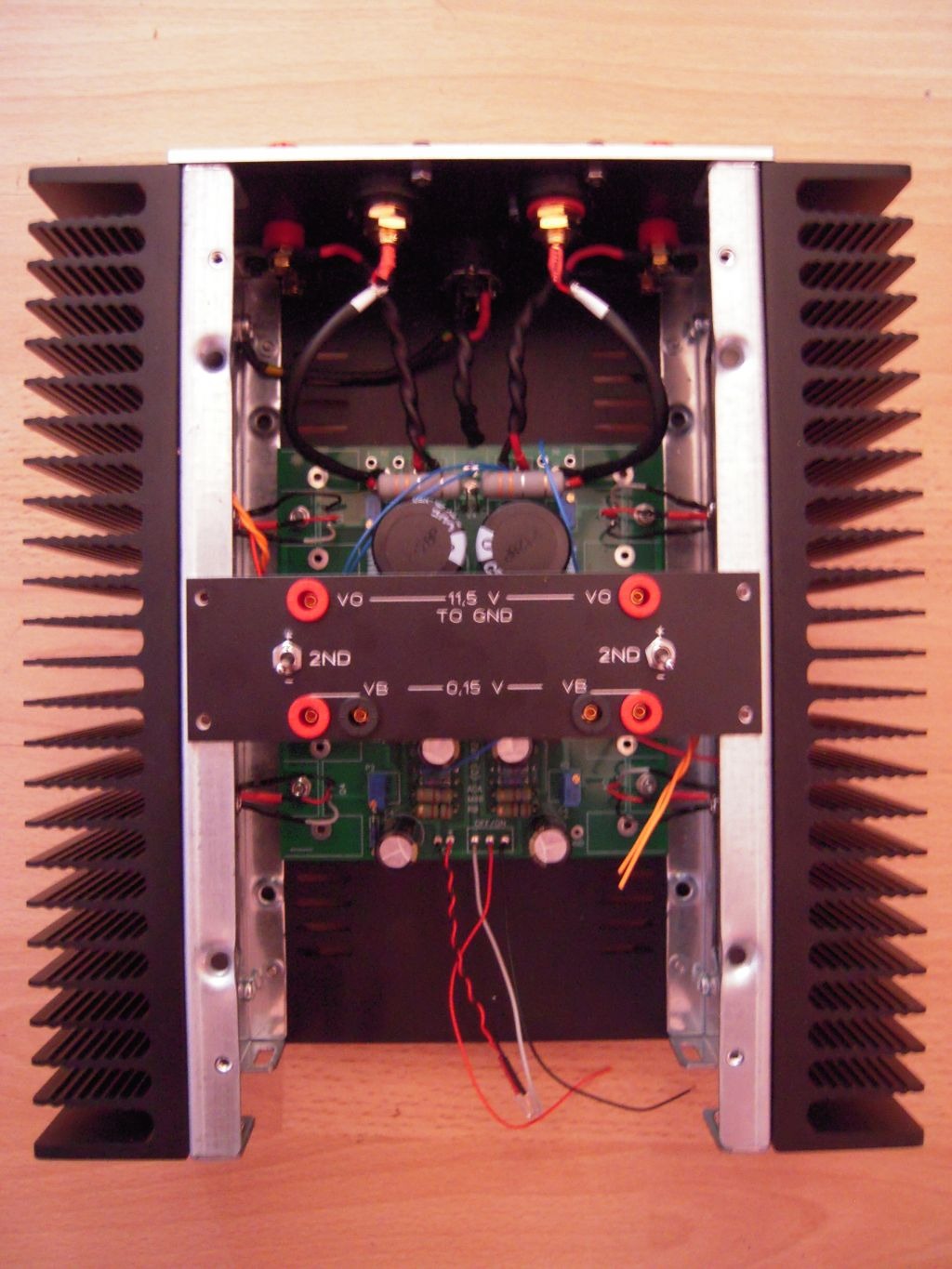

I measured an V-output unloaded of 27.4 V DC. Thought could be a little high. Sagged to 25.4 V loaded and biased up.
I biased the amp higher. At the moment 0.200 V (VB).

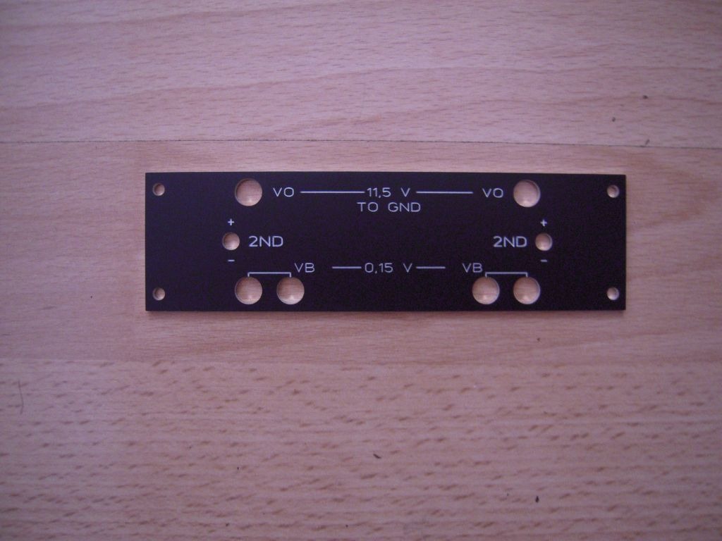

I added an aluminumplate with the switches (higher / lower 2nd - harmonic) and labsockets for easier measurements.
