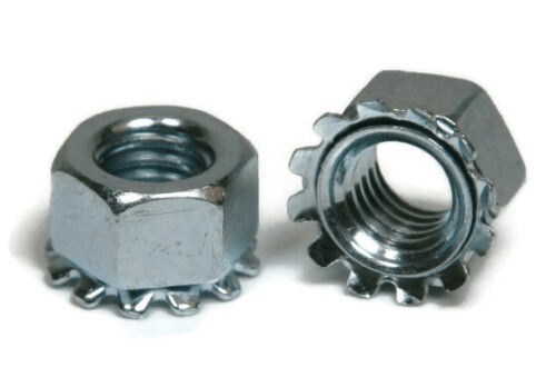

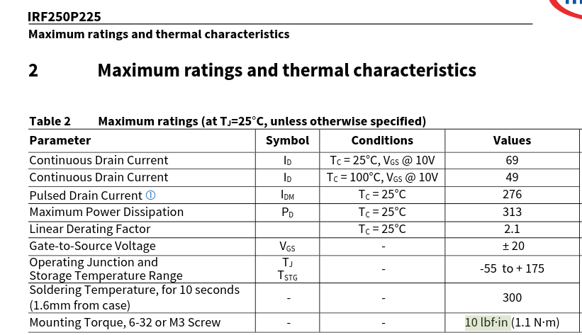

Why not just use Kep Nuts?...I always worry slightly, slightly that the high heat cyklings of the class A amps will loosen the screws and/or the pressure on the active devices...
Regular Nuts/bolts and split locking washers? Yea, of course, it works. Thats what i am using now and it works perfectly fine so far. 🙂
But it is not uncommon in a myriad of technical applications that those tings over time somtimes with heat/cold cykles works them self loose.

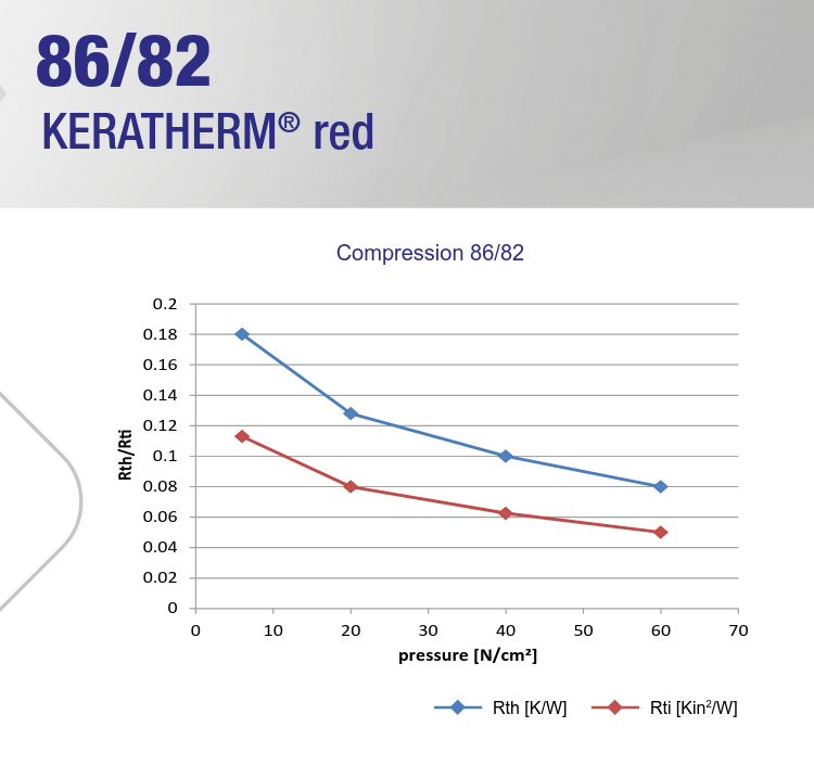

My thinking is that the spring steel fasteners better will flex and maintain pressure over time, far beyond my lifetime, spread the pressure better and will not overpressure the Keraterm.

split washers - I personally have no doubt in their longevity, under condition that they're of proper quality
I wrote several times - in my neck of wood, best way of obtaining controlled/trusted quality of M3 hardware is - using SS ones
everything above M3 I can buy "in quality" (local term of trade, meaning proper goods so you can trust marking), but M3, common things, that's made of ....... cheese
so, for me, buying locally SS is much simpler than buying non-SS-proper abroad

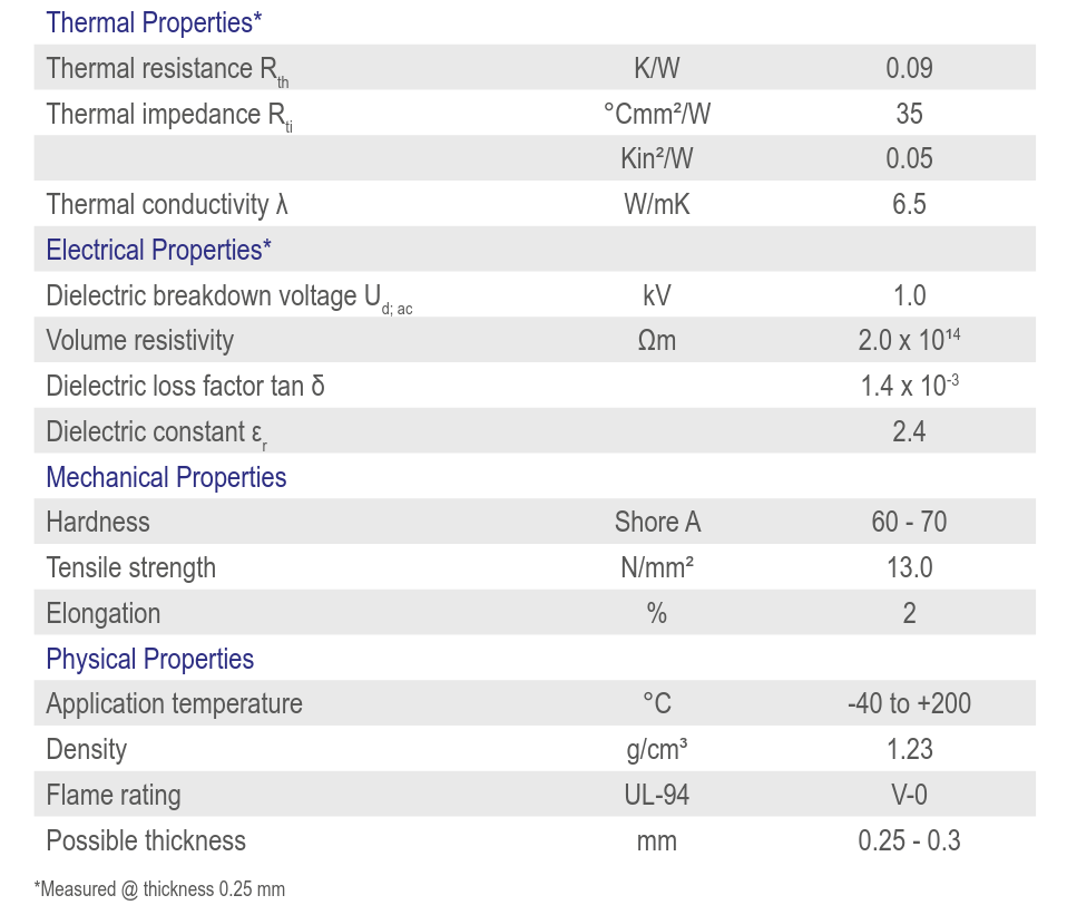

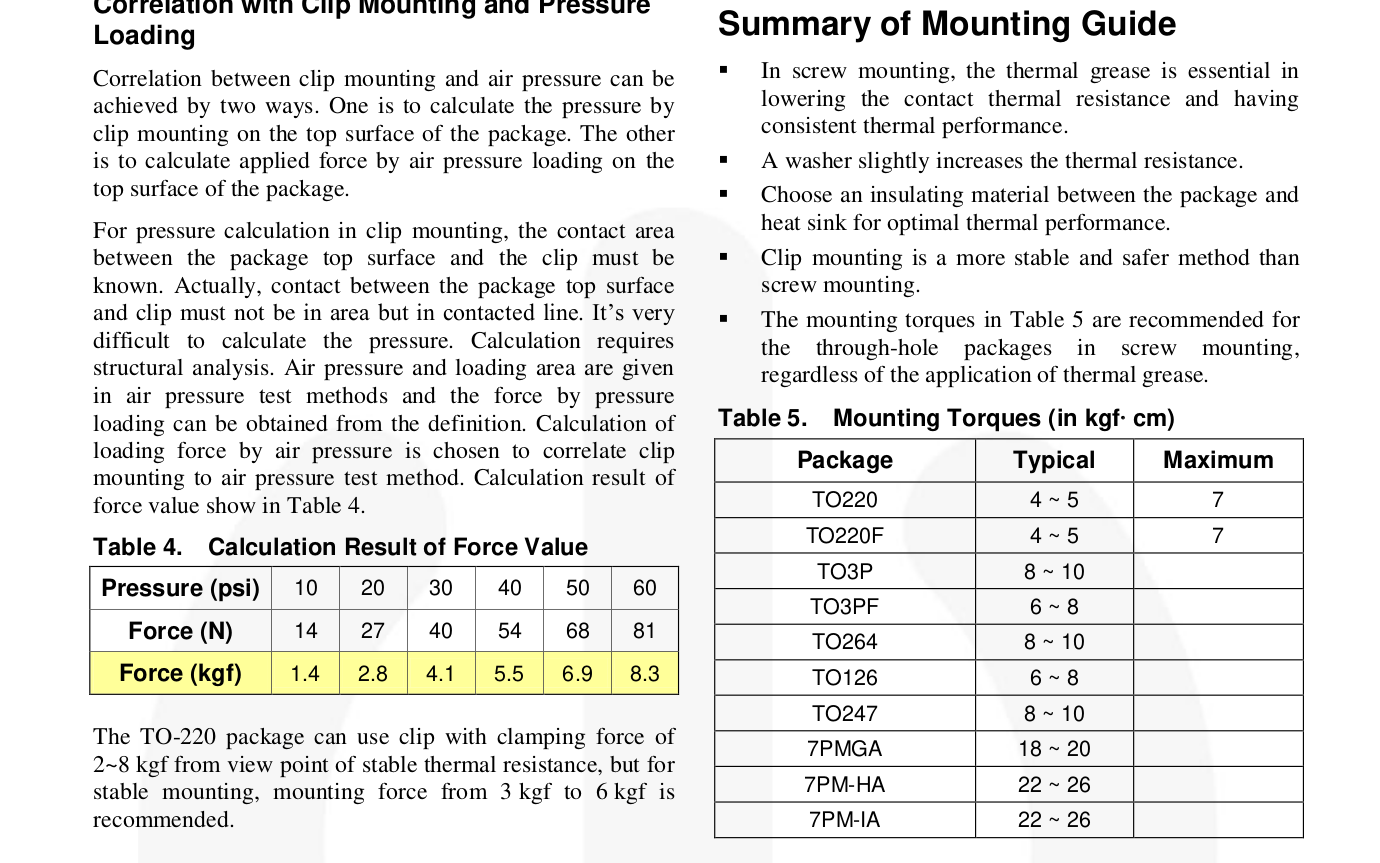

Post 2331 is an important one, particularly the excellent info/datasheet from Fairchild that MJ graciously shared. Page 8 has some recommendations, not specifically stating for Keratherm but they are at least a start.will have the right pressure for Keratherm ?
datasheet don't help
For me at least, I have used mounting clips before with great success. And particularly for Class A builds, I really like the idea.

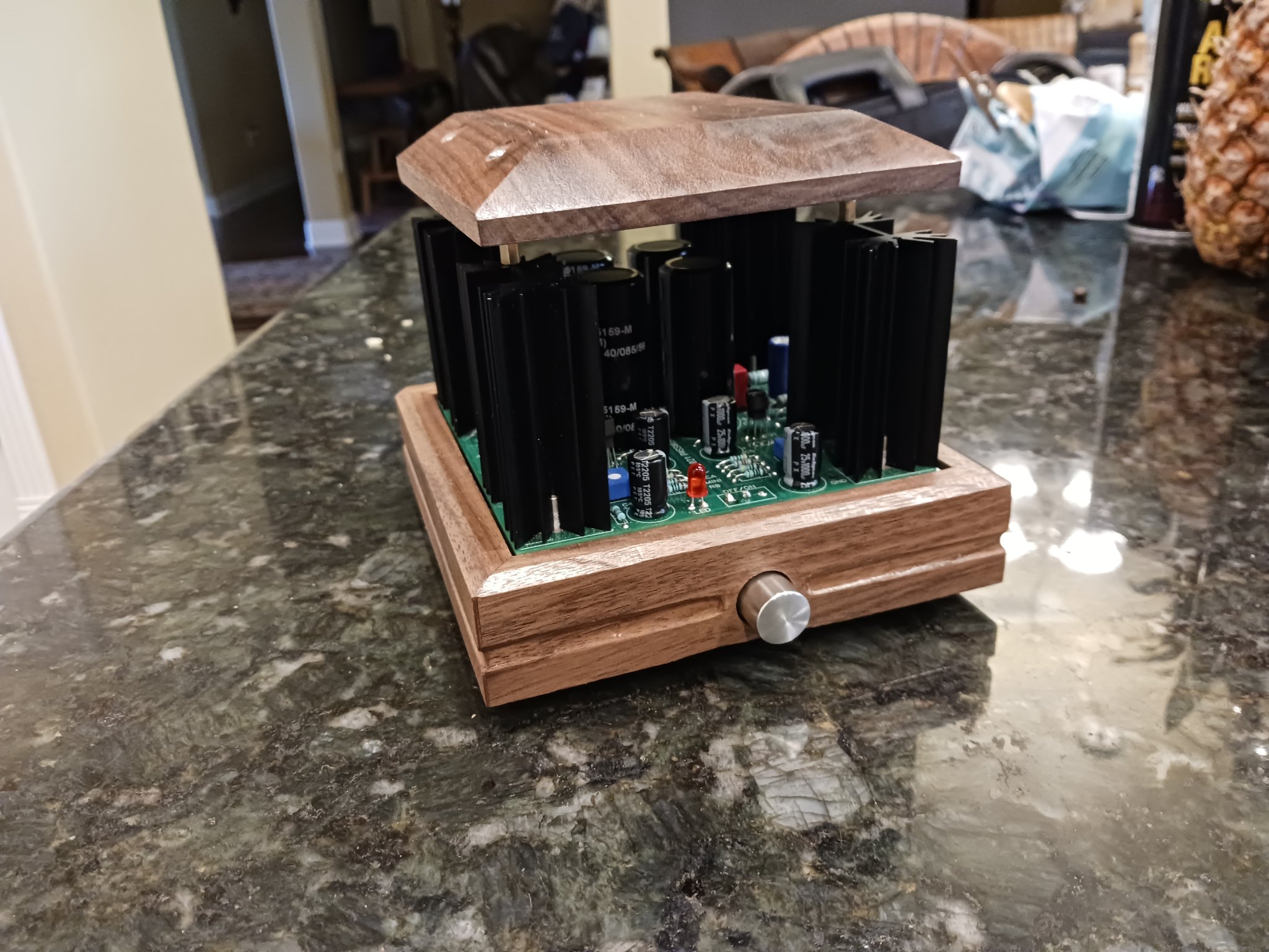

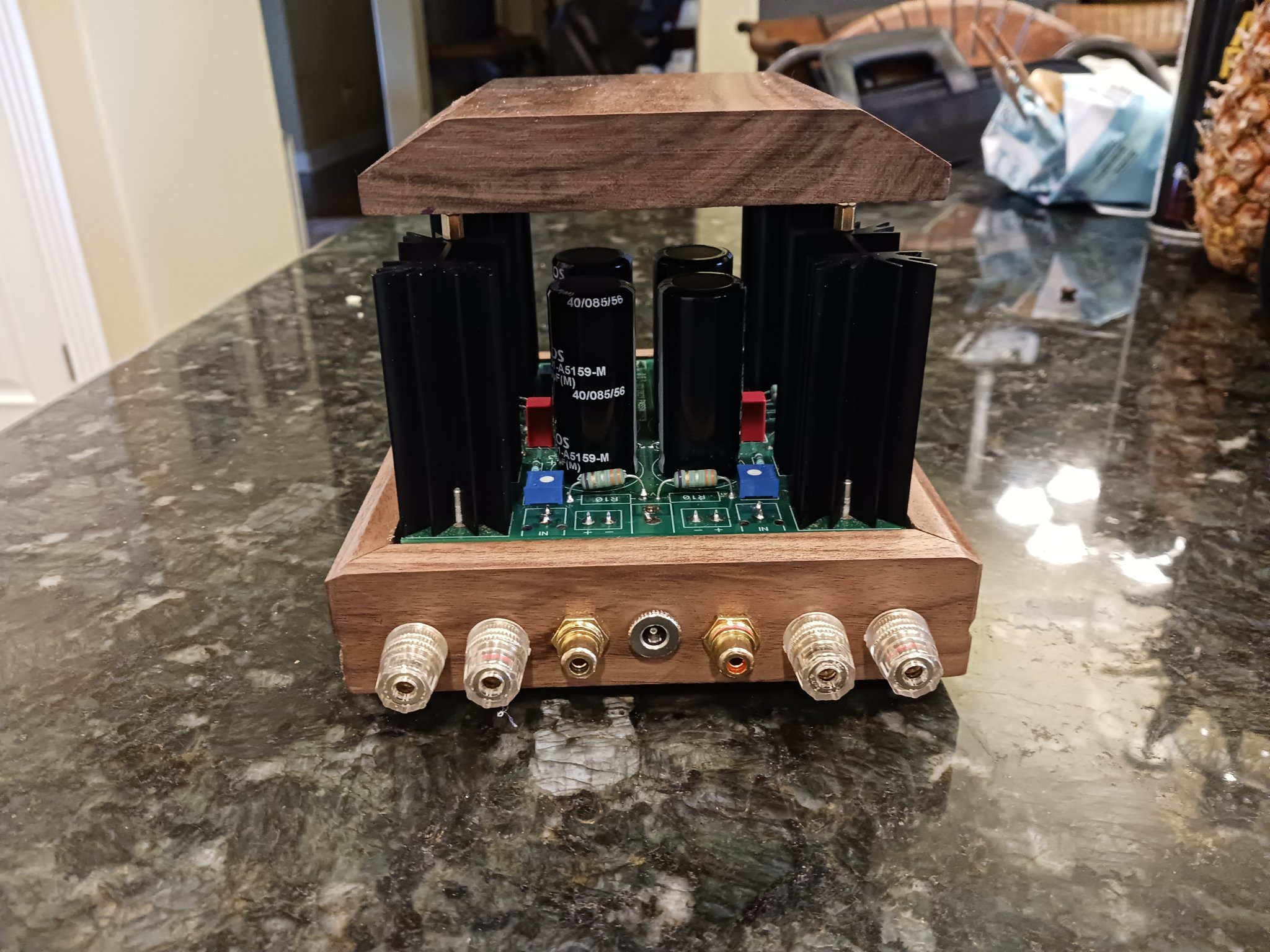

I finally finished dressing out the ACA Mini I built a couple of months ago. It's simple, but it does the job. I was going to enclose it with acrylic panels and a fan, but I decided to go commando to save a little time . And yes, I realize I have the inputs backwards. 🙂
Holy crap that looks beautiful. You should push the DIY Audio store to include the side panels and the roof in a kit (if you are interested in providing them to Store, of course).... at least as an option.
Thank you for the kind words. I think I'll have to wait until they invent a 3D wood printer to offer that service. 🤓
Black Walnut. Amazon has quite a selection of hard-to-find wood in small sizes. My son build an enclosure for his B1 Korg out of Padauk he got from there. I had never heard of it before. It's bright orange and very dense. The sawdust looks like the powder at the bottom of a bag of Cheetos.

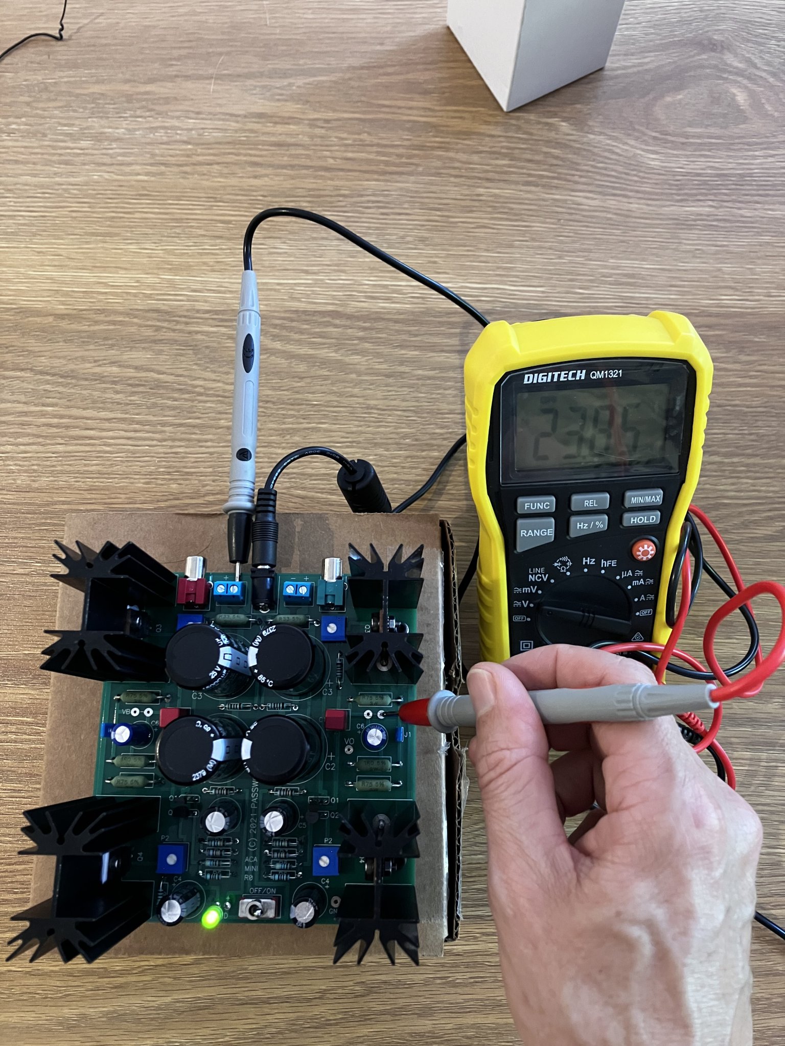

I’ve just finished soldering the ACA mini and have double checked all cap polarities, resistor values, solder joints and the correct position of all transistors. With the pots turned fully clockwise I am getting a reading or 23.85 volts at VB.
I am getting the same values regardless of the position of the pots. I am not sure what to look for? Can anyone help me out?
