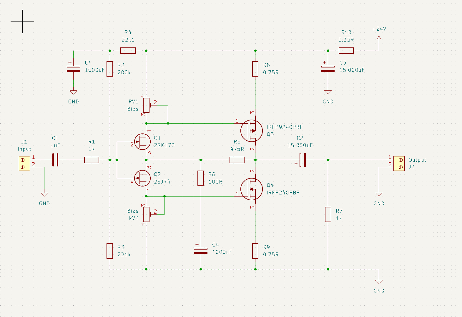

You can modify the circuit of post #2392, add zero new components, and reduce C4 by a factor of 10X. From 1000uF to 100uF. Reducing parts cost and board area.
Disconnect and move R3 so it is now in parallel with C4. Modify the values of R3 and R4. Change C4 to 100uF. Done.

You can but then you are in F5 territory (bias, Ciss, Qg, etc.) and better off building F5.I had a discussion with Carsten (CW) about more output devices. Why not use IRDF240/IRFD9240 and more bias?
