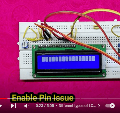

Thanks, yes. Initially all I had was a blank screen, adjusting the contrast made the top row boxes visible.

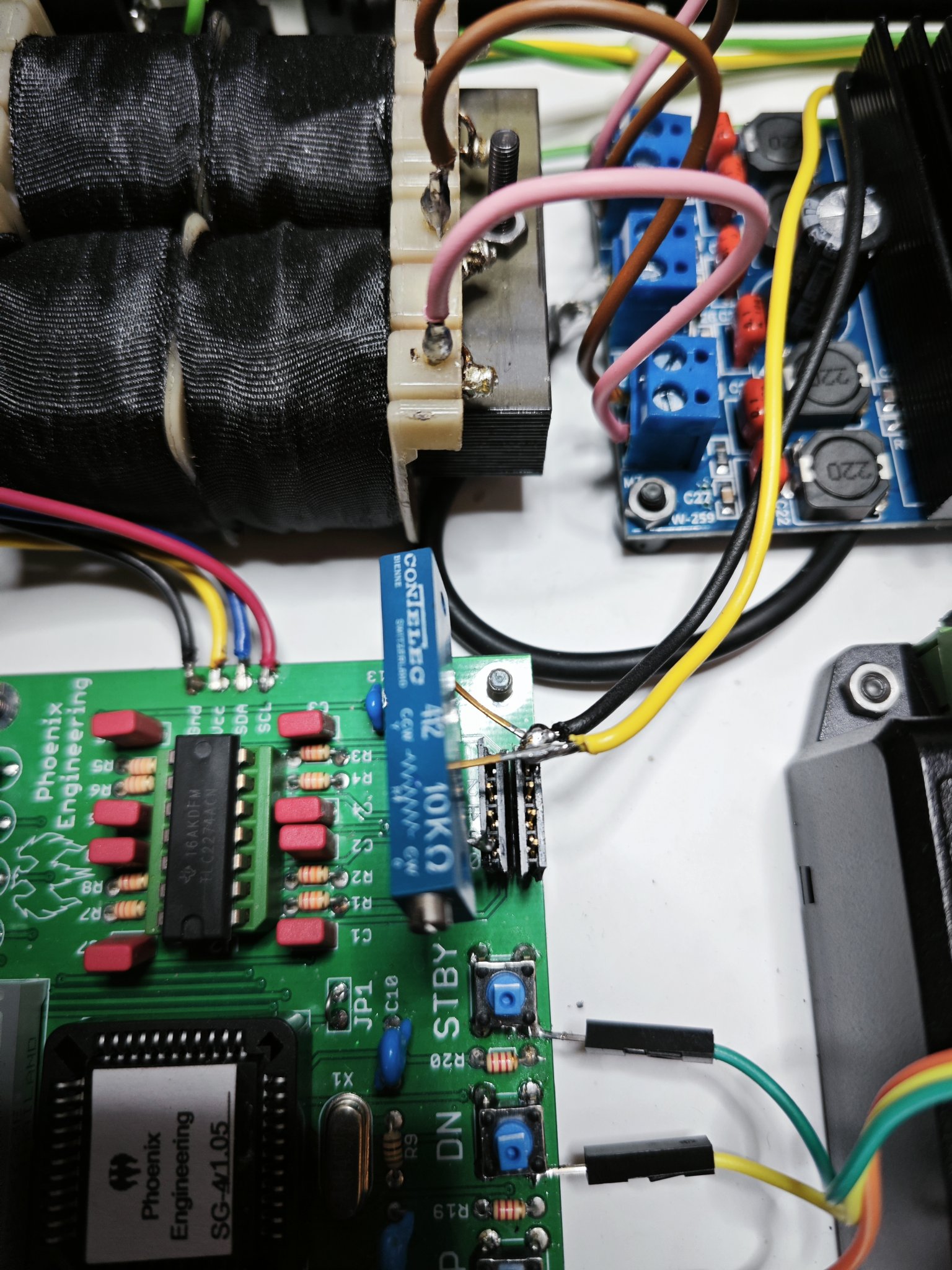

this is what I am seeing - seems to be a chip error? is this possible / has this happened before?
if we are to trust everything on youtube ...
The simplest solution might just be to get a copy of the latest version of the chip, v1.05.
You should be able to get it from Seth Hensel, who is back in the game.

How did I manage to miss this. That did the trick!In addition do you have TP1 connected to ground as that's necessary with the PCF8574 ?

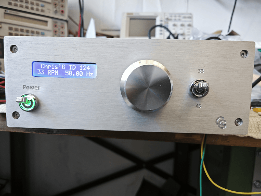

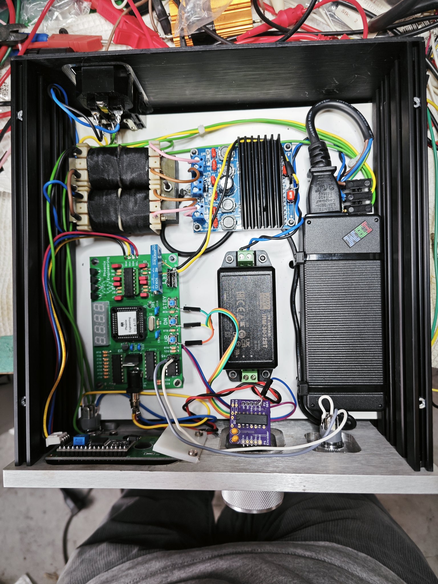

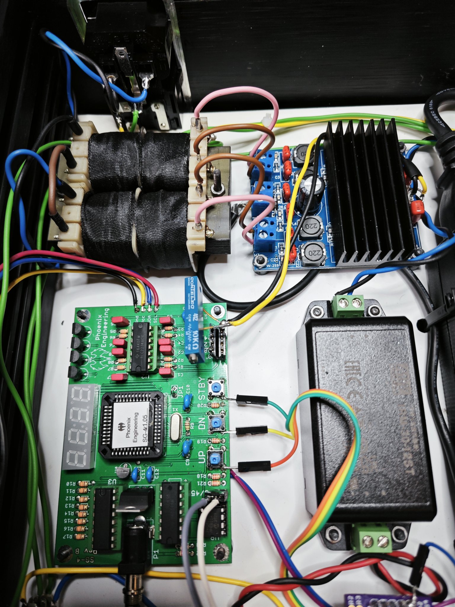

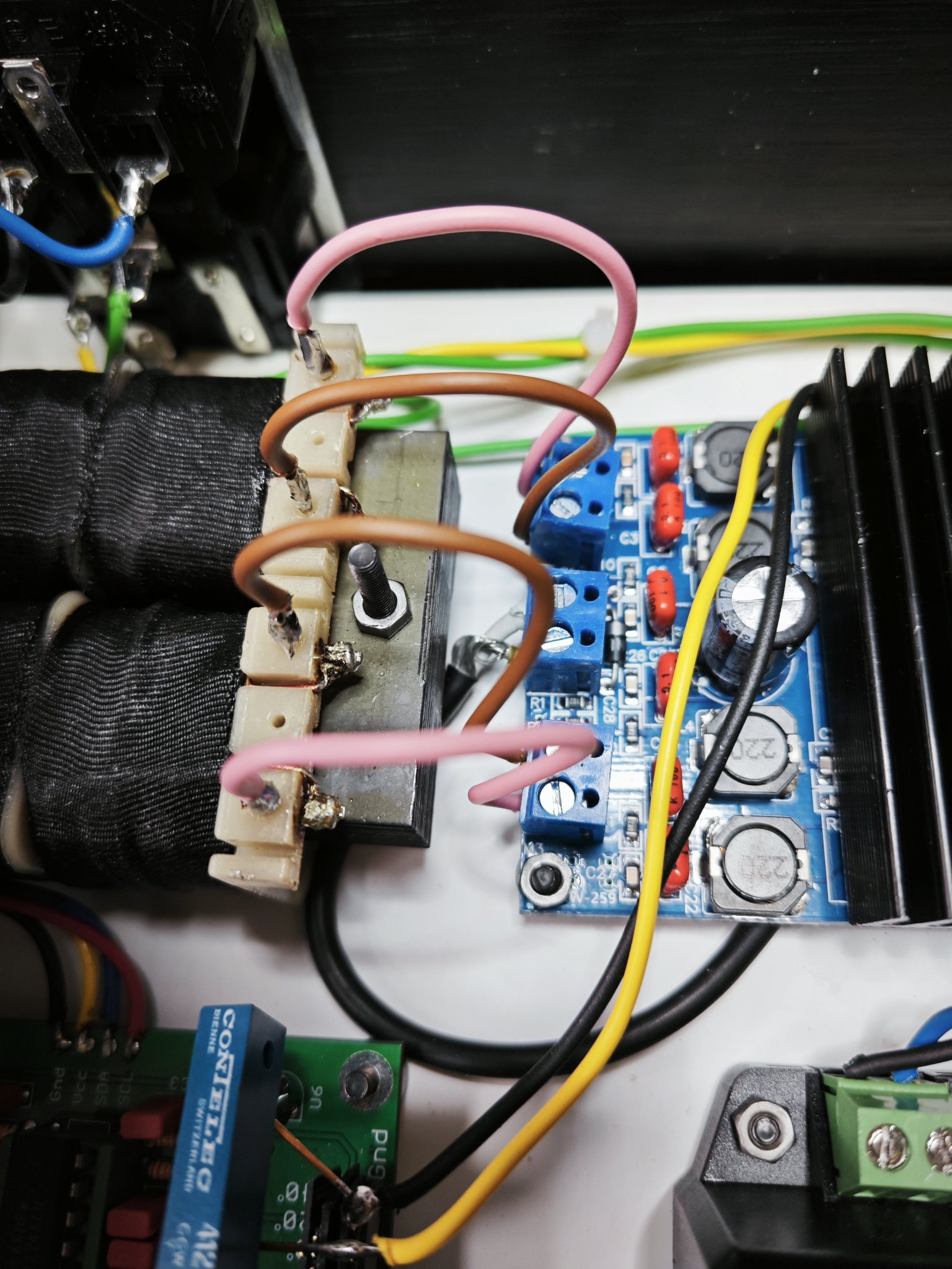

Looks good!, any pictures of the inside?
It's always interesting to see how individuals come up with their results.

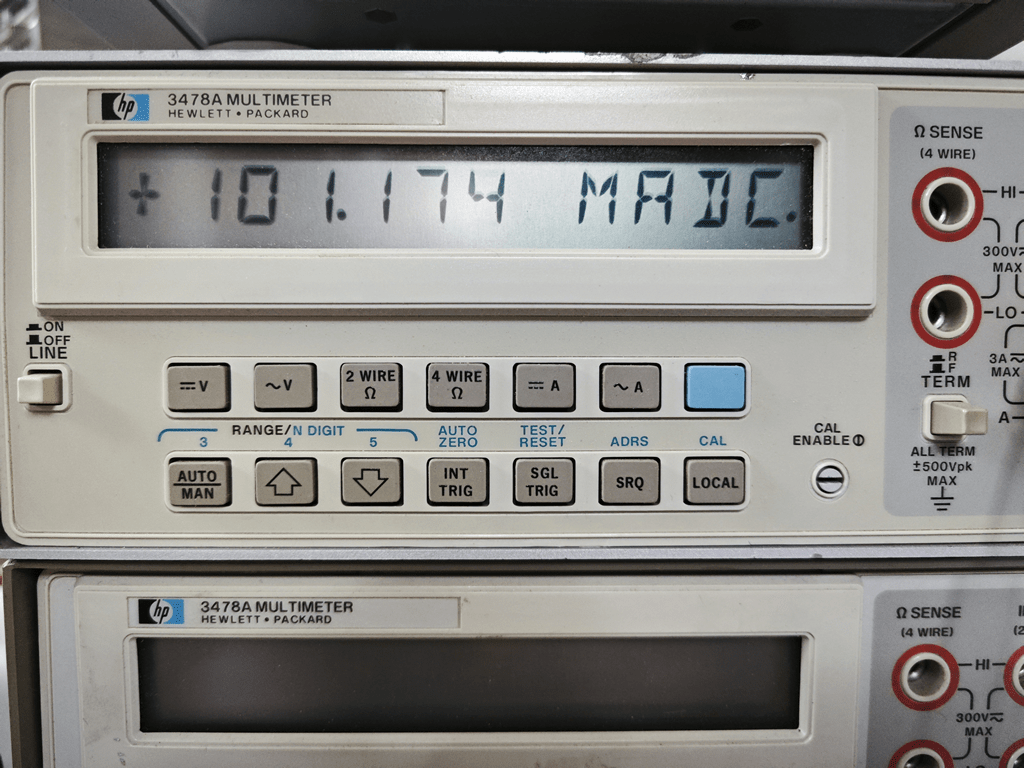

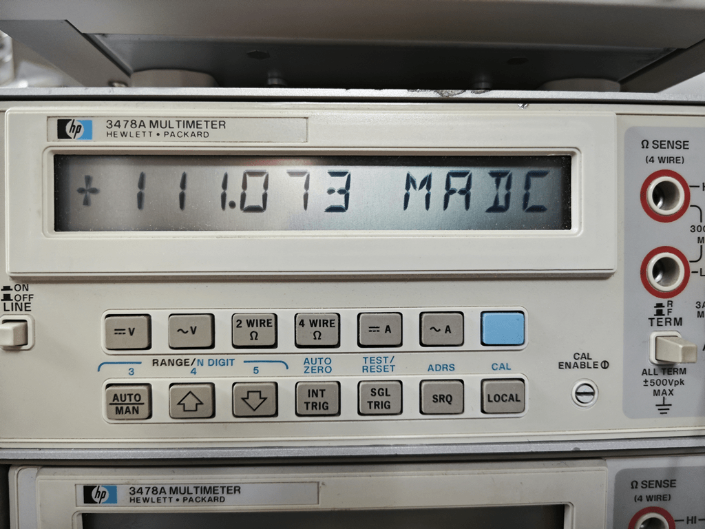

Hi my sg4 with one led for power up use see pictures.Does anyone know how much current you actually need for the SG-4 12V power supply? I see the wall wart at 12V, 230 mA, but I know that power supplies are often given quite a bit of headroom. I'm working on a LM317 regulator tapped off the motor power supply and want to check my power dissipation.
Thanks in advance.
