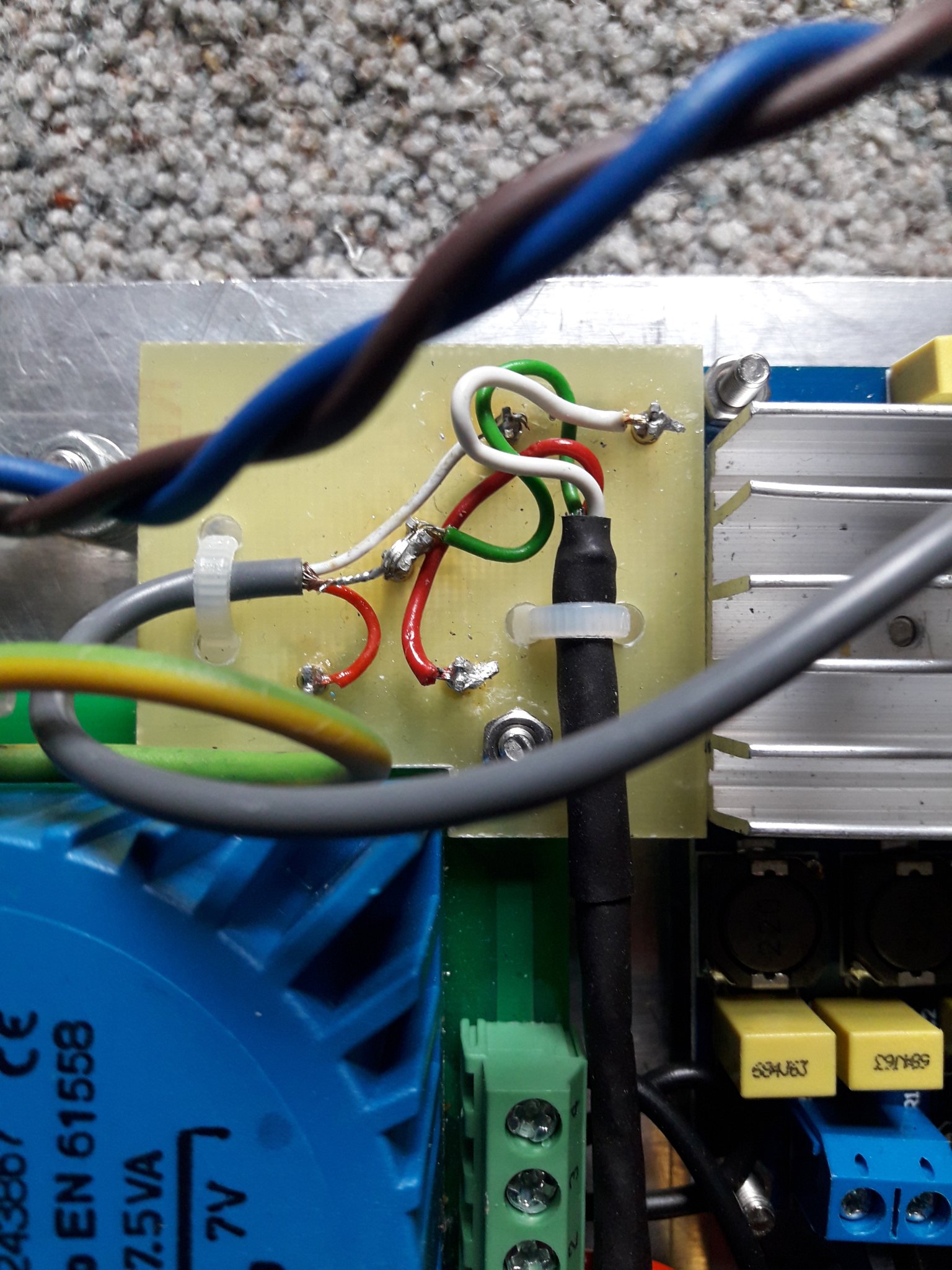

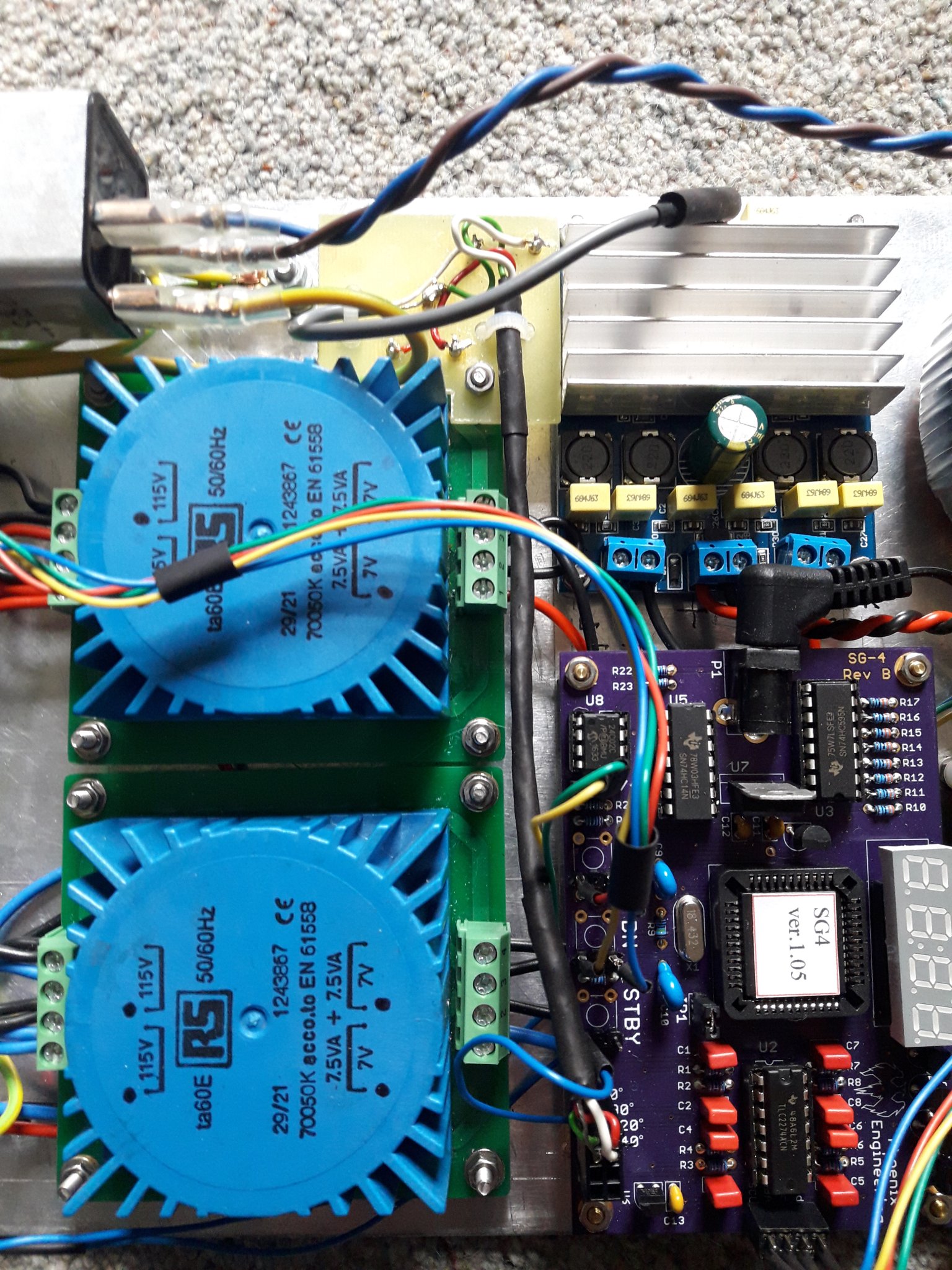

Also small update from my side, I have acquired a new set of transformers, and switched out the one from the phase that was overheating. Now the amp remains cool, and the motor seems to work correctly.
What is concerning me is that the one odd amp overheats to maybe 40°C (warm to touch but not hot). Might this be due to the fact that it is smaller than the others (18va vs 25va), or could this point to some other problem?

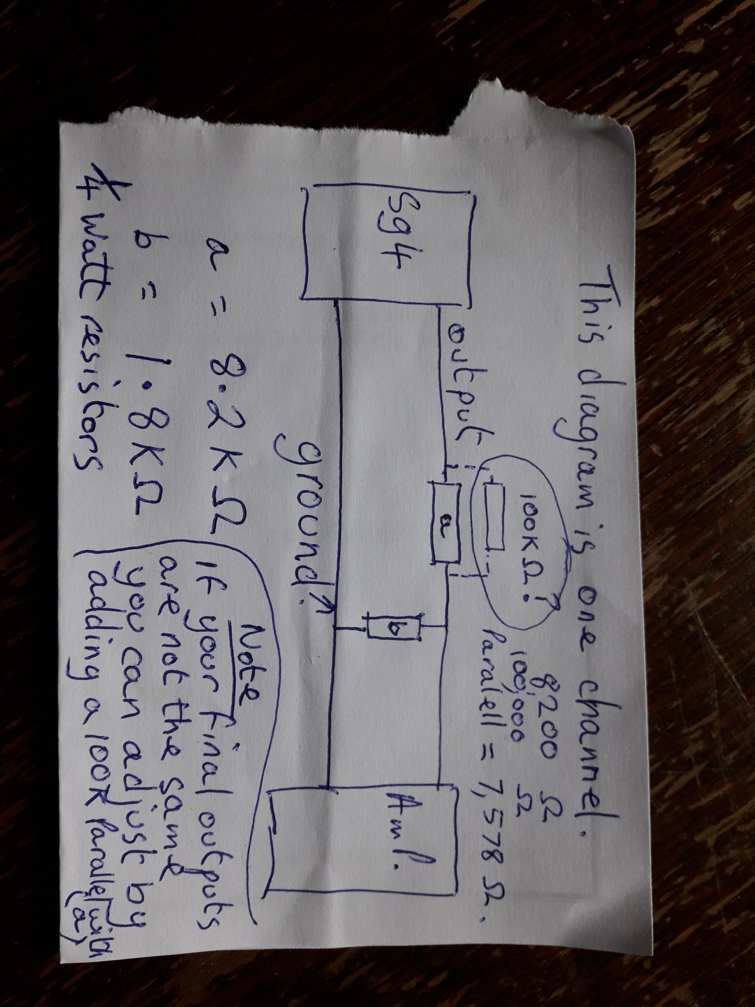

Hi Enby2, my build was to power a Linn Sondek motor. The amplifier is used without modification, but I use resistors between the SG4 and the amplifiers to lower the final voltage down to 100 v ac. I will find the values of the resistors and draw a small diagram. The value of the resistors will depend on value of the step up transformers.
