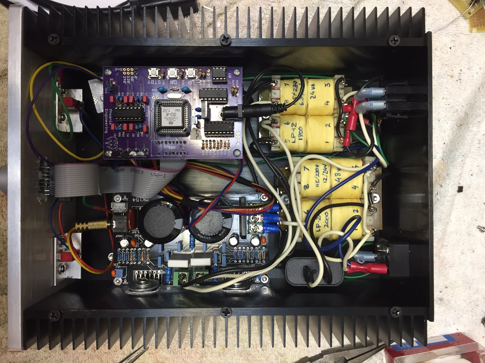

Agreed, but the problem, as described, is not a reset but a return to 'Factory default' condition, normally only seen when both the up and down buttons are pressed simultaneously when applying power. The only other time 'FAC' normally appears is when a new SG4 chip is installed.
No new SG4 chip is needed (as far as I am aware). The unit has seen low to moderate use since it was completed six years ago and this problem has only arisen over the past month or so. Both times, I simply flipped the power switch on and the display presented the "FAC" message. So what's likely causing the problem?
The up and down switches, like the others, operate when pulled to ground, at other times they float.
What you could try is to add a 'pull up' resistor of a suitable value, say 22k, between the active side of each switch and the 5V supply.
Ralph:
Thanks for the suggestion! I have a few spare, small momentary switches on hand. I could remove the Up and Down switches and replace them with ones that hang off a short piece of wire and a 22k resistor but, before I do so, it seems reasonable to also ask if my use of an encoder (hidden beneath the ribbon cable) could be contributing to the "FAC" problem.
Scott
Scott
I'd check the solder connections on each button with a multimeter- do a continuity check to see that the contacts are open. If they registered as closed even when you don't press the button, the chip will read closed no matter what other controls you have connected.
Certainly an encoder could contribute to the problem, they do seem to vary in quality.
Disconnecting it will at least allow you to eliminate it if the problem remains.
