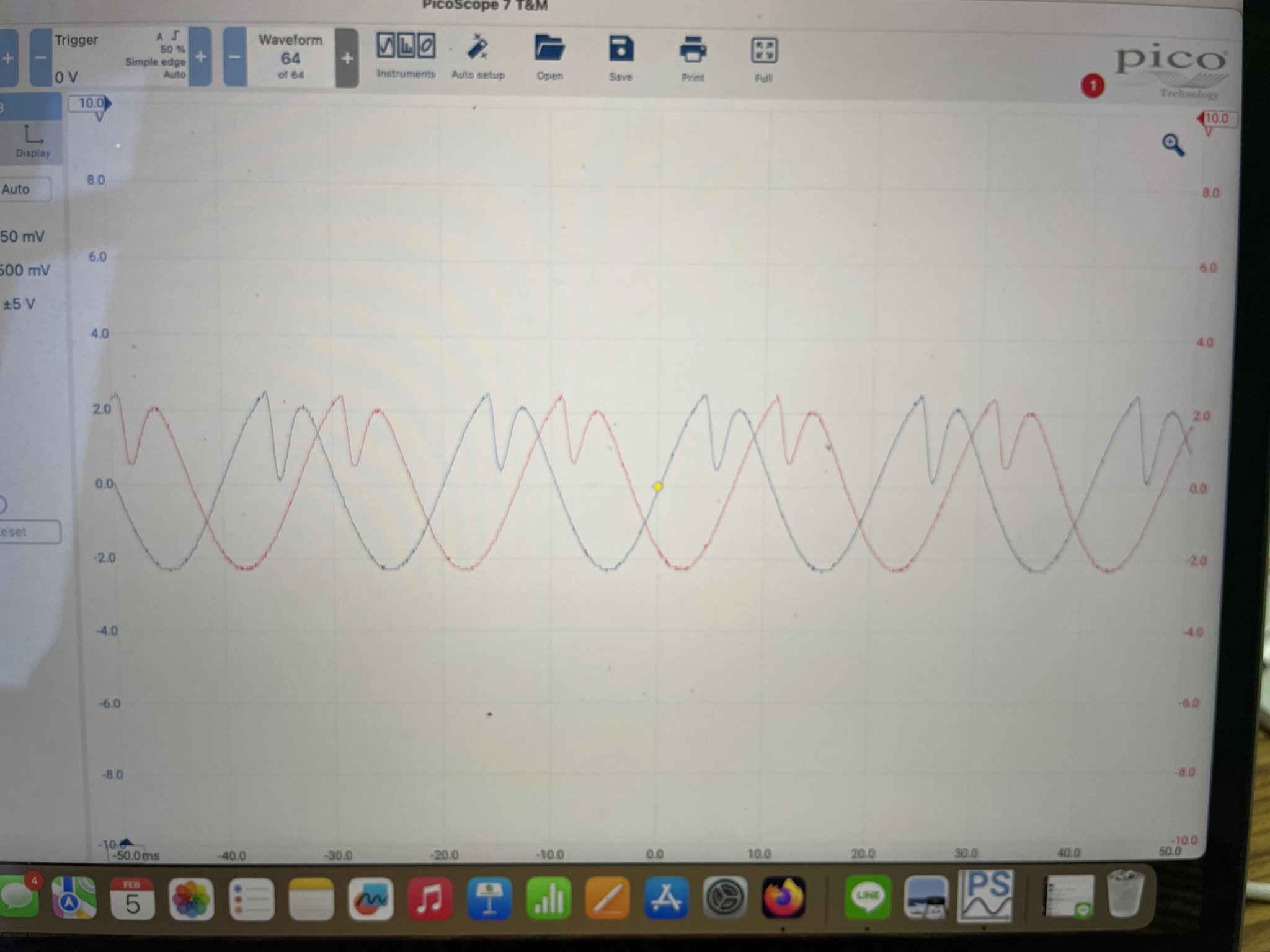

I got microprocessors today so could finaly test it. Starts up properly byt the output looks like this. Any suggestions? Frequency seems fine also amplitude is ok but why do it look like this?
I also saw the clipping. Reducing the output level to 127 or lower cured the problem as found out by ForsBackaKalle. Thank you!
The problem with 128 as an output level is that +128 = -128 modulo 256, or specifically that +128 is interpreted as -128, in standard 2's complement binary representations of integer values. That puts a big glitch at the top of the waveform.
Actually, this has nothing to do with it at all. The glitch happens when the PWM value is 255 not 128 and it is caused by a design flaw in the AT89LP51RB2 processor (now made by MicroChip). The original AT89C51RB2 (Atmel) does not have this problem. I've confirmed with MicroChip that this is indeed the case; they admitted that it is a well known defect, even though they have no app note or other service bulletin or any other documentation to explain it.
Version 1.06 of the SG4 firmware corrects for this by preventing PWM value 255 from occurring; the range of values is now 0-254. Previously, value 255 would occur when the attenuator value is 128.

The output PWM on v1.06 goes from 0 to 254; it passes 128 without a problem. I confirmed the design flaw by manually stepping through all PWM values and measuring the output; the PWM value 255 does not work, all others do.

Because the PWM register is 8 bit unsigned; it produces variable duty cycle outputs for values between 0-255, although in the LP case, 255 is to be avoided, so 0-254. The filtered PWM isn't bipolar; it ranges between 0-5VDC for PWM values between 0-255 so a value of 128 is 2.5VDC (assuming a 5V supply).

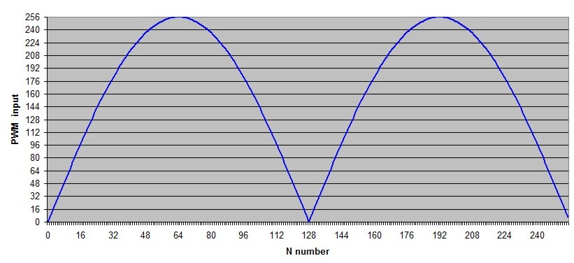

OK, I see where you are coming from. The way that I'm scaling the output to the amplitude number works like this:
I have a sinewave table in ROM with two identical half waveforms, 0-179° and 180°-359° with values from 0-255 (y axis); I use the upper 8 bits of the phase accumulator as an index into the table so there are only 256 entries each representing a 1.40625° step (x axis). To scale the table values to the PWM output, multiply the table value by the amplitude value and divide by 256 then add to 128 (<180°) or subtract from 128 (>=180°). This will produce a variable P-P output centered at 128 with values in the range of 1-255 (PWM output). I use integer multiply and divide so any fractional part is discarded. This worked without problem on the "C" version chip, but I had to change the center offset to 127 for the "LP" version making the range of PWM output values 0-254.
128 works as the full scale amplitude value in this scenario; it will produce a P-P PWM output of 1-255 (128 center) or 0-254 (127 center).
